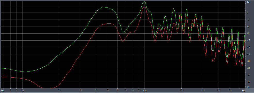

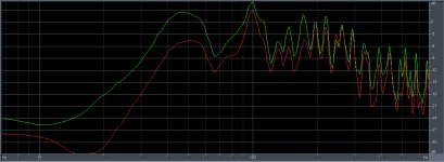

How do these clips sound as mono mix played through one speaker?
Can you EQ for H4 microphones?
EQ below 400Hz needs improvement for direct comparison of reference clip to speaker clips. Here is mono mix comparison for clip-2 of reference v B:
In listening I look for speaker which sounds most directly like reference clip. For this round I ended up using steep 400Hz high pass to make reference clips and recordings sound more alike.
Also, recording at .5m, but referenced to level of 95dB at 1.5-2m would help bring more driver distortion into play.
I found mixing H4 stereo to mono suppressed some of the room factor.
I would be most interested in TC9FD/10F/B80; it is great comparison of similar cone geaometry and ferrite v neo motors.
