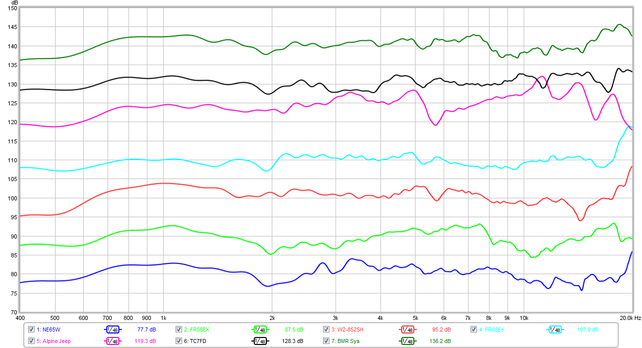

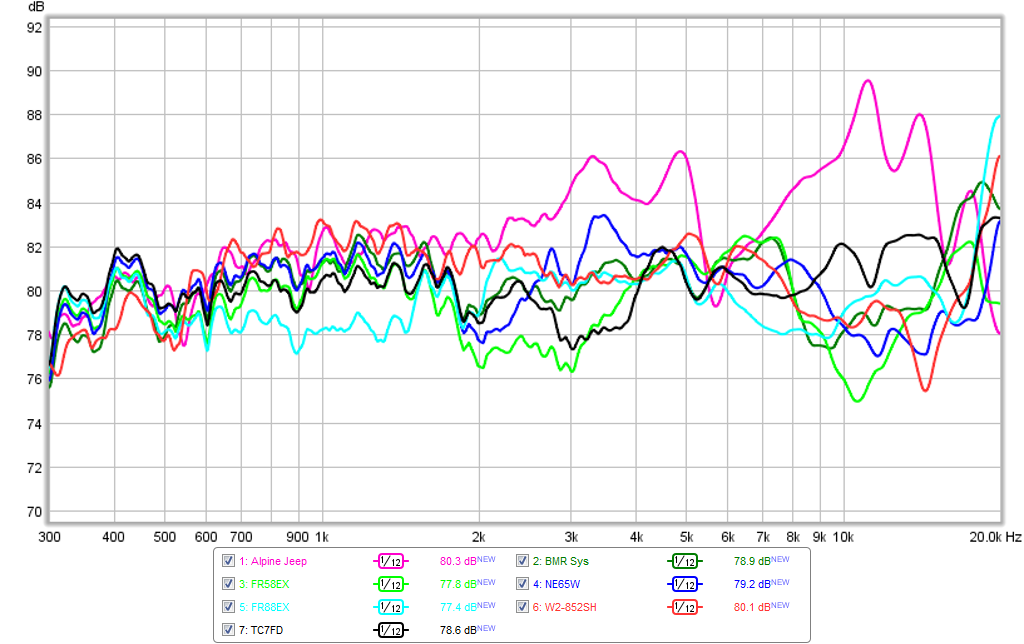

Here are the responses shifted for clarity:
Here is the un-shifted data to show why driver A was so much louder than the others (2dB per division scale to exaggerate differences). Note the +/-1dB span at 500Hz that I worked to try to set the relative levels:

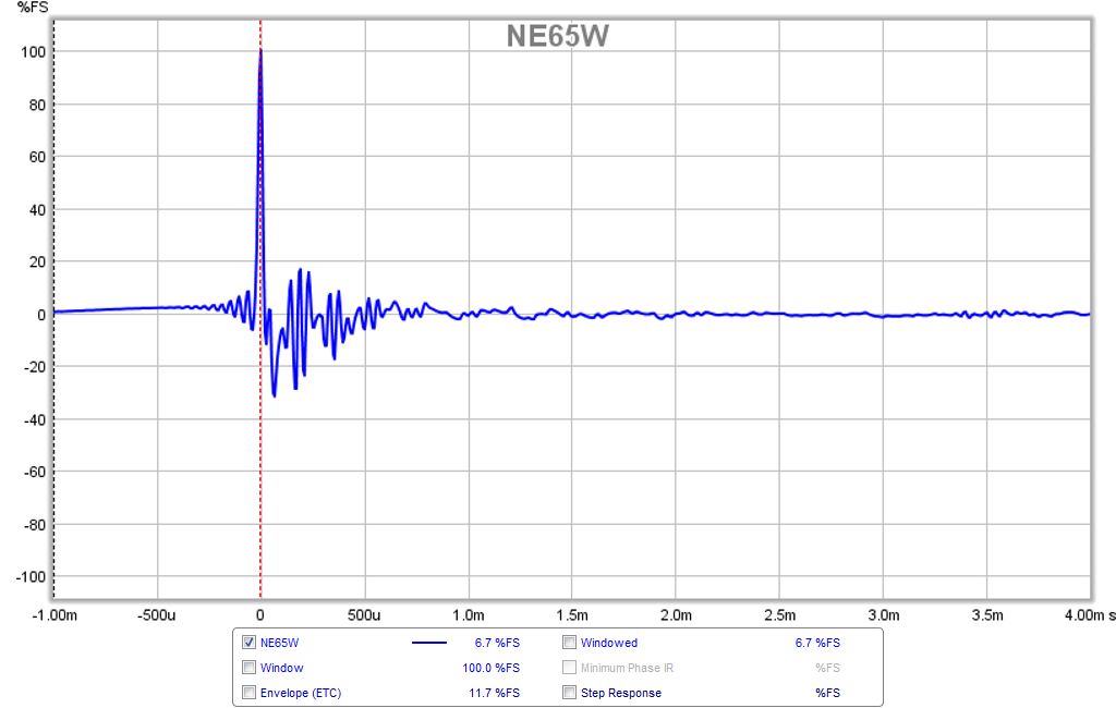

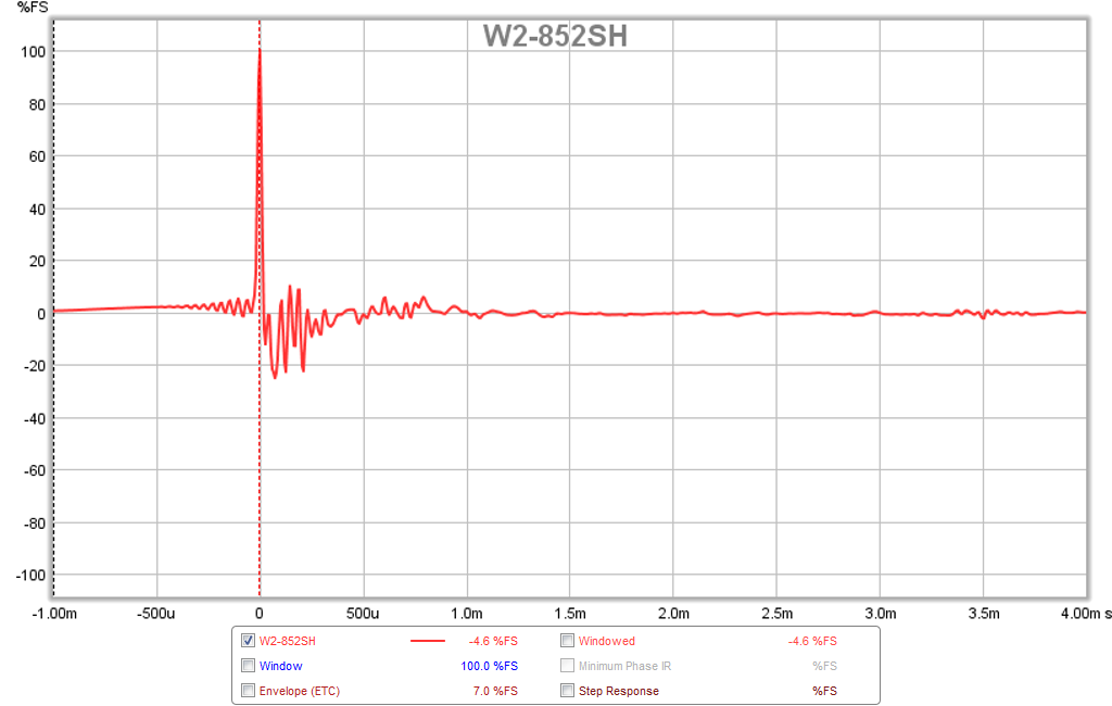

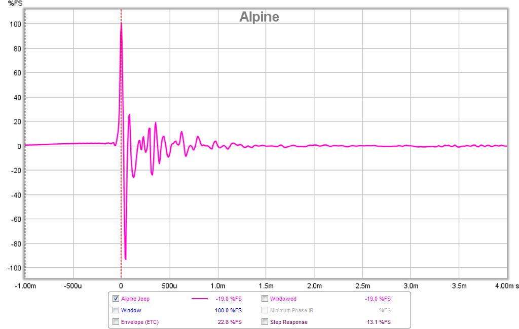

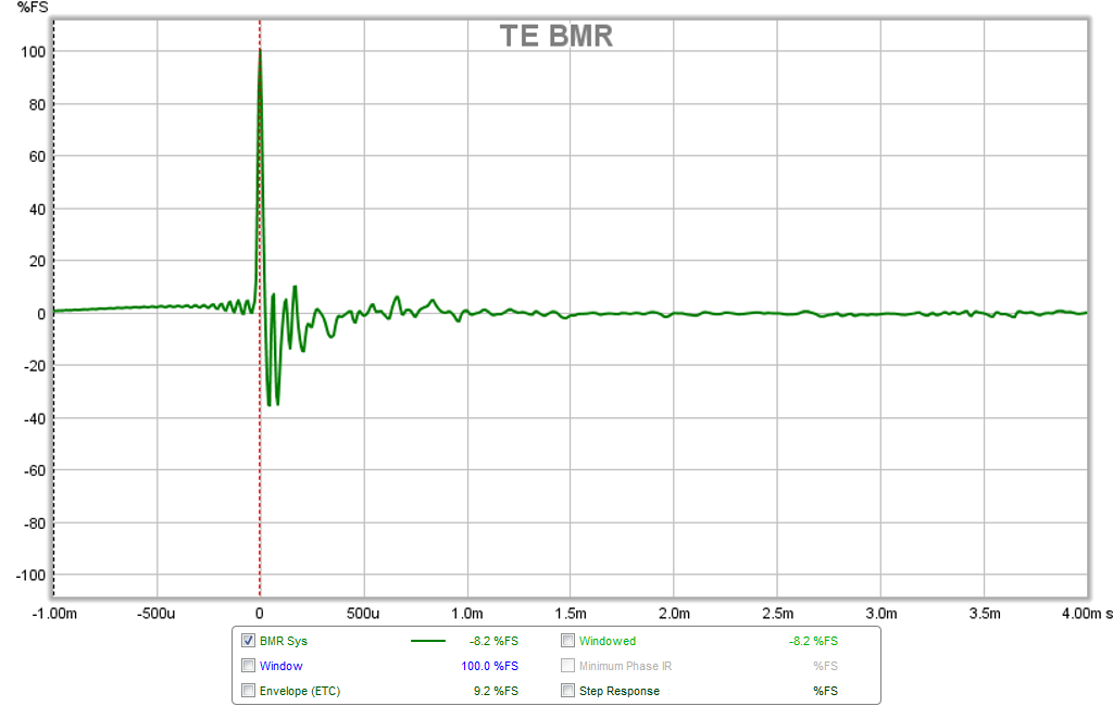

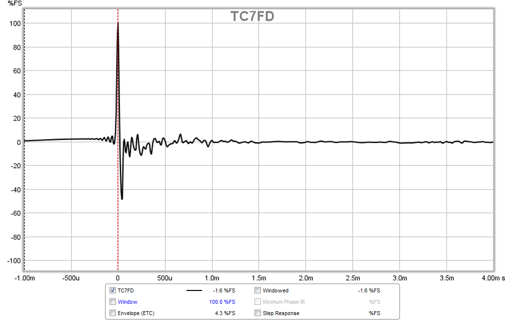

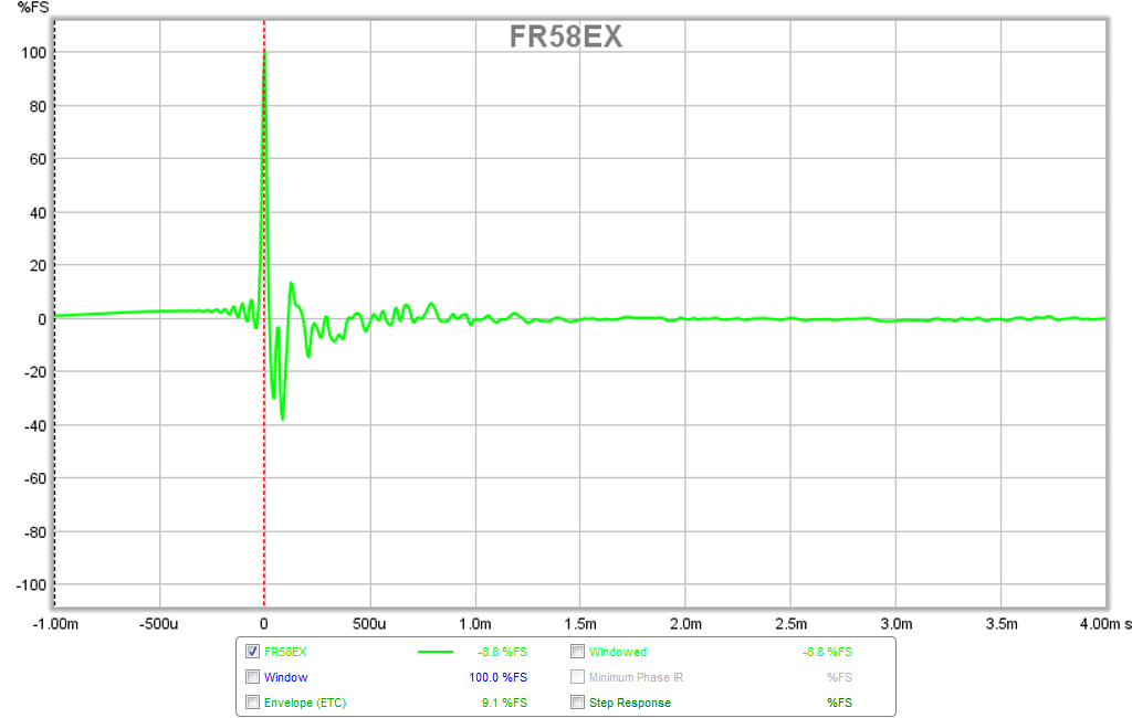

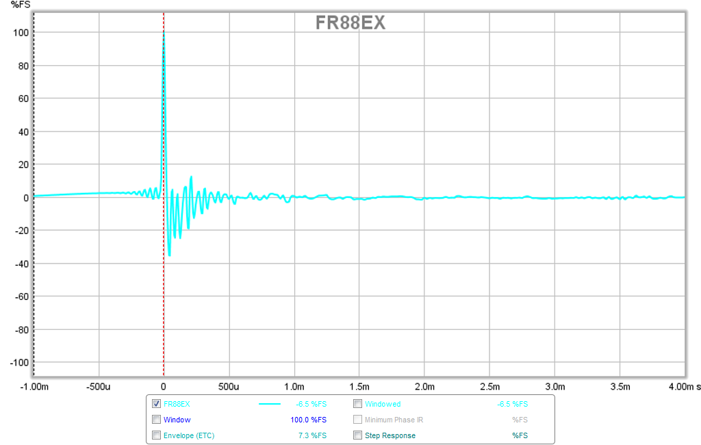

Here are the measured Impulse Responses:
Alpine Jeep Wrangler:
Tectonic Elements BMR:
Fountek FR58EX:
Peerless NE65W:
Fountek FR88EX:
Tang Band W2-852SH:
Vifa TC7FD:

I figured the Alpine was picked as lots were auditioning with loudspeakers plus enjoyed its ramp up in the mid treble which made things "clearer" than the reference tracks. Its horrible that I picked FR88EX to sound resonably close to the reference - hehe
can some of the flatter drivers be eq-ed to emulate the Alpine? - or does its dustcap behavior dominate the character?
I liked the FR88EX - that was my pick too. The Alpine's dustcap is reported to be affixed with a soft resilient rubbery glue to abate resonances. I imagine the big peaks are the carbon fiber cone and surround breakup. This driver is unusual in that it has a soft treated cloth half-roll surround (similar to the one on my old school RS 40-1197 FE103). I think the carbon fiber poly cone is impedance mismatched to the surround and that is the resonance source. If a thicker rubber surround like that used on the FR88EX, perhaps more of the breakups could be dampened. But hey, the resonances are what made it win hands down. 🙂
I think some have said this: in a fast moving SUV blazin' through a bumpy dirt road, this extra "grit" in the sound may actually increase intelligibility over the drone of rubber tires and pavement. It's definitely worth a listen and the price is not going to set anyone back at all. May be tough for folks in Europe or Asia/Australia to get though.
there's still some left at US Ebay (pulls - I think) Jeep Wrangler JK 14 15 Dash or Sound Bar Speaker 4" Alpine | eBay
Hummmm, I voted for A first & E second ! This A cone sings like metal cone while the metal cone of the second not so much while having détails (but less than A in my setup) !

The Jeep looks like a Lowther in response..... My vote was for TC Elliot Dane....Without further ado, here is the answer key:

I ranked G first (Vifa) and A last (Alpine). In fact my notes indicate I would not believe anyone would choose A. I wrote “sucks” in my notes. It sounded very splashy and sibilant to me.
When I chose G I guessed it was one of the larger diameter drivers because - I felt - it had the fullest sound overall. I was wrong about cone diameter.
That the Alpine won (I remember Alpine fondly as the best car stereos of the 1980s with their beautiful green glowing lights) indicates why so many enjoy ragged drivers like Lowthers. Variations in frequency response create a sonic signature that’s exciting for many.
In this instance, the least flat driver won (followed by two flatties). Again, an inexpensive driver performed better than the expensive ones. I love that trend.
