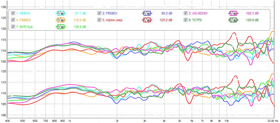

It could easily be said that the Alpine's loudness made it get the most votes.
If the levels had been set so that overlay looks more like these:
then votes would likely have been more evenly distributed.

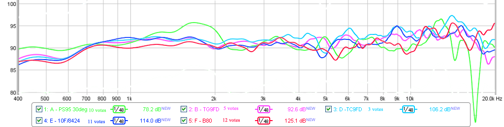

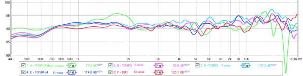

No winners or losers at this stage of development. Each would need refinement in XO level matching, and all the drivers except perhaps the Alpine and FR88EX would benefit from some broad cut at about 1kHz.
I haven't seen or used drivers that don't benefit from at least two bands of PEQ. Many need 3 or 4 bands of PEQ before they remotely sound like results achieved with inverse transfer function filtering. Based on my explorations with both of these alignment approaches, once a speaker system is equalized to about ±1.5dB across the spectrum speakers start to sound very much the same. From here differences in polar response, and thus room response become significant.
Round 4 results support this view:
In round 4 vote distribution was much wider. My ±1.5dB criteria is well met by most of the round 4 drivers across much of the spectrum. Polar response cropped up in round 4 with off axis recording of PS95-8. It was well received by voters but room reverberation sounded brash to me. If the on axis response of this driver had some of its high end tamed with EQ for on axis recording, it may have lead the round.

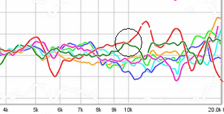

I have a theory that what made Alpine (and TC7 to some degree) sounds natural (others sound like having blanket in front of it) is the tilting response from 6kHz and up. Many speaker builders prefer to do the response like this....
Some other builders (like me) prefer a tilting down response from BSC and up. I have never read people mentioned the reason why, but I know why I did it like that. I even guessed F was TangBand simply from the tilting down response (tho this is only from 1kHz).
