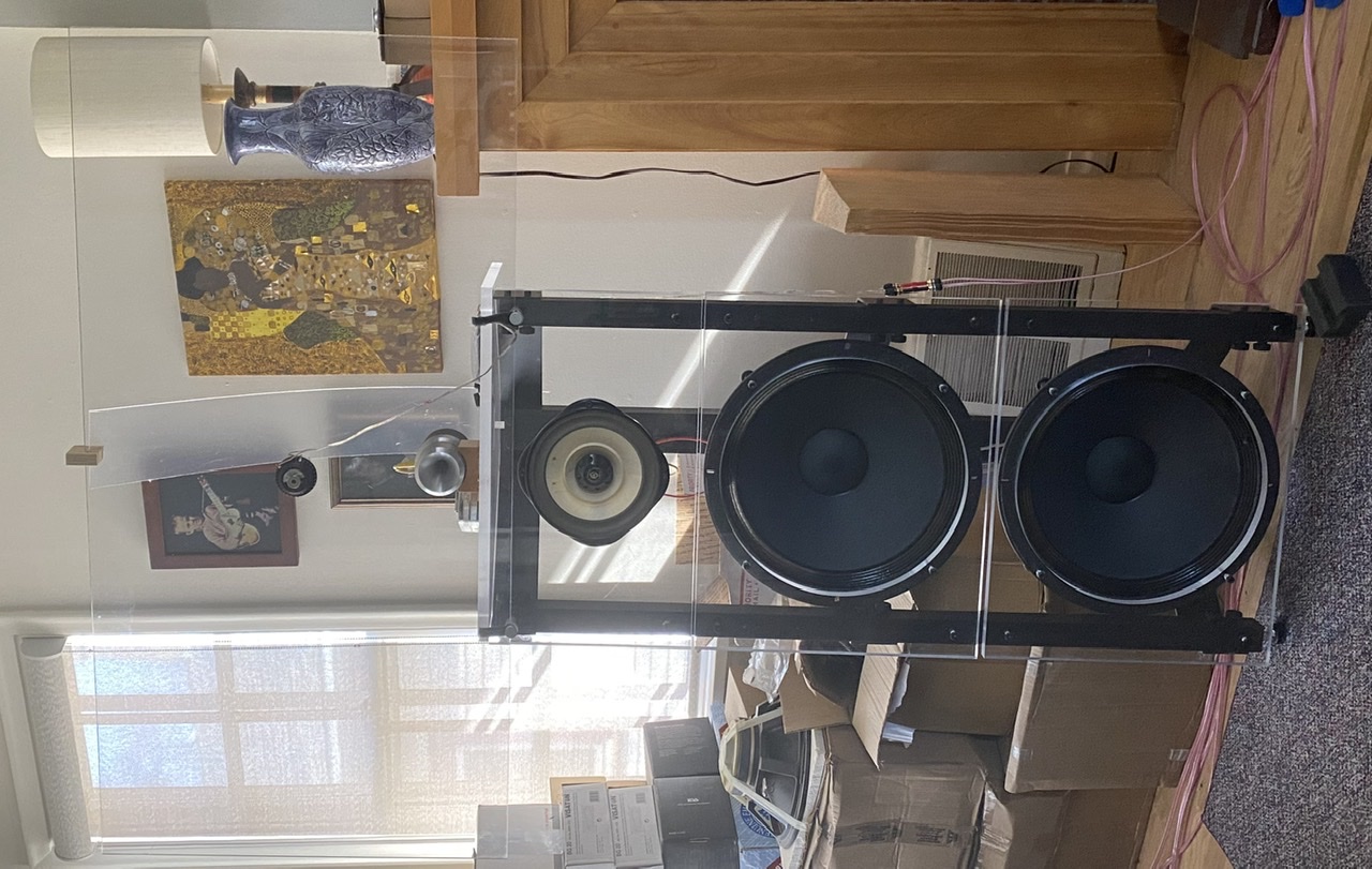

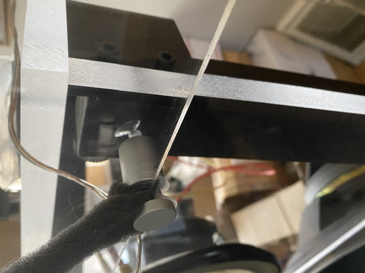

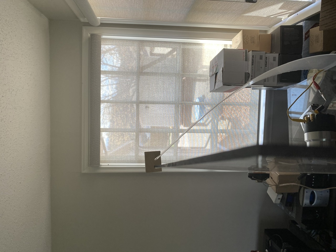

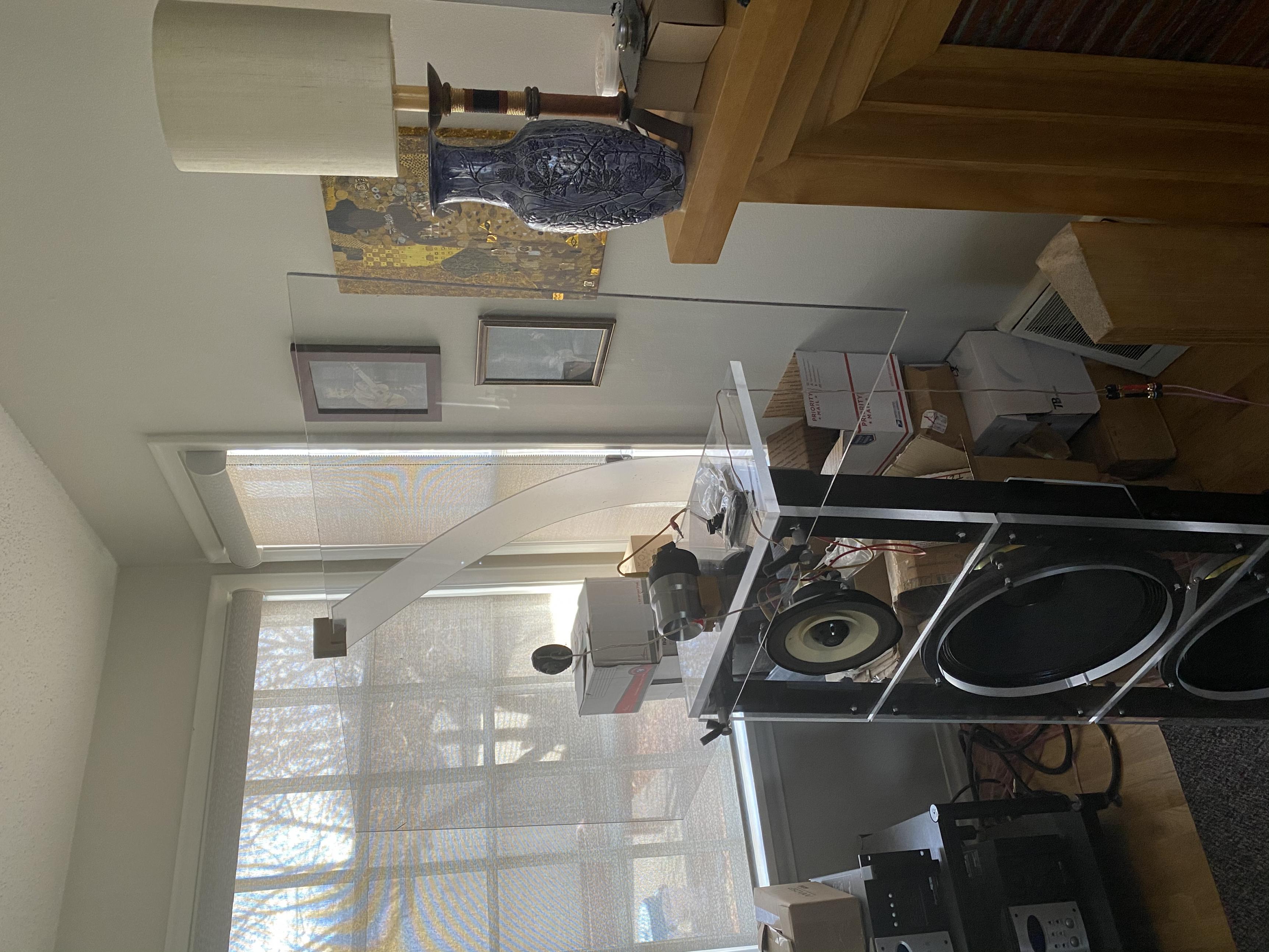

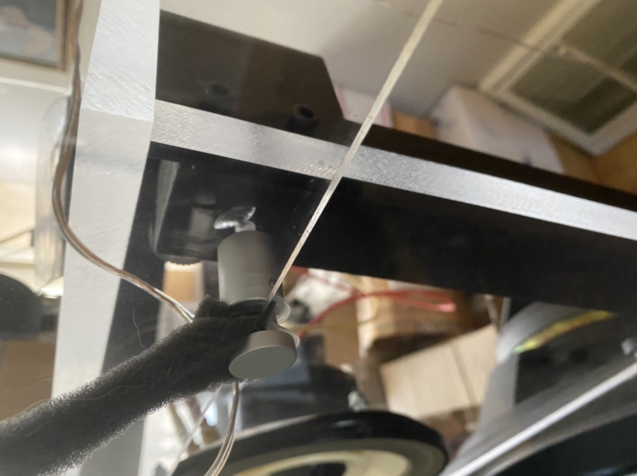

Plexi DML
Here is my latest DML adventure.
2x4 ft plexiglass .25 inch DML with biamped system. The OB full ranger and the super tweeter have been disconnected but are “nearby” for comparisons. Subs are OB 15” Altec 416 c. Yes, there is a big dB/w efficiency difference but so what... I turn down the subs. Running the subs below 125hz only. They play loud. Just got my minidsp so here goes.
Result.... wow! Just wow.

Dave - that looks awesome! I was missing your posts lately - looks like you've been busy!

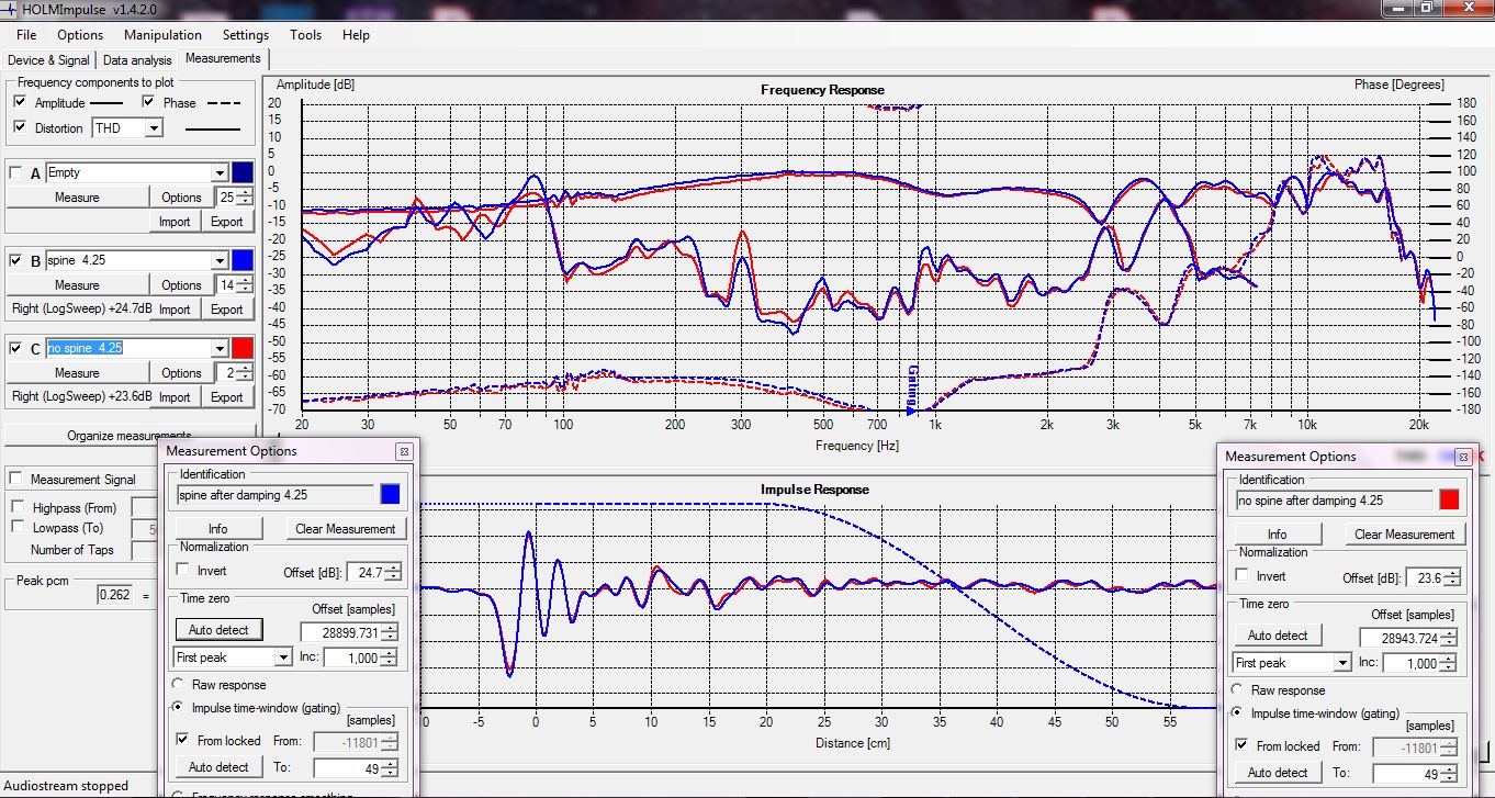

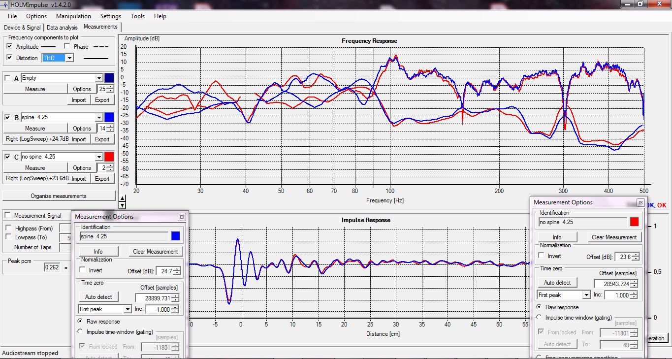

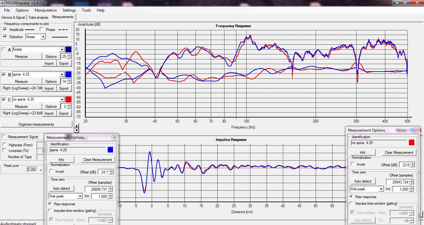

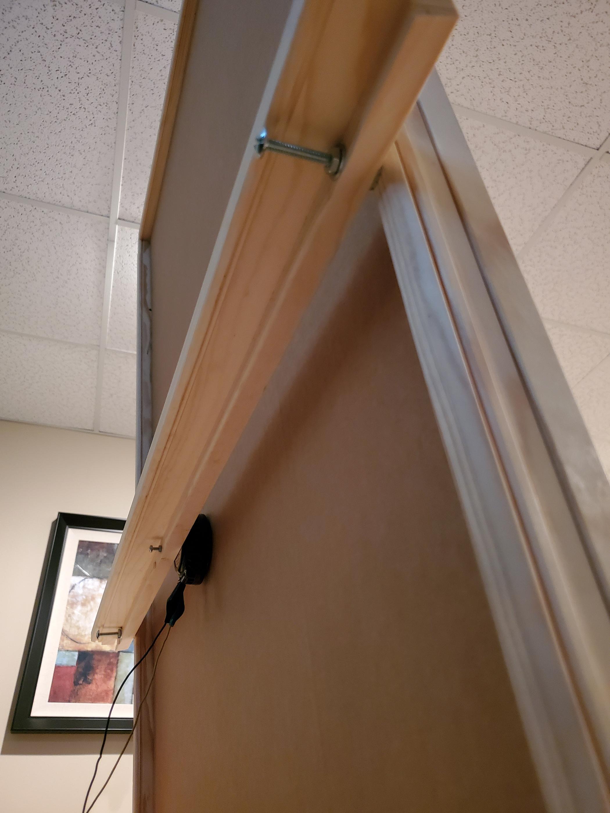

I have so far only had experience with EXP panels with no frame or spine supporting the exciter, so as a test to see the difference a spine could make, I put together a cardboard panel and took some measurements with and without the spine. I was expecting quite a difference since I could feel a lot of vibration on the exciter housing without the spine and the cardboard is quite floppy - but there does not appear to be much. Prior to the measurements, I ran a frequency sweep on the panel and added isolation to points around the frame to dampen resonances (dots of soft butyl rubber). Guys, could you please give me your take on my results or how I got them? Thanks, Bruce.

Thanks for the feedback Spedge. Funny, this is my first build, but my intuition is that the thin wood is pretty good.
After about 10 hours of playing, I started getting some ugly resonance on the short wire that bridges the 2 exciters on each board and also on the wires themselves at around 400hz. Was very annoying and haven't quite isolated the cause.
The speaker wire is a pretty heavy grade, so could be some combination of that and the exciters breaking in. Having something standing behind the speakers to support the weight of the wires has made it go away for now.
Maybe I'm discovering something others here have known for a while? Namely, that you need to attach the exciters with some other means than the included 3M glue strips?

Your exciters are being unbalanced by the wire,this is causing the exciter to rock sideways ,there is a danger of coil damage,a spine is called for to hold the magnets steady
I have been banging on about not using tape of any sort for at least 10 years now,welcome to the clud.

Wow, Dave - this is amazing and totally surprising coming from you. A few pages ago you were experimenting with composite materials, and now plexiglass! And the results are wow.
I use plexiglass a lot in my diy audio - for enclosures, but would never have considered plexiglass for DML panel material. This thread remains incredibly interesting and also confusing.

I think your diagnosis then of "Exciter Wobble" is spot on Dr Steve, because it did seem to get worse when I pushed more LF to the DMLs.
My plan is to suspend the panels, one each on one of these things:
I'll have to think about how best to incorporate the spine in there. Or perhaps will have to cook up something on the back that just "neutralizes" the weight of the wire.
