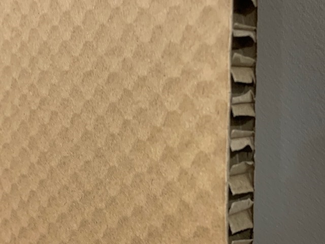

I think I just scored a major find on a potential DML panel material. I got a large mirror delivered the other day. The box had a 76in x 32in x 15mm thick brown paper faced honeycomb core material to protect the mirror inside the box. It is huge, very stiff and light weight. If we like the sound of paper cone drivers, this just might be the thing. I want a pair of stereo panels. Should I cut length wise for two 76in tall x 16in wide panels for a "Tall Brunette" speaker? Or the other way at 38in x 32in pair of panels? I think the tall ones will get deeper bass from what I have read. Has anyone else tried cardboard honeycomb?

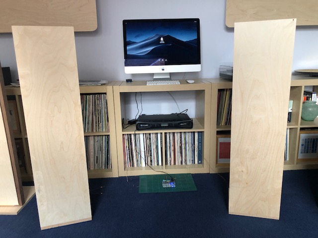

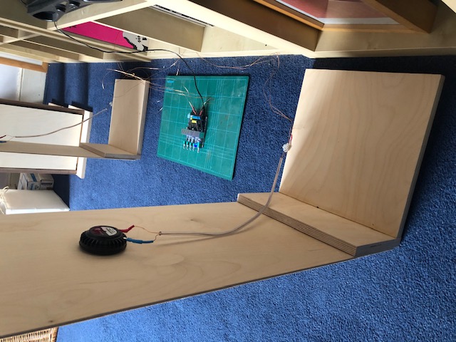

On tall panels I have found the following.
From 100Hz out to 20kHz with EQ I have found the performance to be just as good at the 'conventional' golden section or silver section ratios. Combined with a decent subwoofer you get wonderful performance for the money, in my view , having lived with ESL's for years, the sound is on par but with better rendition of instrument timbre and better attack.
Nothing controversial about that and it makes for a very elegant and WAF friendly solution.
However, and this is the controversial bit, when building a pair of tall panels I discovered that two pairs I built had a much better bass response than panels with the conventional ratios.
BUT...
This needs careful caveating, the detail is important. I have only had this additional bass result with three layer Birch ply. As Veleric has pointed out, this material is highly anisotropic- it is much stiffer in in one axis than in the other axis at 90 degrees to the first. This is probably a big factor in the performance I get from these panels. Secondly, having used a number of mathematical models to calculate the panel eigenfrequencies I find that the simpler models for a beam rather than the models used to calculate a panel to give results closer to the performance I get in the bass. The following is highly speculative and not to be relied on, but I think it possible that the tall ratio panels transition from a DML mode to something more like a vibrating beam at lower frequencies.
None of this has been proven yet! Once the lock-in has stopped in France I plan to run some experiments using various ratio panels measuring the results with REW to try to bed this down once and for all.
Having said that, other posters have reported good bass performance from XPS/EPS panels with similar tall ratios but, I am not aware of anyone doing a side by side comparison yet. It's a work in progress.
So, used with EQ with a subwoofer with an XO at circa 100-200Hz you will get terrific performance from panels with ratios 1:3.8 and 1:4. Experiment with where you place the exciter on this ratio of panel but I find the best position to be just off the centre line on the long axis and about a third of the way up from the base. Plan to do this and, if you find like me the bass goes deeper than expected, you can dial back the subwoofer performance to taste.
Pictures are of the simplest tall panels
Burnt

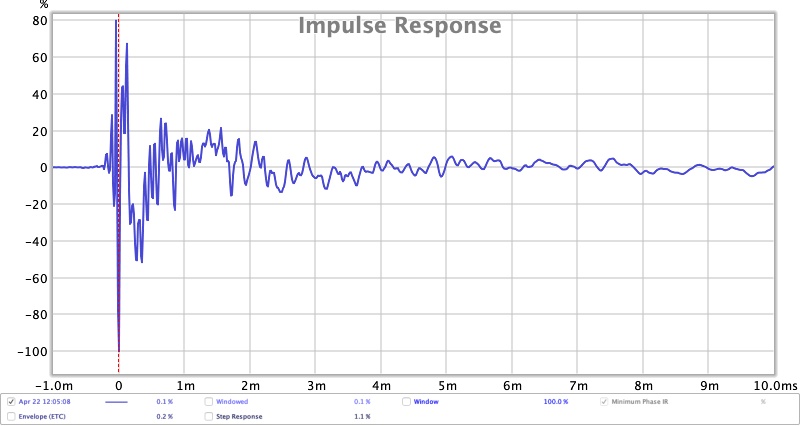

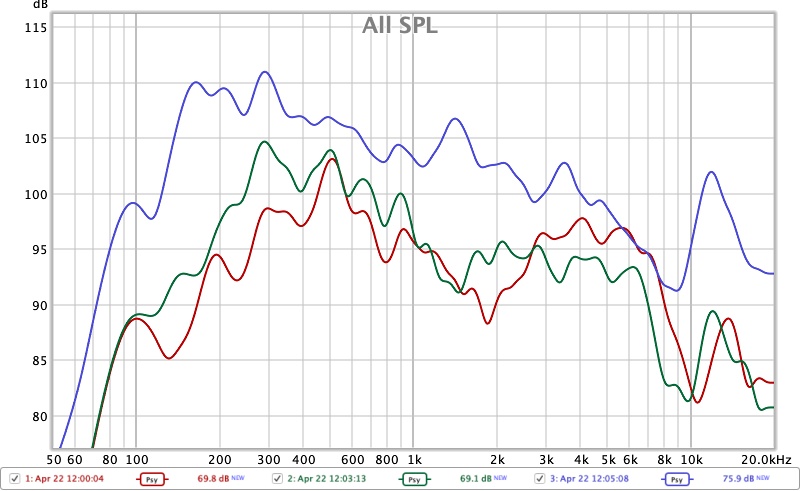

Hi Steve,
I have been able to complete some initial tests on the large panels here in Varaize.
I include two pictures, the first is frequency response, the second is an impulse response.
I measured a single panels FR with the mike in three positions. 1 directly over the exciter ( Blue trace) ,2 at the left hand corner of the panel (Green trace) and 3 at the right hand corner ( Red trace). In each case the mike was 50mm/ 2 inches from the panel surface. The response is raw, without EQ, and with the subwoofer turned off.
I think I have been successful in making sure the response is properly gated to make sure that only the output of the exciter and panel is captured and excludes room effects. It is the first time I have tried this so if anyone thinks I have got this wrong i would be happy to hear that.
As you can see the exciter output is around 5dB higher over most of the frequency range. There are variations in output from the panels at each corner, the divergence in output between exciter and corners at 1.5kHz to 2 kHz is interesting.
I suspect that there is similar variation in output across the panel and what you get at 4M away, my listing position, is a summation of all these differences. In case anyone is alarmed by these results, if you look at what happens to a different areas of a cone at different frequencies, similar variations occur.
Please let me know if this is useful Steve

Hi xrk971
that's a wonderful find and a very good idea. I've this in mind, since burnt has made those long and tall DML's. Probably one side coated with veneer could be an option.
Thank you all for your work and experiences and especially to xrk for pointing to that thread. I appreciate it a lot!!!
