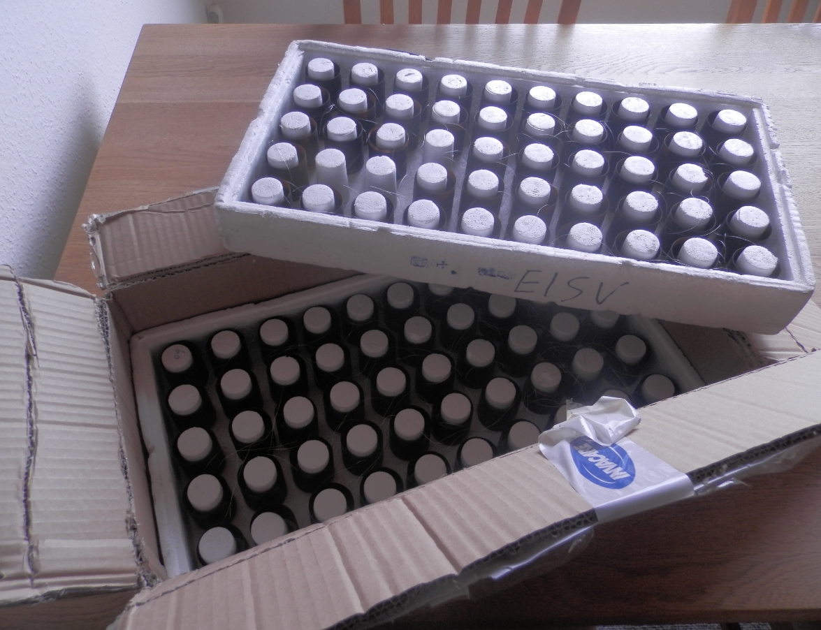

Frank40: do you fabricate the parts yourself? Judging from the magnet mass you are planning a very powerful exciter

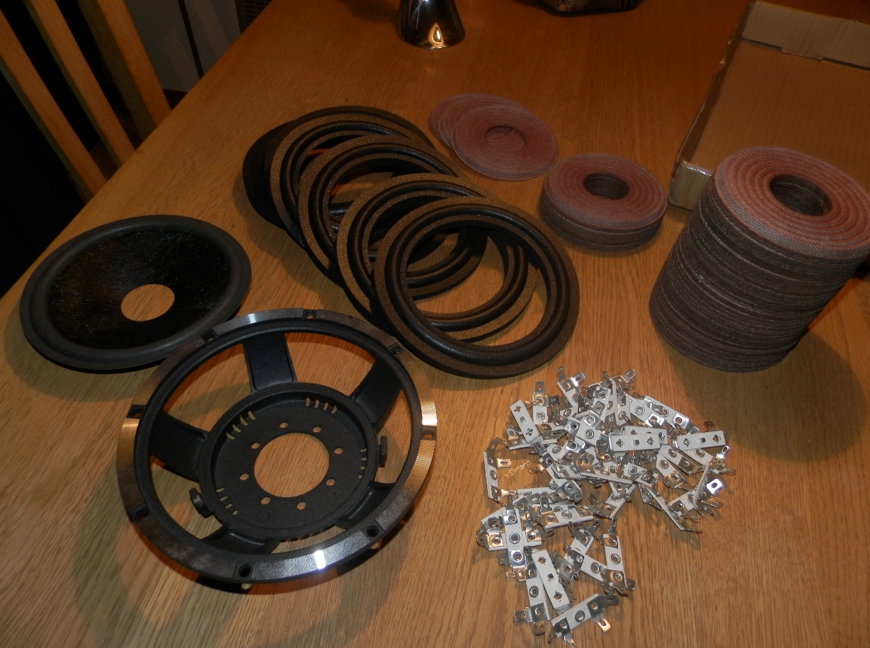

I total agree.... everything count that is why I make my own driver, there is no point to have a nice driver if you do not pay attention to the membrane and suspension. The same goes for dynamic speakers.
The NTX modules that I have heard do have some lacks in my opinion, and I think it is because the lack of attention to make a rely god driver the focus has been to make them as small possible.
There is rely no difference in the energy conduction from the driver the the membrane in normal vs. NTX membranes, it is all in how the membrane load to the air.
I will post as soon as I start making driver.

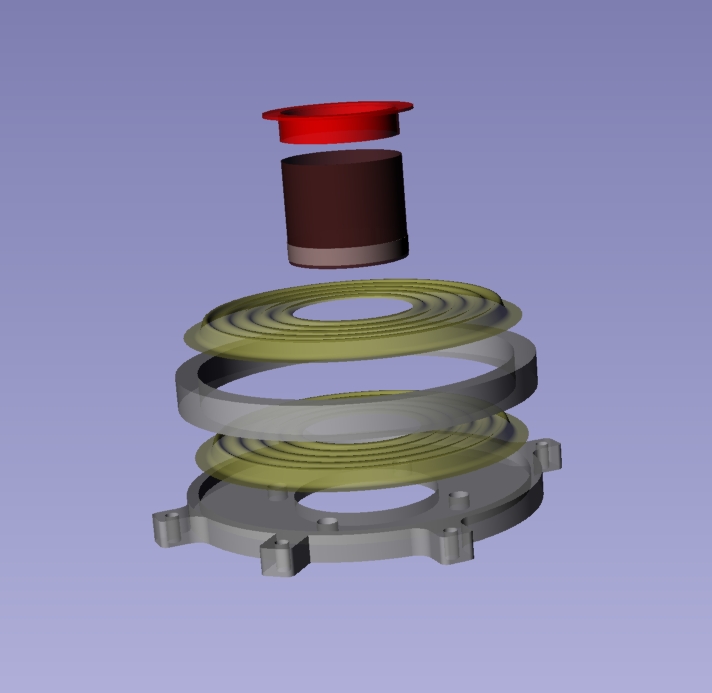

I couldn't wait so I started with a 100 mm mangetic system from a monacor SPH 165C unit.
Would you make the exciter with one or two spiders. Two spider will provide a more stable motion and reduce the rocking movement of the voice coil, but it will increase the weight. Please see picture.

I love the 2 spiders designHello, I need a advice please....
FOR ME, weight is negligible compared to the air resistance of the panel and the power of restitution of the material (of the panel). For stability, I suggest more than an inch separation between spiders. google translator.

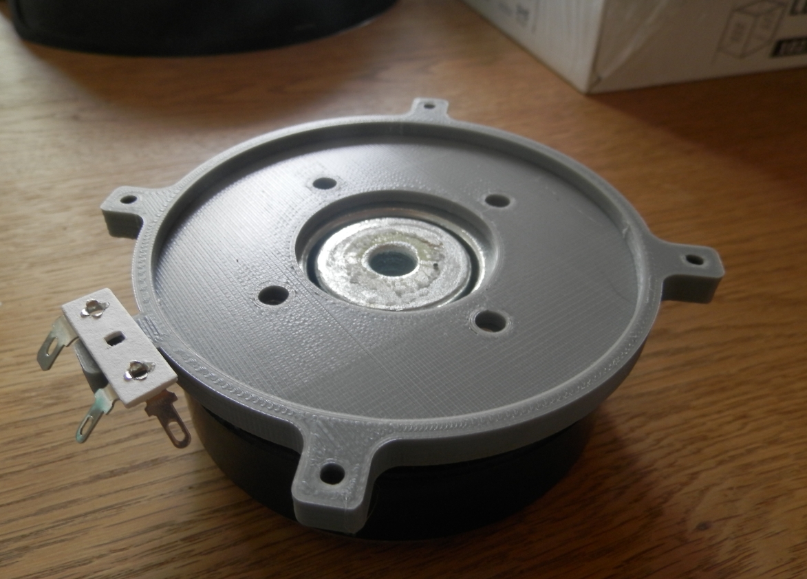

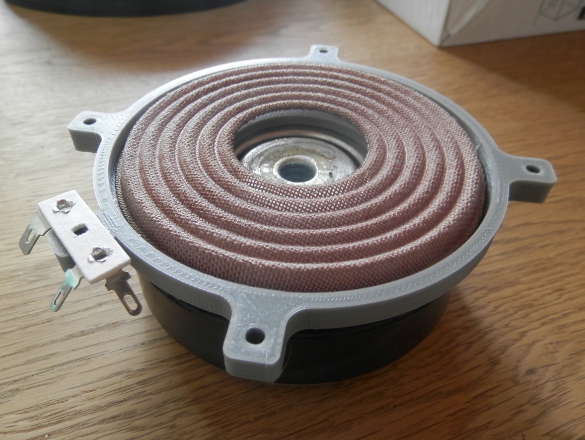

Now I have printed the first part and a quick mock-up, just for show. I think that I will do the two spider version to decrease the rocking motion in the system just to bee sure. So I have to do some more drawings and printing.

Isn't it nice to have a 3d printer? Which printer do you use and what software are you controlling the printer with? I like your solid fill - looks very smooth. Is that ABS or PLA?
Nice work!
Hi xrk971,
Yes it is soooo nice to have a 3D printer, I bought it to make tools for assembling my speaker units, but now I use it for almost everything.... If I can draw it I can have it. Some of the best money I ever spend.
I got a witbox 3D printer and print with PLA only, due to the toxic gasses from ABS. For slicer I use Slic3r and Cura, for printing I use Cura, Pronterface and some times Witbox own (USB stick)
