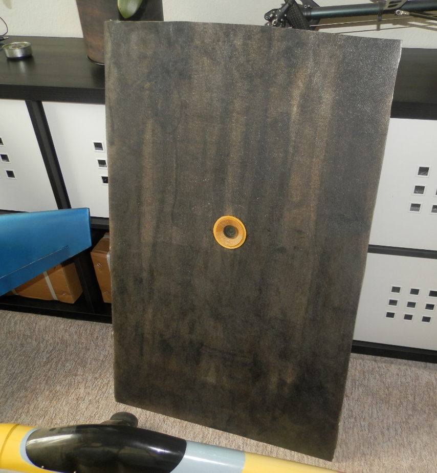

I did a neat experiment to combine a normal cone speaker with DML.... It works nicely. At higher frequency it work like a normal cone, but as the frequency it transforms to a DML unit.... extending the lower frequency range.
I to apart a 3” full range unit (not my own design) and mounted it on a 100 X 60 cm sandwich construction. The extension at low frequency was amassing. Any way I just wanted to share the info of this experiment.
Nice work ! do you have measurements you can share?

Tak! Thank goodness for Google Translate. Sundolitt "sounds" like an interesting material for panel
curious: on the one hand, a "normal" full range driver operates like "ideal piston" at low frequencies. Above some threshold, it goes into "breakup" which is DML (undesired in that case.) On the other hand, using an exciter to a panel, the opposite appears to happen: the DML desired action is at lower frequencies but at highest frequencies there is output closer to the exciter (as I understand this!) Nevertheless, the DMl thiing is "good" because at least at lower (but well into the mids) frequencies the entire panel is a random collection of micro-speakers

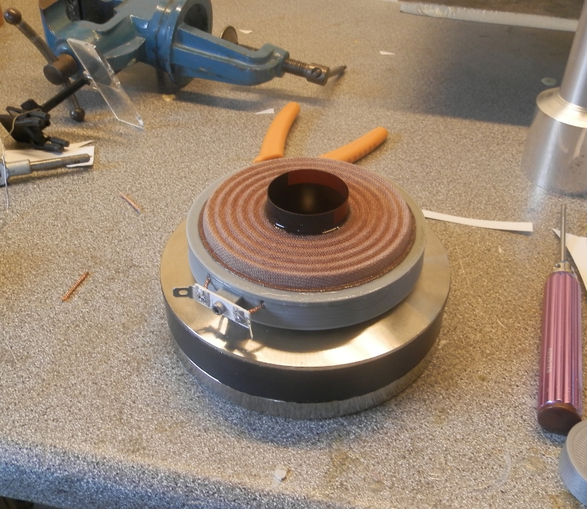

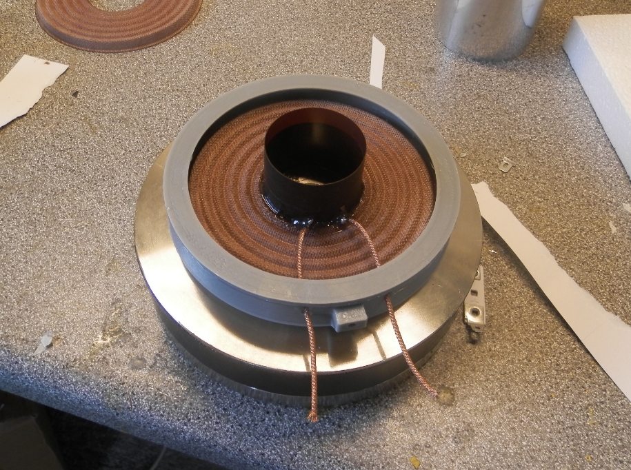

I finished the two spider exciter here is how it turned out......
Very nice! That looks really powerful and capable of bass.

Impresionante ! Sharp work, now in my dreams I see a thin screw with its nut to fix into a hole in the panel.

This is my new exciter, it works great..... The two spider system makes it very stable, see the video and you see the membrane is hanging on the exciter only without any other supports. The membrane is a sandwich construction of glass fibre and a sheet of 3 mm Depron.
I was a bit suppressed... first I thought the sub was turned on but it wasn't. Thesis membranes can go low in frequency but still lacking a bit at high frequency, will do more experiments on the membranes.

That is very nice - amazing that the whole membrane is supported by the voicecoil/spider and nowhere else. It must be a pretty light panel. Great work, thanks for sharing.
