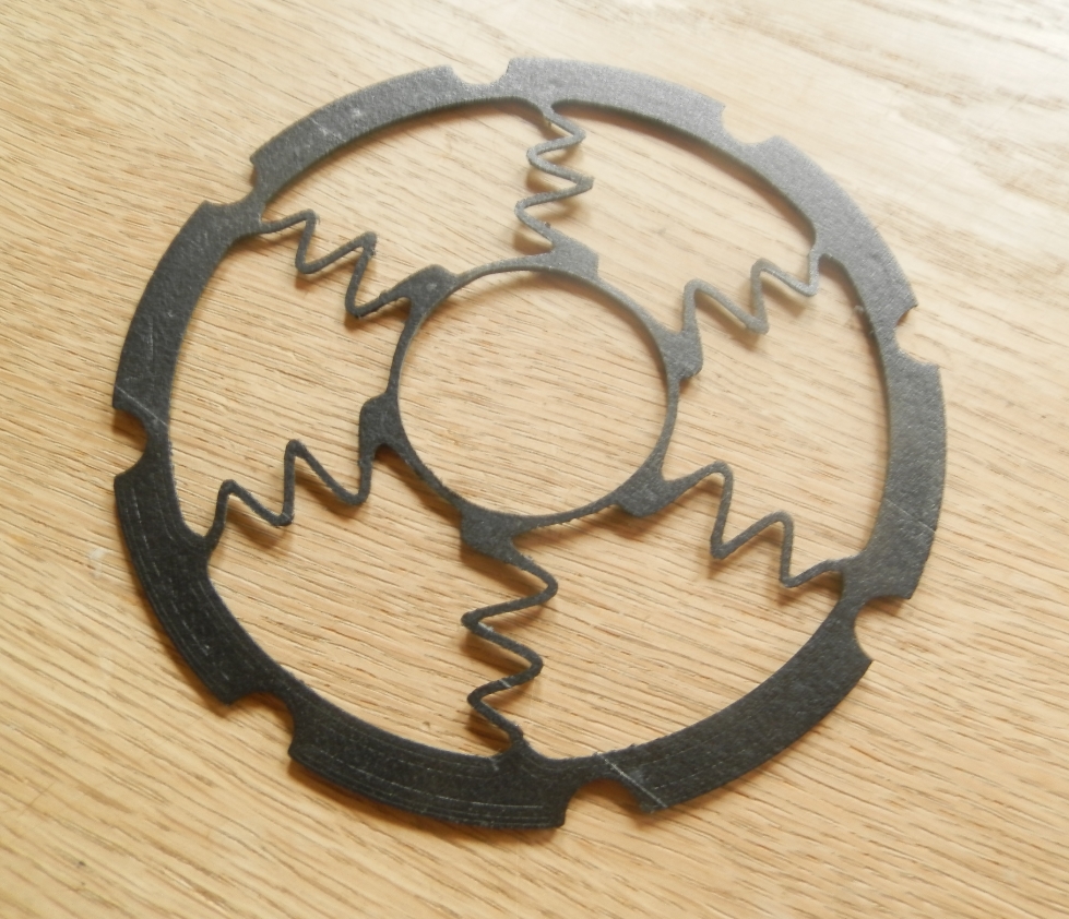

Thanks, Frank40 - I was thinking of something very similar. I was planning on using pentagonal symmetry to avoid usual transverse even order eigenmodes. One can make nice spiders with this method though - even dial in stiffness as needed.
Something like this?

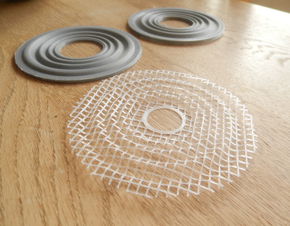

That is very nice - but I like the multi hairpin turn springs better - your latest one is definitely acoustically transparent.
What material are you printing with? That doesn't look like PLA. Looks like nylon?

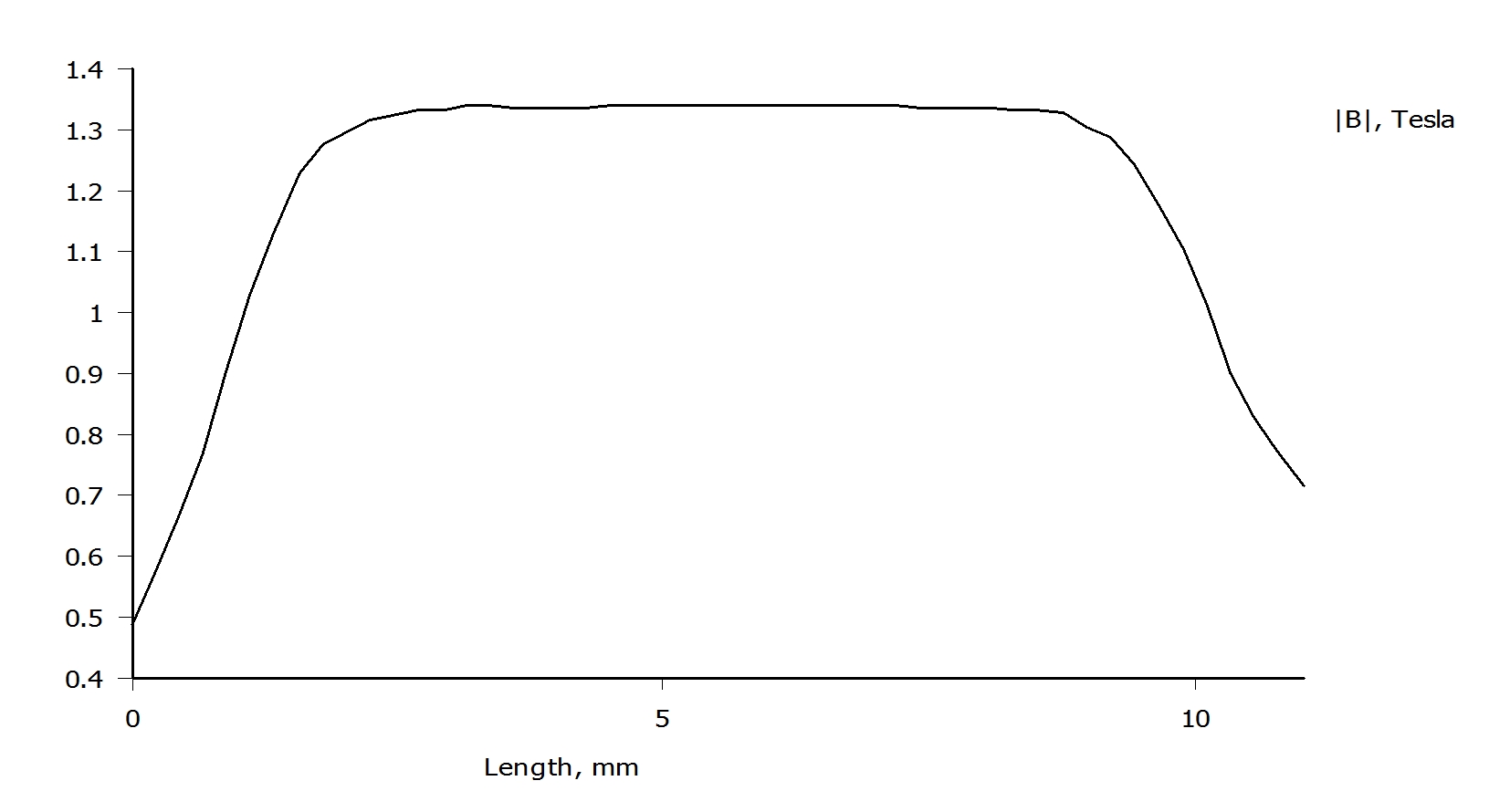

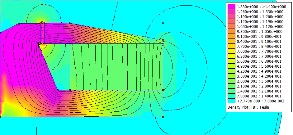

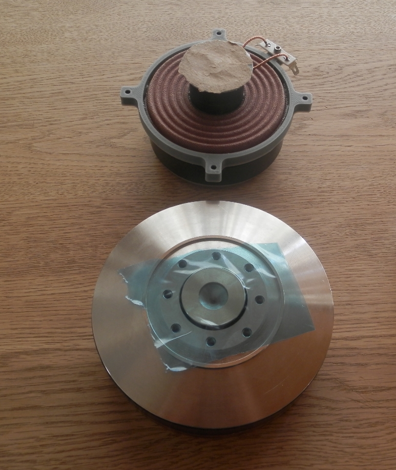

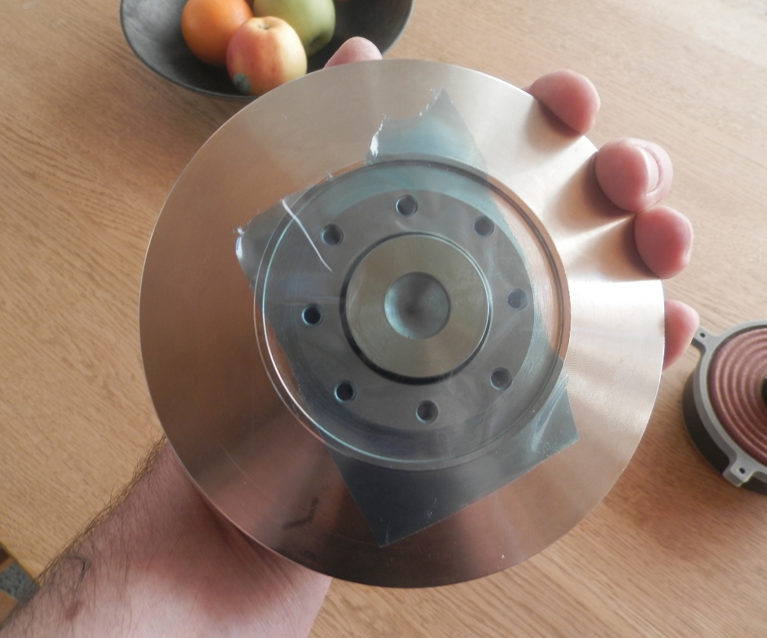

I got the new magnets today... they are Hugh , it will be one massive exciter. Here is some pic. And data.

It looks very impressive.
However, the bottleneck of HF is not at the driving force (strength of motor, suspension, etc.). DML works in a manner very different from ordinary speaker under high pressure.
Upper limit of frequency response is determined by the available density of waves on the panel. (When frequency goes higher and higher, there're more and more bumps and dips across the whole area.) So, the rigidity matters, the size of applying driving force matters.
And, don't be misled by the size of panel and its relation to the frequency response. A whole sheet of PS foam or foamcore board with the dimension of 180 x 90cm can play up to 20kHz. I believe other materials with proper characters can do that, too. And the radiation is very wide and effortless. You don't feel it forceful in near field, and it's attenuated very little when you step back (to the other end of the room). Overall, it's much much much better than any whizzer cone.
How big is your VC? From the pictures, I reckon it's 40mm perhaps? I don't have experience with such a big driver on DML. I've been using the cheap small one from PE with 25mm VC. With proper panel and mounting method, flat up to 20kHz is not a problem.
Big powerful driver is directly beneficial to the bass, though. LF needs large bumps and dips on the panel, which needs bigger driving force.

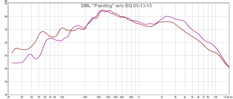

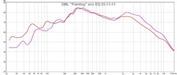

The view from the bed. Panels smaller, now hung on wall via single point attachment at top. Panels painted With spray and oil paint as a "painting" to match colors. I remain amazed how good a $25 pair of s##t car speakers, a panel, some wood, glue and sloppy paint job sounds [emoji12]
An actual test!
I know it is out of character for me to be serious, but I actually did some REW sweeps today and here is a plot. With a REW-generated EQ recommendation (I am using a DEQ2496 and just 4 PEQs) I am reasonably flat to 4K Hz and from there it drops about 12 dB/octave. As I said earlier, not bad for a large piece of foam insulation and a s##t car speaker bought at the local Appall-Mart
I'm not sure how REW accounts for this, but my EQ curve was with the "house curve" being the B&K suggested one (+3 at 20 Hz, down to -3 dB at 20 KHz.) but the highs go away rapidly even w/o EQ so is it really an issue
