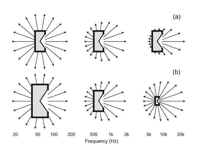

Here's something else from Floyd Toole's book
However, at higher frequencies—shorter wavelengths—the radiated sound will tend to become more focused in the forward direction of the diaphragm, radiating in a progressively narrowing beam. This is illustrated in a grossly simplified manner in Figure 4.20a; when the wavelengths approach and eventually become smaller than the diaphragm of the loudspeaker, it becomes more directional. This is a problem for two reasons
1. The off-axis, room reflected sound cannot have the same spectral balance as the direct sound. This is a problem for sound quality and sound localization.
2. Large diaphragms don’t behave well when driven at high frequencies. They acquire breakup modes—resonances—that color the sound.
However, if the size of the loudspeaker diaphragm is reduced as frequency increases, something closer to constant directivity can be achieved, along with much improved frequency and time-domain performance. This is illustrated in Figure 4.20b. The residual problem is that at very low frequencies the bass is radiated omnidirectionally, so the directivity control becomes effective in the low hundreds of Hz. In practice this is not an issue, because below the transition frequency what we hear is dominated by room modes, as will be discussed in Chapter 9. The choice of crossover frequency is based on both frequency response and directivity.
Figures 4.20a & b are attached in a single image.
I want to call out this portion of the quote.
DML high frequency reflections (ray acoustics above Schroeder room transition frequency) are not as concentrated as cone speaker reflections. So the problem Toole mentions should not be as noticeable.
With DMLs we might have beaming but it may not be as noticeable because it isn't enhanced by the ray acoustics. Or we might not have beaming because the high frequencies get absorbed by the panel before they get a chance to beam. Which might also be an argument in favor of high internal panel damping rather than deploying damping at the edges of the panel.

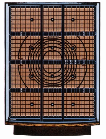

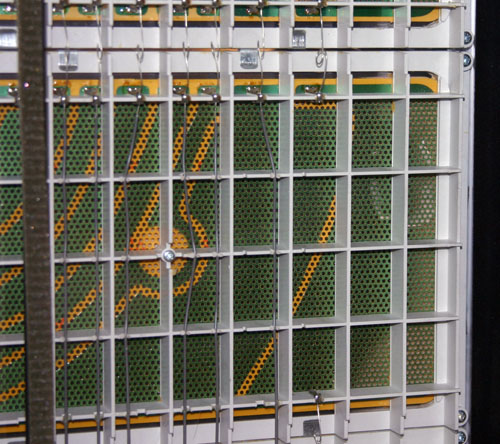

I don't know if the Quad ESL 63 might help with DML panel design, but maybe a concentric circle internal damping structure could be a good strategy. OffGrid Guy said he used hot glue in concentric circles to tune his DMLs and liked the results.
The ESL 63s used their concentric circle technique to address frequency wavelength beaming. Except in their case it was activation rather than damping.
The goal would be to reduce beaming but maybe DMLs don't beam anyway. I don't know why cone speakers and electrostats beam. Maybe DMLs are different in a way that fundamentally prevents beaming.

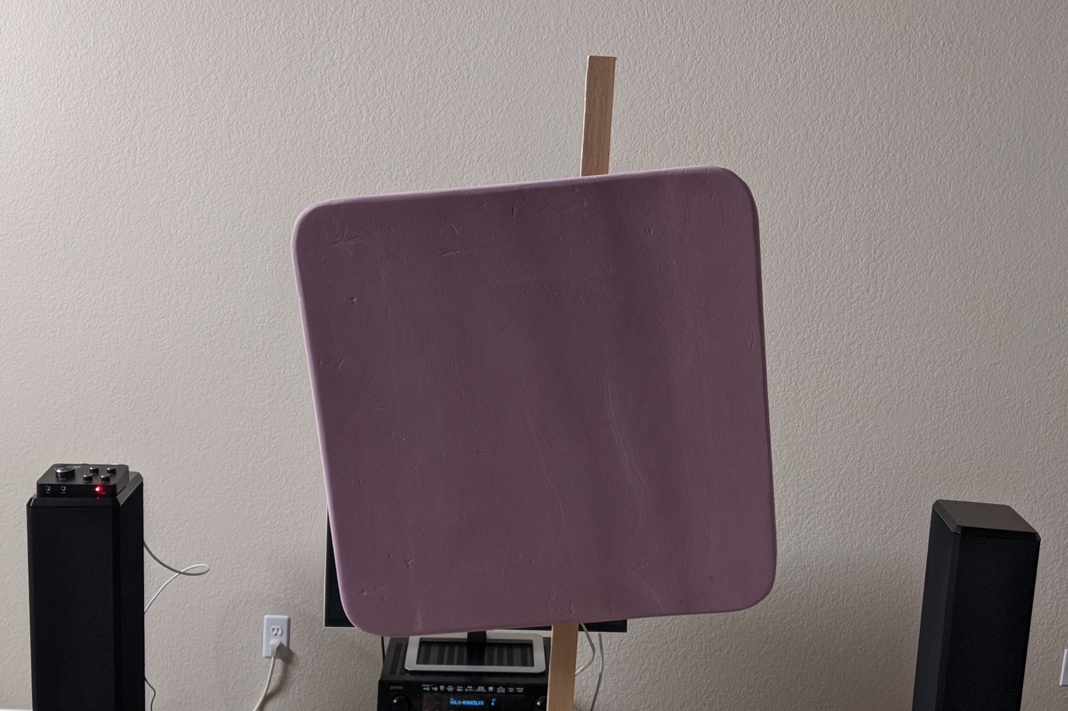

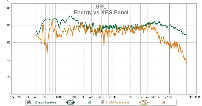

Recently built a DML panel and took some measurements and here are the results. For comparison I measured a traditional speaker in the same room and approximately similar spot. So we have something to compare against.
Setup details:
  • Dayton Audio UMM-6 USB microphone.
  • Traditional speaker used for comparison: Energy Audissey A2.2
  • Foamular 2’x2’ project panel, rounded and smoothed edges (layer of glue+water not applied). Exciter mounted on stand. No spline or support for the panel.

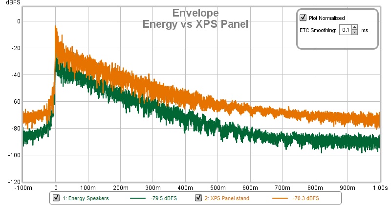

Comparing SPL graph between Energy speakers and XPS panel we see the XPS panels holds its own from 250Hz to 5KHz. Outside that region the response tapers off.
Looking at time domain graphs (ETC graph), we see that XPS panel has much more ringing. The impulse response graph also shows XPS panel not settling down as quickly as Energy Speakers.
Do any of you who have built a frame looked or posted ETC or Impulse response graphs? Would be good to see if frame helps in damping and improving the time domain characteristics.
