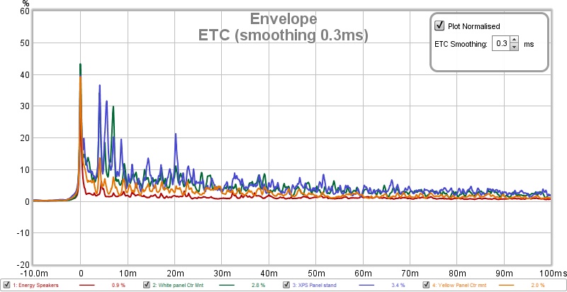

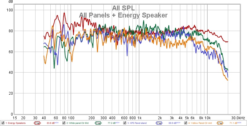

Agree with you that 1inch XPS is not ideal. But what is what is readily available. Have not yet found a source of thinner XPS material. I am in California.
The ECT and impuse response were not from a pulse test. They were generated from frequency sweep data by REW software.
I also tried out couple of other boards
Foam Board - 20" x 30" x 3/16" (yellow color)
Thick Foam Board - 20" x 30" x 7/16" (White color)
The thinner 3/16 board had best ETC graph among the boards. From that metric it should be better than XPS. I have attached the SPL and ETC graphs. The SPL has 1/48 smoothing, the ETC has 0.3ms smoothing.
How does the foam board sound compared to XPS? Looking for other peoples experiences.

Looks like the image attachments did not come through in my last post. Trying again.
Veleric.
I agree with you about foam core ,it is heavily damped by the paper .
Eps on on the other hand has no problem reaching 10k (1inch 70 grade) or 20k and beyond with the vh grade.

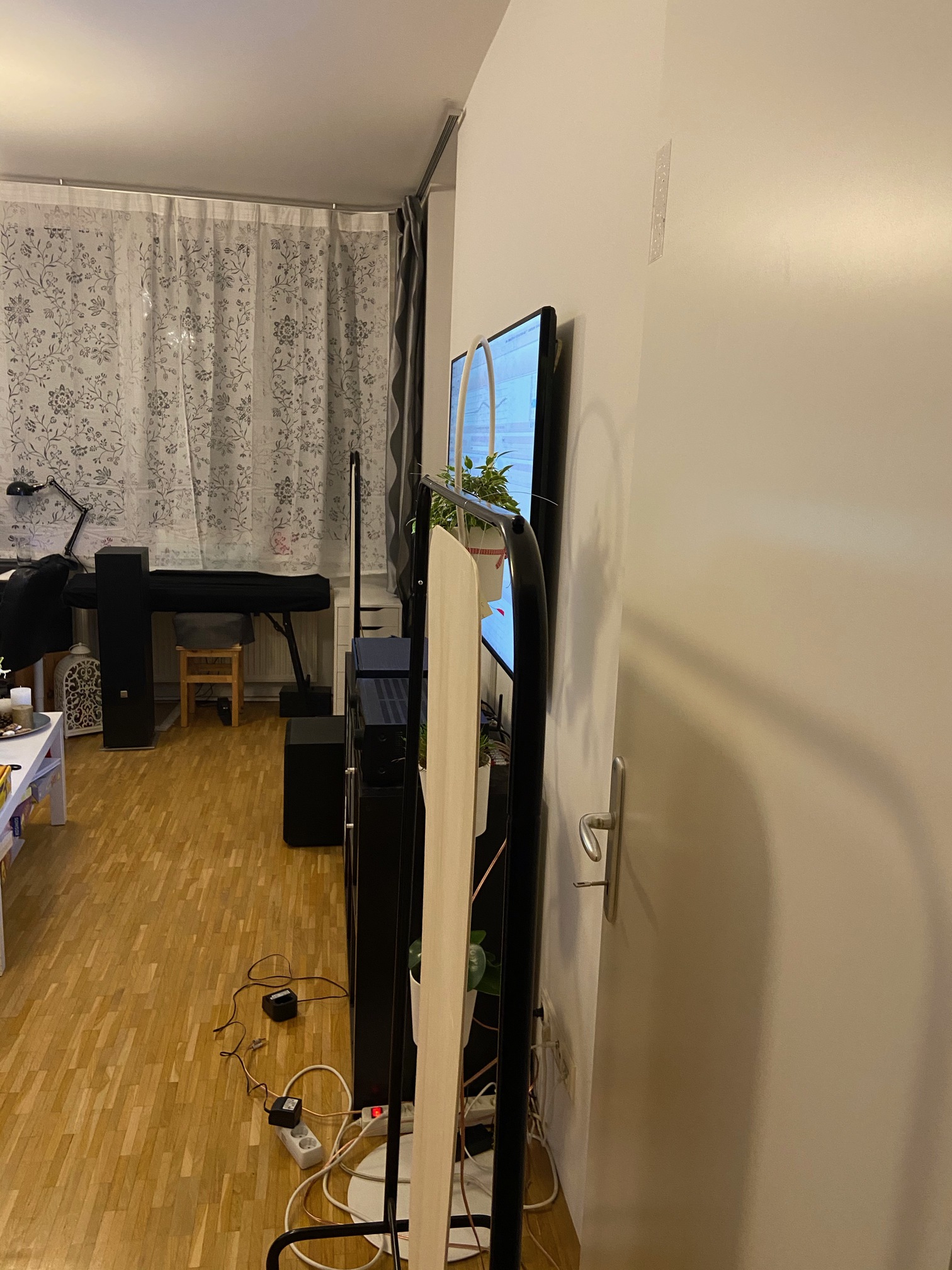

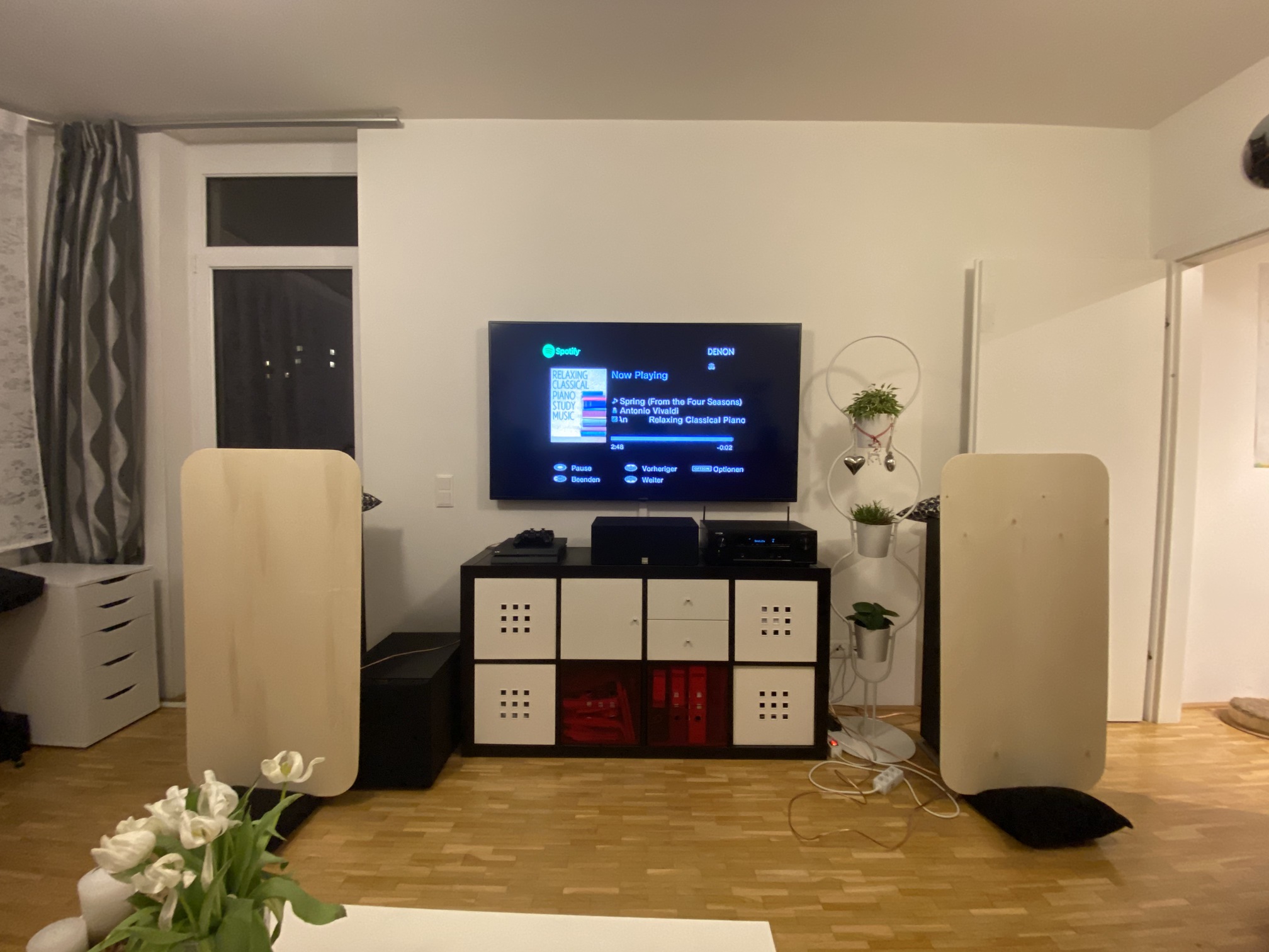

Hi Guys!
After seeing the T.I. video about a year ago I always wanted to build a pair of DMLs. So I was reading through all DML threads across different forums and now I'm here. 🙂
I started with 2 pairs so that I could compare them against each other:
- 1200x600x4mm poplar ply wood
- 1250x600x20mm XPS 300
As it was my first try I started with Dayton Audio DAEX25FHE-4 exciters. I sanded the XPS, rounded the corners and applied the 1:1 PVA glue / water mix (2 layers). The ply wood only got rounded corners, otherwise it was untreated. For exciter placement I've chosen the 2/5, 3/5 rule.

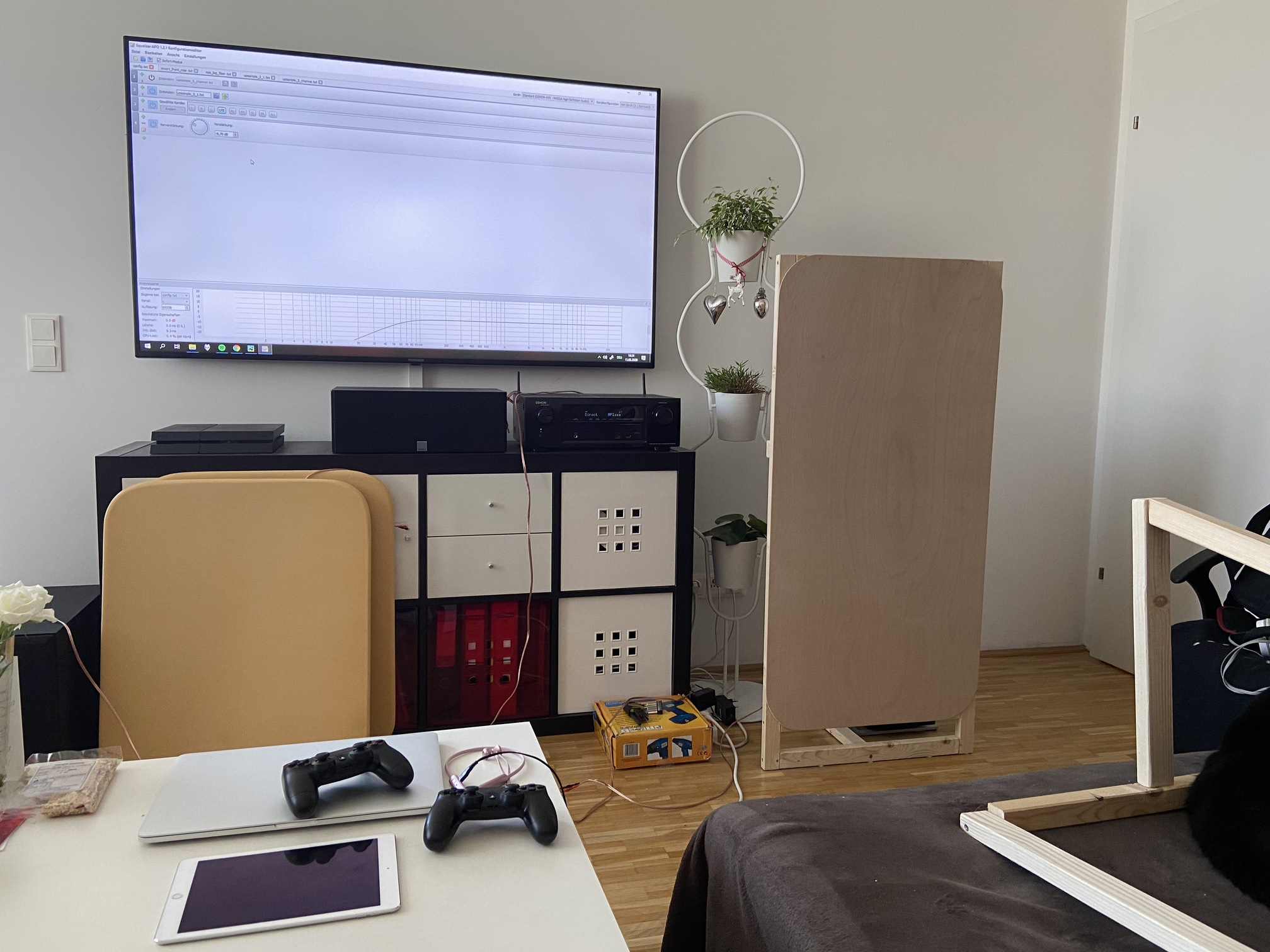

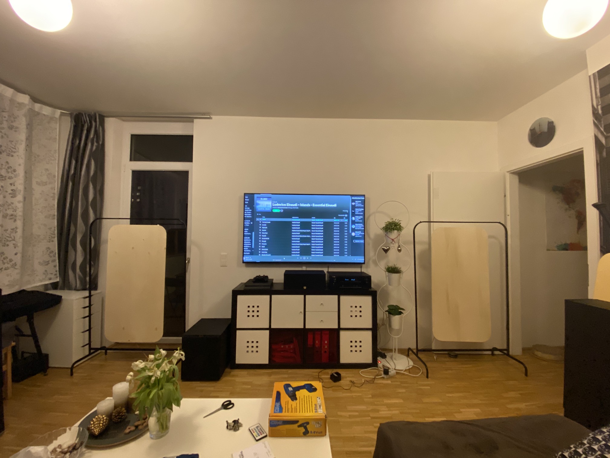

For my first listening test I've put them on pillows and leaned them towards another set of pillows on my tower speakers. So they were damped a bit and should not rattle.
First I tried the XPS. I hooked everything up, turned on the music and then........I was very disappointed. There was no lower end (as expected) but also no lower midrange (everything to about 200Hz seemed to be thin). Middle range seemed to be super dominant and highs were sharp.
So I tried the PLY and it was a bit better, but still having all the same issues just not that severe - but far far away from good HIFI sound.
After that I used my UMIK-1 and took some measurements. Unfortunately they are on my other PC where I don't have access to right now. But the measurements just showed what I've heard. So I EQed them first by ear and then using REW and it got better. But again, they were not even close to my small rear speakers, the Dali Zensor 1.
At this point I didn't want to give up and tried different speaker placements like hanging them from strings.
The XPS got worse but the plywood did a better job. As they were not anyhow damped they played quite a bit louder as well.

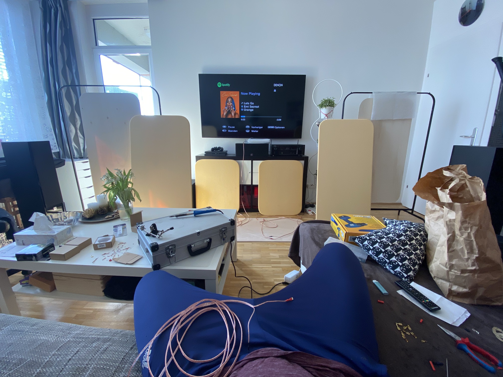

At this point I really wanted to try a different exciter with more punch, because I hoped to get a better low-end. So I ordered 4 more Dayton Audio DAEX32EP-4 Thrusters. As I read many many times that XPS works that well for many people I wanted to give it another try but using the proportions from the Dayton Audio exciter guide which says that the width should be 4/5 of the height. For the plywood I used the same dimensions but different wood. So the new pairs were:
- 1200x600x4mm beech ply wood
- 750x600x20mm XPS 300
The Thruster immediately had a better bottom end and I thought it was going into the right direction.

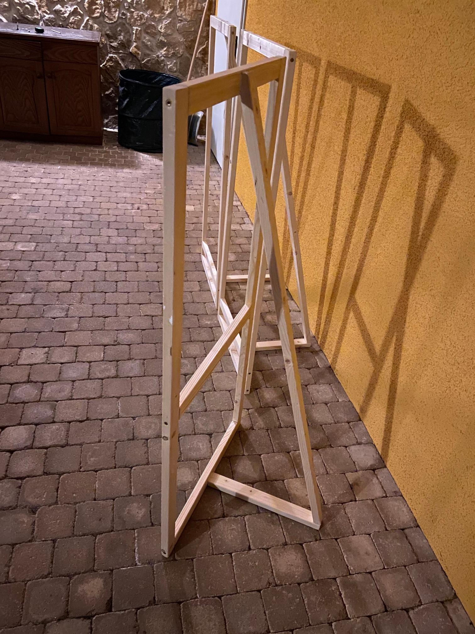

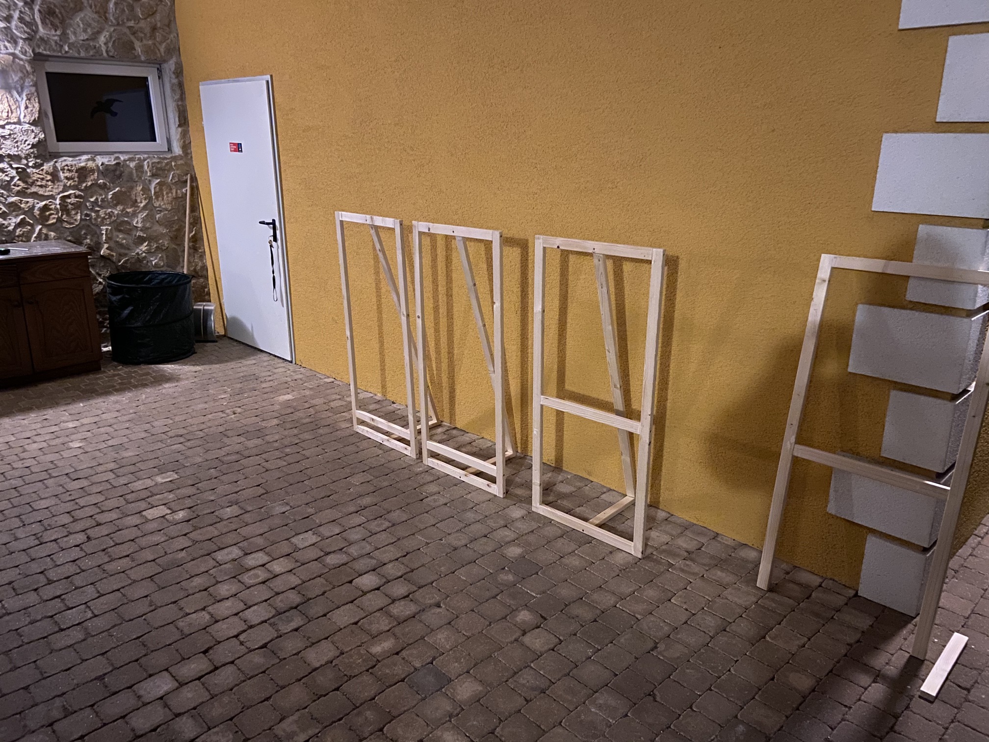

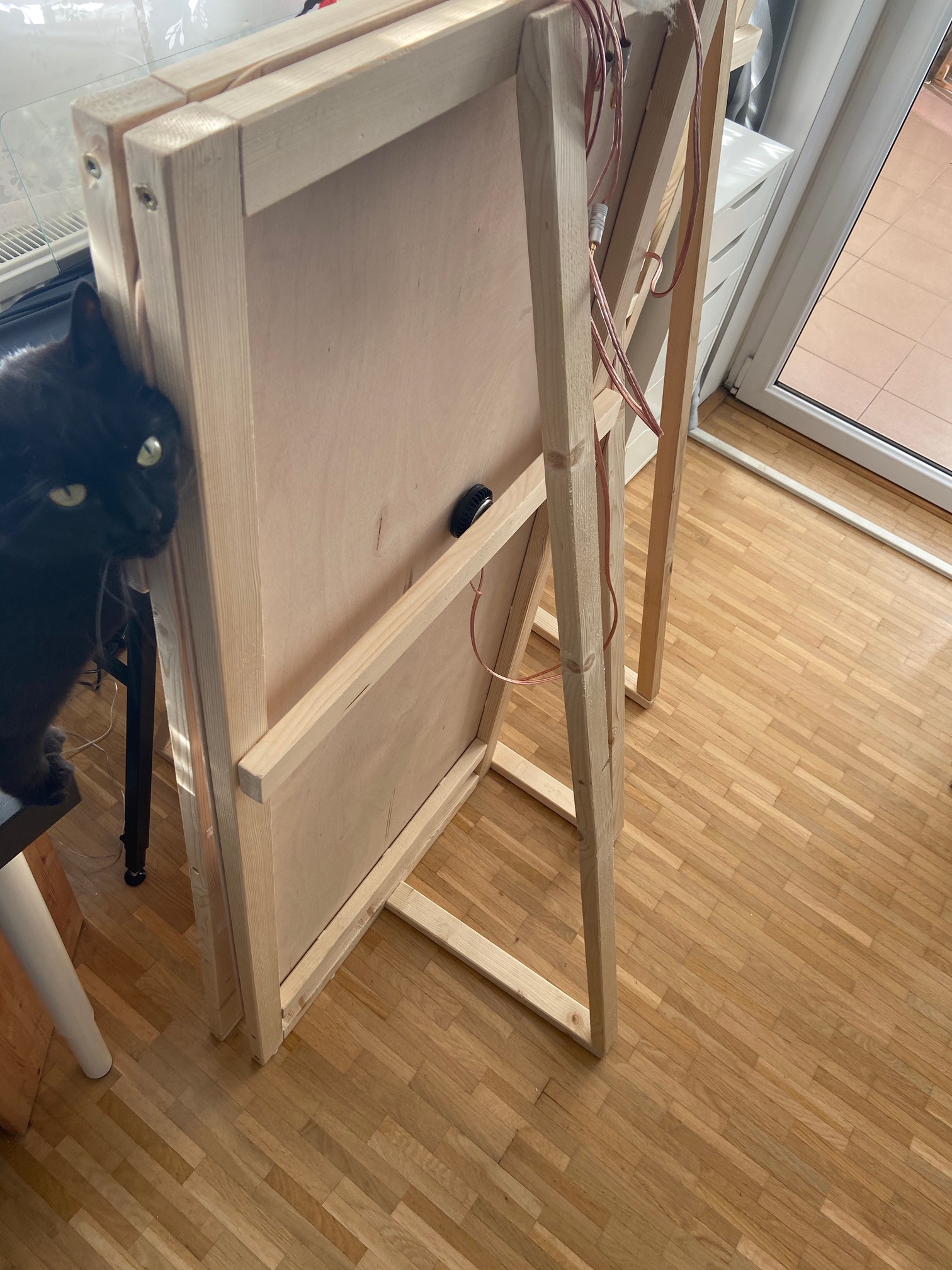

At this point I thought about supporting the panels, as it's something many people suggest. So I build frames with a spline and tried multiple different mounting methods of the panels to the frame. I built one frame for the small XPS panel and one for the plywood panels.
I tried 1mm, 3mm and 6mm double sided foam tape for the panels. I also tried to mount the small panel in a "free" way so it was held only by ducktape and foam within the frame. Unfortunately I didn't take any pictures of this experiment. The splines and exciters are/were attached either by double sided foam tape or hot glue.
Again, I was EQing them which helped a lot. I realized that I over damped the small XPS panel and it sounded weird. Softer and thicker foam adhesives were much better. But still, I preferred the sound of the ply panel. The difference between the beech and poplar is, that the beech is much heavier and harder, therefore I used the stronger Thruster exciter. On the softer poplar I have the smaller 25FHE-4.
So I removed the small XPS panel from the frame and mounted the poplar ply. But this time differently, top and bottom were not attached to the frame, only the 2 long sides. In general, I tried to use small strips so that it is not over-damped.
I also played them in series, so that I could have 4 panels playing at the same time. In that case I have 2x 1200x600 for the left and right channel. I'm also playing them together with a 12" sub, crossed at either 80 or 100Hz.
I was listening to it now for about 1 week and now I switched back to my main speakers for a comparison. I also have to say that I don't have really high end speakers. It's just a pair of Dali Zensor 7. I flattened them using REW to have a fair comparison. I turned them on and.....WOW. What a full and detailed sound. It may be my room and the speaker placement but I do get a big soundstage where the speakers "disappear", very good highs but then again, full lower midrange as well.
So I'm not sure if my expectations were too high or if I'm still doing something completely wrong but I just have to say that my cone speakers do sound simply much better.

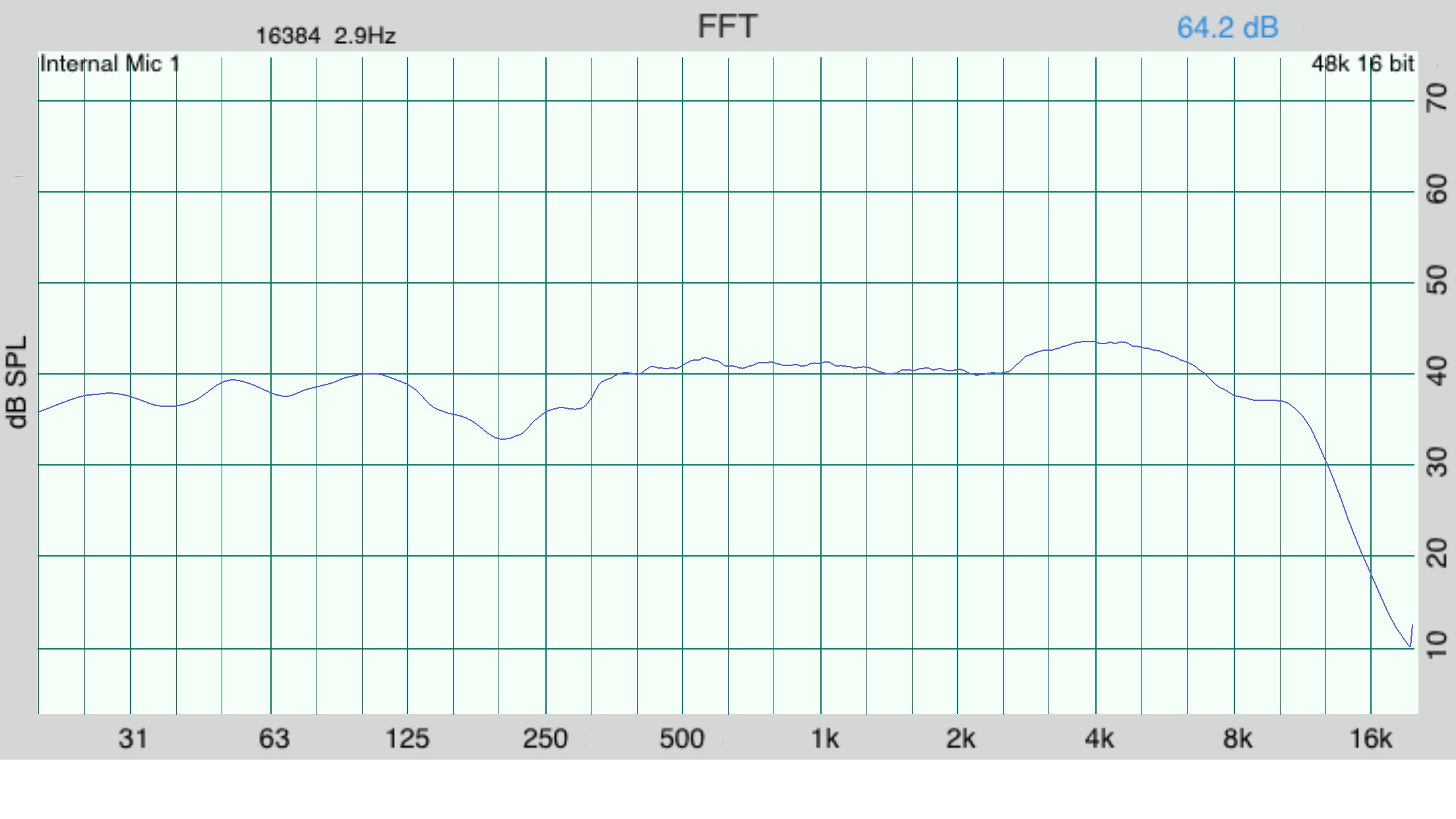

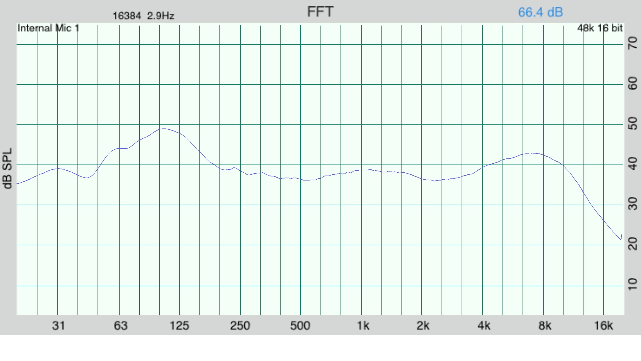

So does anybody really go for a DML instead of e.g. a 1K set of speakers??
Because my main goal is good sound, not the best sound for e.g. 100$. For the price I really have to say that they are not that bad but then again, that's not my main goal.
You might be interested in the image below. It shows the frequency response of the Bowers and Wilkins CM1 bookshelf speaker which retailed at the time for circa £600/$850. The response was measured in a normal sized room with the usual furnishings and drapes etc.
You will notice that the response is tailored to give a specific effect which makes it sound a particular way. The bass is given a boost from around 60Hz to 100Hz which is something that the BBC found helped small bookshelf monitors in the bass department. There is also a very slight rise from around 3kHz to 8kHz which improves presence.
All commercial speakers have tailored responses that give them a characteristic voice and speaker manufacturers have got very good at voicing their speakers to appeal to consumers expectations.
I find as a rule Ply DML's measure pretty flat.
