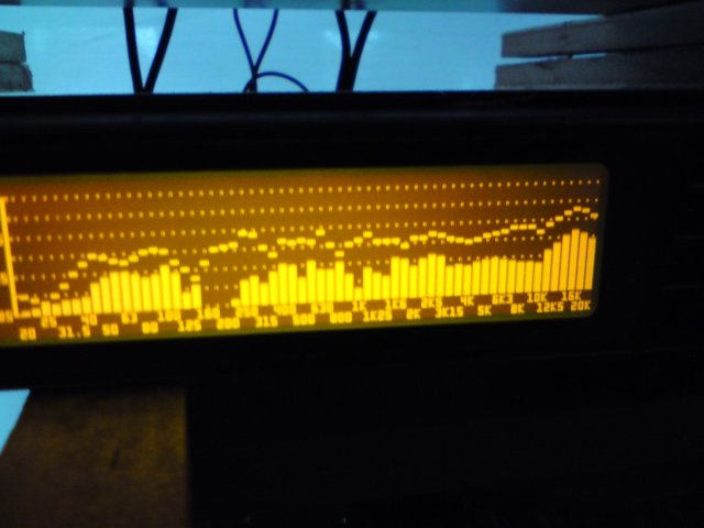

This is a plot of a 3mm ply panel I posted over on NXT Rubbish about 15 years ago.
You can see the rising response in the hf and the hump above 10k.
The thin dots are the response from the front of the panel. The lower thick bars are the response from a side angle of the panel.
The hump above 10k is still there ,but obviously everything is at a lower level.

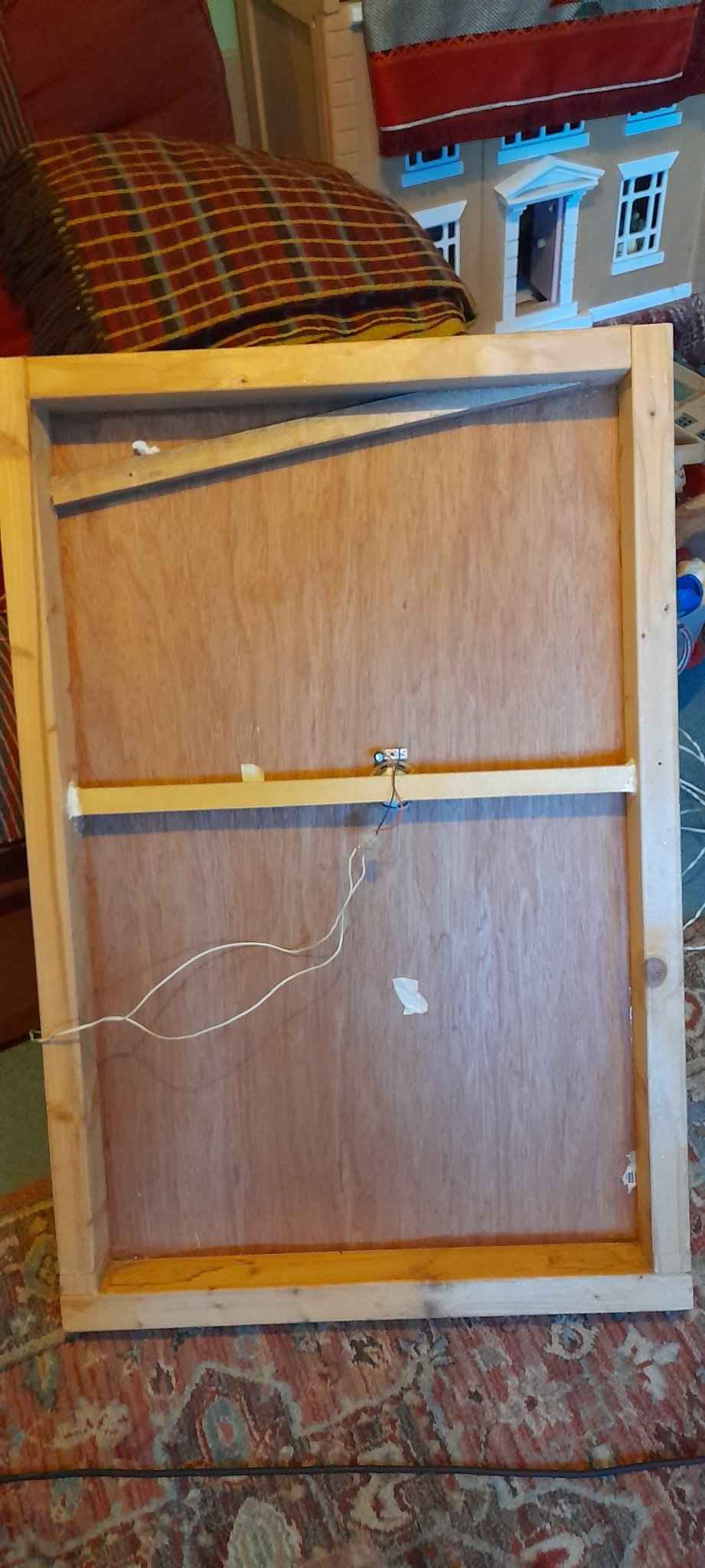

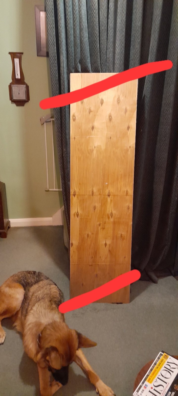

Also if using tall panels of ply, I would recommend either cutting the panel or using braces in the positions shown in this picture.
This prevents the build up of low frequency resonances causing a low frequency drum effect.
I used a large vice to clamp two solid pieces of wood at an angle, this was enough to support the panel with no other mounting needed.
I also used braces on my rigidly mounted 2x3ft 3mm ply panels.
Steve.
