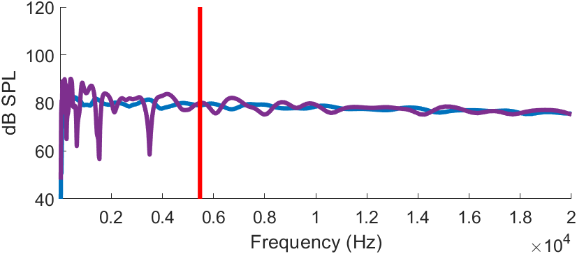

Interesting Steve- The attached FR graph shows a 900x600x3mm ply panel (can't go above 1m with the software at present) with both SSSS and CCCC mounting (blue is free, purple rigid) and a 5W input. PeTTaLS doesn't reflect an increase in volume beyond 1kHz, with a very lumpy response below that. The same goes for 10W input.Eric has noted that his foam mounting increases the low frequencies but rigid mounting increases the sound of the whole panel frequency response as shown in my posts of the panel responses.
Eucy

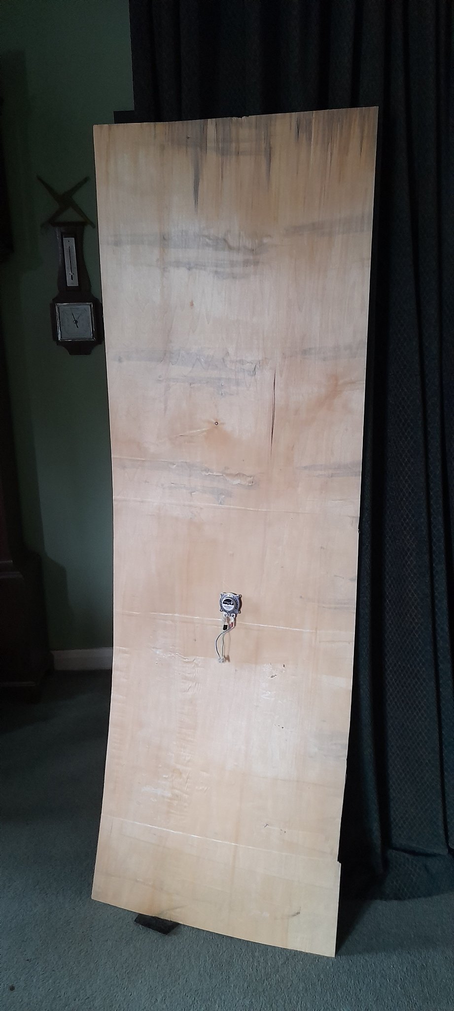

I am probably not the best person to guide you on ply panels as they are not my favourite material."rigidly mounted" meaning screwing the plywood directly to the frame here? Is this the setup you're talking about?
I think I will get some thinner plywood (mine is currently a 2' by 4' sheet of 1/4 inch thick, which is too big and heavy I think) and I'd like your tips on building the best ply panel I can.
1/4 inch is a little thick for a dml panel, my 10watt exciters would have trouble driving it.
The more robust Aliexpress exciters I believe drive thick panels better.
I have the 5mm panel with an Ali express exciter attached, I could post this also on YouTube if you wish to have a look and listen .
Steve.
Trenth.

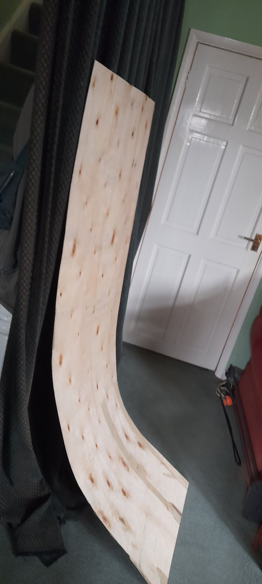

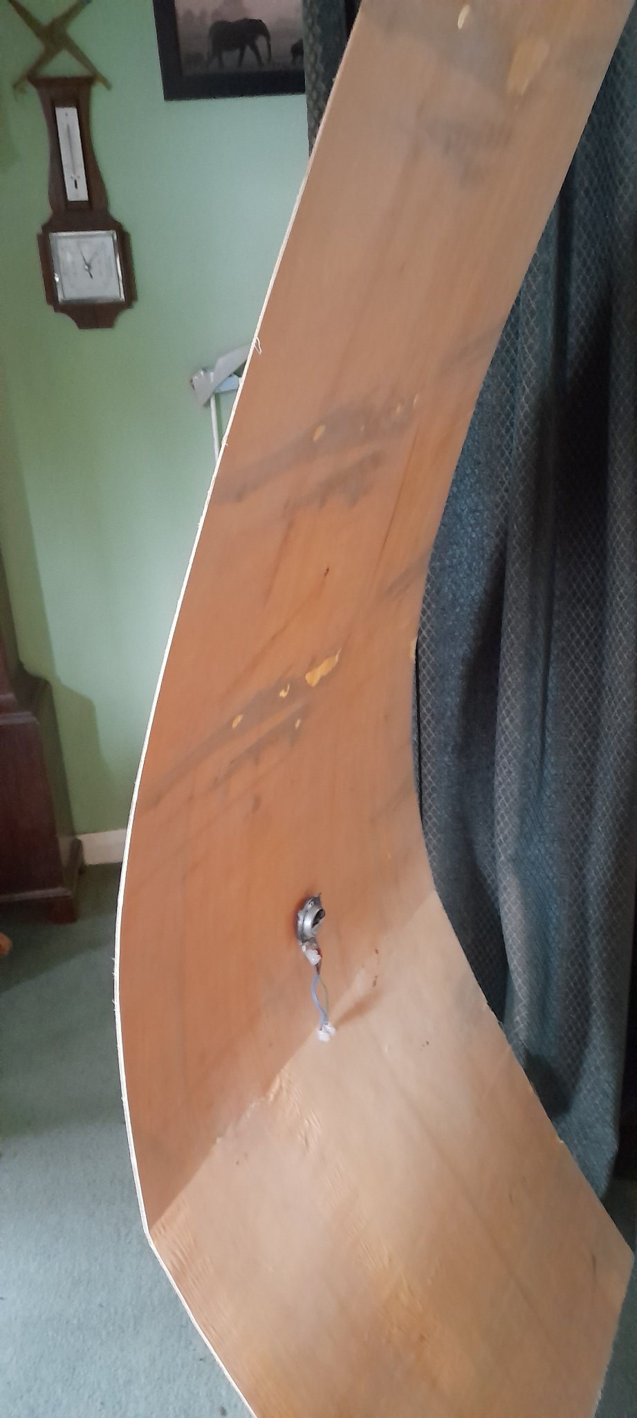

I just remembered a very thin 1.5mm 6ft x 2ft offcut that I demonstrated to Christian on a WhatsApp video.
It was a 2ply with both grains going down the panel length.
It could not support itself properly.
But I did make a couple of good recordings of them.
I was very impressed with the sound of this panel.
So I do , come to think of it, actually like the sound of very flexible ply panels.
They have a very lively horn loaded sound to them, unlike the 5mm ply panels.
I even bent them over into a dome while I was playing music, the trouble was that I over did it and it split 😃
This was me just playing around with different materials.
I Don't think I can send the videos to youtube because of copyright .
Sorry.
Steve.

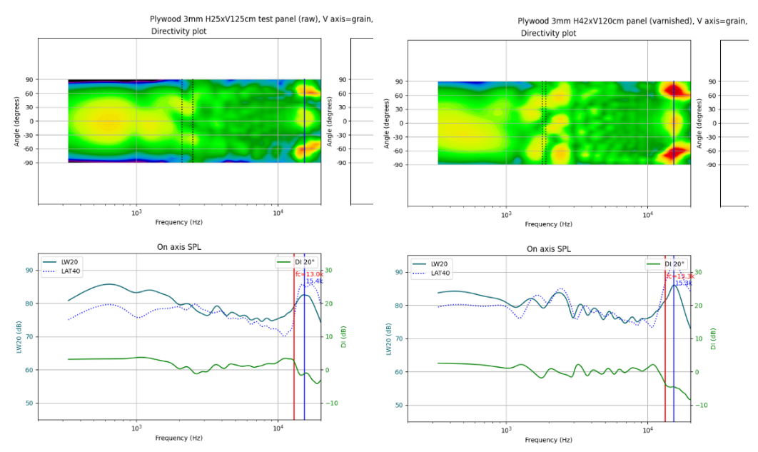

Below are extracts of my paper about directivity showing the plot of the different plywood I tested.Hello Trenth.

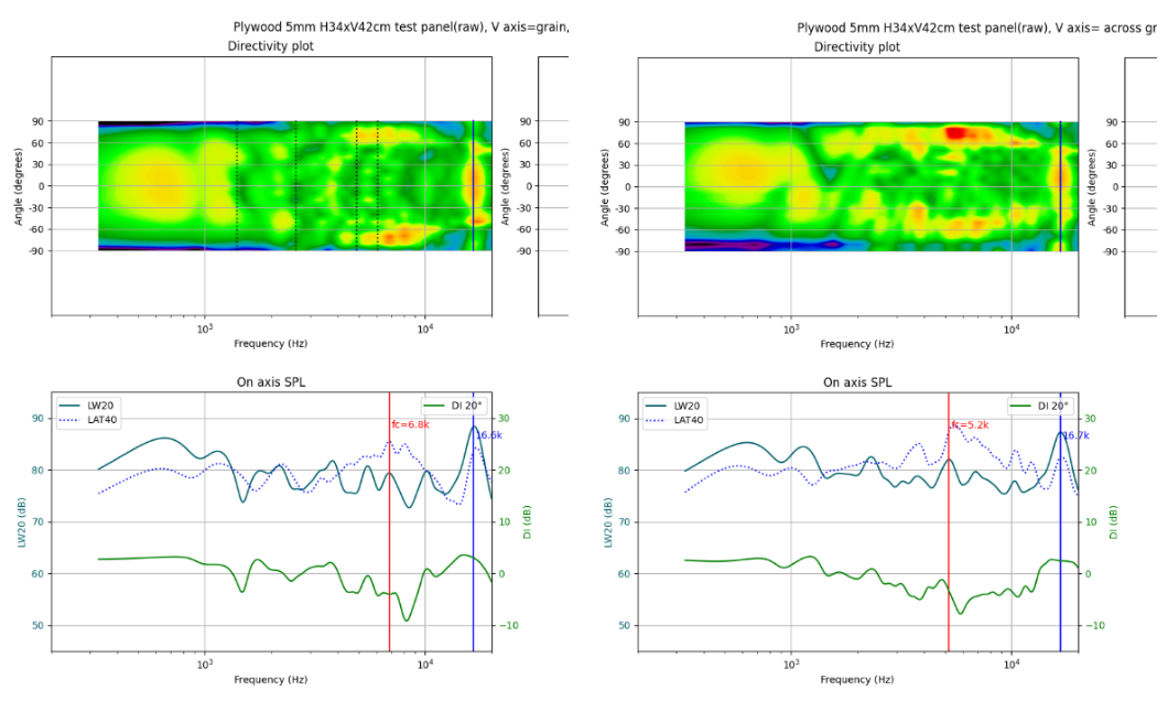

First is 5mm in both directions, along and across the grain. A strong radiation in all directions is visible but much above 10k
Below are 2 different 3mm poplar plywood, both across the grain. A peak is here also but with less level around 45°.

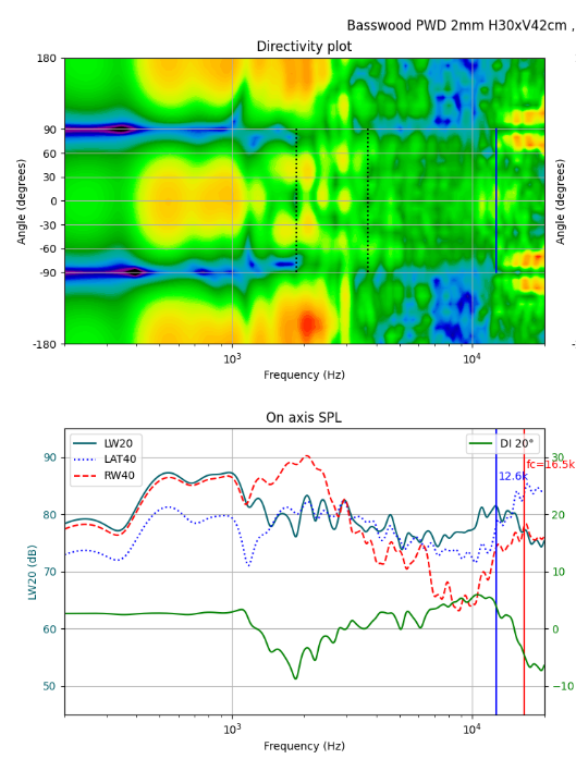

Next is a 2mm basswood. The peak is lower
It might be in the family of what you have detected.
Christian

So orange to red areas show peaks according frequency and direction of radiation.
The 5mm and 3mm plywood were not measured from the rear side so the plots stop at 90° (full left and right).
Maybe I should have remove the plot below. The curve LW20 is the average value of +/-20° window so almost the on axis.
Christian
PS : the 2mm measurement was probably "corrupted" by a too large spine... which would explain it is not as smoothed as the 3mm on the left. It is something I understood after those measurements. The 3mm on the right is from my current plywood panel with a full foam surrounding suspension.
Finally, I just managed to upload pictures of my 1.5mm panel.
I am still having problems uploading pictures.
In the last photo you can clearly see the split (crack) in the panel created by over bending the panel.
I picked this up free from my local DIY store .
It is probably the inner core of a ply panel that was used for packaging.
Steve.
Steve.
I went mad and posted the 1.5 mm panel I recorded for Christian, I'd look quick as it could be copyright protected!.
Listen using good headphones.
Steve.
Steve.

Thanks Steve, for sharing. As a matter of interest - you experiment with such a diverse collection of different panel materials and sizes - how do you determine the exciter position for each panel?
So, is a more desirable full-range panel one with a balance of red and blue areas?
These make sense, the biggest weakness of my current 1/4 inch panels are the highs for sure - they have decent low end actually but seem to seriously lack body and the sparkle. I will do a thinner speaker setup soon.
Also, that wider panel appears to have a greater range of SPL, can I interpret this as being more balanced?

JohnnoG.
It would be nice to have a clear material like glass but without its weight and rigidity.
Glass is too rigid.
The two sheets of veneer that make up the panel I have shown on YouTube run in the Same direction, so it is more rigid in its length than across.
Which helps it stand up by itself, a little.
I was ment to cut this into smaller panels, but never got around to it.
It was a nice surprise that the large panel worked so well.
Steve.
