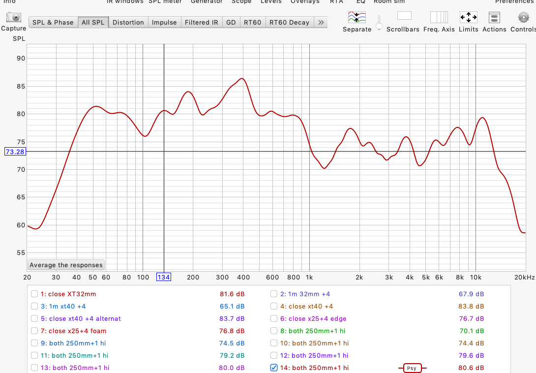

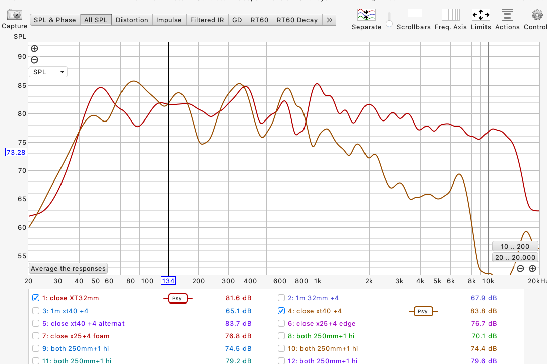

I received a couple of XTB40-8's and some XT25's today, I didn't have much time to play with them but did a quick test on an HD Eps panel I had.
The panel is approx 12mm thick HD EPS 600/400mm, I had tuned it with a couple of weights for the XT32 I had on it. It is suspended in a frame with 30/3mm foam tape around 3/4 of the edge, corners free. Around a 5mm gap to the frame. I removed the weights when I added the XTB40.
The XTB40 definitely falls off above 1khz then very steeply from 7khz. There is good bass to mid 40's but not noticeably more than the XT32 on the same panel, it will be interesting to see if it can handle more power and play louder without strain once I run it with the dsp crossover. The panel needs some work as there is suspension noise when it's turned up very loud and the bass is more extreme.
Below are some quick dirty bench close mic measurements comparing XTB40 with the XT32. I didn't have time to try different positions but will in the future.
I also added the XT25 with a capacitor high pass near the edge to try them together, this is measured on the bench from 250mm. Second screenshot.
I think this could work quite well with a little tweaking and tuning.
