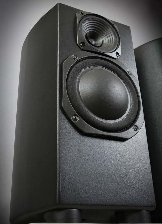

A flat panel is a different kind of beast, so the software designed for testing cone speakers has no understanding of how a flat panel should sound.In this case, FR at the listening distance would help to understand the difference between both while some proximity measurements (few centimeters from the panel at the exciter position, a second one at the vent) would help to understand what happens in the bass, if the bass reflex is correctly tuned.
I'm not at all interested in any kind of measurements, especially at a 1-meter distance. After all, everyone has different ears. Attaching an exciter or a few of them to a flat panel is an easy task, but finding something aesthetically pleasing is the challenging part, especially when one doesn't have (m)any rooms available for listening. One can cut all kinds of panels to various sizes, hang them on strings, frame them, etc., and this has been happening for over a decade, yet we are still at that early stage.Be ready to make different dedicated measurements.
Anyway, here's an image of handmade speaker drivers in a handmade speaker box, created by a certain specialist in another country. The mid/bass speaker membrane is actually convex, while the tweeter cum mid cone is concave. This tells that a membrane doesn't need to be terribly massive to produce good sound, and it doesn't have to be concave, let alone flat. (No, I have not heard them, but I can believe those who have. No measurements are available.) All I know is that they are made of paper and painted.

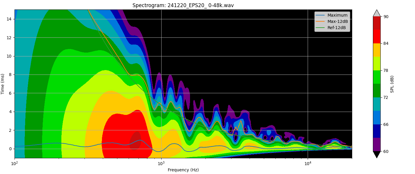

Hi Dave,It is low-Q (e.g. internal damping is very high), which makes it sound good with vocals, but it's going to sound "dead" with most music.
Is there a less subjective description of the kind of response would sound "dead"? That is, lacking of some particular frequency range, or other measureable characteristic? And can you explain why low-Q would result in that? Like Christian asked, I would be interested to know what you think of as the optimum range for Q.

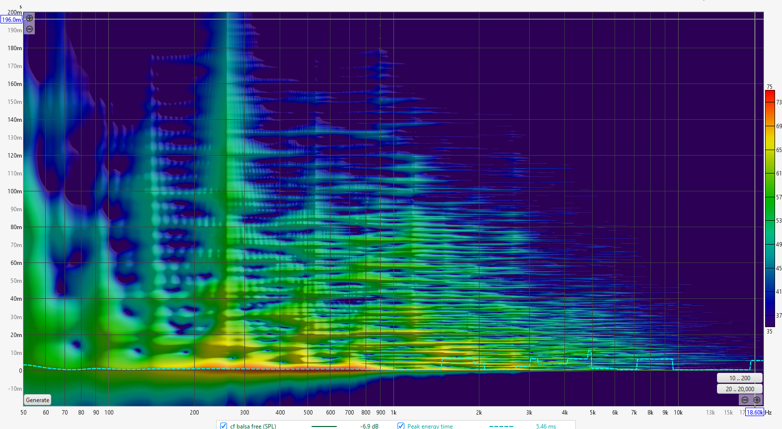

@homeswinghome @Veleric OK, I finally got around to posting a new video, it should be available here. I tried to keep the discussion to material parameters and Q factors. I'll be posting more videos as time permits!
I don't have any precise answers about material Q factors. The idea that a material has one Q value is an oversimplification, as Q tends to be frequency dependent and is based on a large number of effects and factors. As I'm sure you all know, adding extra damping at the panel edges can affect the Q value of the peaks in the response as well. DMLs are unique because they use resonances to recreate sound as compared with a traditional loudspeaker, which is largely resonance-less (besides cone breakup!).
In my experience, low-Q devices materials well as small panels, and high-Q materials work well as large panels with free edges, when the audio range entirely avoids the region of low modal overlap (where there are sharp, isolated peaks). It's very subjective, though, and that's part of the fun of these things!

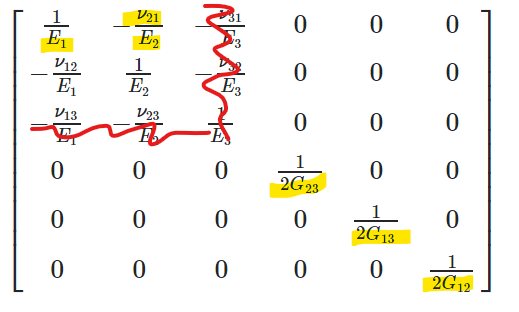

1. For the material properties inputs, and especially the sandwich panels, I renew my suggestion to have the option to use an orthotropic Mindlen *(thick plate) model, where users would input their own set of material properties. For sandwich panels, there is no way for you to anticipate all the material combinations someone might want to try. You can test a few and add them, but you can't really even specify "posterboard" as a particular set of elastic properties, because for every thickness the apparent elastic properties will be different. I suggest putting the burden on the user to know or measure the properties of any material they want to input (other than a simple set of isotropic materials like you already have). Everything else could be described by input of the elastic constants. For an orthotropic plate one would need the six highlighted independant properties here:
I have already shared a methodology using equipment most of us have (REW), that allows deterimination of all of these with the exception of G23 and G13. But those can be simply estimated as the values of the G23 and G13 of the core material, which can often be looked up or guessed at. Also, I believe this treatment would eliminate the need to add the artifice of a sharp transition between a frequency dependant wave speed and a constant one, which you described in the video. In my mind, that "transition point" is a pure guess. With a "thick plate" formulation of the plate equations, the two shear (G23 and G13) will automatically (I believe) flatten the wave speed function appropriately. I fear my explanation is poor, but I'm sure you have a contact in Engineering Mechanics that can confirm (or refute!) this idea.

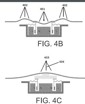

For those who are still interested in "slapping" an exciter onto a panel, there are still individuals writing patents. Here is one of them. It's quite recent, having been granted in 2021.
"Typical electrodynamic force actuators are designed with a cylindrical voice coil, the top surface of which has an adhesive material applied to it so that it may be bonded to the object to which the vibrational force is to be applied. The contact area between the force exciter and the panel is annular in typical applications. A problem with this configuration is that at high frequencies, the area of the panel within the force actuator's annular contact area may vibrate out of phase with the panel area outside the exciter's annular contact area. This occurs at the resonant frequency of the first “drum head” mode of the panel area within the annular contact region. Under these conditions, and due to the phase reversal between the vibrating region within the annular contact area and the panel area outside the contact annulus, the net acceleration of the panel, when integrated over the entire panel area, decreases noticeably. ..."
Hello LekhaFor those who are still interested in "slapping" an exciter onto a panel, there are still individuals writing patents. Here is one of them. It's quite recent, having been granted in 2021.
I think I fall in this category. I have some tests ongoing with this idea and the idea to reduce the cavity noise. This interface and patent was introduced here some posts ago ( see 13102 ) by @HvdZ and by Dave

Hello Dave,@homeswinghome @Veleric OK, I finally got around to posting a new video, it should be available here. I tried to keep the discussion to material parameters and Q factors. I'll be posting more videos as time permits!
Thank you for this new video. It gives a first idea of what could be a Q range. Acrylic with a Q of 8 is among the dead material, aluminum at 40 is much too ringing. So maybe a range 5 to 20 is already too wide.
It is interesting to see how the speaker changes from DML (there are modes) to a bending wave driver (low Q, no modes) with the reduction of the emission area when the frequency increases.
