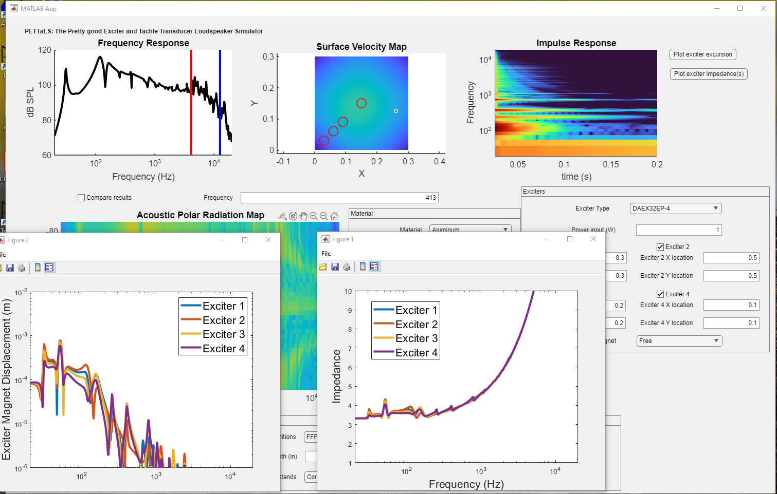

In response to the great feedback from @Veleric, @homeswinghome, and @Eucyblues99 - here's a screenshot of some updates. I redid the code so that the IR is shown as a spectrogram (not CWT, yet, but I can add that in the future too). I also figured out how to calculate two (very related) things... exciter impedance and exciter magnet displacement. I doubt anyone cares much about magnet displacement besides me, but there was one company that had a real issue with the magnet whacking against the plate at a certain frequency, and we had to determine where that was to filter it out effectively. Usually that frequency where the magnet is moving like crazy is one where you don't get much acoustic power output anyway, so it's usually worth filtering out.

Dave,In response to the great feedback from @Veleric, @homeswinghome, and @Eucyblues99 - here's a screenshot of some updates. I redid the code so that the IR is shown as a spectrogram (not CWT, yet, but I can add that in the future too).
That's great stuff. I do like the new spectrogram. What does CWT mean? I'm really glad to see the impedance plot, and the magnet displacement is also of some value, because, yeah, it can start slapping the board. For "final" builds I usually use a spine support for the magnet, which eliminates that issue without any apparent detrimental effect for my usual designs (where the panel fundamental is well above the magnet resonance). But I'm interested to use the model to see what it says about the effects of a spine are with more varied designs.
I'm glad to hear that you are excited about anisotropic materials. From my perspective, one of the most interesting aspects of designing flat panels is trying to tailor the elastic properties and density of the panel to optimize performance, so that pretty much requires sandwich structures. I'm eager to hear more about your current sandwich model. I'll mention again that I suspect the transition from the frequency dependent wave speed to frequency independent wave speed can be handled "seamlessly" by an orthotropic thick plate model, where the three shear moduli are used as inputs.I'm very happy and excited to work more on integrating anisotropic and non-homogeneous materials into this model, but it'll probably take time to verify that everything works. I'll post again later today when I'm in my lab about how I'm modeling the sandwich boards
One other suggestion that occurred to me is that it would be nice if the acoustic response plot and the polar radiation plots were aligned directly above and below each other with the frequency scales matching. It would then be more obvious how the features of each line up with each other. For example, how the region of sharply spreading directivity in the polar plot aligns with the coincidence frequency in the acoustic response plot. Also, it would be interesting to see clearly which peaks in the acoustic response are responsible for each of the "lobed" frequencies in the polar response.

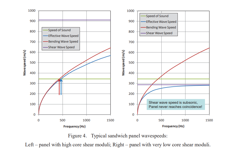

Also, in your reply on YouTube you mentioned your somewhat anomalous results for posterboard, you wrote:
These simulations tend to be tricky for non-isotropic materials like cardboard or posterboard. For example, I published some comparisons between measurement and simulation here (https://acoustics.org/how-to-find-the-best-material-for-making-exciter-based-plate-speakers/) showing how weird posterboard acts. Posterboard simulations are very accurate at low frequencies, and very inaccurate at high frequencies. I'll have to do more research into how to best model that - maybe a frequency-dependent Young's modulus or something along those lines.
The usual rationalization (on this forum) is that when the panel is too "soft" (like posterboard may be) we envision the exciter sinking into the panel at high frequency rather than driving it as it should. But I wonder if the real cause might be the low shear modulus of the foam core. As you probably know, at high frequencies the speed of bending waves is limited by the shear modulus of the core, as Stephen Hambric shows (below). So an isotropic panel and composite panel of the same stiffness and areal density might behave the same at low frequency, but not high frequency. I'm thinking that the lower wave speed in the posterboard composite at high frequencies could be reason it doesn't model accurately at high frequencies, if your model doesn't take that into account. What do you think?
Eric
https://www.hambricacoustics.com/IN16_5_Hambric_rev1.pdf

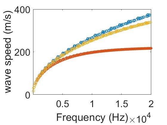

Using this earlier post as inspiration, here's a graph of the wavespeed in my gator board PETTaLS simulation with two different cutoff frequencies (which roughly defines the "corner" where the model becomes primarily nondispersive). Blue line is cutoff=infinity, yellow line is cutoff=20kHz, red line is cutoff=4kHz. I'm sure the "thick plate" model is a better fit, but this might work okay for the time being!
