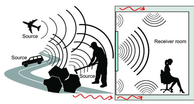

Not you? See picture belowLike the footsteps in the corridor or the cries of a child on the floor above? Do you think the concrete floors or brick walls vibrate in such a way that the air can move? Or the sounds of cars travelling on the street somewhere out of sight?

He, he, my fellow countryman! How lovely!Not you? See picture below

But I only live here. 🙂
In any case, sound is energy, not merely a variation in pressure. It can be used as a weapon.
If you want to move beyond the standard cone design, then you need to abandon the idea of "pushing the air," as well as Henry Azima's incorrect interpretation of "bending waves." Regarding the drawing you posted, people can certainly create drawings...
