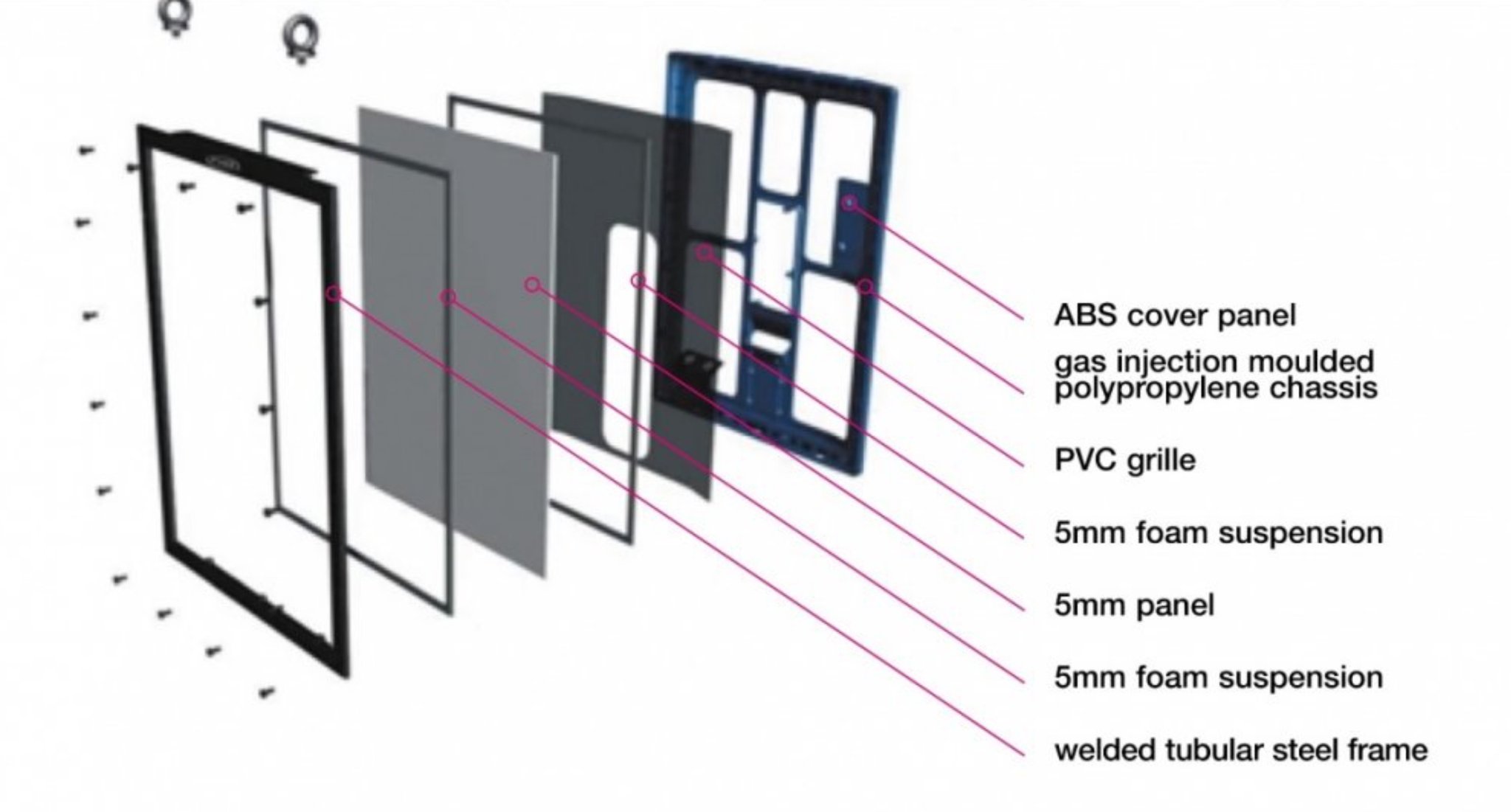

I believe those NXT speakers were manufactured in the early 2000s. I'm sure @spedge is quite knowledgeable about the NXT panels produced by those companies.Steve preferred one is the round flutes one.
By the way, these people (in the video) attempted to sell DMLs more than a decade ago, but now they are offering something quite different. Here’s what they aimed to sell around 2012...
I have no idea whether they sold anything. Perhaps those in the UK might have come across some of their products.
Thank you Christian for pointing out my preference for the round flueted panels.That's all quite nice, but can we truly hear what the microphone captures or what the software calculates for us?
It’s quite difficult to comprehend how such two corrugated pieces of aluminium foil can produce such a beautiful and engaging sound. Although the song is in Russian and you may not understand the lyrics, the emphasis is on the sound itself rather than the words.
This video was recorded using an ordinary mobile phone available in that region of the world, yet the sound produced by these corrugated pieces on the flattened coil is truly remarkable. (It is best experienced through earphones.) By the way, the individual who uploaded the video possesses considerable knowledge of various types of excellent audio equipment.
View attachment 1406250View attachment 1406254
Oh, by the way, the NXT panels were cut at an angle. They were crafted from corrugated double-sided plastic material, which is sometimes used by @spedge In other words, the corrugations were not parallel to the vertical sides.

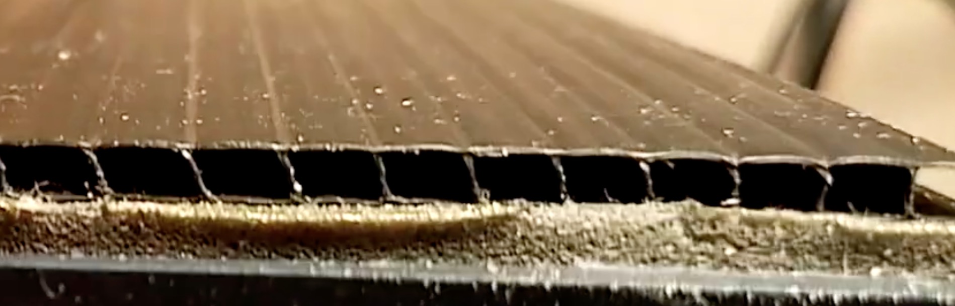

I have compared the square fluted panel to the round flueted panel.
The problem with the square fluted panel, I believe, is shown quite well in the photos in lekha's post.
The flutes are never perfectly square.
They are always distorted and warped in some way.
The walls are very thin and usually bent, which will cause them to buckle and bend and probably vibrate under drive from an exciter.
The round flueted panel has very strong and rigid flutes that do not warp .
Smaller thinner round flueted panels could probably be 3D printed for better efficiency, as the panels I was given by JohnnoG only go down to about 6mm thickness which makes them about the same efficiency as a 3mm ply.
The sound from the 6mm round flueted panel is far cleaner than the sound from the square flutes.
But not as efficient.
Steve.

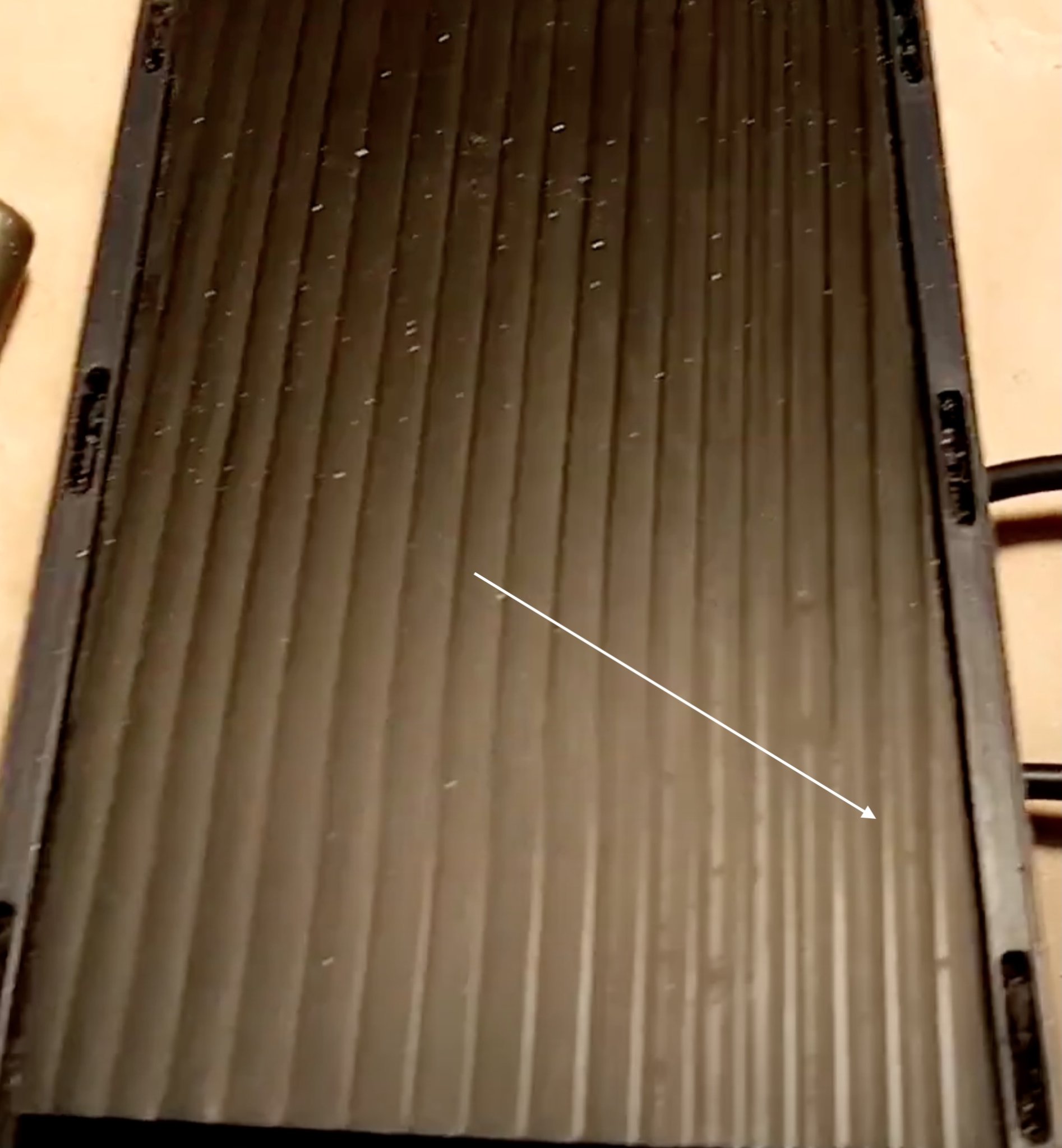

It is true that the round flutes contribute to the stiffness of the panel. Additionally, there is a certain amount of filling between the round flutes and the two surfaces, which could potentially distort the sound, someone said, indicating that it "might" have an effect.I have compared the square fluted panel to the round flueted panel.
Regarding those somewhat angled "flutes," someone mentioned that there are cells between the top and bottom layers, and that this emptiness contributes to the sound. Each cell (flute) has its own unique voice, and when they are all uniform, it creates a choir-like effect. Moreover, the larger the radiation area, the more pronounced the sound becomes.
It appears that, even in honeycomb panels, there are enclosed cells present, and these contribute to the overall sound emitted by the panel. We have been steadfastly ignoring those enclosed cells and the potential impact they may have.
