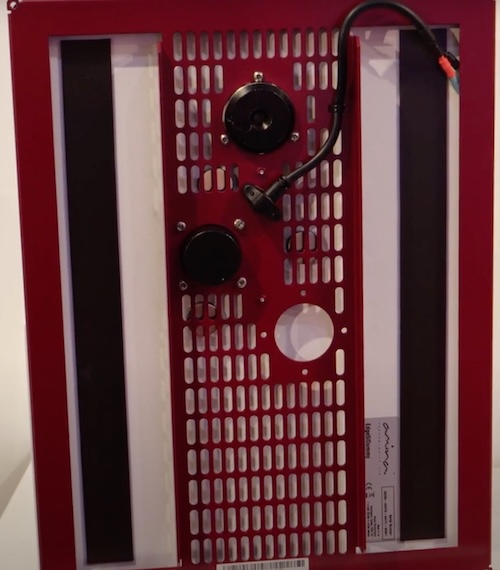

Interestingly the cedia panel uses at least 9 weights for their panels.Here’s the Russian perspective on the sound produced from about two years ago. A musician of some sort is testing those speakers. You might notice two "exciters" and some kind of object on top of the exciter area, possibly covering something. They were exploring @spedge 's beer can ideas? 🙂
Subtitles are available
And, Richard Newlove speaking at CEDIA 5 years ago.
I wonder if they take into account the mounting on the wall and how that would change the reflections?
Steve.
They are actually Amina panels.Interestingly the cedia panel uses at least 9 weights for their panels.
Steve.
The weights...
It just looks to me that they have stuck some black mastic inside the coil area, similar to what I did many years ago.Here’s the Russian perspective on the sound produced from about two years ago. A musician of some sort is testing those speakers. You might notice two "exciters" and some kind of object on top of the exciter area, possibly covering something. They were exploring @spedge 's beer can ideas? 🙂

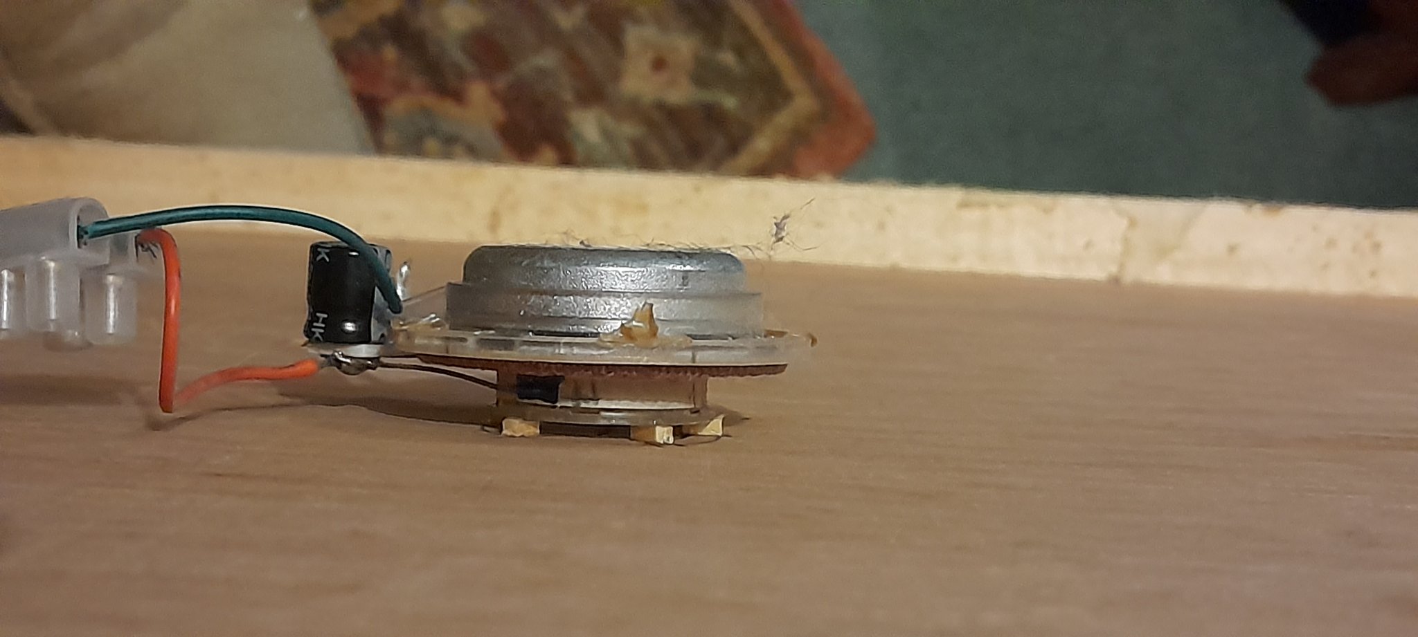

The 3k peak could be the cavity resonance, try measuring the exciter from the back to see if it is still there.I tried a few things that people are proposing, because I have a peak at about 3kHz that I want to get rid of. I tried to damp the center point, put little weight on it, make a hole but it only seems to lessen the mid/high freq output, and leaving the peak intact (although on a different freq?).
I tried this stiffening (made a 3d printed cone like the amina solution). Doesn't seem to have benefits for my panel. Only the high freq seems to be dampened....
I think the disk should provide more high freq output (like the Spedge beer can solution that works really well!), and the damper is used to tame the effect down a bit? The center of the panel is working pistonic and the rest dml?
I try "solutions" I see on the internet because I think the inventors/manufacturers must have their reason to make/use/patent them. But they don't seem to help in my setup. Maybe the effect is too subtle?
On the other hand, copying things like using a foam tape around the edge of the panel made a big difference.
Cupping your hand over the magnet area at the back usual makes the noise sound even worse.
I am only guessing as I have noticed this problem before.

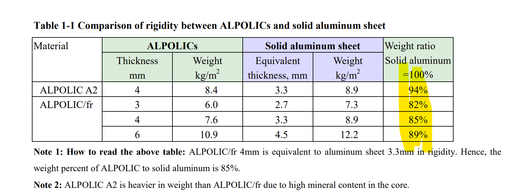

I've been off the boil with the want to build audio devices using Forum guidance for a while.
The Holiday Period has created time to revisit past interests.
The link may be showing a Panel Material that could be of interest, as I have seen Aluminium Composite as a structure has become a used material in recent posts.
This is intended as a Cladding Material to be used in Construction, which usually means a large amount of Waste Material in attractive dimensions can be discovered towards the end of a project when it is known to be a used material.
Samples may be able to be found for trials that are not with too much cost.

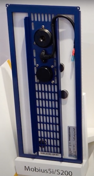

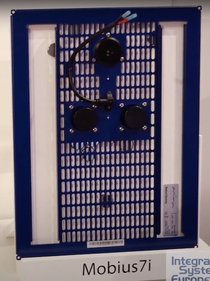

But I don't think it's a dome or mastic that is on the apparent exciter positions. Below is a close up of one of those panels. There's an obvious "pattern". Does that look like anything familiar to anyone? (and I don't mean that like some kind of riddle where I think I know the answer, I really don't know).
But this seems like a decent guess to me:
I did notice them too, but suspect it to be something to bind the front and back layer of the honeycomb to the exciter foot.
Another curious thing I noticed was that the more central exciter doesn't appear to be located at the "magic" spot defined in the DPK patents. According to their patents the exciter should be at about 41% across the width of the panel, but is appears to be located at closer to 34%. I wonder why that is.
Eric

JohnnoG,The link may be showing a Panel Material that could be of interest, as I have seen Aluminium Composite as a structure has become a used material in recent posts.
Thanks for the link. It might have some good damping properties. But from an efficiency/sensitivity perspective it doesn't look like a great candidate, as it is only very slightly lighter than solid aluminum, at equal stiffness. So I think from the efficiency perspective the aluminum honeycomb is more promising, If you can find it.
Eric
