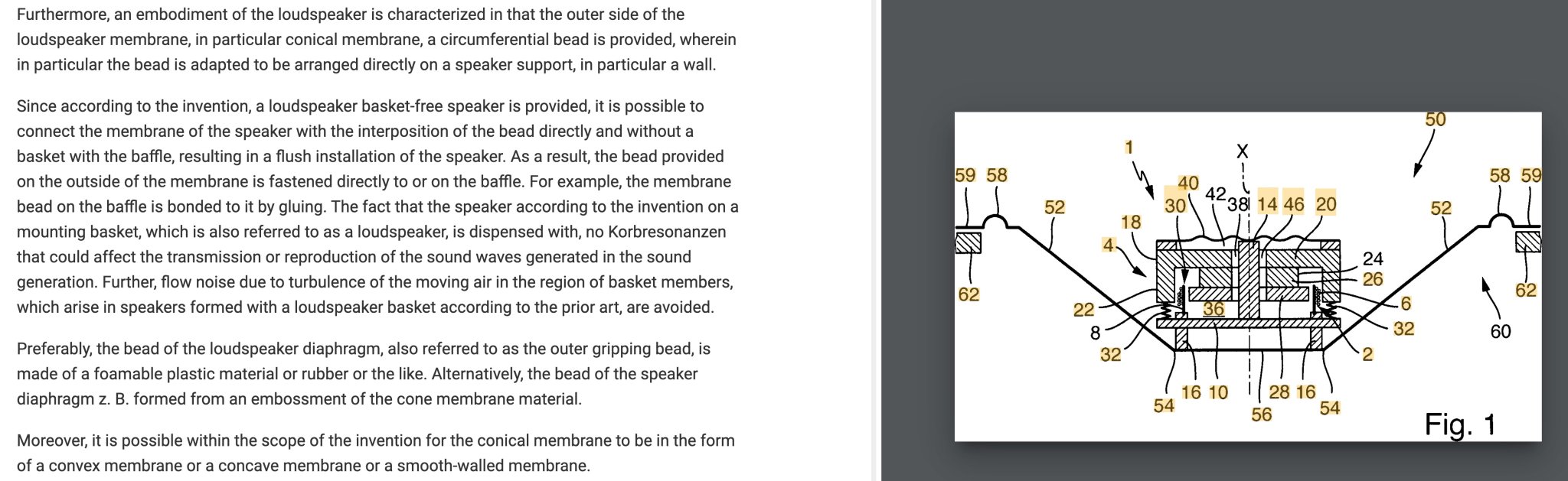

One can find the strangest ideas in patents. This German one is currently active.
It's about using an exciter on the front side of a very shallow cone speaker, effectively blocking the internal side of the coil former area.

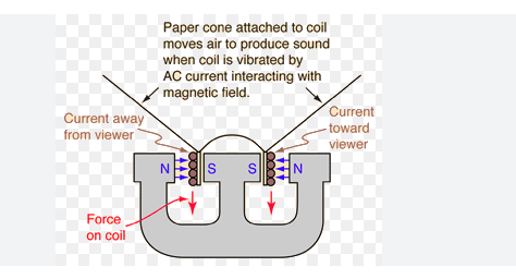

When we consider a voice coil, we typically think of its pistonic motion, often overlooking the fact that a coil carrying an electrical current vibrates within a magnetic field. We are so accustomed to viewing it solely in terms of pistonic motion that we tend to forget that in a 'normal' cone speaker, the lateral movement of the coil is constrained, meaning only the visible pistonic motion is apparent. This was advantageous for speaker manufacturers in the past, and it remains the case today. However, the coil actually vibrates within that magnetic field. These vibrations occur on both sides of the wound coil, indeed in all 360°. Nevertheless, the coil is confined to a coil former to somewhat limit these vibrations.
You have me confused. Are you saying that there is a "vibration" of the coil and/or coil former that is something other than pistonic? Can you draw a sketch or otherwise help me understand what these other vibrations look like?
It is normally understood that the pistonic vibration of the coil former creates transverse waves (i.e vibrations) that travel across the panel. But it isn't necessary for the coil former to have any other type of vibration other than pistonic for that to happen. Or do you believe otherwise?

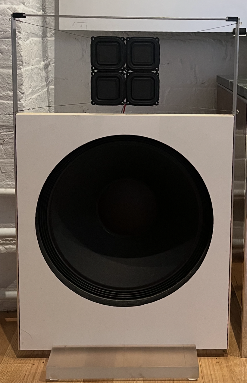

@aagas, any progress on your centre channel panels?
Lots of activity, but not certain I'd call it progress.
I did rig a kind of test frame on my subwoofers to try different center channel speakers.
In the photo, you can make out the bottom edge on one of my aluminum panels.
These pseudo DMLs from Parts Express work OK, but don't inspire.
Next, I want to try another version of Steve's card panels.
Remember, I use a pair of center channel speakers.
I'll provide an update as I make actual progress.
The wire connected to the amplifier in a magnetic field vibrates. If you wind it into a coil, it doesn't mean that the coil would only move up and down in the magnetic field; it can jump in any direction. In a speaker driver, all movement is restricted to the so-called pistonic motion. If you leave the coil free in a magnetic field when connected to an amplifier, it would move in any direction.
The coil former vibrates within that space and often strikes the walls of that area. A considerable amount of work has been undertaken by driver manufacturers to prevent this, but they have not yet been fully successful.

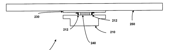

Why do you need to create your own exciter to incorportate a damper? What prevents anyone from putting a circular damping pad on a panel, and installing a typical exciter right overtop it?
If that exciter permits it, you can consider that option. You can also cut a hole in the panel in that area. This inventor had understood this quite sometime ago. They actually make a good profit from the flat panel speakers. That company has been in business since 1999, and this is their line of work. A patent usually contains just enough information to secure acceptance, and it often covers various aspects to hinder competitors. This inventor provides a bit more detail as they do not really have any competitors.
Well, I suppose the wire/coil former could move in any direction, if there was no spider. But the direction of the force on the coil former caused by the interaction of the current and the magnetic filed is determined by the cross product of the current and the magnetic field, which is only up, or down (in the figure). Is that right. or not?
And are the up and down vibrations the ones that result in the problems in the panel within the voice coil area? Or is/are there other vibrations in some other direction that are responsible for that?

Thus, the issue lies within that area inside the coil former.

Mikalauskas thinks the problem is a dip in the high frequencies, solved by adding a "damping device" that looks more like a stiffening device

Neil Harris was the obvious assumption, but it was the patent by Ken Harris, cited by Miskalauskus, that I was referring to:
https://patents.google.com/patent/WO2006078247A1
