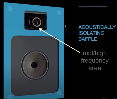

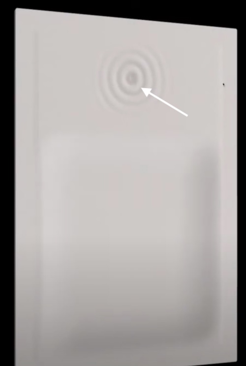

Stanley Rich's idea is mentioned at 13:44 in that video.
At 14:30 you can see how the baffle is divided into 3 sections.

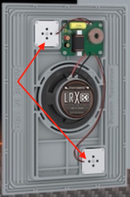

The original creator of flat panel speakers in our time, Dr. Jose Bertagni, discovered that it would be quite challenging to produce low frequencies from a flat panel, at least one that is flat in front, using a small voice coil. Later, the highly advertised NXT came to the same conclusion. Companies that purchased NXT licenses typically produced small so-called PC speakers, and these speaker manufacturers always offered a subwoofer alongside those tiny speakers.
Jose Bertagni and/or his sons likely utilised Stanley Rich's idea to achieve low frequencies when they ventured into the invisible speaker business. Those speakers were marketed to those who could afford their price. Jose Bertagni began his flat panel polystyrene speakers in the 1960s and managed to stay afloat until 2005, when their company was sold to Sonance.
Stealth Acoustics, or their parent company Dimensional Communications, started in 1973 and had a different perspective on hidden or semi-hidden sound systems. Stealth Acoustics was established specifically for that purpose around 20 years ago. They utilised standard speaker drivers to create a flat panel sound diffusion experience.
Both Stealth Acoustics and Sonance utilise Stanley Rich's concept of trapped air to produce low frequencies from the front surface of the flat panel before the air enclosure using pistonic motion. They both employ a very thin air enclosure to achieve this, precisely as Rich described in his patent. Additionally, both companies use a very small area to generate high and mid frequencies, employing the bending wave modal.

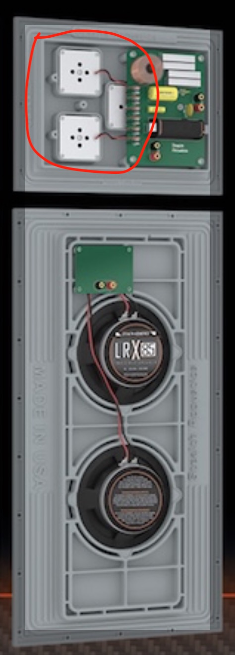

Conclusion:
If we need to hide the speaker in a wall, or if we want to have both resonating areas, we can create the speaker with two separate panels, thereby avoiding resource wastage. Those two resonating areas don't need to be connected at all. Alternatively, we can design quite small mid/high frequency flat panel speaker separately, using either standard exciters or conventional drivers with a coil former and foot, and utilise Stanley Rich's concept to create a low frequency (subwoofer) that is also quite flat. This would also involve using a flat panel to diffuse sound, allowing it to be placed anywhere in the room.

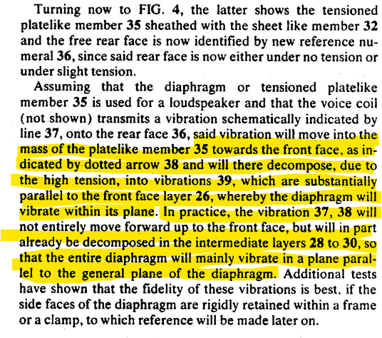

Speaking of Jose Bertagni, as far as I can tell, this is his first patent.
https://patentimages.storage.googleapis.com/a9/de/c5/2a486d79e60733/US3596733.pdf
It is a very interesting read. In effect, I believe his invention is essentially a flat panel bending wave/DML speaker. But he sees it quite differently from how we normally think of such speakers.
First, his panel is a granular polystyrene with a tensioned paper or woven face layer. He believes that the tensioning creates stresses in the panel that play an an important role in how the vibrations of the voice coil are turned into sound. Such a stressed panel is not typically used in any other panel speakers that I am aware of. It might sound a little like the "canvas frame" construction that is sometimes discussed, but if you read his description you will see it is not the same concept.
Secondly, and most interesting, is that his description of how the vibrations of the coil are transmitted to the panel is very unique. He believes that the vibrations are "decomposed" as they move from the back (where the voice coil is attached) to the from of the panel, and, that the vibrations are substantially parallel to the plane of the panel. Presently, we generally understand that what creates the sound waves in the air from such a speaker are transverse vibrations of the panel (vibrations perpendicular to the plane of the panel). But Bertagni apparently believed something different.
