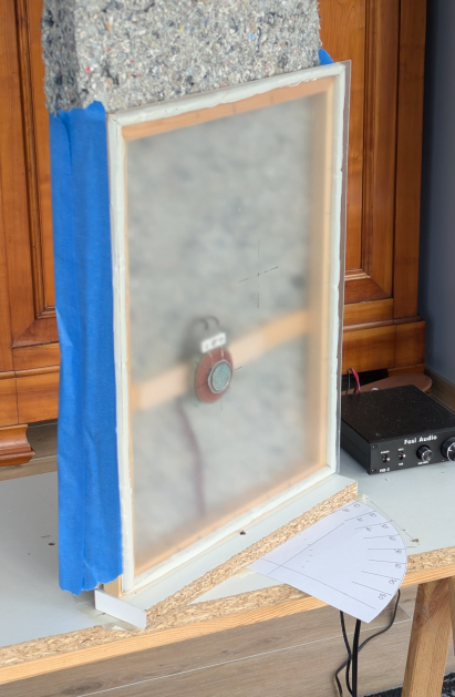

Following the first set of directivity measurements which were -90/90° in my first paper, I made a second set with I hope better settings. So prepared (maybe too quickly) a kind of turn table (see picture below) in order to have a fixed axle for the source, a fixed position of the mic and no room reflections before 5ms.
With this set up I tested different sources. Some DML test panels, a wide range speaker (Visaton FRS8 in a small closed box, on the picture), another FRS8 on an open baffle of the same size than the DML (about 30x40cm).
The goal was to have new evidence of the coincidence frequency for material like a 2mm plywood (done, it confirms the fc increases when the thickness decreases with the attention to have in the 2 directions - along and across the grain, for orthotropic materials). It was also to try to see in which way a DML with an open back is similar to an open baffle and to check what are the modifications with different rear load like an absorber, a partially open plate, a closed back.
So for a DML withe suspension, frame, spine and for the FRS8 in open baffle I tested with those different rear load options.
As expected some lobes due to the front and rear waves combination in the 1k to 3kHz range disappeared... Probably as Sandasnikaren suggested other reflections appeared.
My current difficulty is a peak around 500Hz remained what ever the back load is, even a closed one. It is in the measurements of the DML and the FRS8 in open baffle even when the back is closed suggesting the source is not the rear wave. It is not in the measurement of the small closed box.
Thinking more about it, I wonder if it is not simply a reflection from the small "table" supporting the source?
Anyway, as I just saw a similar peak in the FR from Sandasnikaren, I have asked about a possible source.
I hope it is clearer now. Tell me

Christian,My current difficulty is a peak around 500Hz remained what ever the back load is, even a closed one. It is in the measurements of the DML and the FRS8 in open baffle even when the back is closed suggesting the source is not the rear wave. It is not in the measurement of the small closed box.
Yes, much clearer now.
I see you discovered the same as I did that you need to be careful how close your speaker is to the front edge of the table, so that it doesn't fall to the ground when you rotate it! But the problem then is that you introduce a reflection from the table.
Just yesterday I was measuring some of my panels from the back. I had really not done that much before. Most of my high aspect ratio panels have quite deep frames (4-6 inches), so there are also reflections from the inside of the frames that make the impulse response look terrible from backside.
Your observation about the 500 Hz peak is interesting. But I really can't think of a reason why the table reflection would cause a reflection at a particular frequency. I'm sure you are thinking about it already, but you could try to fashion a smaller table that could rotate along with the speaker, so as not to introduce the new reflection surface. It would probably be a better way of creating your directivity plots too.

My first intention was first to have a well defined axis. There is a 6mm wood pin in the "table" and so a hole in loudspeaker. Previously, they were suspended to a transformed floor lamp based but it was not easy to change the angle.Christian,
It might be this frame helps in the bass extension by increasing the delay of the rear wave. It is similar to a U shape open baffle. The risk then (according to what we can read) is a "cavity noise". In open baffle domain, some designer increase the dimension on only one side keeping the other on as short as possible. It is something I think to test. On consequence is the direction ot the null is not at 90° on the wing side.Just yesterday I was measuring some of my panels from the back. I had really not done that much before. Most of my high aspect ratio panels have quite deep frames (4-6 inches), so there are also reflections from the inside of the frames that make the impulse response look terrible from backside.
Yes it is in my intention to make a support without the table effect. Something like a classical loudspeaker stand with the rotation close to the floor and screws to secure the panelYour observation about the 500 Hz peak is interesting. But I really can't think of a reason why the table reflection would cause a reflection at a particular frequency. I'm sure you are thinking about it already, but you could try to fashion a smaller table that could rotate along with the speaker, so as not to introduce the new reflection surface. It would probably be a better way of creating your directivity plots too.
Eric
The peak is much less visible for the FRS8 in a closed box and also with the canvas panel I have tested... but it seems here, hiden in the small peaks and dips of the FR, not coming as the
I will test also a better mic support using a 20mm pipe in addition to increase the distance mic/mic stand.

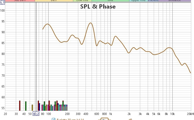

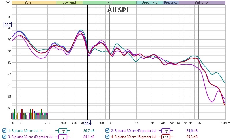

I have not figured out the reason for the peak at 480Hz . My assumtion is that some kind of resonance maybe related to the fs of the exciter I’m using. It’s fs is 230Hz +/- 10% and the high peak is at roughly twice that.Hello Scandasnickaren,
Your post is fully on what I consider at the moment!
In this post, are you refering to the panel 250x190mm in post #12529 ? extract below.
I initiated directivity measurements few posts ago mainly to detect possible important lobes at high angles. An update of my last paper should come if I am not going to be lost in new ideas...
From that I think I can conclude that some directivity singularities are detectable quite easily (currently with a gated IR). The need or the way to correct them seems to be an other story (see you post + the general position among the DIYer to use fully open back DML).
The singularities in directivity that are detectable are the lobes due to the coincidence frequency (if the fc is not out of the frequency range) and lobes in the mids that might be the combinaition of the front and back rear in the 40° / 60° range in front.
I observe 2 other singularities which might be with more effects.
One on-axis which is a peak around 500Hz. Going back to your post, I see you have a peak in this range. My test panels are 30x400mm measured at 1m so maybe no relation. Have you found a source of this peak? To be more explicit on why I am scratching my head: I have to explain that I made a set of measurements of 30x40cm DML with different back load, a 8cm large range in an open baffle of same dimension and the same model in a small closed box. The peak is here for the DML and the open baffle with or without a back load (even if it is less with) but not (or very small) with the small closed box. A difference being the front face of the closed box is maybe 10x12cm (and 10cm depth 1.2l).
The second singularity is an important emission around 2kHz to the back of the panel. Have you already observed that?

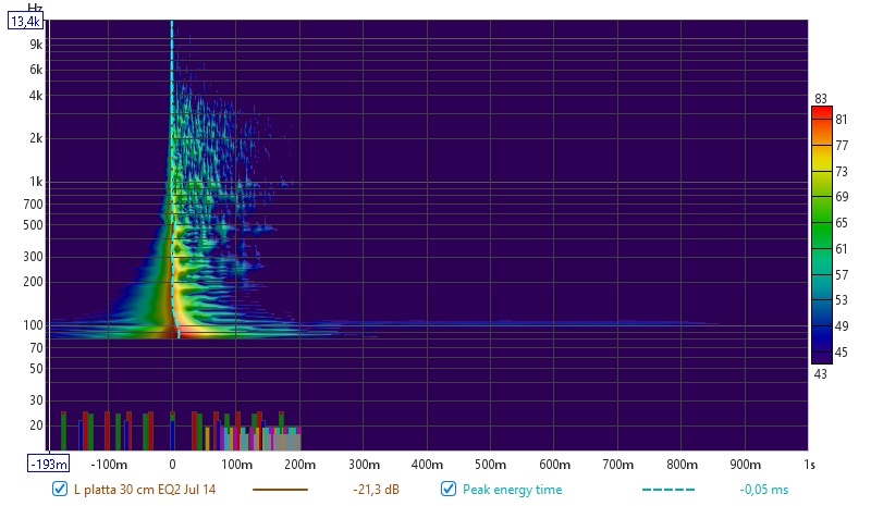

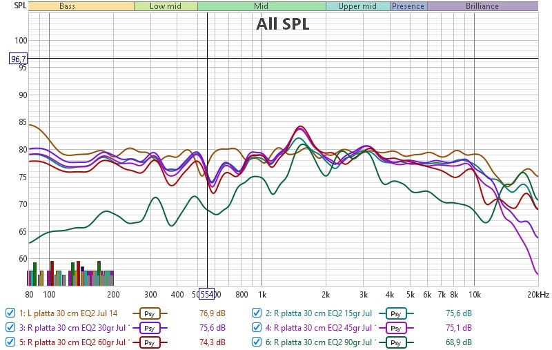

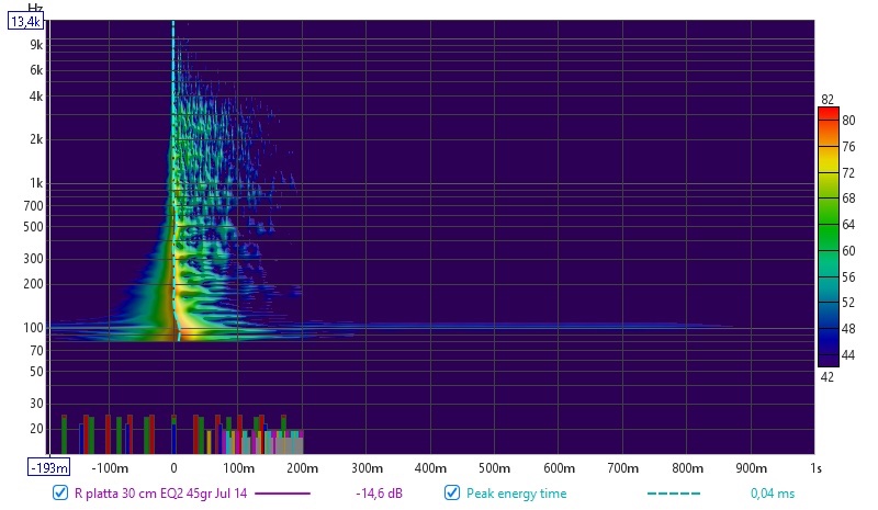

I have measured the directivity att 0, 15, 30 , 45, 60 and 90 degres angles. I’ve done it with and without equalisation.
The spectogram is 0 and 30 degres for the equalised case.
Thomas
Thank you Thomas,I have not figured out the reason for the peak at 480Hz . My assumtion is that some kind of resonance maybe related to the fs of the exciter I’m using. It’s fs is 230Hz +/- 10% and the high peak is at roughly twice that.
Thomas
Is there a woofer or a sub playing in those FR?
I have also in my hypothesis some resonance related to the exciter characteristics. I don't think it is in direct relation with the fs in the spac. This fs measured with no plate. The plate, depending of the frequency, the mode, shows to the exciter a mass, a stiffness and a damping so a new resonant system is created. At least it is how I see it.
Christian

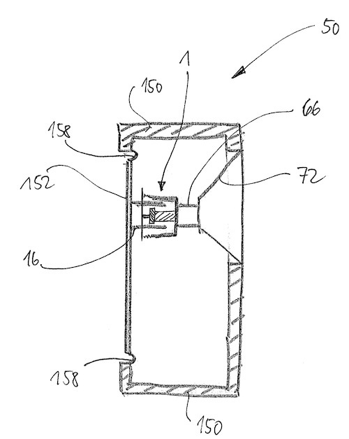

The perforated panel in fig 6 is not the dml panel itself, but a kind "acoustic lens"/helmholtz resonator (?) mounted close behind the panel.As with most reviews, whether paid or otherwise, what is shown is not always what is meant to be seen, often accompanied by some misdirections.
Anyway, One can always give them a ring and ask. The contact details are available in Tefra Audio website.
Whatever balsa he used doesn't really matter; what is important is the holes at regular intervals (fig. 6 of his patent) — "shows a perforated grid plate, preferably made of medium-density fibre material, which has openings of a certain diameter and predefined hole spacing, and which is positioned at a specific distance from the panel." All patents have misdirections. The holes are in the panel itself, not at a specific distance from the panel.
"a certain diameter and predefined hole spacing"... There is no further mention of them anywhere else.
The holes in the panel are quite common (as described earlier) when using vacuum infusion. For foam/glass infusion you can get pre drilled foam.
The "inventors" never include everything in their patents and almost always omit or miswrite something. It is not in their best interest for everyone to easily copy their "inventions," particularly when it concerns a working or profitable patent for the inventor. It was blocked until October 2022, and by that time, Oliver Göbel had outgrown its use and opened a more lucrative business. It is the same with those Russian and Austrian patents... misdirection. When we read a patent, we must have an open mind and some understanding of the subject, and we should never take it at face value.
No, there is no sub woofer.Thank you Thomas,
Christian

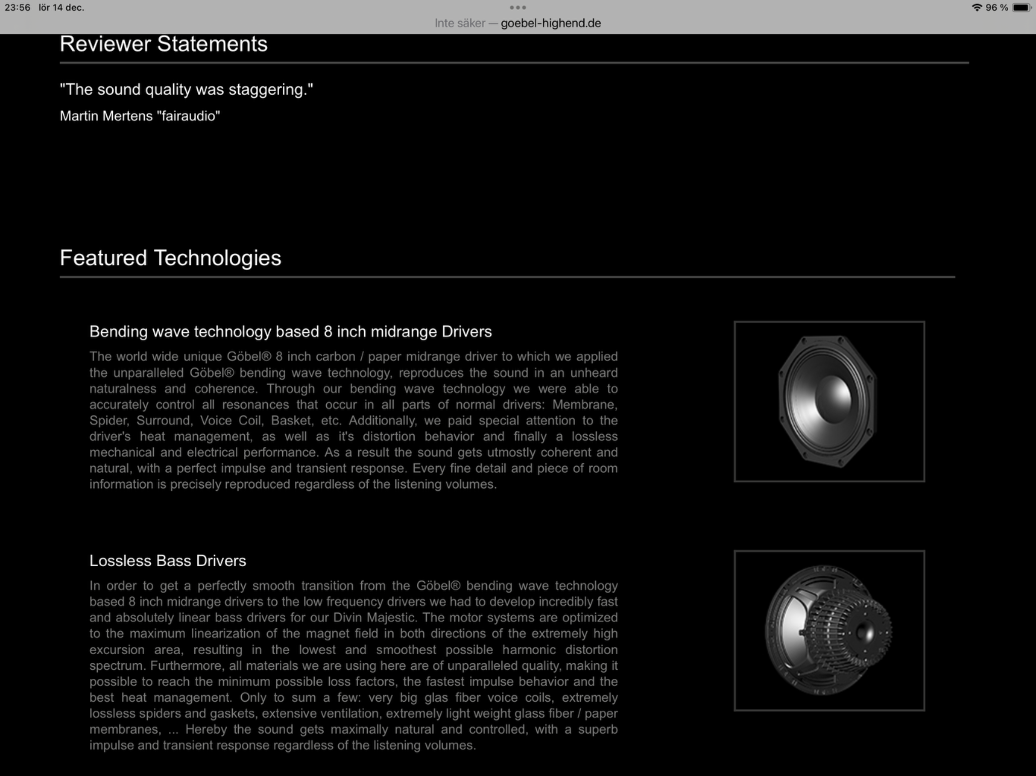

From Goebel high end website.
He is still using his Bending wave technology. Both in a flat configuration and a cone variant.
Thomas

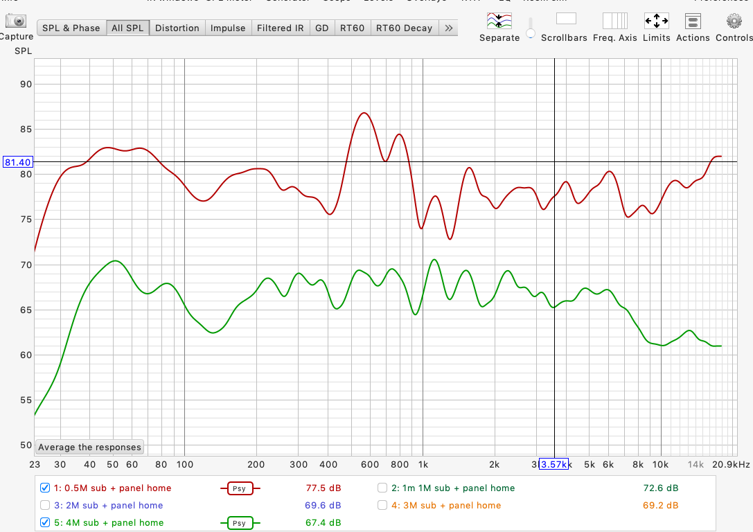

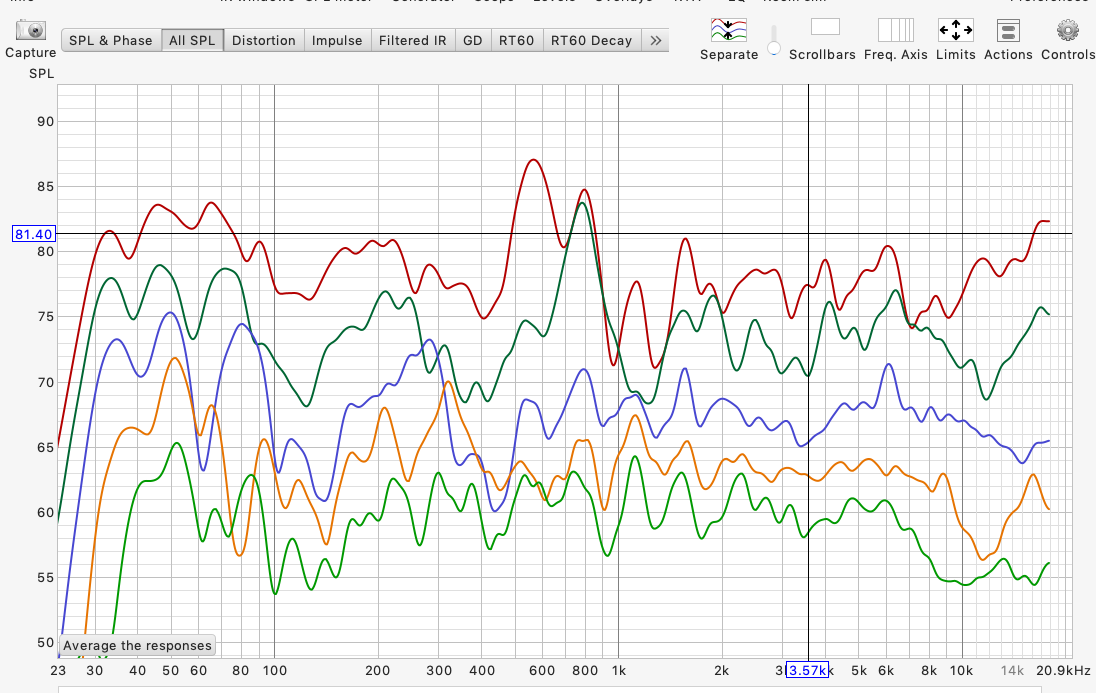

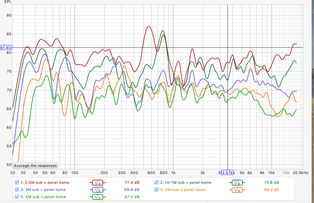

I was doing a quick test today with a different sub and noticed something that others may have already seen. I was trying out measurements at different distances and noticed that the peaks at 0.5m and 1m had smoothed considerably by 4m. They are in room measurements taken quickly and not scientific.
Might explain why panels with sharp peaks can still sound surprisingly good.
Different distances close.
0.5m vs 4m Psy smoothing
Seperated
Seperated
