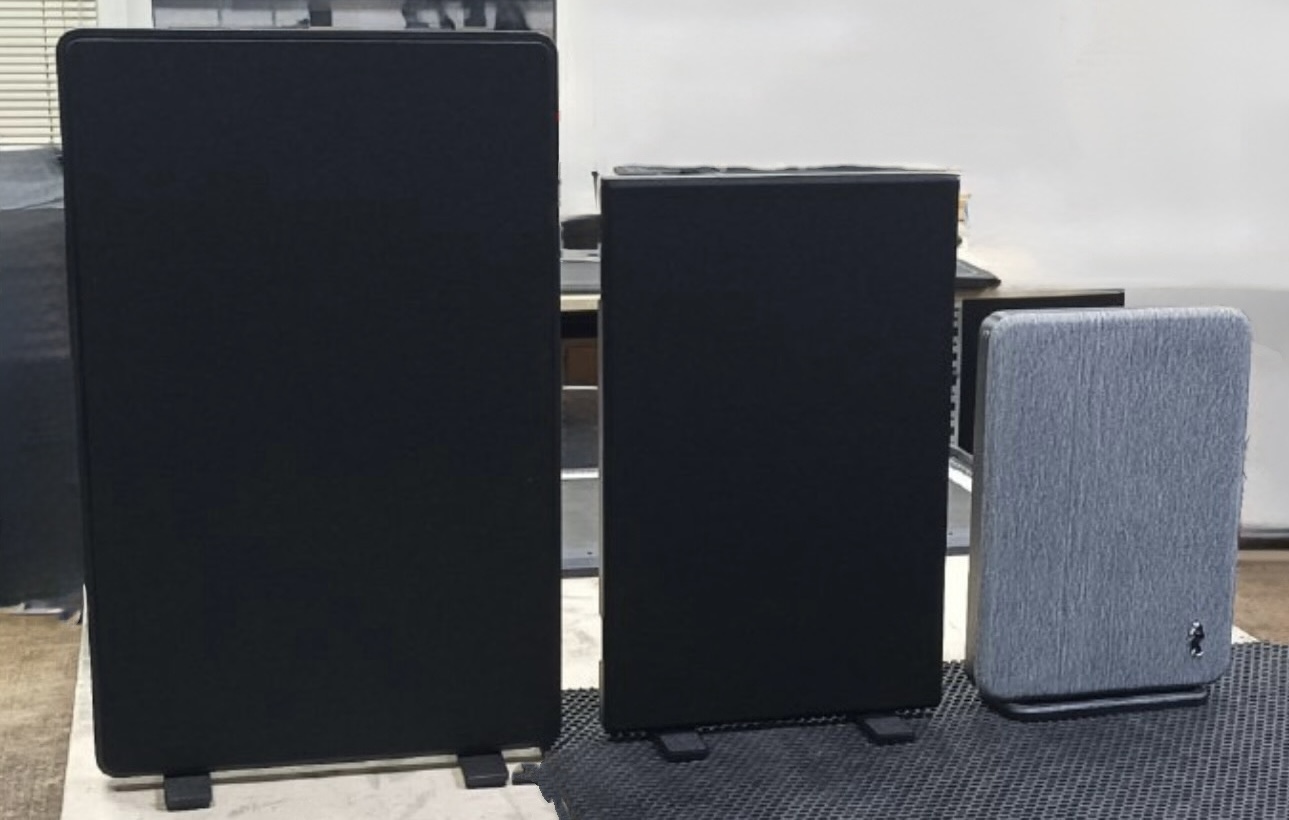

Hi Sandasnickaren, These look great! Wondering if the backs of these are fully open, since the discussion of late has been on the potential negative effects from the back wave. Thanks, BruceI've been testing 3D print panels with intresting results. I prefer to keep my speakers fairley small in order to use them in the living room without to much complaints...
I'm using simple PLA for the panel and frame, The panel has 20 % infill and the top an bottom layers are 0.2 mm. The layout of the panel is inspired by the Goebels high end bending wave.

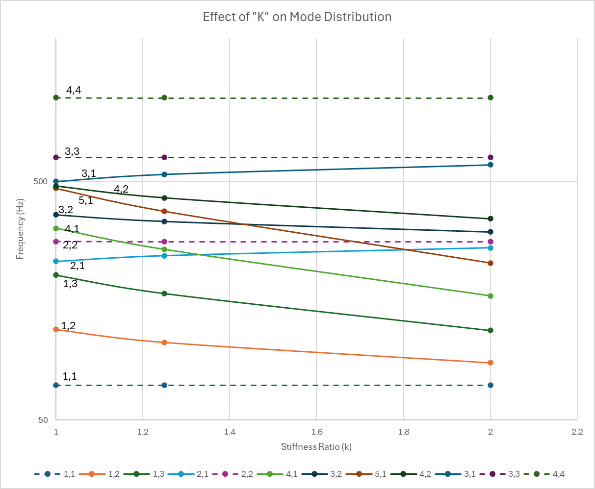

So here is what the finite element modeling says about how the "k" factor from the Herger patent performs with respect to the distribution of natural frequencies.I am working on a little analysis with FEM to see just how using this ratio actually works with respect to the distribution of natural frequencies. But I wanted to be sure that I was using the "rule" properly before I tried assessing it.
First, I modeled an isotropic plate (stiffness is the same in both directions) with a aspect ratio of 9/5, as prescribed in the Herger patent. The vertical series of dots on the far left (k=1) represent the frequency distribution for that case. Note that the absolute value of the modal frequencies is arbitrary, but their relationship to each other along the frequency axis will be the same regardless of the plate thickness, total area, etc., so long as the plate is isotropic and the aspect ratio is 9/5.
On inspection, it's far from clear to me why this distribution would be particularly good. Herger says it is, so maybe it works just fine for him. To me, it looks like a poor choice, particularly looking at the odd, odd modes, that radiate the most efficiently. Note how far apart the first two of these are (1,1 and 1,3). And then, the 5,1 3,1 and 3,3 are all bunched up at near 500 Hz.
But the question I was really wanting to look at was this: Does applying the "k" correction factor to the aspect ratio result in the same distribution of the natural frequencies along the frequency axis? The answer seems to be "yes", for a few of the modes, but "no" for the majority of modes.
I modeled two additional cases, one where the stiffness ratio (k) was 1.25 and another with k=2.0. The aspect ratios in those case was (9/5)*1.25=2.25, and (9/5)*2=3.6, in the two cases, respectively.
The results show that the relationships if the 1,1 2,2 3,3 and 4,4 modes all stay exactly the same. But all other modes either increase or decrease significantly, depending on the k factor, changing their relationships with each of the other modes.
I should add that the patent never claims that using the k factor to adjust the aspect ratio would keep the relationships of the natural frequencies from changing, but it is natural to assume it's what they were trying to achieve. In any event, it seems to work that way for a small subset of modes, but not the majority of them.

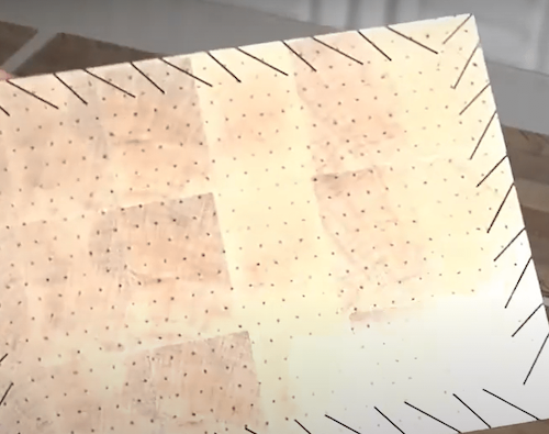

As bdjohns just mentioned, it would be interesting to take a look back at Göbel's flat composite membrane, even though he abandoned the idea of trying to profit from DMLs. Perhaps one should consider it after reading through the article linked by RMAM, but not focusing on the cuts, which is a misdirection – the suspension around the panel would dampen the edges anyway – but rather on the holes at regular intervals (fig.6 of his patent). By the way, Oliver Göbel is an audio engineer who once worked at Siemens as a loudspeaker and electroacoustic developer.
If you take a careful look at that membrane, you’ll notice that it is made of equal pieces of very thin balsa glued together at the thin side, with the pieces arranged against each other in the manner that carpenters typically glue wood together, with the grains placed against one another. Siemens, by the way, has had considerable experience in using wooden panels as sound diffusers since the beginning of the last century.

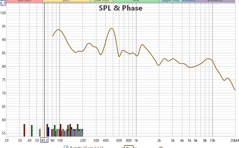

Yes, they are fully open and free standing in the room with 1m distance to walls.Hi Sandasnickaren, These look great! Wondering if the backs of these are fully open, since the discussion of late has been on the potential negative effects from the back wave. Thanks, Bruce
However I’m using the same panel in two other cases (home cinema):
First being i an athmos system as ceiling speakers. They are in this case installed in the roof with the backside fully enclosed in a large cavity which means it’s an infinite baffle. This works fine.
Second being in a small closed box as center speaker (unable to make a hole in the wall). (Still working on it not sure it’s usable).
I have earlier been experimenting with various form of damping of the backside. I got the initial inspiration from Goebel high end speakers. They have created an acoustical lowpass filter if I understand it correctly (it is stated in their spec that the frequency response on the backside is 200-4000 Hz, if I remember it correct).
I gave it up as I couldn’t see the value of neither through listening or in measurements.
And there are a couple of issues to consider:
- The frequency response from whatever you are using. It has to be linear/flat otherwise it will change (like an equalizer) the frequency response of all sound coming from the back in comparison with the front. This will influence the in room response (the sum of direct and reflected sound in listening position, what you hear) in an unpredictable way.
- There will be sound reflected back (” inside) to membrane/panel from the material on the backside this is due to the difference in impedance between the air and whatever material you are using. This is more or less the same effect as you have i regular box speakers ”box coloration”. Can you hear this? It depends on the amount of reflections…
In conclusion, today I prefer the omni directional characteristic of the open solution combined with DSP equalization as this gives the flattest frequency response from the speaker and also in the room response.
