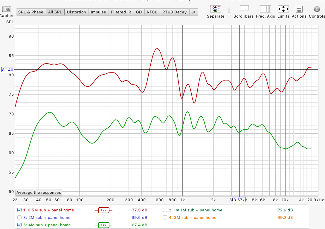

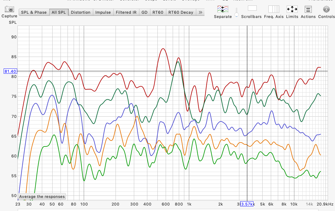

Hello Jozka,Nice to see this thread active again.
I was doing a quick test today with a different sub and noticed something that others may have already seen. I was trying out measurements at different distances and noticed that the peaks at 0.5m and 1m had smoothed considerably by 4m. They are in room measurements taken quickly and not scientific.
Yes it is nice. I agree and with real experiences sharing. Thank you for your measurements. I don't think there is a "scientific" question. Any measurement (with a minimum of serious) is better than nothing. We do all measurements at home so with some limitations. What is important is to keep that in mind and try to understand where we reach the limitations.
Your measurements bring a new observation of a peak in the 500Hz range with a new clue which is the influence of the distance (to be confirmed of course that it is the same for Thomas and I).

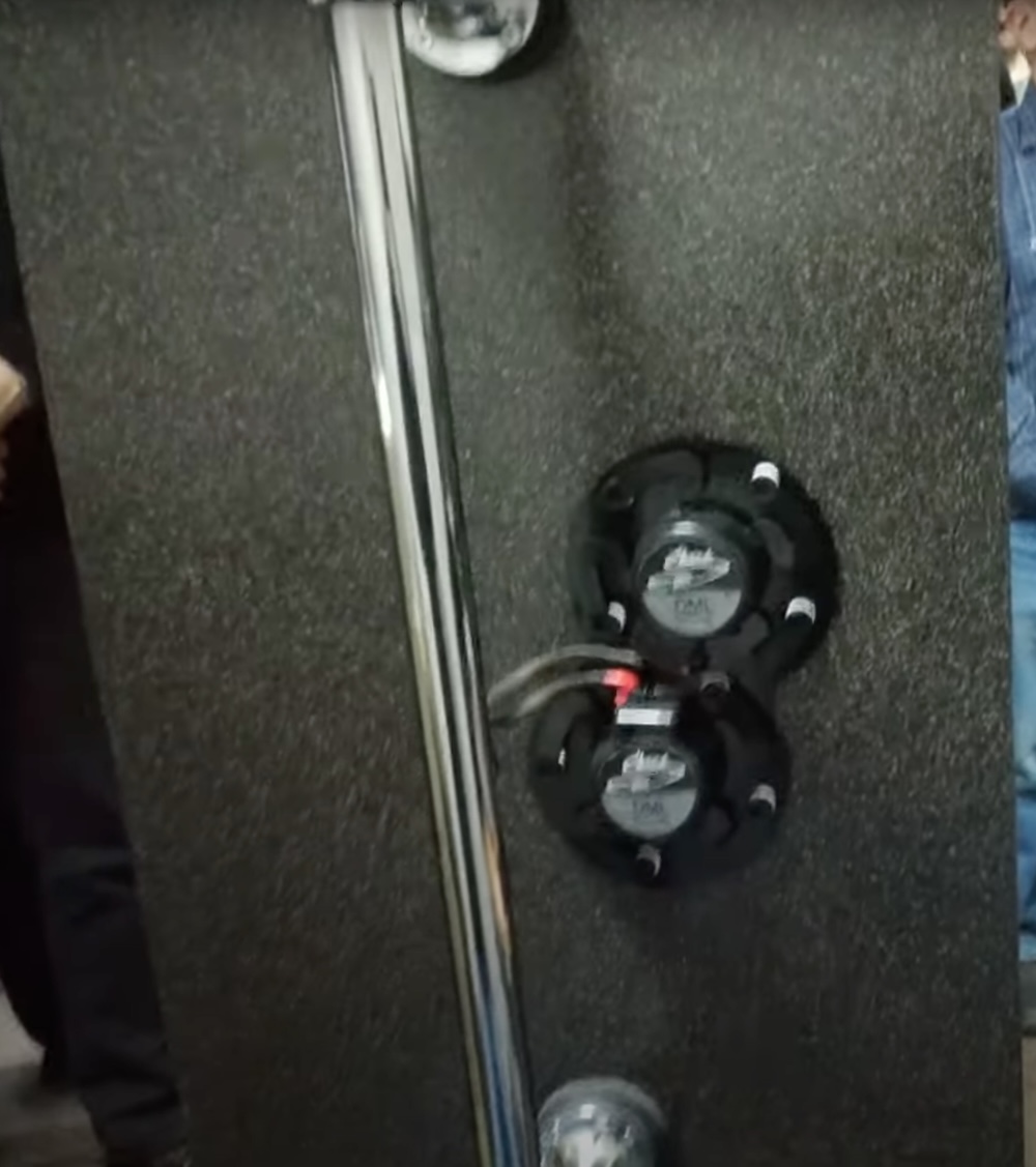

It would be quite refreshing if someone were to present a new idea, rather than attempting to replicate the somewhat unclear concepts found in existing patents. Oliver Göbel, for instance, has never provided more information than what is available on his website, and that information is rather dated. The only updates on his site pertain to exhibitions where his company or their partners showcase large speakers, but without the DML component. The last time he mentioned the DML component was in 2018, six years ago. Since then, the focus has been solely on large speakers that utilise conventional drivers, whether cone or otherwise.Really?
From Goebel high end website.
He is still using his Bending wave technology. Both in a flat configuration and a cone variant.
Thomas
Certainly, the aim is to achieve good, clear sound from flat panels. The concept of suspending them from strings has been around for a long time, demonstrating the principles of pistonic motion. Similarly, flat panels suspended in frames—both with and without back panels, as well as those with stuffed backs or artistically cut designs on the rear—have also been explored. Additionally, there is a Serbian/Swiss individual promoting the smallest DML panel ever created. The flattened coil glued to the flat panel, with a magnet system positioned just a few millimetres away is also around. However, none of these innovations have gained significant traction yet, not even the Göbel panels or the Russian variants.
NXT has been defunct for quite some time, and its successor, Tectonic, has also shut its doors. The Russians may manage to persist for a few more years, as they are quite resilient, no one in the local community seems interested in copying them anyway. As for the Serbian/Swiss individual, perhaps they could succeed if they learned to sell at commodity prices.

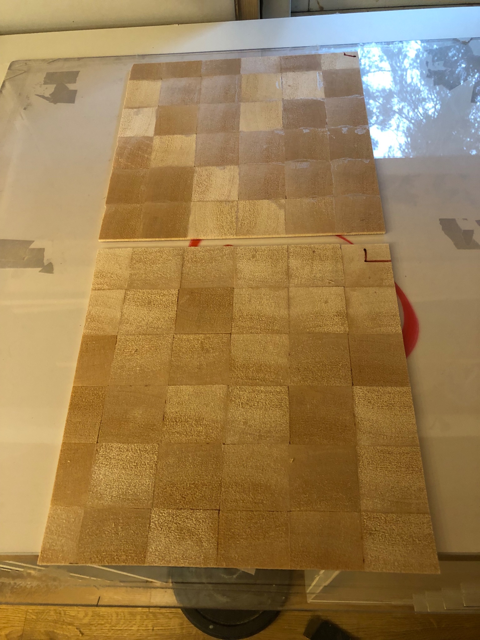

I used ”plaster of paris” in these frames. It was the easest way to fill them as printed them in two halves. I’m using sand in another concept I’m working on, more on that later.
I’m also considering to use ”epoxy-granite” which have some very intresting characteristics. It’s very often used in machinery to control vibrations. There is a lot to read on the webb if you are curious.
Thomas

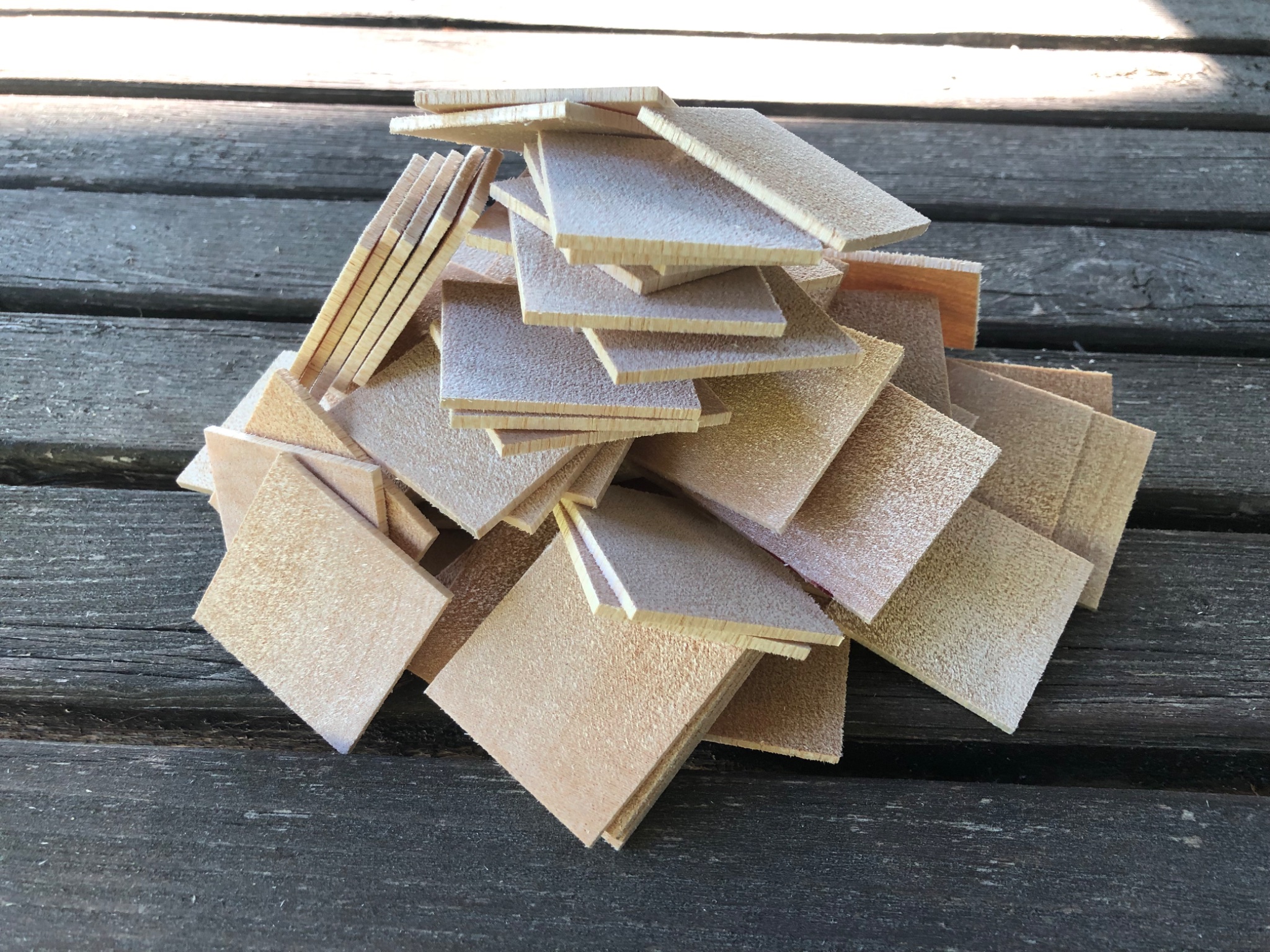

Is cross grain balsa a kind of balsa plywood? With layers in perpendicular directions? So different from what Eric did and also different from the end grain (Goebel or Monteverdi)?However I do not foresee a difference as its cross grain balsa so it’s pretty uniform in both direction.
Christian

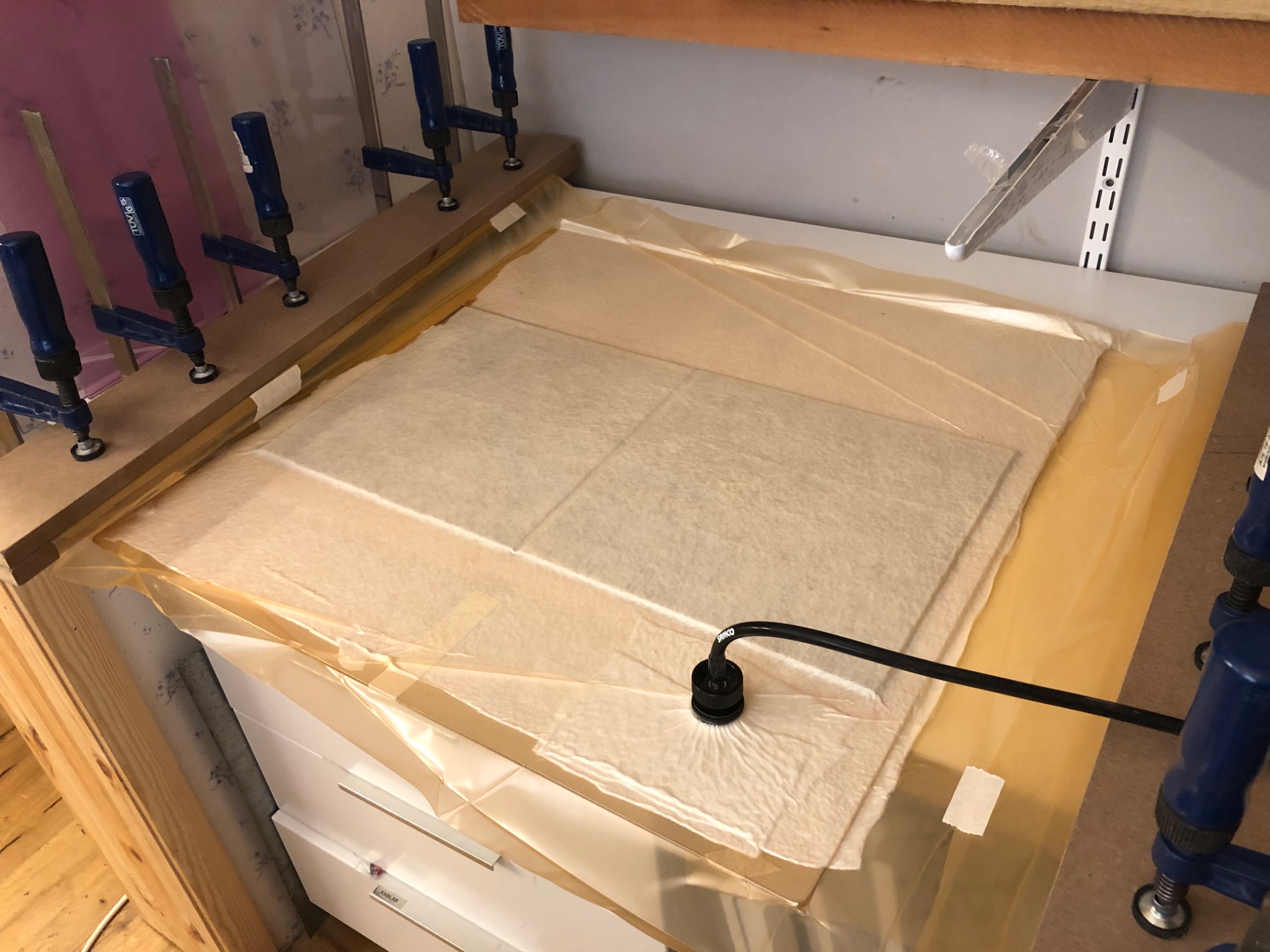

Homemade diy…the result is much stiffer compared to using balsasheets. The thicknes is 2mm after gluing and sanding.Is cross grain balsa a kind of balsa plywood? With layers in perpendicular directions? So different from what Eric did and also different from the end grain (Goebel or Monteverdi)?

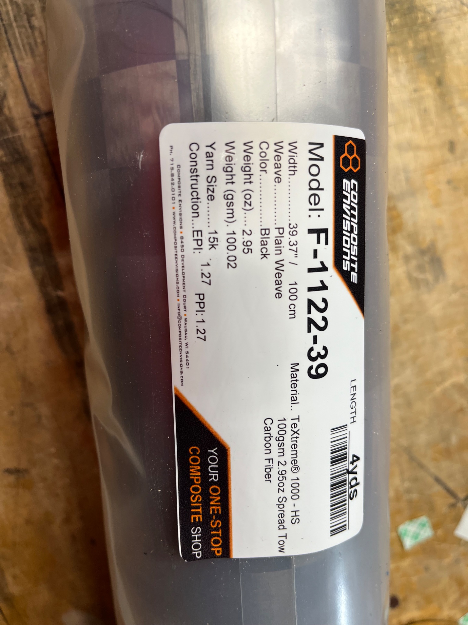

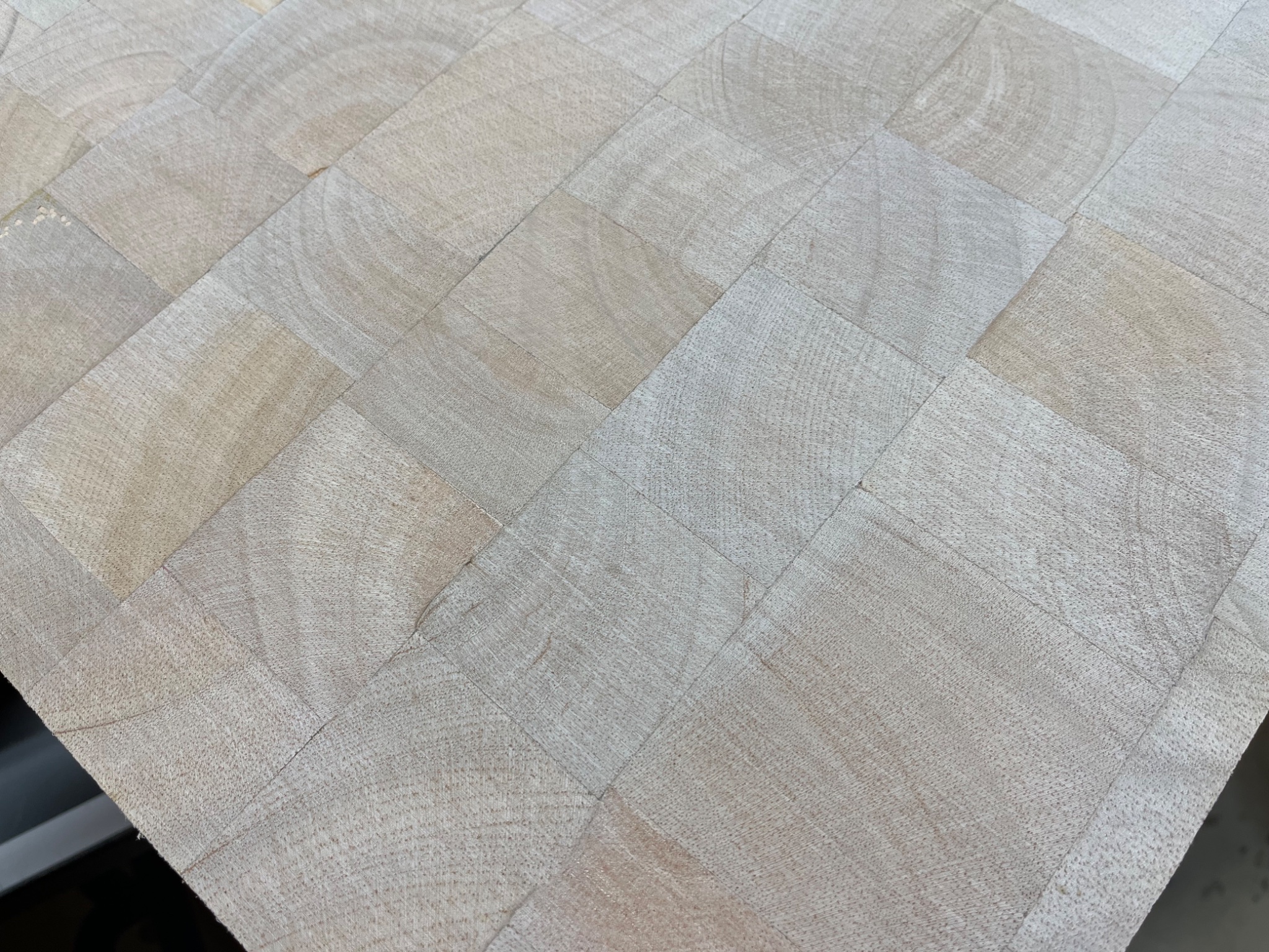

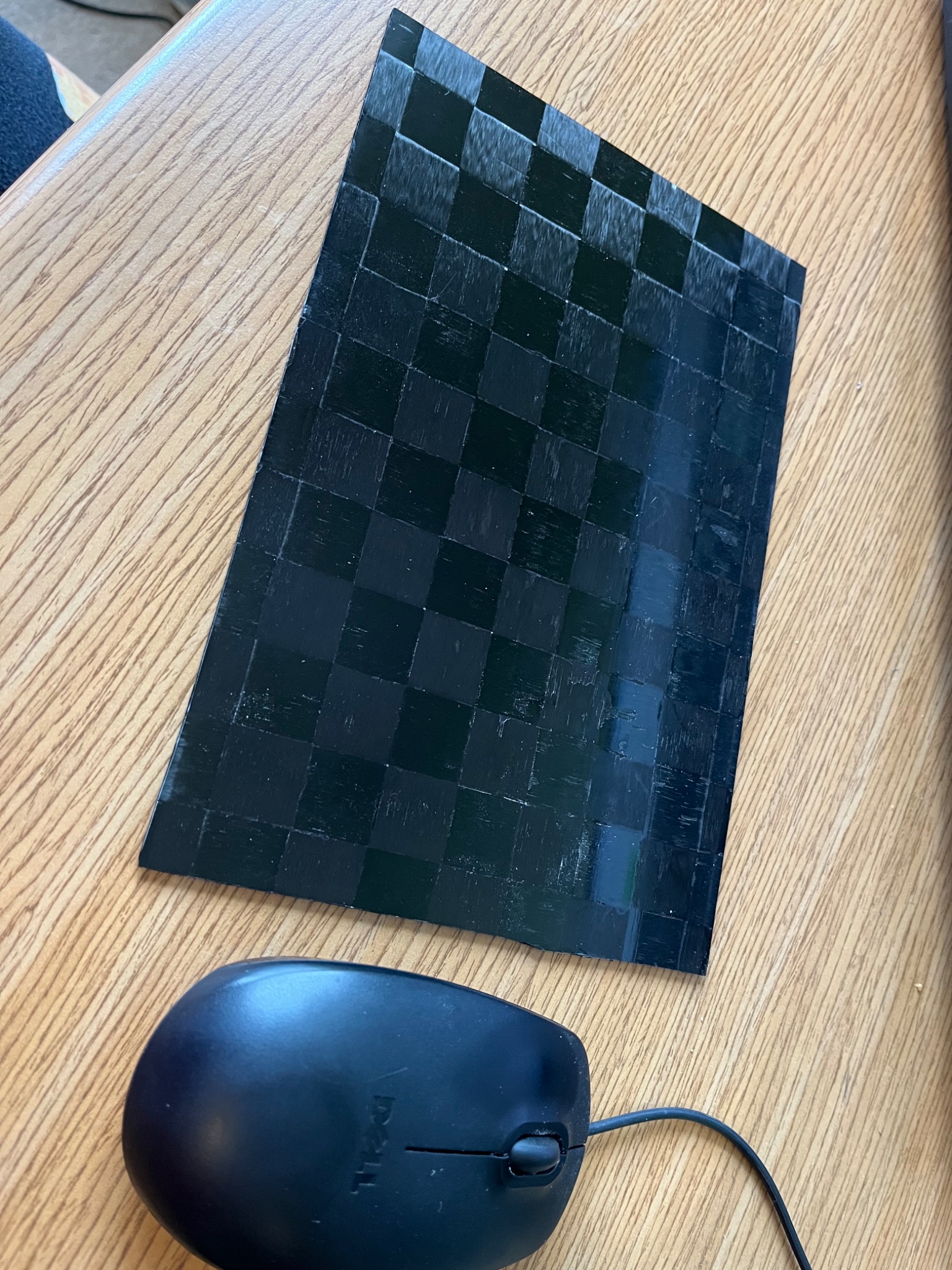

Thomas,3) new panel textreme carbon fibre 0.15mm skins and a 2 mm balsa core with cross grain using the tectonic exciter the aspect ratio will depend on the previous tests. I’m making the balsa core myself in my woodshop.

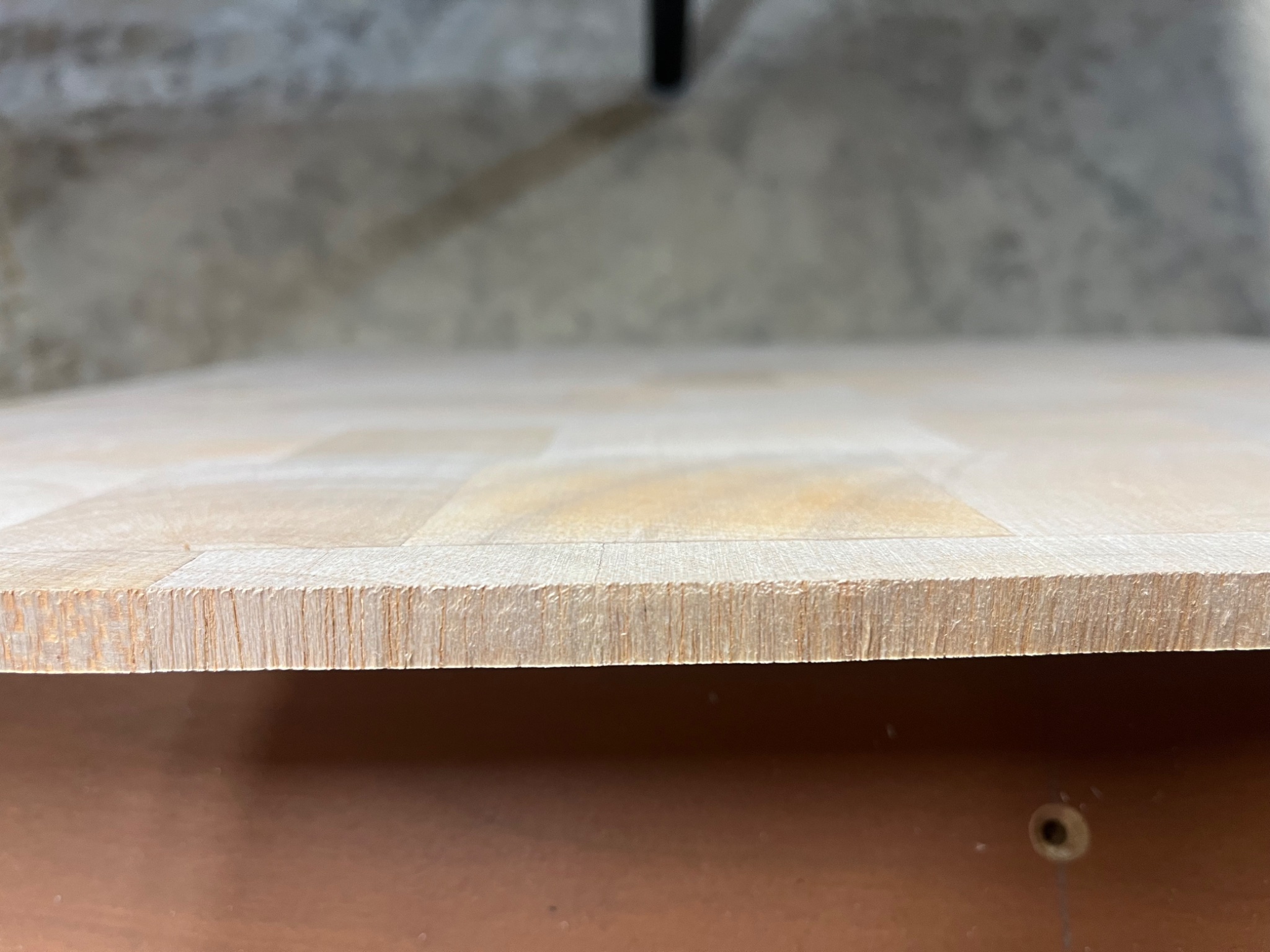

When you say "cross grain" do you mean the same as "end grain"? Like in these photos (but obviously thinner).
A few weeks ago I made a little test panel with Textreme F-1122. At 100 gsm it sounds similar to what you have. Which grade/model of Textreme is yours? Is it the same?
Eric
Ah, yes, it is end grain. Would love to hear more about your process. Epoxy, just on the edges? What density do you end up at?Homemade diy…the result is much stiffer compared to using balsasheets. The thicknes is 2mm after gluing and sanding.
Thomas

It’s similar different supplier 88g/sqm.Thomas,
View attachment 1394157View attachment 1394158
View attachment 1394168 View attachment 1394169
Eric
I’ve tried to minimize the amount of epoxy that I use, still room for improvment….

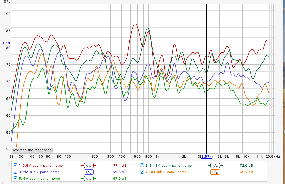

This is why I always measure near field and far field.Nice to see this thread active again.
Might explain why panels with sharp peaks can still sound surprisingly good.
Different distances close.
0.5m vs 4m Psy smoothing
View attachment 1393912View attachment 1393912View attachment 1393913
Seperated
View attachment 1393912View attachment 1393913View attachment 1393914
Not much point having a fantastic near field measurement if the far field measurement is bad.
Although a great room response is is the general goal.
Different panel materials, size and shapes will alter the frequency plots.
When testing a new type of panel, I always have to start from scratch again .
trying to duplicate the same measurements of someone else's panel will be impossible unless you have an exact copy of that panel.
Having a panel that measures well does not necessarily mean it will sound good.
This is why I prefer to find materials that sound good rather than trying to build materials that could possibly sound good, but most probably won't.
Steve.
