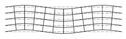

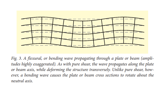

Better than words, here is a representation of what are bending waves.
Certainly, one could utilise a flattened voice coil and have the magnet system mounted independently from the back panel. By avoiding the depth typical of the Vifa-type speakers, it may be possible to create a slimmer Vifatanstisch panel while still achieving commendable results.
The speed of the waves in a flat panel increase with the frequency. Slow at low frequency, fast at high frequency. A specific threshold at which the way the panel radiates to the air is the coincidence frequency. At this frequency, the speed in the panel is the speed of the sound in the air. To get some orders of magnitude, let imagine it happens in the 10kHz. This gives a wavelength of 34mm. So roughly the dimension of the common exciters but also the dimension of a possible flat coil. So is it really the way to go? Where are the pros and cons of a flat coil, a standard exciter or maybe other solutions?

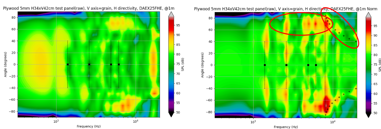

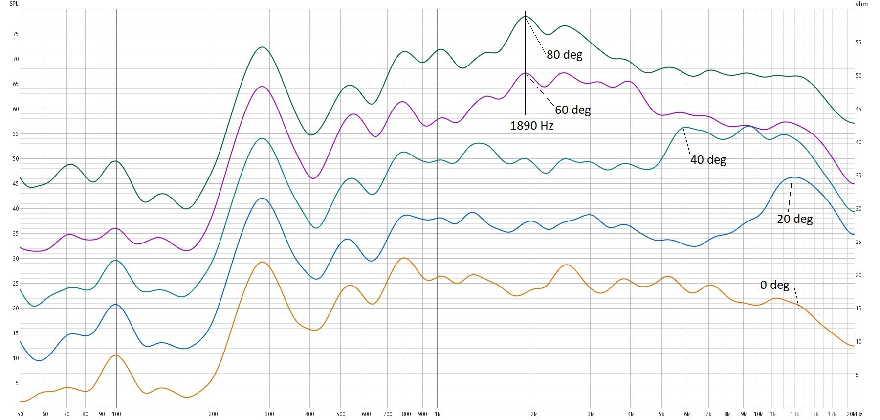

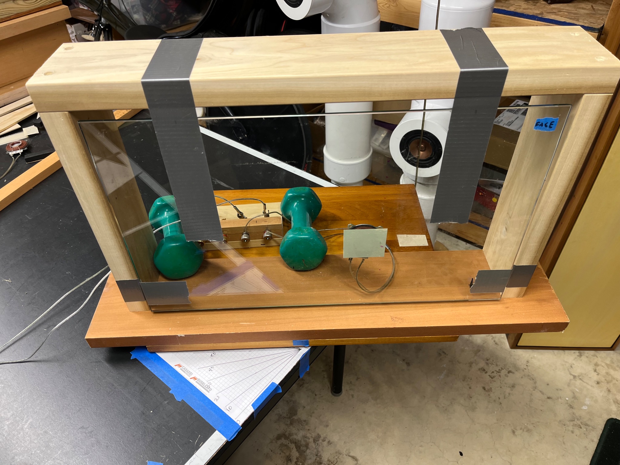

Inspired by Christian's recent posts about directivity measurements, I decided yet again to look for evidence of the coincidence effect on a panel. This time, I think I found it.

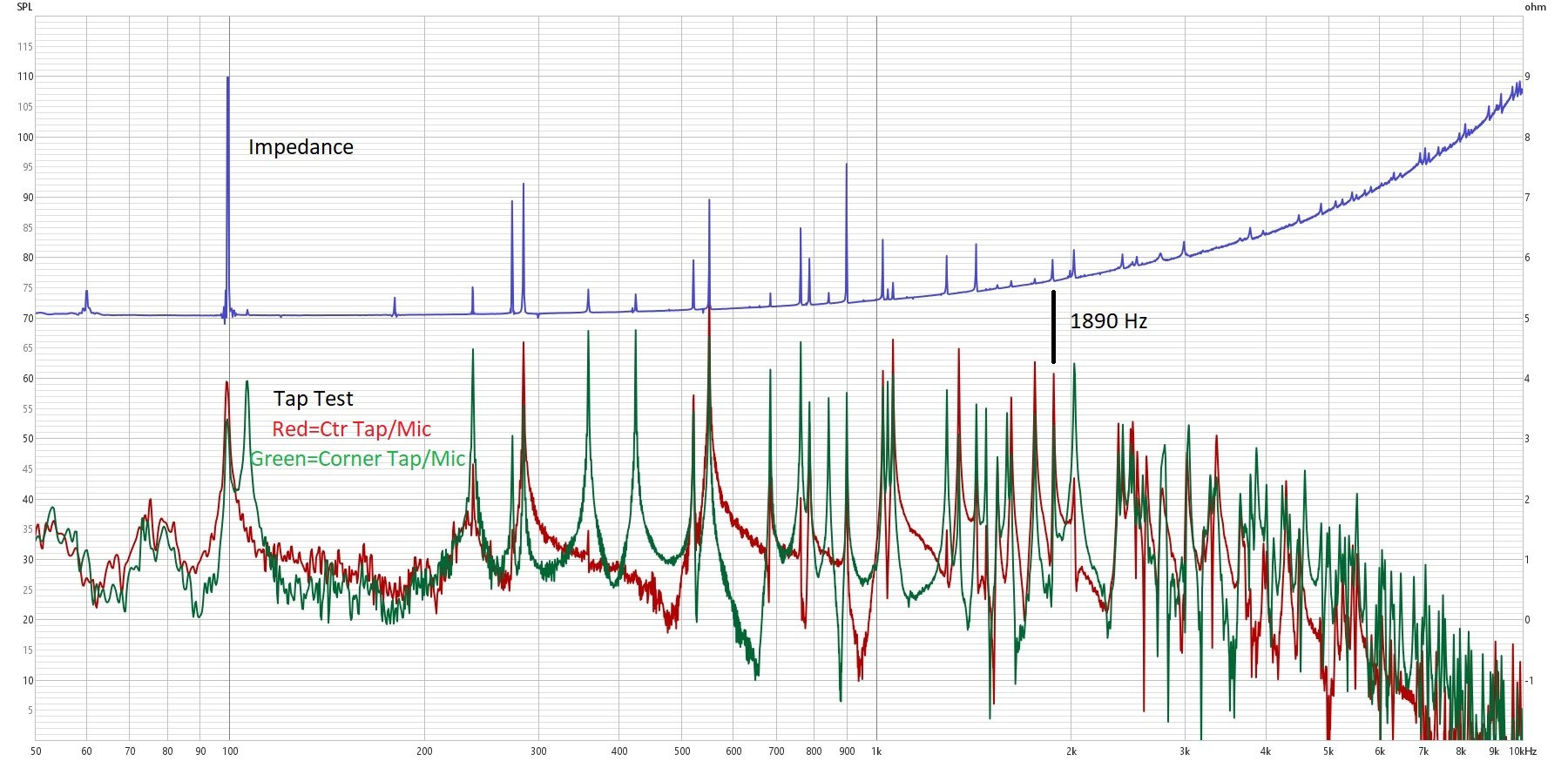

I decided to try a test using a 5 mm thick x 12.25" x 20.5" glass test panel. I did not choose this panel because it should make a great speaker (it does not!), but rather because it should be relatively easy to predict its coincidence frequency, since it's an isotropic material with elastic properties that are well known, using the equation below.
using typical properties of glass:
E=70 GPa
nu=0.22
density(rho)=2500 kg/m3
combined with my plate thickness (0.005 m) and using c=343 m/s, gives 2,392 Hz as the expected coincidence frequency for high incidence angles.
I suspended my glass plate in a frame using tape, mounted a 25FHE-4 exciter slightly off center, and measured the SPL using REW at angles from 0 degrees to 90 degrees in 10 degree steps.
Sorry Christian, I did not yet download VitiuxCAD and create hemispherical plots, but I will!
Results (1/3 smoothing) are shown below for angles of 0, 20, 40, 60 and 80 degrees. While the 0 degree (on-axis) plot shows no real peak at high frequency, the 20 degree plot shows a large SPL increase at around 13 kHz. And as expected, as the angle increases the "coincidence" peak occurs at lower and lower frequencies, and settling in at around 1890 Hz for angles of 60 deg and higher.
I must admit I'm a little perplexed that the apparent coincidence frequency (1890 Hz) is lower than the calculated value above (2392 Hz). My best guess is that the calculated value is closer to the true coincidence frequency, but that the mode (or modes) in effect at 1890 Hz are very efficient ones, and are simply close enough to the true critical frequency to be very well strengthened, and as a result give an even stronger peak than at the true (slightly higher) coincidence frequency.
The impedance and tap test results (below) are pretty interesting too. Not surprisingly, the resonance peaks in both are extremely sharp and narrow, presumably due to the very low internal damping of glass. Also, as I've shown before, note that the impedance peaks and tap test peaks coincide with each other since peaks in both occur at the panel's resonances. Note that there are a few peaks in the tap tests that have no corresponding peak in the impedance test, but this is simply because the exciter was located near a node of those particular resonance modes, and hence those were not detected in the impedance test.
And note in particular, that there is a resonance revealed in both the impedance and tap tests at 1890 Hz, which I suspect is responsible for the coincidence peak that I observed there when testing at 60 and 80 degree angles.

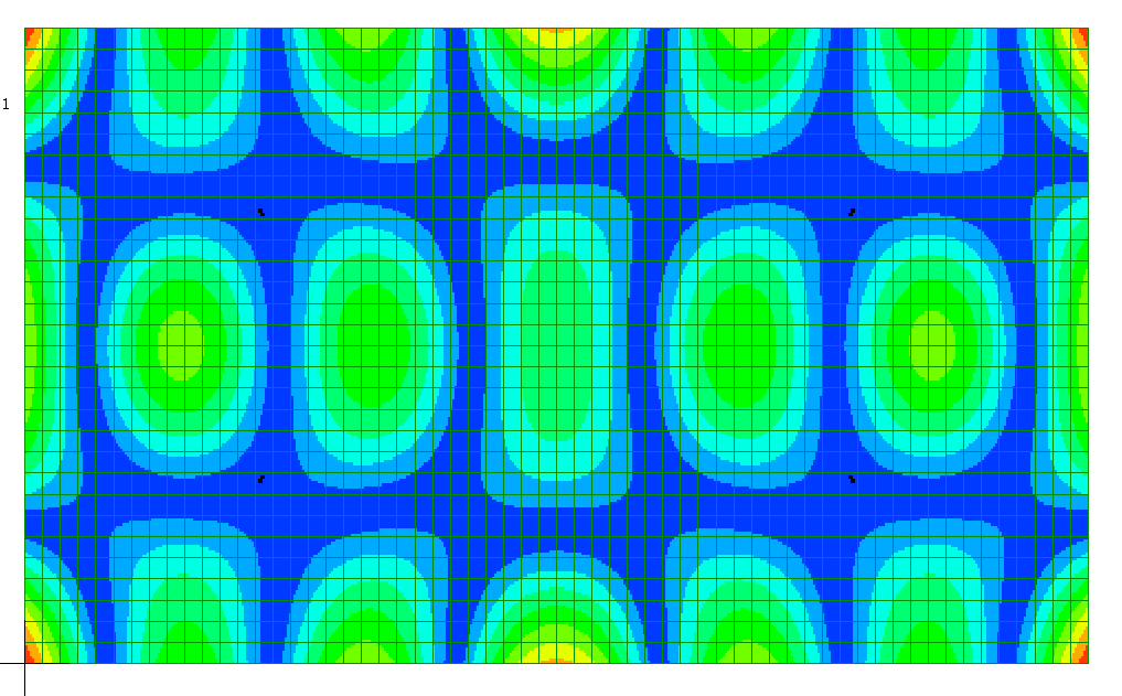

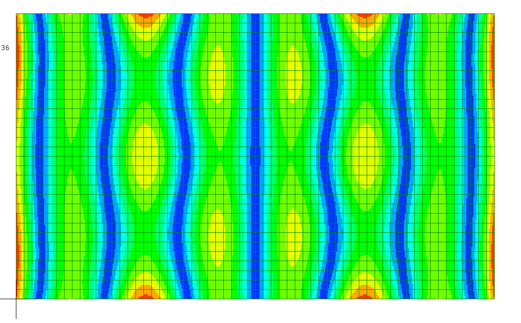

I did a FEA model of the plate also. I was able to get an extremely good fit between the model and the impedance/tap test resonances, using:
E=66 GPa
rho=2450 kg/m3 and
nu=0.23
which are close to the literature values mentioned above. Interestingly, the FEA model predicts both of the modes pictured below to occur at nearly 1890 Hz. Normally, I don't expect the FEA model to accurately predict such high order modes. But in the case, the correspondence between the measured and FEA predicted resonances is so strong that I thing there is a good chance that one of both of these modes are the ones responsible for the observed coincidence peak.
Eric

What do you mean by directivity accidents? Bruce
If you go back to the directivity measurements post like #12708 or after, there are this kind of directivity plots (also in my last pdf files).
Frequency in horizontal, angle in vertical, a color for the SPL. On the right figure, the areas in orange or red at angle from 20° and above show the SPL at those angle/frequency is higher than what is on-axis.
The consequence is a high level coming with a delay to the listener after bouncing on the room walls. Probably not good? Even at the opposite of what makes a good loudspeaker according the work from M Toole and others (smoothly increasing directivity)
So now we have those kind of measurements, my goal is to understood the causes and next to think about designs that won't have this kind of map.
We have good indications about one source which is the coincidence frequency (the small crosses on the map) and so the proposal of a design rule to reject it above the targeted bandwidth (that means roughly thin material, probably heavy and not too stiff).
Lower in frequency, the causes are not identified. My assumption currently is an effect of the open back. More measurements on going!
Now I have full plots at 360° so including the emission from the back which confirm something already shared here which is a high level in the 2kHz range to the back. An other high SPL out of axis.

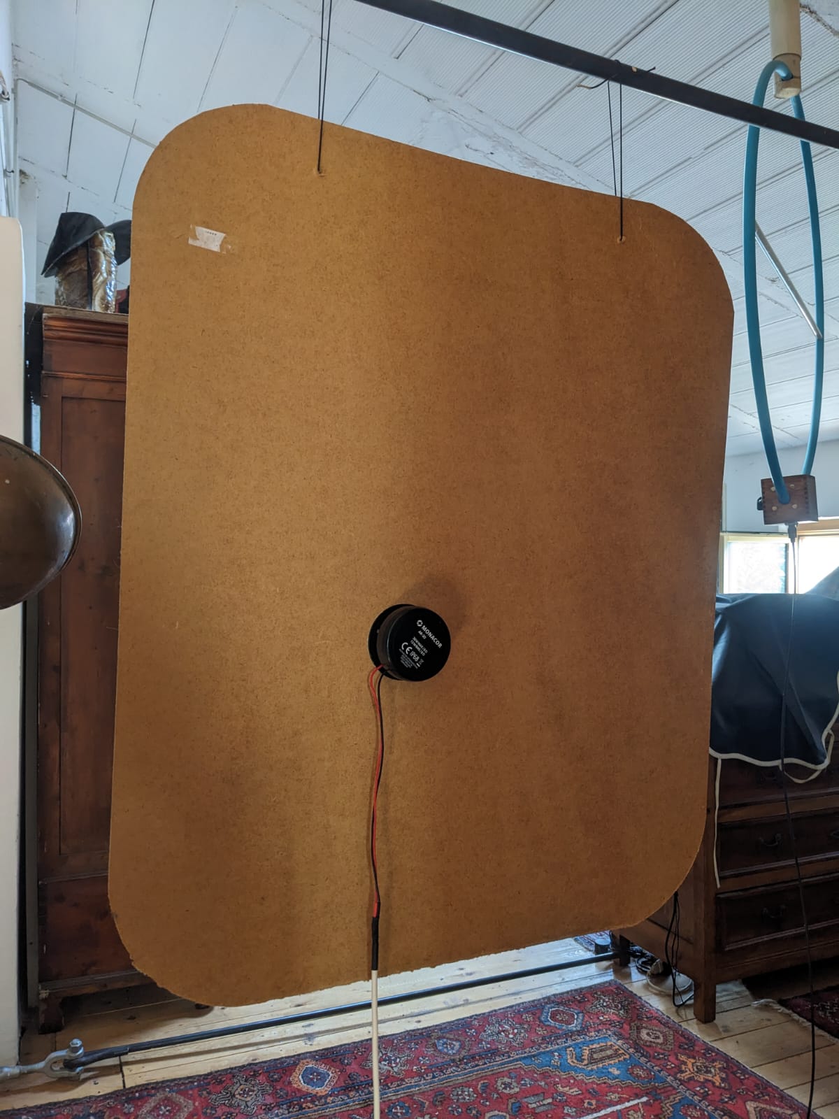

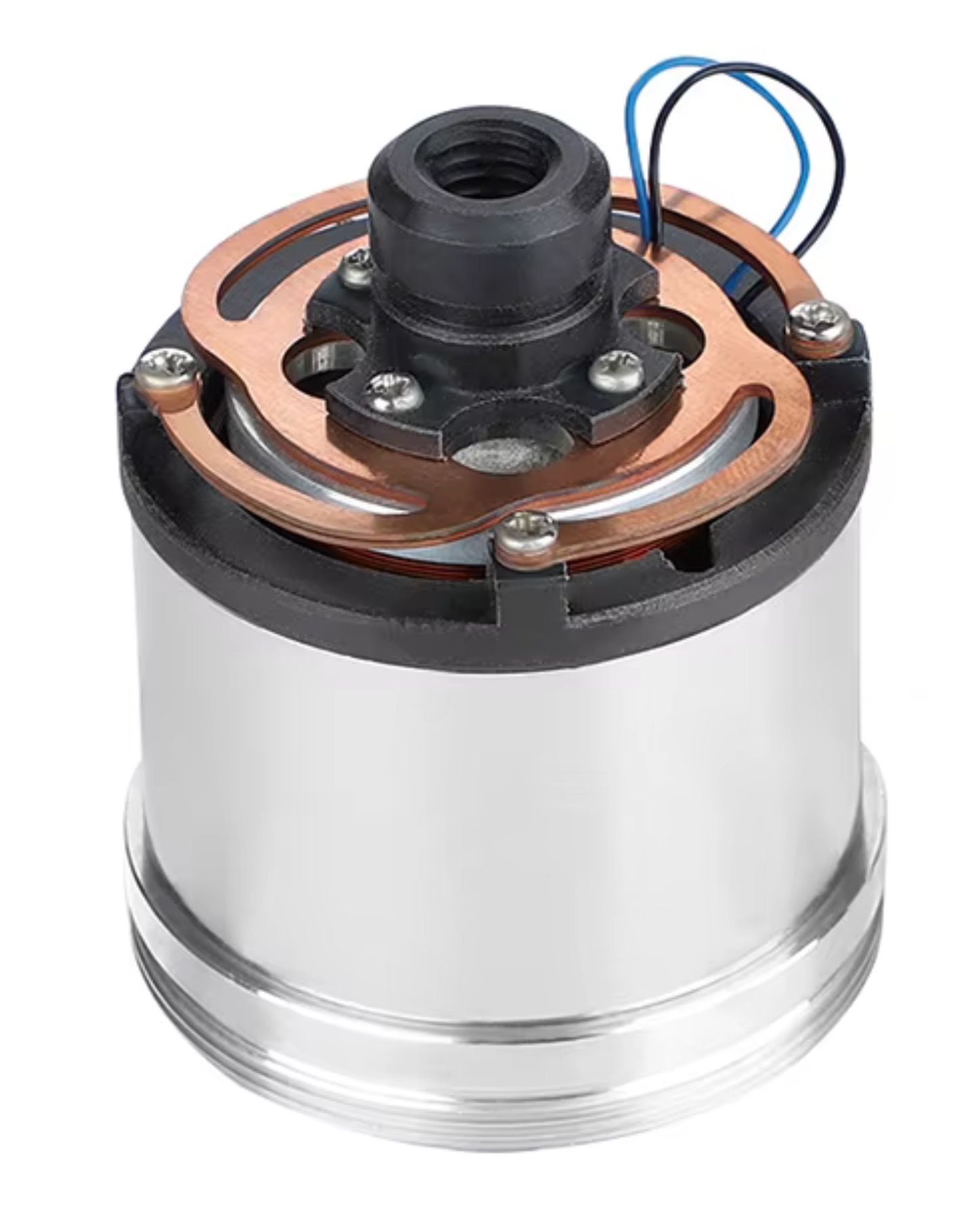

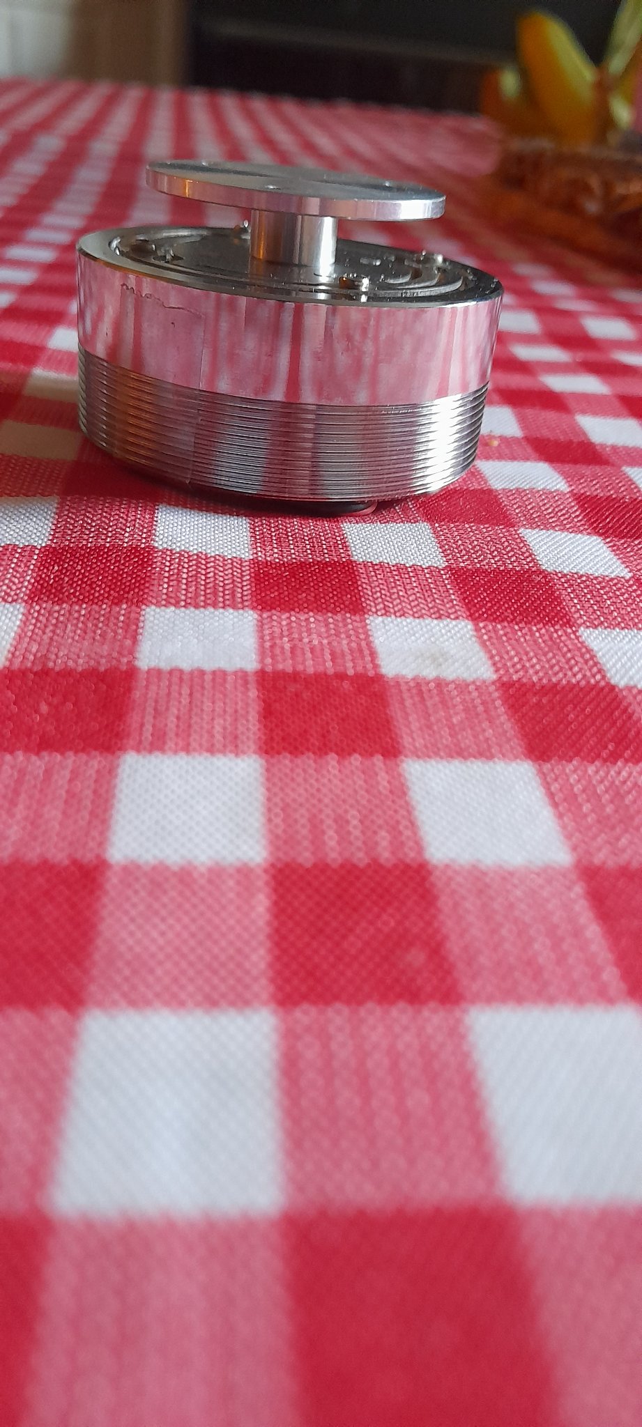

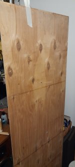

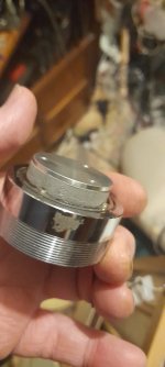

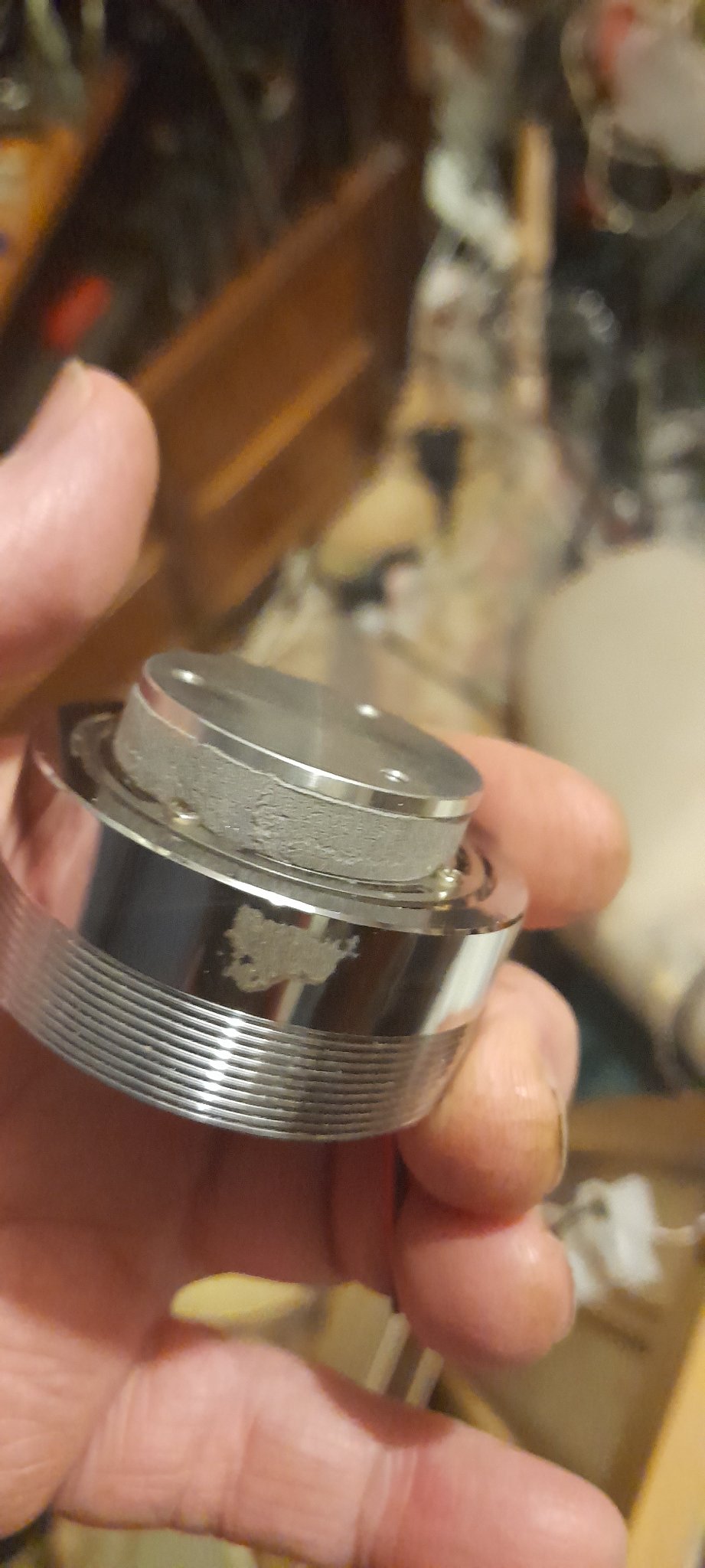

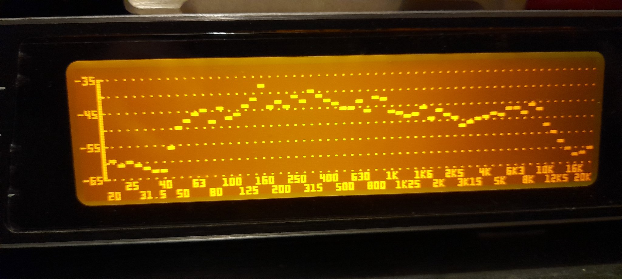

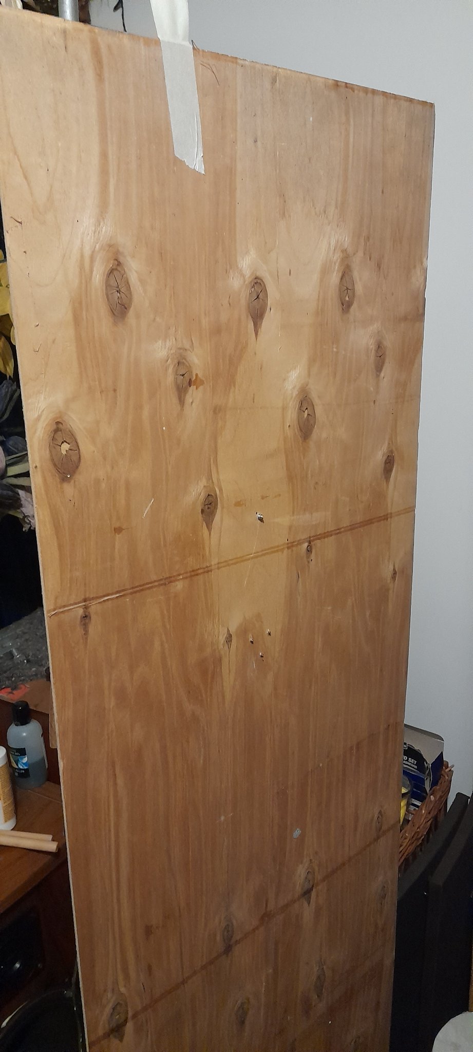

I was playing around with the new exciter today.
So I attached it to a 150cmx40cm x5mm which already has a hdn8 attached to it
I will compare these two at a later date.
The holes for the screws are ridiculous small but luckily I found three screws that fitted even if they were a little too long.
I'm not happy with this mounting so will probably use a long bolt for future mounting.
Probably giving a 2inch gap between exciter and panel in an attempt to minimise the exciter and panel interference .
I also think in the second picture that something like a foam insert if used as is,might be a good idea to stop the metal spider from ringing 🤔.
To be tested.
I was surprised that this exciter sounds pretty bad on the smaller lighter panels that I have but sounds quite good on more heavy rigid panels and stud walls.
It drives them very well.
i have not seen this probem mentioned before ,if it is a problem?
this is my first experience with metal spiders.
The sound is not up to the standard of the ordinary exciters, but I think improvements can be made.
The frequency plot on the ply panel is not bad compared to others I have seen.
10k seems to be the maximum hf for this exciter so far.
On this panel it just about reaches down to 40hz.
The measurement was taken at about 60cm.
If anyone has had similar experiences with this exciter and has any good ideas to improve them ,please let me know.
I'm mainly looking at this exciter to use on walls or on a Small PA type panel so ultimate fidelity is not an issue.
Steve.

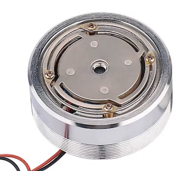

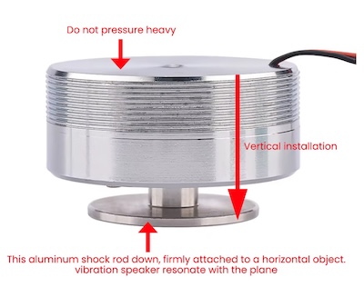

I have watched the video you posted here, as well as a few others later. Did you take the final readings/measurements in that room? It is cluttered with junk! How can you obtain accurate measurements in such an environment? As in this post?
By the way, that Aiyima "exciter" is more of a party gadget than something intended for serious use. It is designed to be placed horizontally.
It is far too heavy to be suspended on any surface without proper support. The Aluminium plate ( shock rod) will transmit vibrations, but at the same time, it will cause the driver section to vibrate as well. This will also result in the shock rod becoming loose from the driver section; in other words, its screw will become undone.
Of course, you can turn it into a functioning exciter, but only if you discard that "shock rod" and use the blocked metal spiders to transfer vibrations directly to a flat panel. You would need to attach a very thin transfer plate to the flat centre of that spider. In any case, you must support the heavy driver section to prevent it from moving or vibrating along with the support. (It is quite difficult to dismantle the device; I attempted to do so some time ago.) By the way, it can turn the entire door into a speaker, and even the wall.
Aiyima even has a larger model.

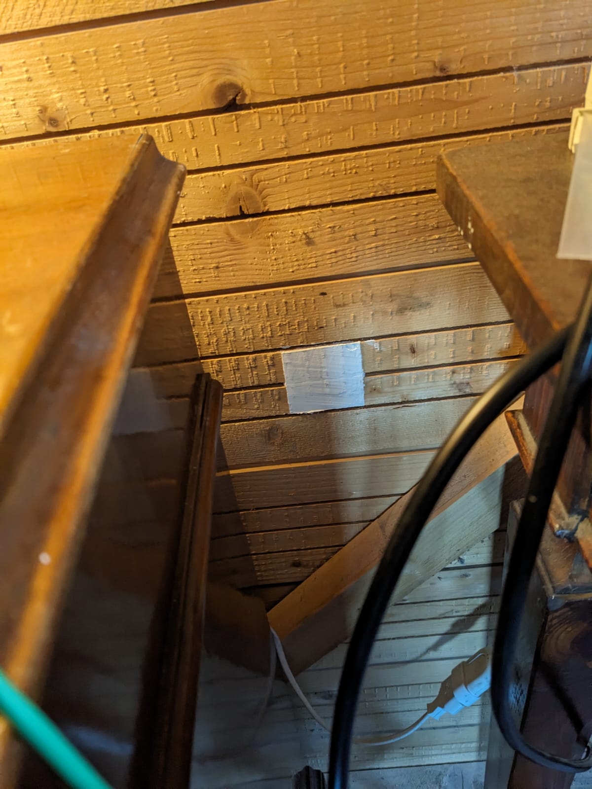

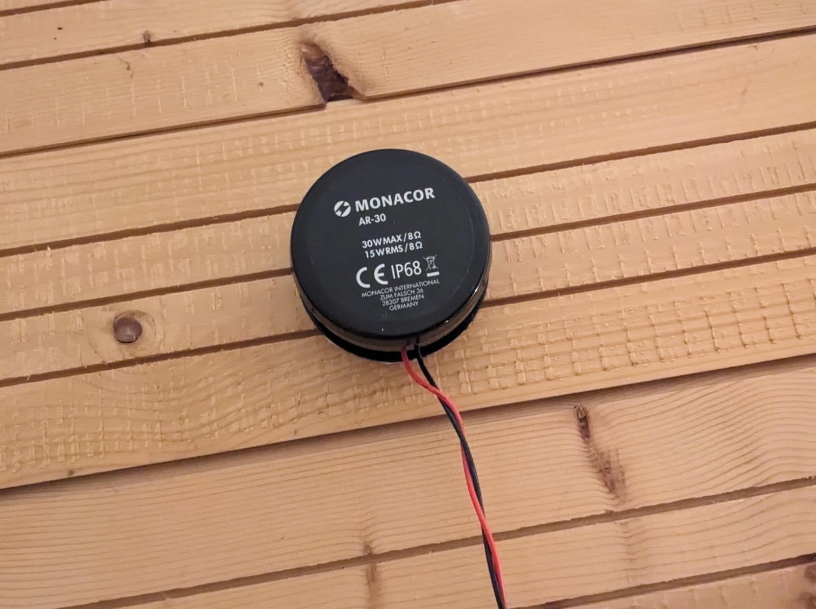

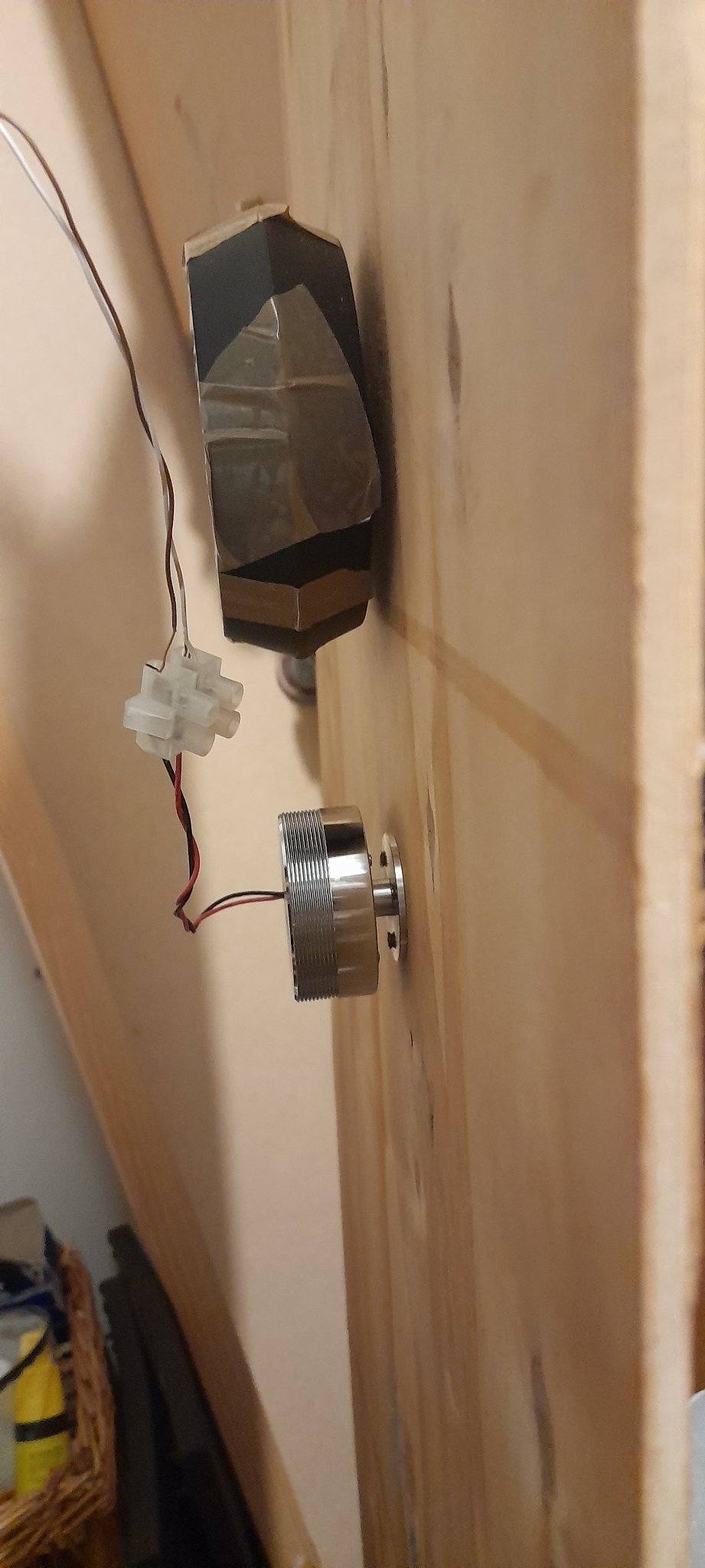

Please forgive my english, first of all. This thread got my attention months ago. I used exciters for the first time some years ago while making a large (2 sq m) plate reverb and I still had one Monacor AR-30 spare, so I tried to arrange a mono DML panel just for the fun of trying.

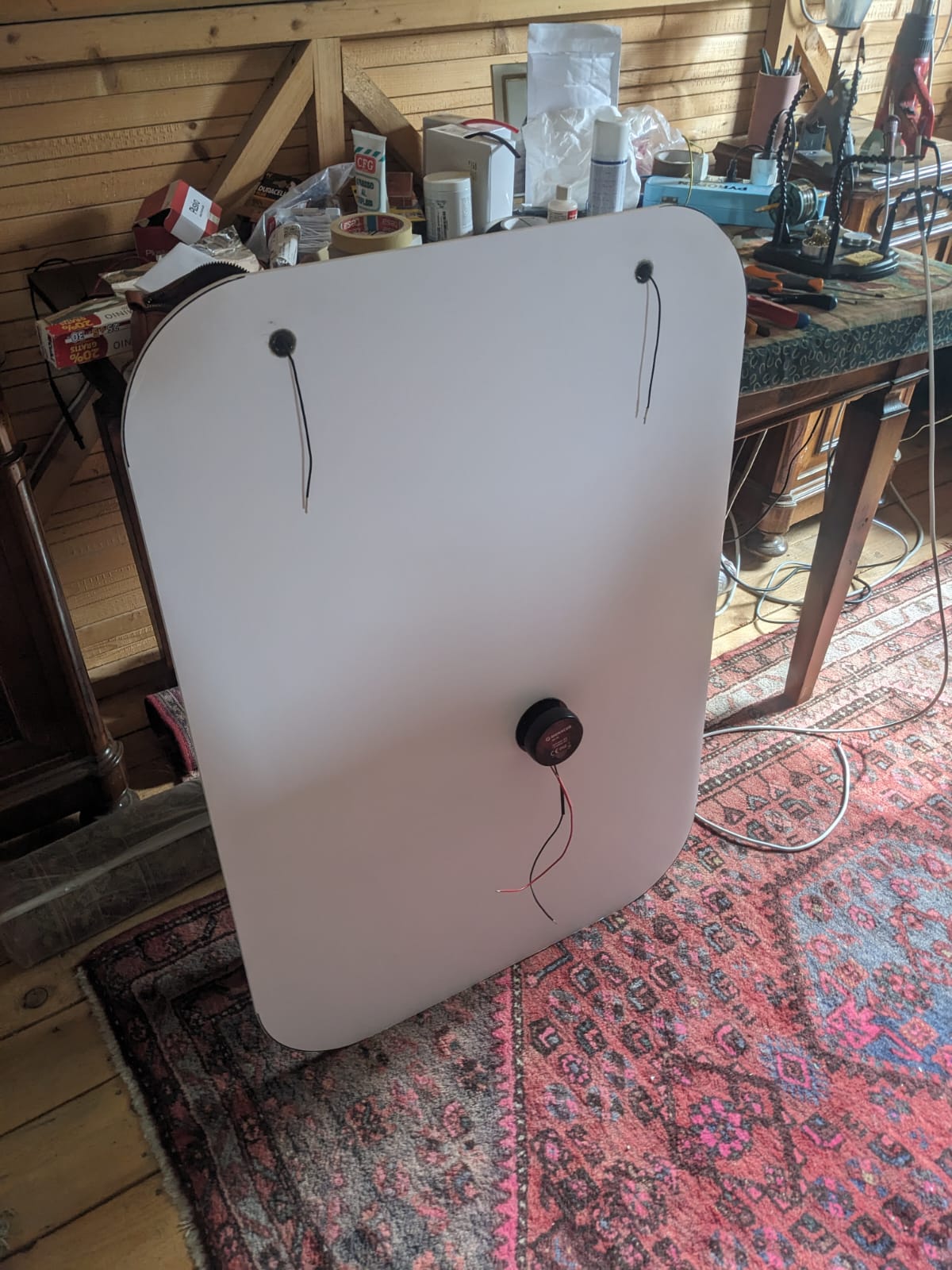

My first attempt was with a 100x70x1 cm poliplat sheet, which is a foam core panel with paper glued on both sides, with rounded corners and 2/5 3/5 placement of the exciter, suspended. It sounded very loud but I got bored very soon as it lacked bass and it was screaming too much in the mids, so I tried with a different material.
Take 2 was made using a 100x70x0,3 back panel of an Ikea frame, I think it's like hot pressed sawdust. It sounded much quieter than the previous one and lacked high frequencies, but some kind of bass was there and the sound reproduction was more enjoyable to my hears.
I was ready to purchase some more exciters and make a "proper" pair of stereo speakers using 2 mm plywood panels for my attic, which is an open space floor with a 4x4m room in a corner, made using interlocked wood boards 2 cm thick. I wanted to suspend the DML panels on the outside of the room (that room is a closet, not a living space), when I realized I was mounting wood panels on a wood wall, which seemed kind of redundant to me. So I tried to stick the Monacor exciter directly to the wood wall, and it sounded much better than the previous attempts: loud, clear and with enough bass for my taste, good enough for listening to some music and podcasts while working.

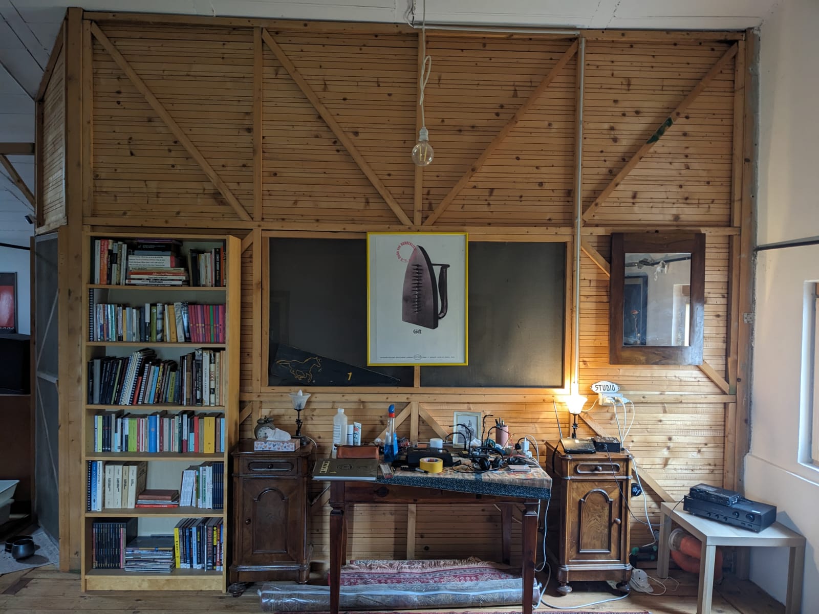

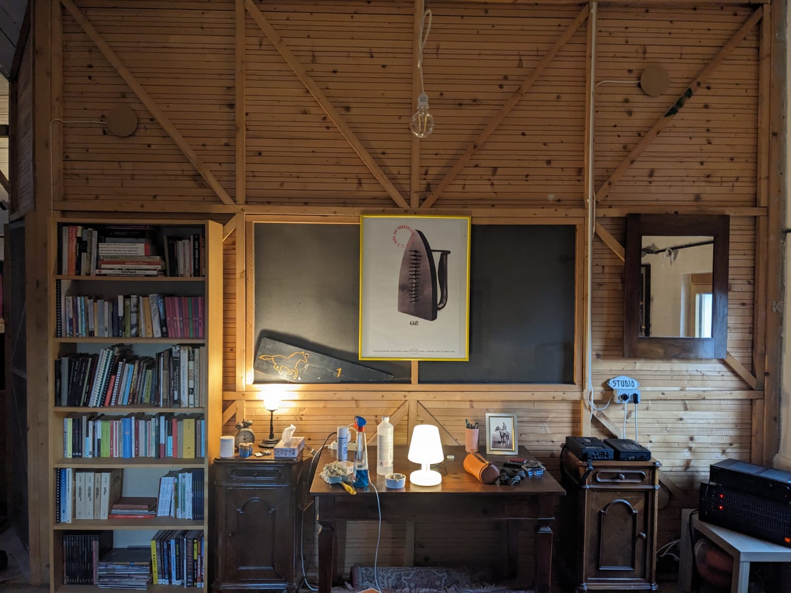

I made tests mounting the exciter on both sides of the wall, as I loved the idea of concealing the exciters inside the closet, but the loss in treble was too much noticeable, so I decided to mount them in sight. I bought four DAEX32U-4, two in series for each channel, and after some empirical testing for finding the best positions I placed the exciters on the wall. The outside of the wood wall has some grooves in it and it's not perfectly smooth, so after finding the sweet spots I prepared the area using plaster first and sandpaper after. Two are placed in the upper part of the wall, two are in the lower part, below the window level and concealed by furniture.

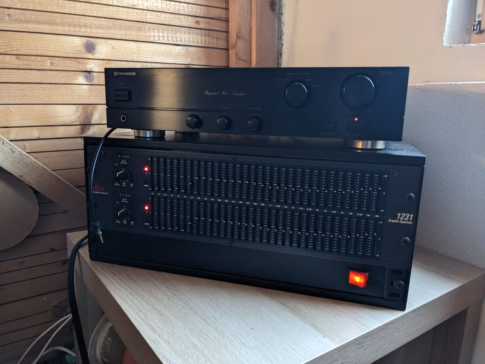

For driving the 8 Ohm loads I'm using an old Pioneer amp from 1991 which outs 2x30W @8Ohm. I noticed from the beginning that I needed to apply some kind of EQ as the wall was very prone to resonate with specific bass frequencies. I first tried with the Pioneer onboard bass control but the filtering was obviously too coarse for my needs, so I put a 31 band EQ in the equation. I found out that the 63 Hz band is the baddest, but in some way I needed to lower everything below 100 Hz to make it sound decent. Now I like the result but probably I will add a small subwoofer in the future. As last, I added some hoods to the exciters, to make them less noticeable.
Now, speaking of the listening experience... I'm close to 50, I'm a musician, I run a live music club, in some way I've been into hifi and sound stuff since I was 15, but I'm still impressed by how this cheap 4x4m wall sounds. Very natural, very loud, very clear, and everywhere. The stereo separation is quite noticeable even if the exciters are mounted on the same surface, and the sound pressure is... very different from "regular" speakers. Human voice, acoustic instruments and orchestra sound more than decent to me, electronics and heavier music are still lacking something and sometimes still can get a little confused, mostly when deep bass frequencies are directly involved. Adding a subwoofer with adjustable crossover frequency will sure make things much better.
