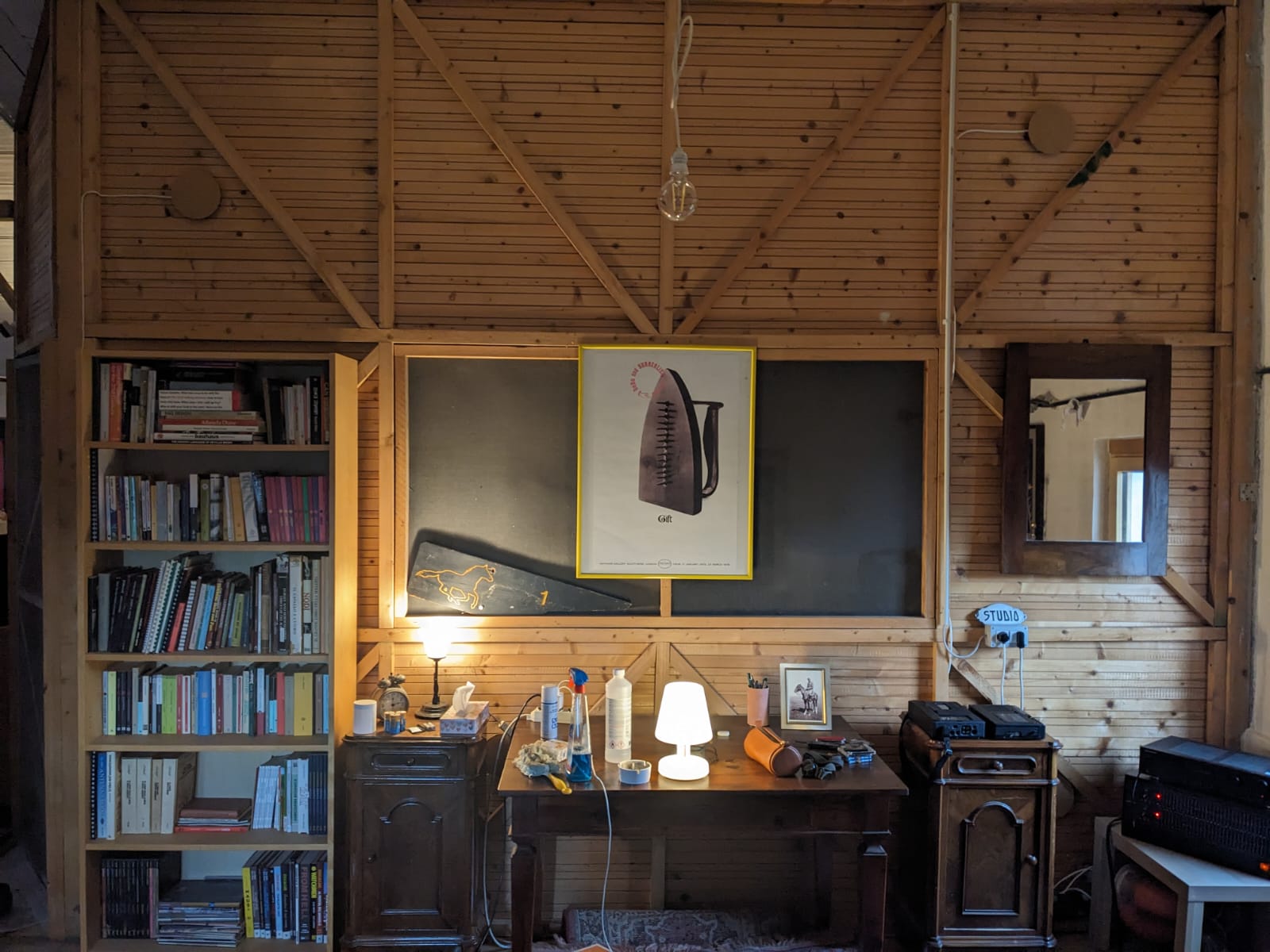

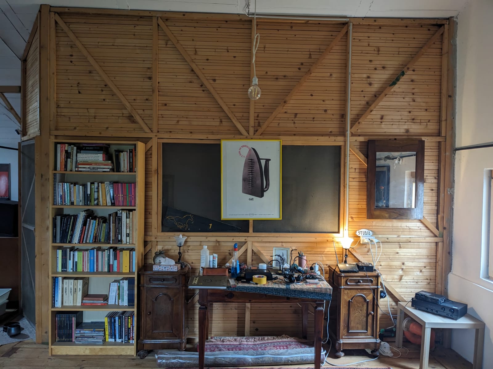

Please forgive my english, first of all. This thread got my attention months ago. I used exciters for the first time some years ago while making a large (2 sq m) plate reverb and I still had one Monacor AR-30 spare, so I tried to arrange a mono DML panel just for the fun of trying.
My first attempt was with a 100x70x1 cm poliplat sheet, which is a foam core panel with paper glued on both sides, with rounded corners and 2/5 3/5 placement of the exciter, suspended. It sounded very loud but I got bored very soon as it lacked bass and it was screaming too much in the mids, so I tried with a different material.
Take 2 was made using a 100x70x0,3 back panel of an Ikea frame, I think it's like hot pressed sawdust. It sounded much quieter than the previous one and lacked high frequencies, but some kind of bass was there and the sound reproduction was more enjoyable to my hears.
I was ready to purchase some more exciters and make a "proper" pair of stereo speakers using 2 mm plywood panels for my attic, which is an open space floor with a 4x4m room in a corner, made using interlocked wood boards 2 cm thick. I wanted to suspend the DML panels on the outside of the room (that room is a closet, not a living space), when I realized I was mounting wood panels on a wood wall, which seemed kind of redundant to me. So I tried to stick the Monacor exciter directly to the wood wall, and it sounded much better than the previous attempts: loud, clear and with enough bass for my taste, good enough for listening to some music and podcasts while working.
I made tests mounting the exciter on both sides of the wall, as I loved the idea of concealing the exciters inside the closet, but the loss in treble was too much noticeable, so I decided to mount them in sight. I bought four DAEX32U-4, two in series for each channel, and after some empirical testing for finding the best positions I placed the exciters on the wall. The outside of the wood wall has some grooves in it and it's not perfectly smooth, so after finding the sweet spots I prepared the area using plaster first and sandpaper after. Two are placed in the upper part of the wall, two are in the lower part, below the window level and concealed by furniture.
For driving the 8 Ohm loads I'm using an old Pioneer amp from 1991 which outs 2x30W @8Ohm. I noticed from the beginning that I needed to apply some kind of EQ as the wall was very prone to resonate with specific bass frequencies. I first tried with the Pioneer onboard bass control but the filtering was obviously too coarse for my needs, so I put a 31 band EQ in the equation. I found out that the 63 Hz band is the baddest, but in some way I needed to lower everything below 100 Hz to make it sound decent. Now I like the result but probably I will add a small subwoofer in the future. As last, I added some hoods to the exciters, to make them less noticeable.
Now, speaking of the listening experience... I'm close to 50, I'm a musician, I run a live music club, in some way I've been into hifi and sound stuff since I was 15, but I'm still impressed by how this cheap 4x4m wall sounds. Very natural, very loud, very clear, and everywhere. The stereo separation is quite noticeable even if the exciters are mounted on the same surface, and the sound pressure is... very different from "regular" speakers. Human voice, acoustic instruments and orchestra sound more than decent to me, electronics and heavier music are still lacking something and sometimes still can get a little confused, mostly when deep bass frequencies are directly involved. Adding a subwoofer with adjustable crossover frequency will sure make things much better.
Sorry for the long post, and thanks for all the useful info!
Nice tidy environment!
The uncluttered timber wall would provide a pleasingly resonant output. I have tried the same type of exciters, the Aiyima ones mentioned in this post and the one below, on a hollow brick wall and on a gypsum board wall. The sound was much more pleasant on the brick wall, but somewhat hollow on the gypsum wall. These exciters are designed to be placed horizontally, as they are essentially a party gadget. Aiyima refers to the aluminium plate as a shock rod. You’ll notice how it bounces here. If you want to use the Aiyima exciters, you'll need a solid support for the driver part of it.
I hope you achieve great results with the timber wall speaker! 🙂
