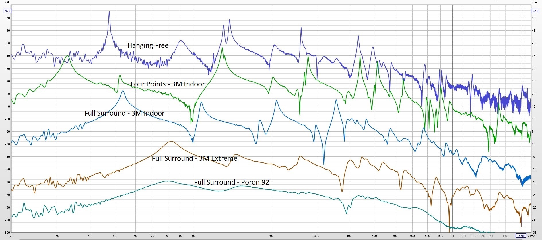

For the purposes of demonstrating each of these damping test methods, I constructed five different builds using the same panel but supported five different ways. The panel is a three layer composite with a balsa core and carbon fiber skins, about 2.1 mm thick and with dimensions of 16" x 23.5". In all tests the panel was oriented with the long direction horizontal.
The five mountings are as follows:
1.Hanging Free: Panels were hung from wires attached with small alligator clips, about 5" from the two ends of the panel.
2. Four Points 3M Indoor: Panel attached at four points to a frame using 3M Indoor double sided foam mounting tape. The four points were along the two long edges, about 5" in from the corners. The tape pieces were each approximately 3/4" square. This foam tape is quite soft and rebounds quickly when compressed.
3. Full Surround 3M Indoor: Panel attached to frame around the entire perimeter, excluding about 2" from each corner. The width of tape in contact with the frame and panel was about 0.5" wide.
4. Full Surround 3M Extreme: Similar to directly above, except using 3M Extreme double sided mounting tape. This foam tape is much firmer, and has much slower rebound than the 3M Indoor used in mountings 2 and 3 above.
5. Full Surround Poron 92: Similar to 3 and 4 above except the panel was attached to the frame using Poron 92 foam (about 0.25" thick). This foam is very soft, with very slow rebound. The width of foam in contact with the panel and frame was in this case was about 1.25" wide.

I won't go into all the details of conducting an REW impedance test here, as they can be found in the REW help file. But suffice it to say that it is similar to performing a typical frequency sweep test, except that instead of monitoring the speaker SPL via a microphone, REW monitors the electrical impedance of the panel speaker assembly. The result is a plot of impedance vs. frequency that is similar to what you see in the datasheets for conventional drivers or speakers. The big difference, however, is that instead of seeing just a single peak as you would for a convention speaker driver, the impedance curve of a panel speaker typically exhibits many, many impedance peaks. These peaks each occur at a resonance frequency of the driver/panel/mounting system. And, most importantly, the "defining" effect of damping is that damping widens the frequency range over which a particular resonance mode occurs. When damping is very low, each impedance peak will be concentrated around single frequency, and hence appear as a very tall, narrow and pointy peak in the impedance curve. When damping is higher, the impedance peaks widen, and appear as shorter, wider humps with rounded tops, instead of narrow and pointy peaks. The sharpness of the impedance peaks is the feature that best indicates the relative strength of the damping in a panel speaker system.
The overlay plot below compares the impedance curves for the five panel mountings I described above. For each of these, the exciter used was a DEAX VT25-4, mounted at the 0.4/0.4 position using a thin double sided tape.

In each of these curves, the lowest frequency peak, which appears between between about 20 and 32 Hz, is mainly due to the exciter itself, and can be largely ignored for the purposes of comparing damping levels in these panels. But all the other peaks are associated with the resonance modes of the panel itself, as hung or mounted.
As expected, the top curve (Hanging Free) exhibits very sharp peaks, indicating very low damping levels, as expected. Similarly, the second curve from the top (Four Points...) exhibits almost equally sharp peaks, and again indicating very low damping. Even the third curve, despite having been mounted to the frame virtually all the way around the perimeter, still exhibits pretty sharp peaks. Clearly not as sharp as the previous two, but still quite sharp. The fourth curve (Full Surround -3M Extreme) finally shows significant spreading of the impedance peaks, with rounded tops, indicating a clear increase in damping from the previous builds. Finally, the bottom curve (Full Surround - Poron 92) shows even more spreading of the impedance peaks, indicating the greatest level of damping in this set.
Here are a few final notes regarding exciter placement for this test. One is that the height of the peaks (not just the sharpness) is also an indicator of damping (the higher the peaks the lower the damping is). But be aware also that the height of each peak on an individual curve is also determined largely by the location of the exciter on the panel. That is to say, for a particular panel/frame mounting, if you move the exciter, some peaks will get taller, and others will get shorter. That doesn't mean that moving the exciter decreased the damping for one mode, and increased it for the other. Rather, it simply means that you moved the exciter closer to an antinode of one mode, and closer to a nodal line of the other.
A second note is that you can do this test equally well with the exciter at virtually any position on the panel. As I described above, using a different position will excite some modes more effectively (taller peaks) and others less effectively (shorter peaks), but the overall sharpness or roundness of the peaks will remain virtually the same regardless of the exciter position.

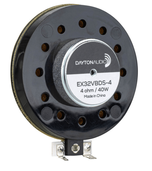

BTW they use this https://doc.soundimports.nl/pdf/bra...VBDS-4/dayton-audio-ex32vbds-4-spec-sheet.pdf low freq exciter. Another clever design idea, I think. Because of the steep HF roll off they can use a simple first order high pass X-over for the "tweeter" and leave the "woofer exciter" without any filtering. On my panels I use two Xcite 4 drivers, but 2 way active X-over-ed. Bit complicated.

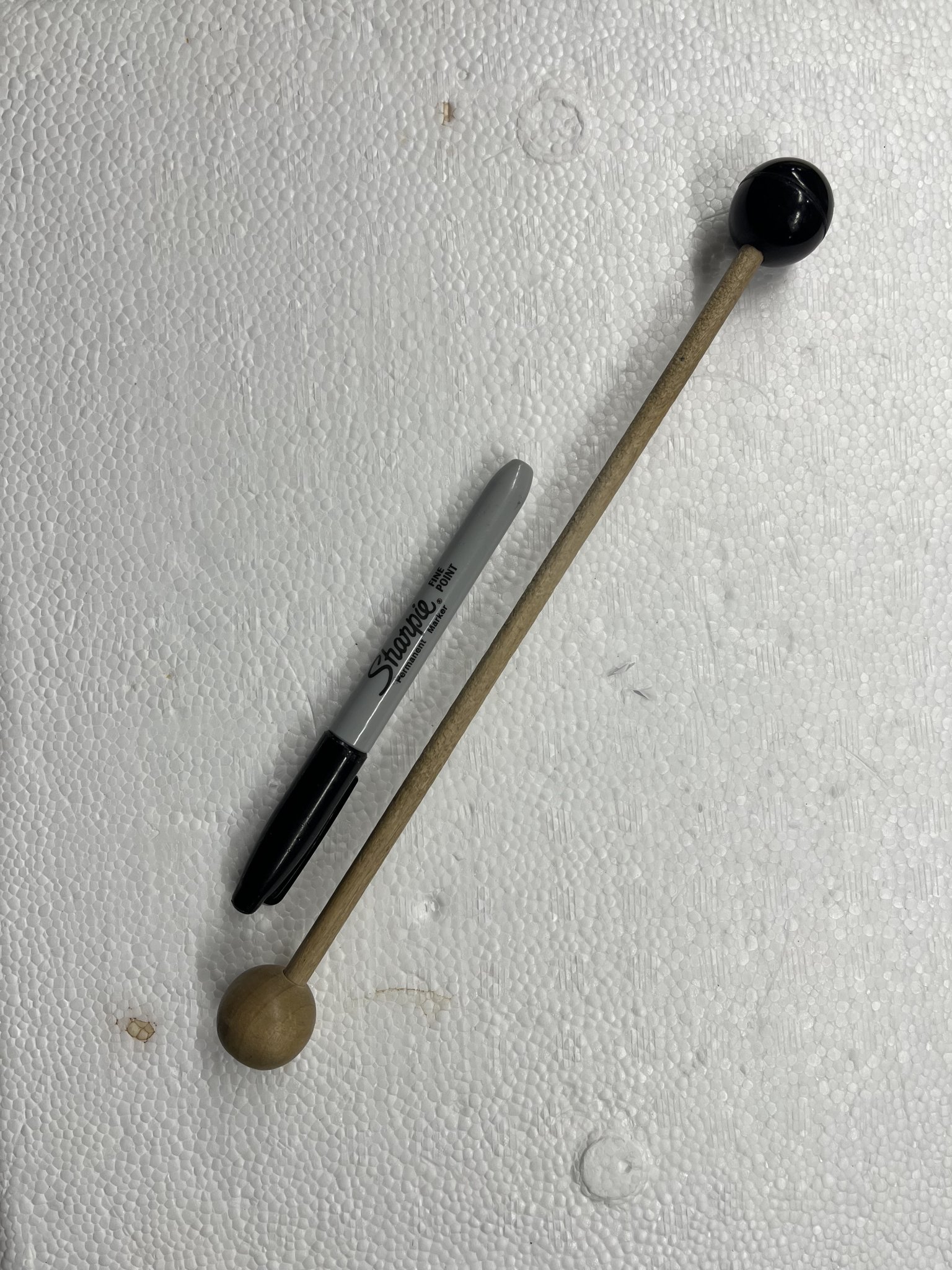

The Tap Test uses REW but requires only a microphone and my rubber ball hammer for hardware. In fact, you don't even need an exciter. I actually prefer to perform the tap test without an exciter attached, but it can be performed either way. Typically I observe that the exciter will affect the first resonance peak, but has little to no impact on the other peaks. The curves shown below were generated without an exciter attached.

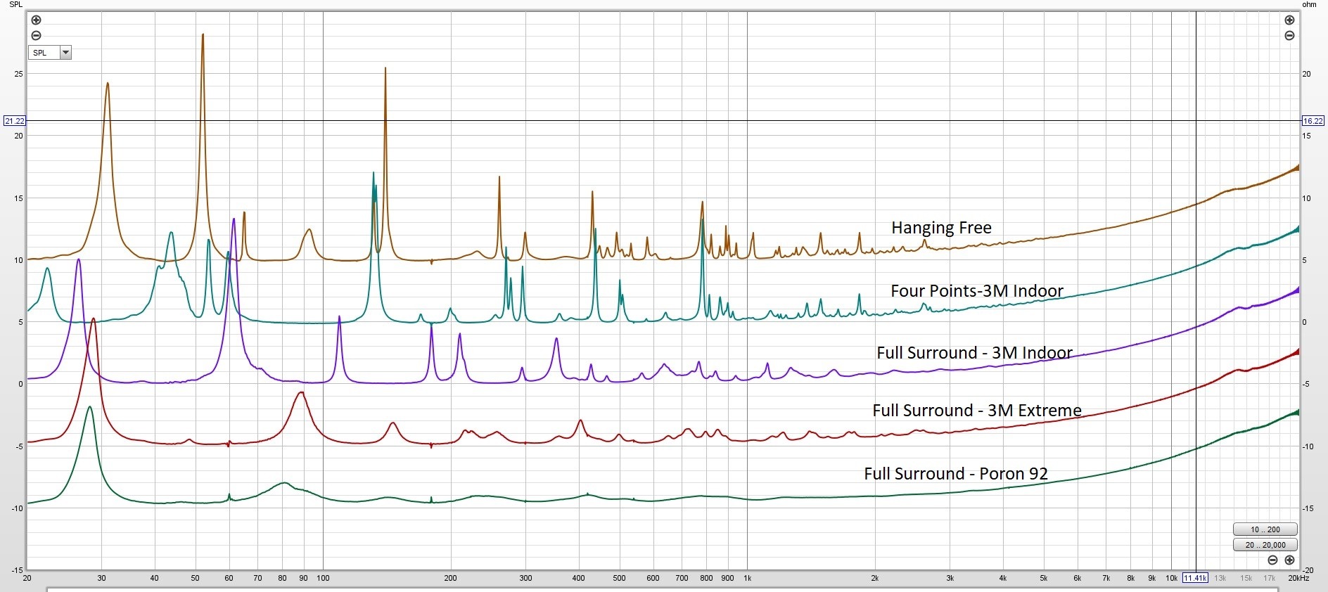

Tap Test Method and Results
Rather than use the normal SPL frequency sweep measurement, I use the RTA mode of REW. Here are the steps in the test:

Discussion
I won't go into great detail, but the results show almost exactly the same thing as the Impedance Test results show. Each curve has peaks at each of the resonance frequencies of the panel assembly. The first two curves (from the top down) exhibit very sharp peaks, with a very slight increase in damping for the third curve (Full Surround, 3m Indoor). The lower two show much broader, rounder peaks, indicative of significantly increased damping. One interesting difference is that this test shows not just peaks (like the Impedance Test) but also dips in the frequency response which are likewise sharp with little damping but rounder with more damping.
With respect to the location of the mic and the tapping location, the effect is similar to that of the location of the exciter in the impedance test. That is, choosing different locations for tapping and mic-ing will simply change which modes are driven (and picked up), and hence where along the frequency range the strongest peaks are. But generally it doesn't effect how sharp the peaks are.
The aspects I like best about this test are that it shows the degree of damping equally well as the impedance test, but doesn't require the impedance rig, or even an exciter. As I mentioned above, the other feature I like is that it can also be used to determine the elastic properties of panels.

BTW they use this https://doc.soundimports.nl/pdf/brands/Dayton Audio/EX32VBDS-4/dayton-audio-ex32vbds-4-spec-sheet.pdf low freq exciter. Another clever design idea, I think. Because of the steep HF roll off they can use a simple first order high pass X-over for the "tweeter" and leave the "woofer exciter" without any filtering. On my panels I use two Xcite 4 drivers, but 2 way active X-over-ed. Bit complicated.
HvdZ
Sure does look like it!
Eric

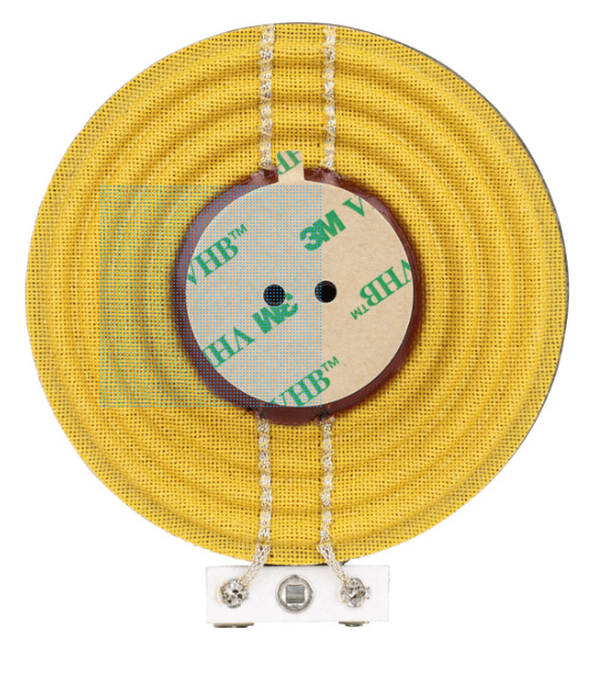

If I compare the specs it looks more like they are using this PUI exciter:BTW they use this https://doc.soundimports.nl/pdf/brands/Dayton Audio/EX32VBDS-4/dayton-audio-ex32vbds-4-spec-sheet.pdf low freq exciter. Another clever design idea, I think. Because of the steep HF roll off they can use a simple first order high pass X-over for the "tweeter" and leave the "woofer exciter" without any filtering. On my panels I use two Xcite 4 drivers, but 2 way active X-over-ed. Bit complicated.
https://puiaudio.com/product/exciters/asx05408-hd-r
I would also like to know what exciter are they using for the tweeter?

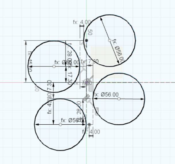

Just looking at this right picture, I was wondering the reason of the tape shape which is almost a disk which is not the usual shape. The answer is "it is a model with the interchangeability feature". Then came a second question : what is then the behavior in that case of the central area and the consequence on the panel. There is no more possibility of drum effect. Are such exciters able of HF?
Tried to get a decent drawing out of Fusion but not so easy :\Leob.
