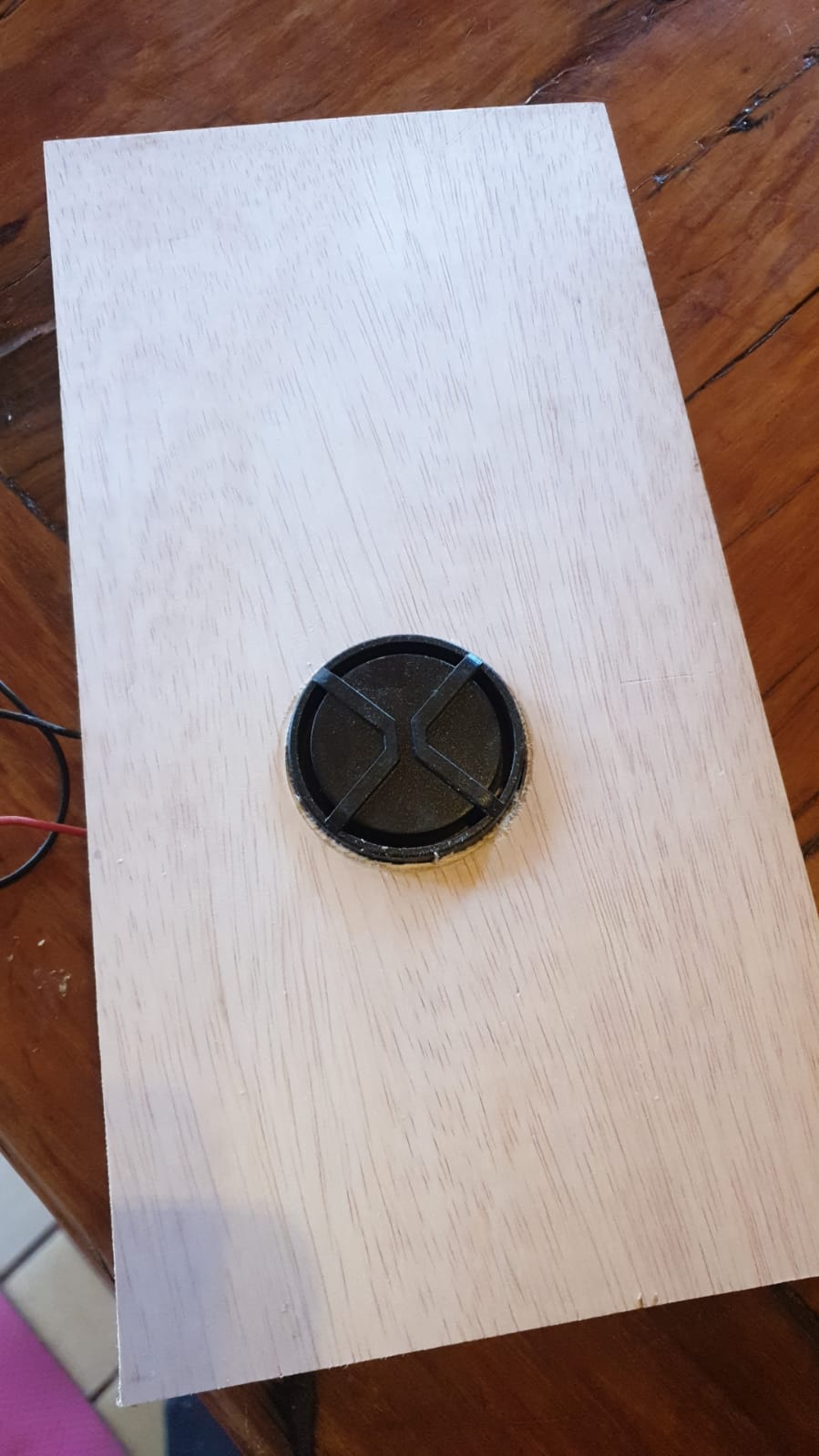

Eucy
Houston, we have a problem...

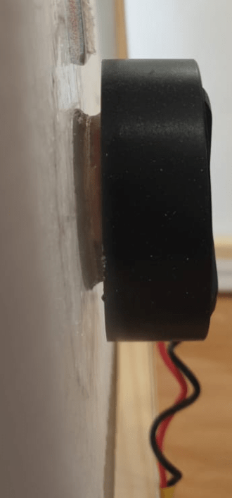

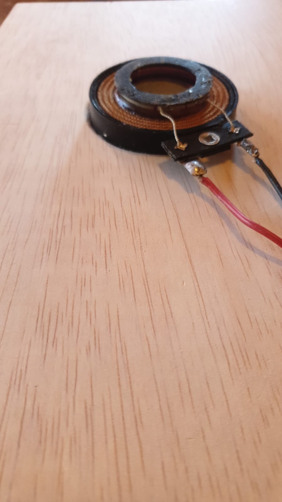

I was running this panel quite hard over the weekend. The driver has started sagging and distorting. I will have to add some kind of brace or support to future drivers.
Andrewas running this panel quite hard over the weekend. The driver has started sagging and distorting. I will have to add some kind of brace or support to future drivers.
Please, for a quick and simple fix, do try a zip tie anchored to the panel and the back of the exciter by whatever means at hand. The first few I used I wrapped in masking tape to dampen them, now I don't bother.

Thanks, yes, quick and simple fixes are no problem.Andre

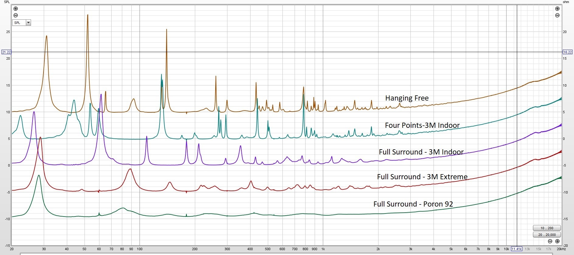

On this forum we are often talking about the concept of damping. People will say for example that they did such and such which had some net effect that they attributed to a difference in damping. But it occurred to me that while we often talk about damping, rarely if ever does anyone include test results with clear, direct, evidence that whatever change they have made actually does increase (or reduce) damping. In such cases, how are we to know that it was truly damping that caused the change observed, rather than simply an increase in panel mass, or a change in the constraints that simply shifted the natural frequencies, rather than actually damping anything?
In this and following posts, I want to share several test methods that can be used to get a pretty clear indication of how much damping is actually increased or decreased by a change in a DML/bending wave speaker design. Spoiler alert, none of these methods is a conventional frequency response curve at 1 meter. This is not to say that damping effects do not show up in such a test, but rather that IME there are much better tests for unambiguously detecting the degree of damping in a DML/bending wave speaker construction. What I'm hoping for is to encourage others of you to try these tests, and maybe even show some results of these tests comparing your own builds, especially when you are trying to increase or decrease damping in your designs. Or even if you simply wonder if some change you made actually influenced damping, even though you never intended for that.
In short, the three tests are:
I'll start in this post with the Impedance Test, and demonstrate the other two tests in later posts. Unfortunately, the Impedance Test does require a special "impedance rig" described in the REW help file. It's not too hard to build, but it may be more effort than some of you want to spend. If so, don't worry, because you can get much of the same information from either of the other two tests. I'm starting with the Impedance test mainly because the results are the easiest to plot and compare. Some of you may recall a previous post in which I compared the internal damping of various panel materials, here:
https://www.diyaudio.com/community/...s-as-a-full-range-speaker.272576/post-7499940
For the purposes of demonstrating each of these damping test methods, I constructed five different builds using the same panel but supported five different ways. The panel is a three layer composite with a balsa core and carbon fiber skins, about 2.1 mm thick and with dimensions of 16" x 23.5". In all tests the panel was oriented with the long direction horizontal.
The five mountings are as follows:
1.Hanging Free: Panels were hung from wires attached with small alligator clips, about 5" from the two ends of the panel.
2. Four Points 3M Indoor: Panel attached at four points to a frame using 3M Indoor double sided foam mounting tape. The four points were along the two long edges, about 5" in from the corners. The tape pieces were each approximately 3/4" square. This foam tape is quite soft and rebounds quickly when compressed.
3. Full Surround 3M Indoor: Panel attached to frame around the entire perimeter, excluding about 2" from each corner. The width of tape in contact with the frame and panel was about 0.5" wide.
4. Full Surround 3M Extreme: Similar to directly above, except using 3M Extreme double sided mounting tape. This foam tape is much firmer, and has much slower rebound than the 3M Indoor used in mountings 2 and 3 above.
5. Full Surround Poron 92: Similar to 3 and 4 above except the panel was attached to the frame using Poron 92 foam (about 0.25" thick). This foam is very soft, with very slow rebound. The width of foam in contact with the panel and frame was in this case was about 1.25" wide.
Impedance Test Method and Results
I won't go into all the details of conducting an REW impedance test here, as they can be found in the REW help file. But suffice it to say that it is similar to performing a typical frequency sweep test, except that instead of monitoring the speaker SPL via a microphone, REW monitors the electrical impedance of the panel speaker assembly. The result is a plot of impedance vs. frequency that is similar to what you see in the datasheets for conventional drivers or speakers. The big difference, however, is that instead of seeing just a single peak as you would for a convention speaker driver, the impedance curve of a panel speaker typically exhibits many, many impedance peaks. These peaks each occur at a resonance frequency of the driver/panel/mounting system. And, most importantly, the "defining" effect of damping is that damping widens the frequency range over which a particular resonance mode occurs. When damping is very low, each impedance peak will be concentrated around single frequency, and hence appear as a very tall, narrow and pointy peak in the impedance curve. When damping is higher, the impedance peaks widen, and appear as shorter, wider humps with rounded tops, instead of narrow and pointy peaks. The sharpness of the impedance peaks is the feature that best indicates the relative strength of the damping in a panel speaker system.
The overlay plot below compares the impedance curves for the five panel mountings I described above. For each of these, the exciter used was a DEAX VT25-4, mounted at the 0.4/0.4 position using a thin double sided tape.
Discussion
In each of these curves, the lowest frequency peak, which appears between between about 20 and 32 Hz, is mainly due to the exciter itself, and can be largely ignored for the purposes of comparing damping levels in these panels. But all the other peaks are associated with the resonance modes of the panel itself, as hung or mounted.
As expected, the top curve (Hanging Free) exhibits very sharp peaks, indicating very low damping levels, as expected. Similarly, the second curve from the top (Four Points...) exhibits almost equally sharp peaks, and again indicating very low damping. Even the third curve, despite having been mounted to the frame virtually all the way around the perimeter, still exhibits pretty sharp peaks. Clearly not as sharp as the previous two, but still quite sharp. The fourth curve (Full Surround -3M Extreme) finally shows significant spreading of the impedance peaks, with rounded tops, indicating a clear increase in damping from the previous builds. Finally, the bottom curve (Full Surround - Poron 92) shows even more spreading of the impedance peaks, indicating the greatest level of damping in this set.
Here are a few final notes regarding exciter placement for this test. One is that the height of the peaks (not just the sharpness) is also an indicator of damping (the higher the peaks the lower the damping is). But be aware also that the height of each peak on an individual curve is also determined largely by the location of the exciter on the panel. That is to say, for a particular panel/frame mounting, if you move the exciter, some peaks will get taller, and others will get shorter. That doesn't mean that moving the exciter decreased the damping for one mode, and increased it for the other. Rather, it simply means that you moved the exciter closer to an antinode of one mode, and closer to a nodal line of the other.
A second note is that you can do this test equally well with the exciter at virtually any position on the panel. As I described above, using a different position will excite some modes more effectively (taller peaks) and others less effectively (shorter peaks), but the overall sharpness or roundness of the peaks will remain virtually the same regardless of the exciter position.
Anybody have any similar impedance results to share? Or want to give it a try?

Well damnation, I've yet to find an upmarket zip tie! 🤭Thanks, yes, quick and simple fixes are no problem.
I will be applying solution that would allow the panels to sit comfortably next to Focals or B&W's or something.
This was just a quick test to see of the hole saw was the right size. I'll build rear panels (both for driver support and for an air-spring effect) to fit across the back of the panel.But I'm very interested in seeing your solution !!👍
And, given @Veleric 's post on damping, I'll also check to see what effects this rear panel will have on resonances and on the impedance curve.
