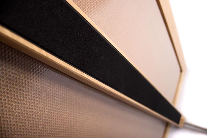

Yep! almost like bee hive panels with a layer of fiberglass.

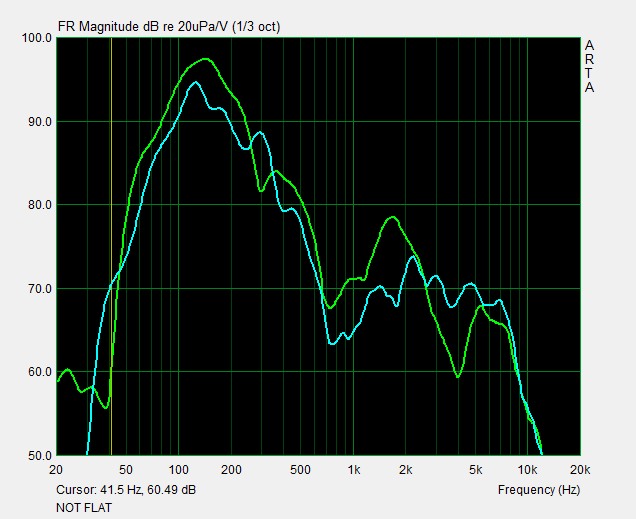

At the least I could run some frequency sweeps for each panel before I change it around yet again. While I use active EQ almost always, I know what low (or even mid) bass sounds like and I hardly hear any, even with EQ!
Meanwhile, I have attached the 12" sub to a 4x8' sheet of "R-Matte Plus-3" foam board but not yet hooked up to test.

For my current "full range" on wall experiments ("campaign sign" is offline now, current build has different "exciters" each is a Scosche HD5253A "car" driver, they are 5 1/4 3-ways from Wal-Mart. Well they are "one-way" after I remove the dreadful mid and tweeter. About $25/pair.). Also am doubling # of drivers per panel and putting a NU3000 in service instead of tiny class D amp
Meanwhile, I get bass out of my 4x8' with 12" sub but not impressive. I will admit I am doing many things "wrong", (1) not using proper exciters; (2) very possibly my mounting: I have voice coil (piston) in center and four points of contact where basket's screws would connect in a normal panel. This no doubt damps resonances more than if my "basket" were connected far away from driving force.
