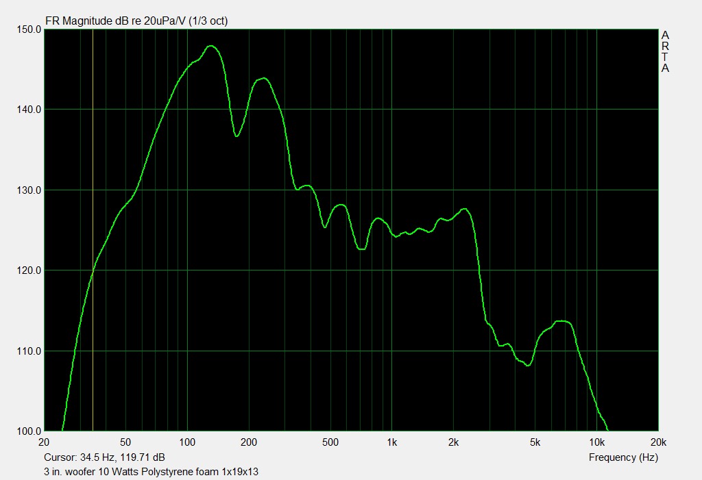

XRK971: I know it is your material, but other threads say that FC is not the best. While there is no consensus (eg. some say glass is great, others say "no"), it seems that thin, rigid, light is best. There are trade-offs of course. No doubt carbon fiber would be best, can anyone afford a 4x8' sheet 🙂 I vote for expanded polystrenge (XPS?) -- available in big sheets, very cheap. Some have foil facing (I have wondered if anyone could use it to make a ready-made planar magnet or electrostatic panel?) and coroplast can be free (unless you get arrested :darkside: )
I give the "speaker cone full of Gorilla Glue" an "F" for results: too much attenuation. For my two remaining drivers I am going to try the cat food tin, a variation on what might be best (xrk's suggestion to use a puck). I don't play hockey, so puck it!

Es para seguir utilizando el sonido emitido por la bocina en si, pero reforzar los bajos con una membrana mas grande al fondo de un baffle abierto (un marco de 3 pulgadas de fondo). En si, un tambor en toda la parte posterior del gabinete.
Help me translate, here is my try.😛
I still using the sound of the small driver, but, transmiting the low freq. to the back panel (the drum) it is a sheet of polipropylene foam (6x4x1) mounted on a frame 3 inches deep..Prototype disassembled to build another one, my goal is to invent the smaller bluetooth speaker with real deep bass. I think I already did it🙄. maybe to patent😕. I want to buy the Bose Soundlink mini to compare but is expensive for me.🙁
