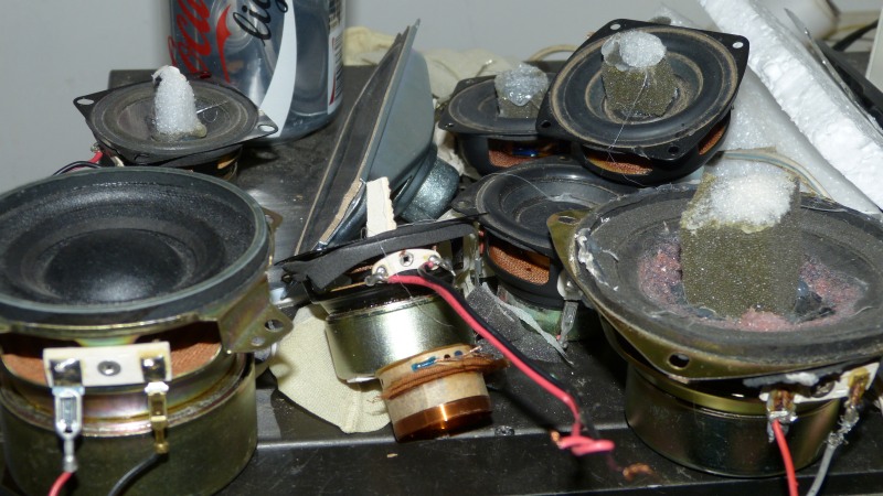

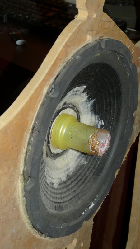

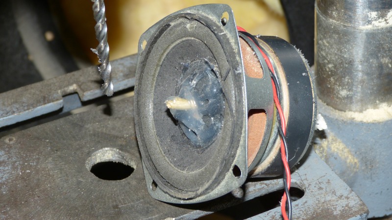

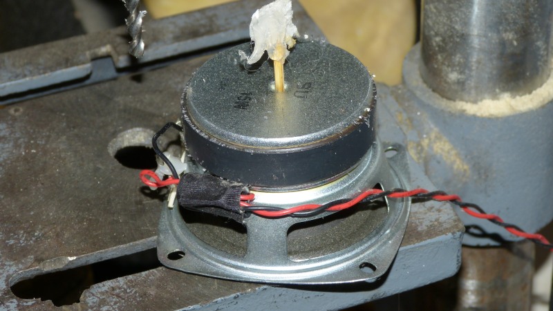

I've been reading the NXT thread at audiocircle and ... fun! I have yet to buy "proper" exci ters because...I am still destroying my own spare parts 🙂
Somewhere in that thread it mentioned the "broken speaker" method. Having none of those, and quickly tiring of the 12" sub (meh!) I browsed for the next likely victim. Not having any broken drivers, I grabbed two Bose 901 (type) full rangers -- many people in this forum would say they are the next best thing to a broken driver 🙄 -- and have done unto them just like I did with the subwoofer: cat food tin, Gorilla Glue and illicitly acquired sign from last year's elections 🙂
In the aforementioned thread there is much discussion about mounting the exciter to the panel. Having never seen an exciter, I am not completely sure of what's going on. However, since I have some experience with the "broken driver" method, I have some qestions: many of the exciters rely on inertia of their mass to transmit the vibration? Tsk tsk. Much more efficient would be if the panel is "mostly" connected to the voice coil and we have a substitute for the "surround". Here the crystal ball grows foggy...
At issue is the added mass of the panel upon the voice coil assembly, maybe not so much if the voice coil will remain vertical but most of us probably will have the panel more or less facing us, so voice coil goes horizontal. Well, not quite, since it has several grams added mass pulling it down. Thus the need to better affix the basket to the panel somehow....and minimize damping of said panel.
Since tuning the panel is somewhat hit-or-miss, here is an idea: if some damping is needed anyway, it can be supplied by the mounting points of the basket (new "spider"?) for the combined contriviance.

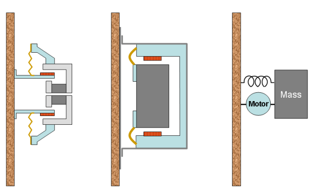

Here is a sketch to show the structures of the exciter and bass shaker I have on hand:
I haven't actually dismantled them, but I guess it's reasonable enough for how they work.
The cheapo tiny exciter is on the left, its VC is exposed and intended to be coupled with the panel. For itself, it's "moving coil" structure.
In the middle is the Dayton bass shaker I have. Its VC is fixed on the inner wall, while the magnet block is suspended by several spiral-shape plastic cantilevers. So, this can be seen as "moving magnet" structure.
No matter they are MC or MM, when coupled with panel, eventually it's a mass mated with a spring / motor onto the panel.
So, the inertia of the mass, resilience of spring, and the motor are cooperating to deliver the driving force.
