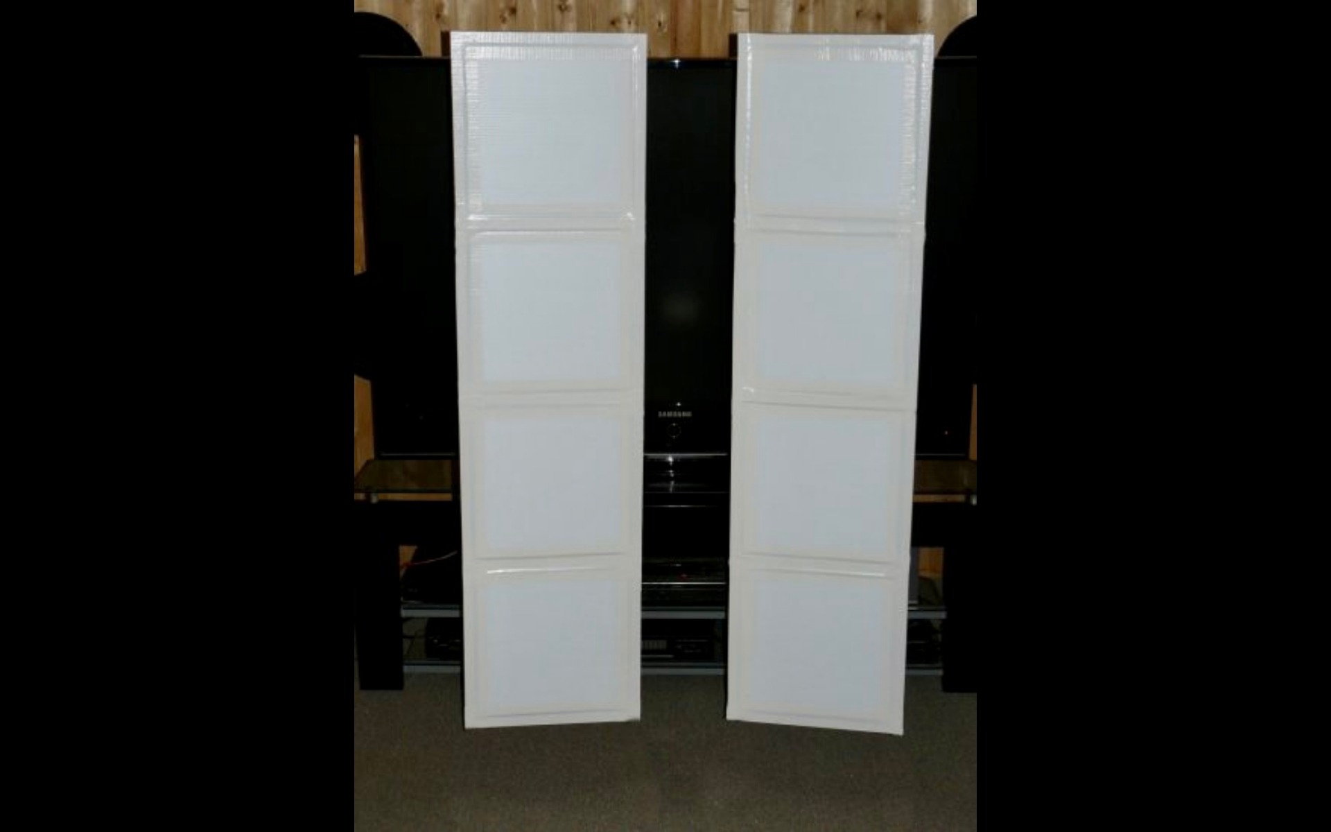

I've been playing with DML's for about fifteen years.
It is my opinion that one exciter per panel yields the best results.
Here is a photo of a prototype pair. I used corrugated plastic for panels. (Not the best material.)
stacked four panels isolated from each other. One exciter per panel. All panels were suspended
with duct tape.
They sounded pretty good and had plenty of volume. Bass was decent to 70hz.
