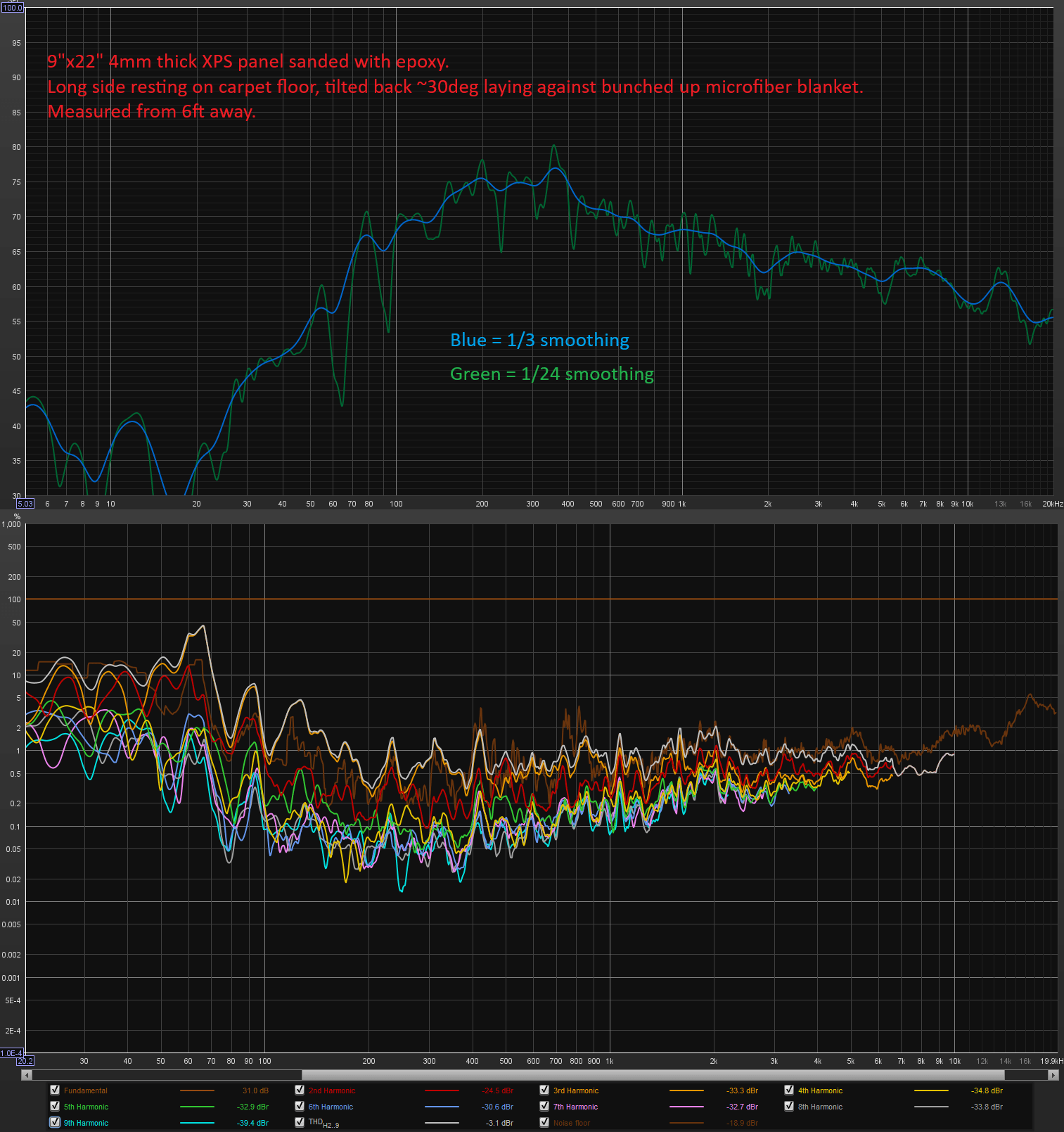

I'm experimenting with different honeycomb panels, and I get the impression that the material makes more difference to the FR than the aspect ratio/size. For instance I made a 4 mm thick panel from higher weight honeycomb nomex than my 3 mm panels, and it's bass light, and has a very pronounced and annoying peak at 3 kHz. Changing the dimensions didn't make a difference to the peak. The panels shouldn't be to stiff to get enough bass - or so it seems.
My first nomex paper panel that "sounded" really good has ridges on the surface - a random pattern of bumps because I used to much epoxy, It pooled under the paper with air bubbles in between. Could it be that that accidentaly is a good way to "randomly" dampen the panel? It still is the best effort so far. It gave an immidiate "This sounds really nice" reaction. Has anyone a clue what might be happening? I'll try to make another "proper" panel, and to mimic the ridges with a textured roller and thickened epoxy.
If I manage to get a similar sounding panel as my first one I might keep that as "the standard". This panel thing is so complex. It might be best to stick with what (found by accident) works OK.
BTW the panels I make are about 450 g/m2 now, so building lightweight is doable.
BTW II The response of the panels changes quite a lot in the first days after making the panel, because of the epoxy slowly hardening to it's end value. When cured for 24 hours there's not much HF, and the panel sounds cardboard-y. Two days later the HF by magic has appeared!
