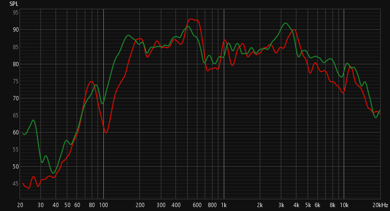

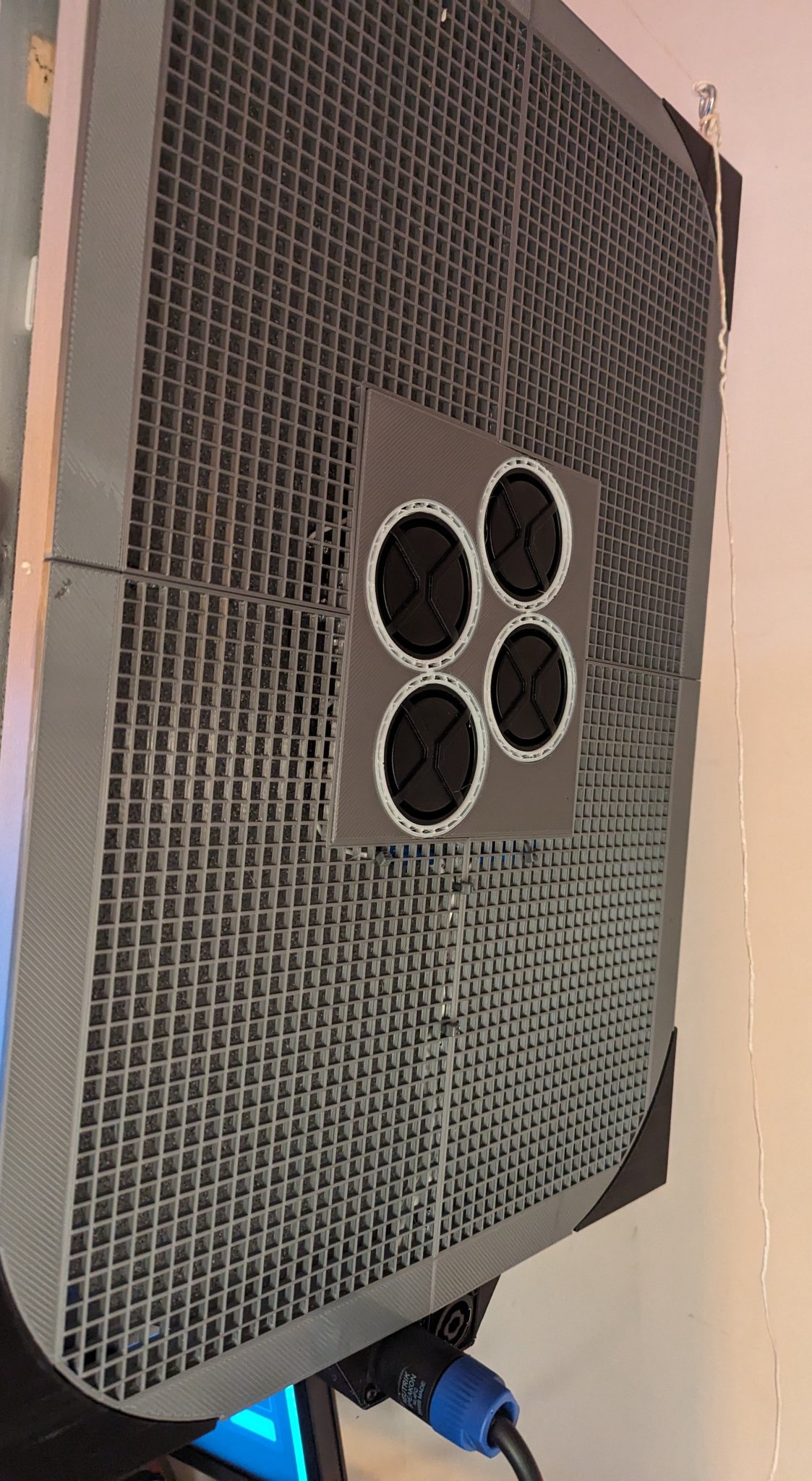

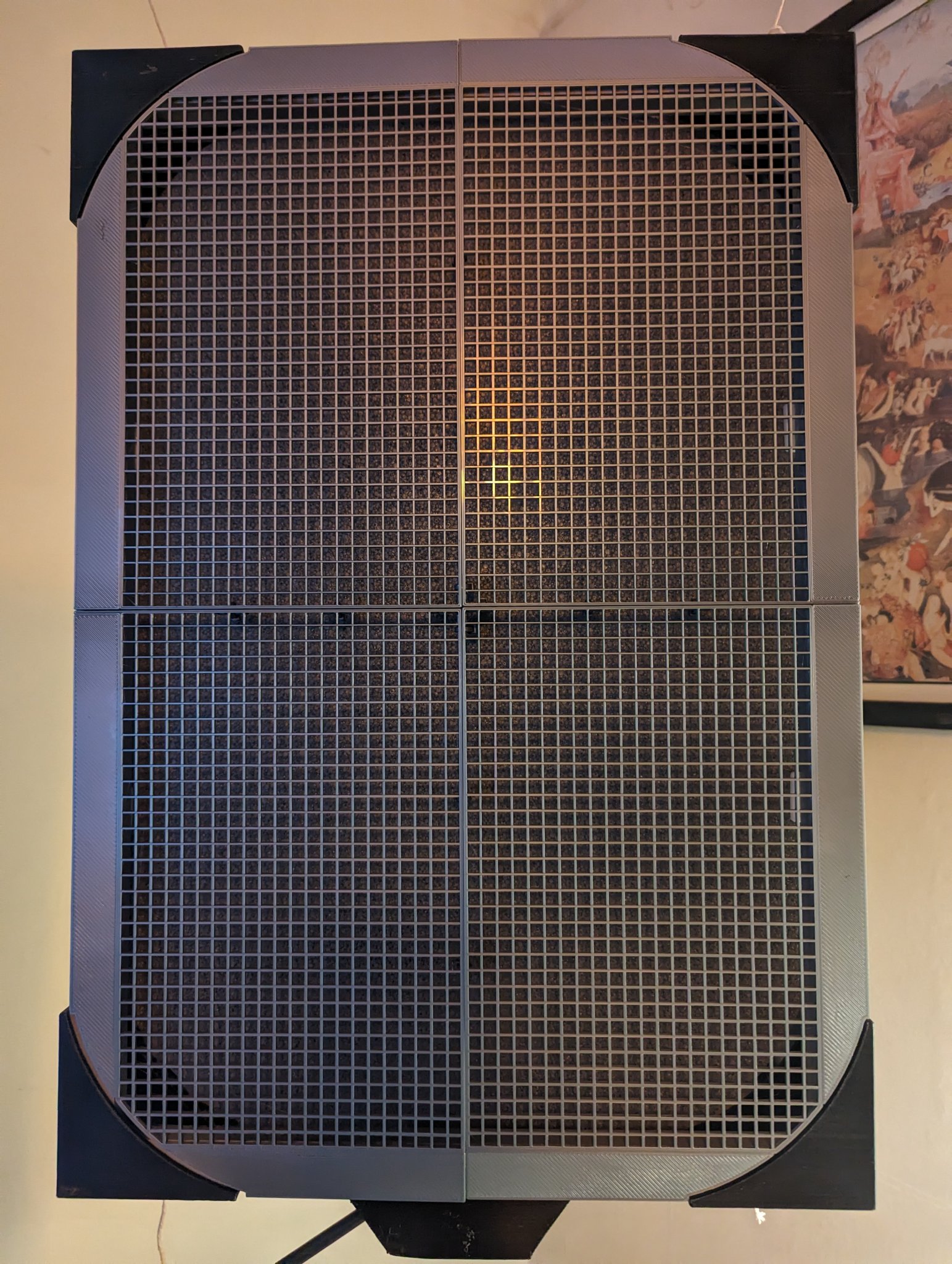

Did some sweeps in REW with the X32-4 panels. Both are using the provided VHB tape, and mainly wanted to look at differences between the suspended and free exciters. Unfortunately I did also change position of the plate suspension a little bit, which muddies the result.
First here are som pics of the panel with grill and suspension of the exciters:
And here are the TPU pads holing the pate in place:
It was a bit tricky to get the backplate with cabling in place so had to make a desperate solution with zip ties, but know to assemble them in the opposite order next time so I can make it tidy.
FR is not looking that good though. I already noticed with the first test plate I made without the suspension of the exciters that they where lacking below 150Hz, and suspension did not seem to help. In fact the suspended plates are worse, but that could also be down to the fact that the free exciter plates have been conditioned, or that I moved the plate suspension about 7mm towards the centre of the plate.
Started conditioning the new plate and will measure again later and see if that makes a difference.
The suspended plates generally have more uneven response, but does sound better to my ears. Using glue instead of VHB tape should improve the HF response a little, but not sure what I can do about the lack of response below 150Hz.
I have not had that problem on any of the plates using the Daytons, so I suspect that it could be due to stiffer suspension on the Xcites, in which case some more conditioning might help a bit. Or it is the change to plate suspension, so will test some changes to that. My subs will handle 150Hz without problem, and the plates does sound great despite the rough response, especially with some EQ, so I guess I can live with it.

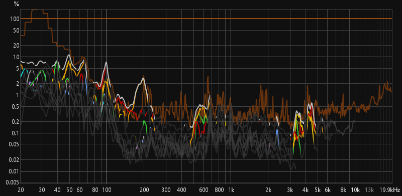

Distortion looks very good though:

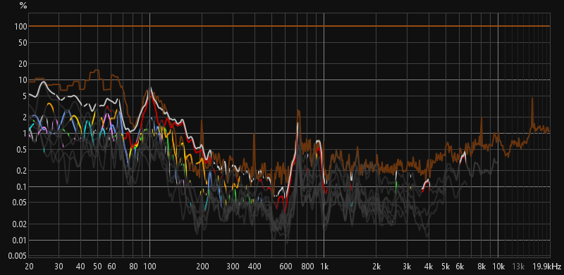

And even better on the suspended version:

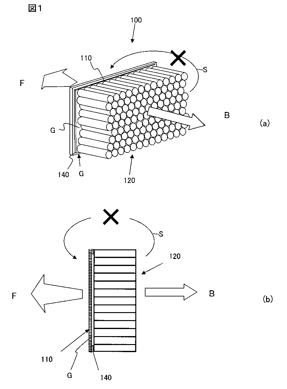

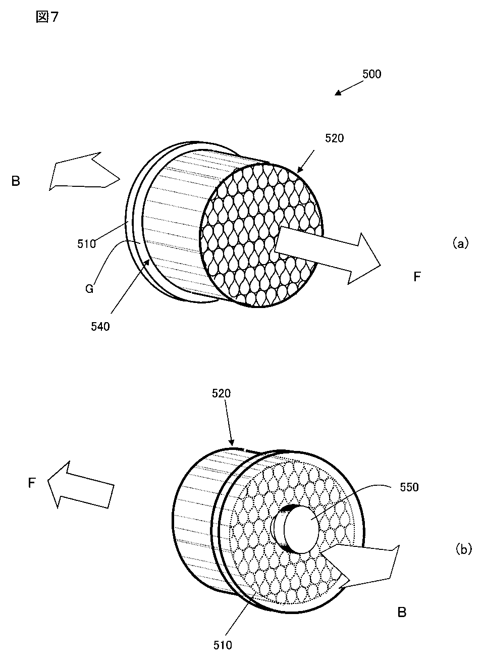

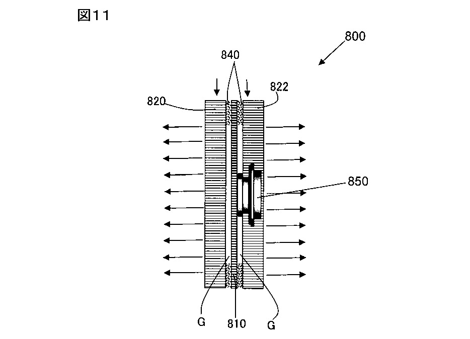

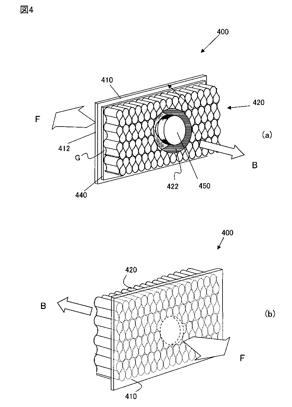

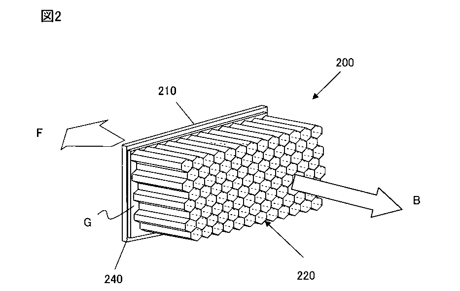

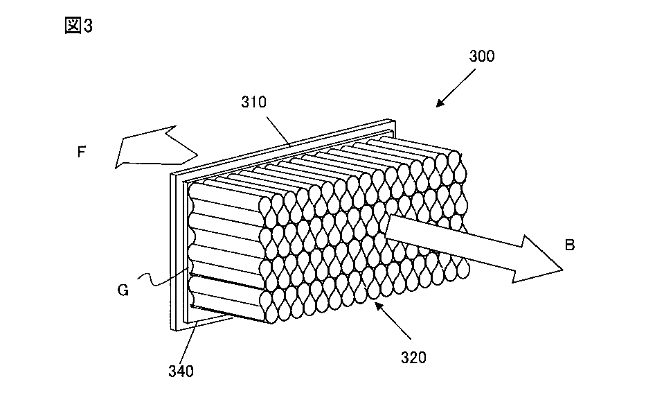

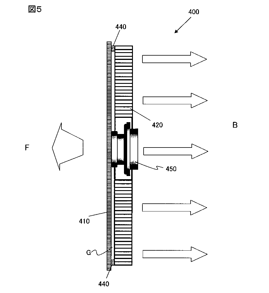

Japanese DML/Flat panel loudspeaker patents - 1/? (Adding tubes to improve DML performance)
While browsing through the thread's catalog of patents, I suddenly had an idea. Japanese manufacturers have worked with flat panel speakers for several decades, and some good ideas may be stashed away in Japanese patents. A quick search in Japanese led me to several patents from a certain Katsuhiko Umeda on Google Patents. Patent no. JP2009206914A suggests adding a layer(s) of honeycomb tubes to the panel for some benefits. Namely:
Other examples discussed include:
Prevent the "wrap-around" of sound waves, which causes poor low-frequency characteristics in small speakers
The patent's proposed "flat panel speaker" and "ducting system":Provide directivity in the mid-and-low frequency range to reduce unnecessary sound wave diffusion and subsequently, noise in the vicinity outside the intended area of the broadcast (outdoor concerts and annoucement broadcasts are given as examples)
The flat panel speaker of the present invention consists of a diaphragm panel, a vibration exciter mounted on the diaphragm panel, and a number of tubes arranged through a gap against one of the acoustic emission surfaces of the diaphragm panel. The ducts are made of an elastic material that seals the gap between the diaphragm panel and the surrounding ducts.
A diffusion suppression duct device, consisting of numerous tube-like ducts, is attached to the radiating surface of the diaphragm panel with a gap. The area around the gap is sealed with a sealing material.
With this device, the air inside the duct vibrates due to the sound pressure of the diaphragm, sound pressure is introduced into the interior of the duct.
The sound waves S are reflected off the inner surface of the duct, and the sound waves that hit each other interfere with each other, similar to the effect of a common "megaphone". The ducts are parallel, thin, and long, so they do not have the effect that a typical "megaphone" has.
The sound waves are emitted from the back surface B. In this process, the sound waves are oriented in the direction of the duct.
This phenomenon is similar to the principle that light traveling on the inner surface of a honeycomb core with a metallic mirror surface is directed by reflection and interference.
The tubular duct is made of a honeycomb core, and the axis of the tubular duct is formed at an arbitrary angle to the diaphragm panel. Furthermore, the axis of the tubular duct can be formed to have a focal point.
The cross sectional shape of the tubes can be circular, hexagonal, or quadrilateral.
the length and thickness of the tube must be selected according to the intended use of the speaker. If the tube is thin, reflections in the high frequency range, etc., will appear and affect the diaphragm and interfere with sound quality.

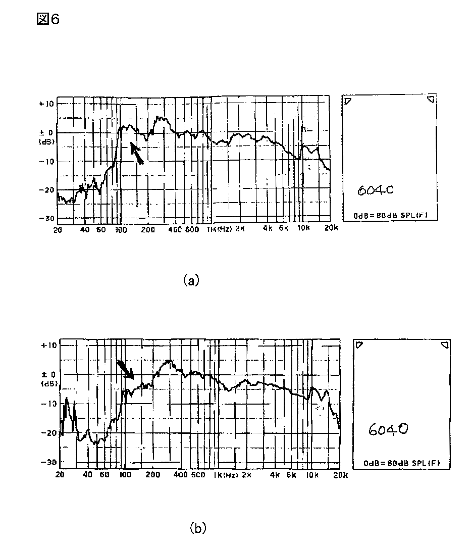

The narrower the distance between the diaphragm panels and the diffusion suppression duct devices was assumed to have a large effect, so experiments were conducted by varying the gap in various ways. In the experiment, it was confirmed that the narrower the gap, the less sound waves leaked from the gap, and thus the directional effect was greater. However, the limit is about 2 mm from the amplitude of the diaphragm.
Example no. 1, a panel for listening to music:To prevent sound waves from leaking from the gap, a sponge-like material was used around the diaphragm panels to prevent the sound waves from leaking
You can refer to file F1 before and after. (a) is after the modification, which significantly alters low-end performance and attenuates the mid-range. It also worsens the frequency roll-off and dip between 8-10KHz (likely due to the weight of the tubes damping the panel).The size of the diaphragm panel is 40 cm in height and 60 cm in width...the core thickness (tube length) was 40 mm and the tube diameter (cell size of the core) was 8.4 mm, with good results...The improvement was about 10db in the range of 50Hz to 300Hz.

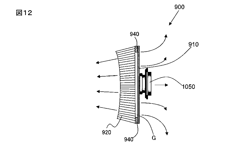

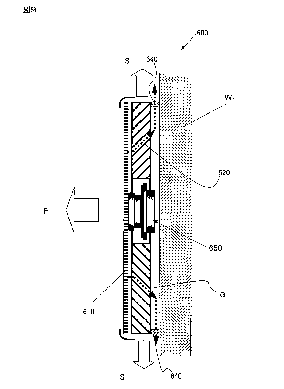

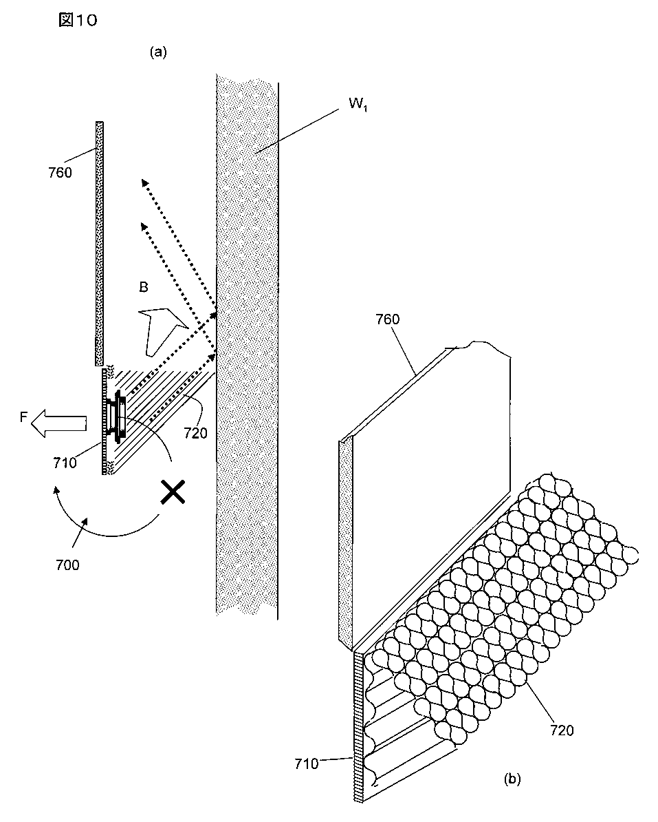

- Circular panel, 20 cm in diameter, with 80x8.4mm tubes for outdoor use (with the tubes in front and exciter in the back);
- Wall-mounted panel with the tubes angled 45 degrees from the wall to reduce wall reflections;
- More sophisticated angled tube design for a whiteboard or video screen;
- Panel used for area-specific guidance broadcasts, such as station platform guidance, with tubes on both sides;
- Curved tubes placed in front of the panel further strengthen directivity in the middle and high-frequency range.

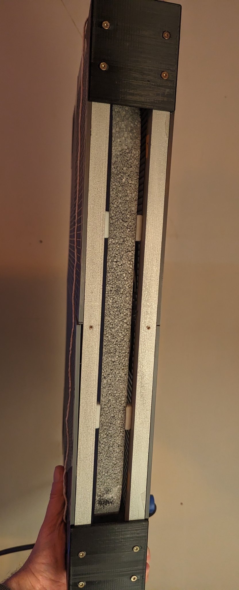

Can you remind me of your panel dimensions and the locations of your tpu support points?
Eric
Eric
The plates are 500x330mm and the support points in the latest version are located at 140mm from the edges and 20mm long.

LeobThe plates are 500x330mm and the support points in the latest version are located at 140mm from the edges and 20mm long.
So is it 4 points of contact then, two on each of the long sides? Or 8 (on both long and short sides)? And what is the thickness of your panel? I was thinking I might do an FEA model of your plate/mounting, just to see what the mode shapes and frequencies are. It would only be a rough approximation, as I don't know the material properties of your plates, but I can probably make a decent guess.
Eric
Thanks @Veleric that would be amazing!
It is these plates https://www.dekokopf.com/neopor-styroporplatten-3er-set-50x33x2-5cm.html
So 25mm thick.
I added hide glue and shellac and rounded the corners, mostly to make it easier to mount everything together.
I add on 2 points on each long side, from both directions, so a total of 8 pads.
Previous revision I had one point in the middle on each side, so same amount of pads, and then I got a lot better response below 150Hz...but with many other variables being different as well.
So 25mm thick.

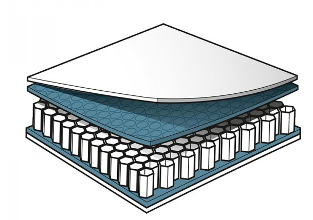

I'm experimenting with different honeycomb panels, and I get the impression that the material makes more difference to the FR than the aspect ratio/size. For instance I made a 4 mm thick panel from higher weight honeycomb nomex than my 3 mm panels, and it's bass light, and has a very pronounced and annoying peak at 3 kHz. Changing the dimensions didn't make a difference to the peak. The panels shouldn't be to stiff to get enough bass - or so it seems.
My first nomex paper panel that "sounded" really good has ridges on the surface - a random pattern of bumps because I used to much epoxy, It pooled under the paper with air bubbles in between. Could it be that that accidentaly is a good way to "randomly" dampen the panel? It still is the best effort so far. It gave an immidiate "This sounds really nice" reaction. Has anyone a clue what might be happening? I'll try to make another "proper" panel, and to mimic the ridges with a textured roller and thickened epoxy.
If I manage to get a similar sounding panel as my first one I might keep that as "the standard". This panel thing is so complex. It might be best to stick with what (found by accident) works OK.
BTW the panels I make are about 450 g/m2 now, so building lightweight is doable.
BTW II The response of the panels changes quite a lot in the first days after making the panel, because of the epoxy slowly hardening to it's end value. When cured for 24 hours there's not much HF, and the panel sounds cardboard-y. Two days later the HF by magic has appeared!

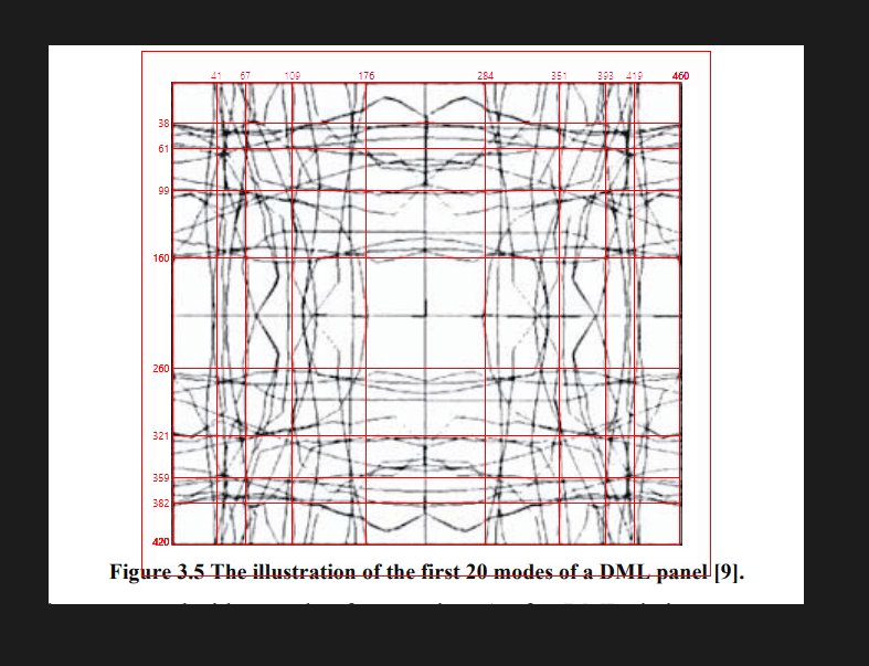

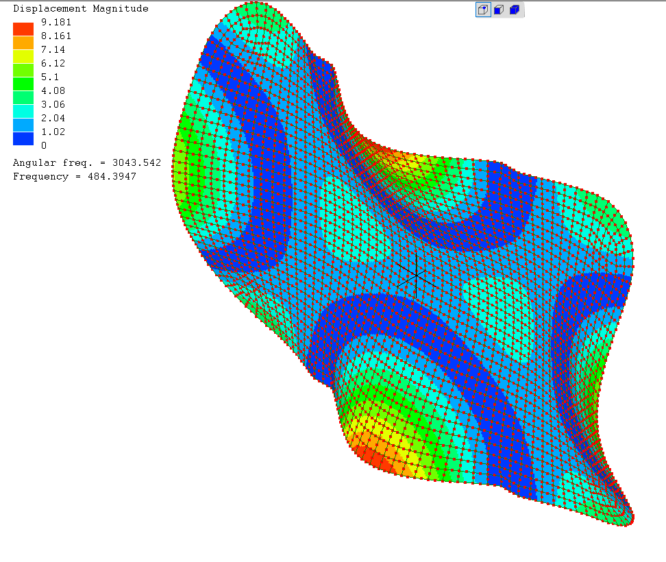

Hello!
I am new to the DML "sport" so I've been doing some homework.
I've been through much of the pages here as well.
Now here's something I found out, that might be interesting.
There's a paper from Chalmers University of Technology:
"A critical review of bending wave loudspeaker technology and implementation
Master’s Thesis in the Master’s Programme in Sound and Vibration
KUONAN LI Department of Civil and Environmental Engineering
Division of Applied Acoustics
Room Acoustics Group
CHALMERS UNIVERSITY OF TECHNOLOGY Göteborg, Sweden 2010 Master’s Thesis 2010:9"
You can look it up, it's free to download.

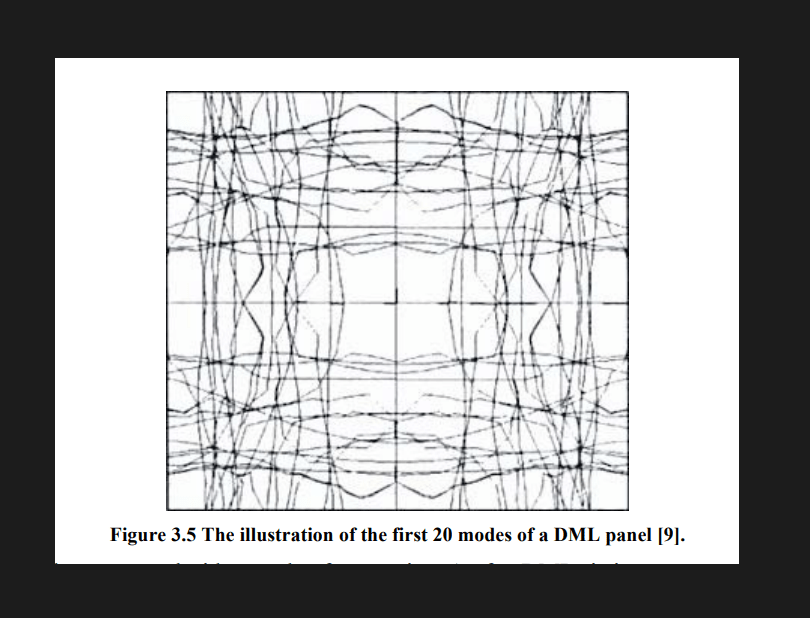

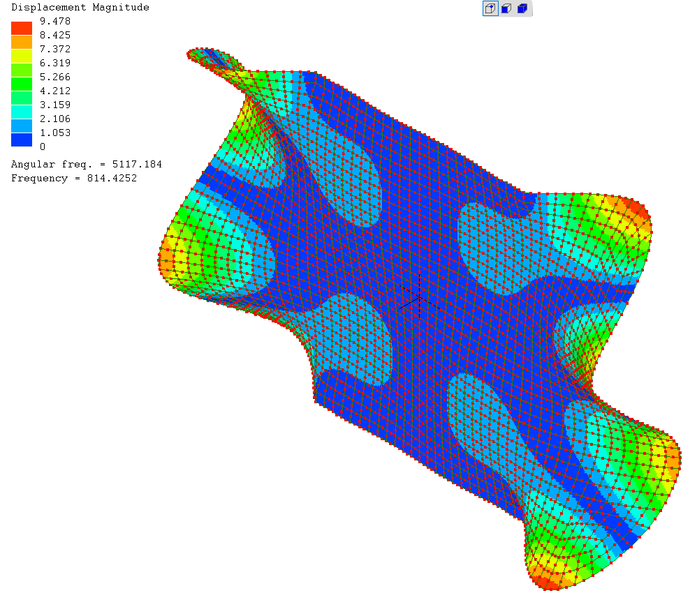

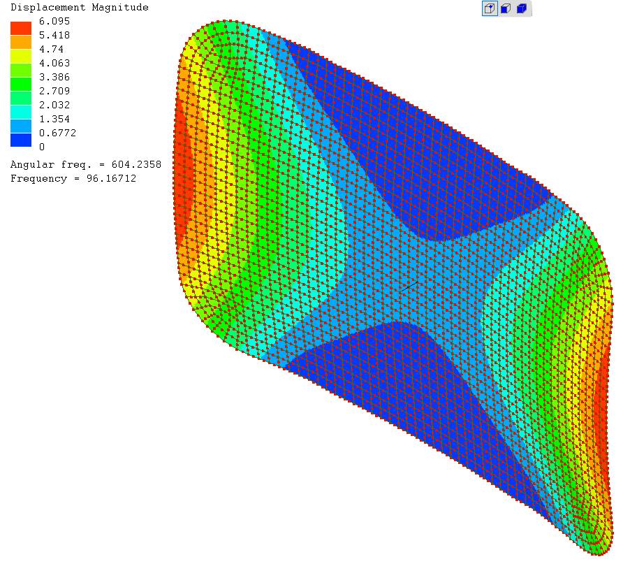

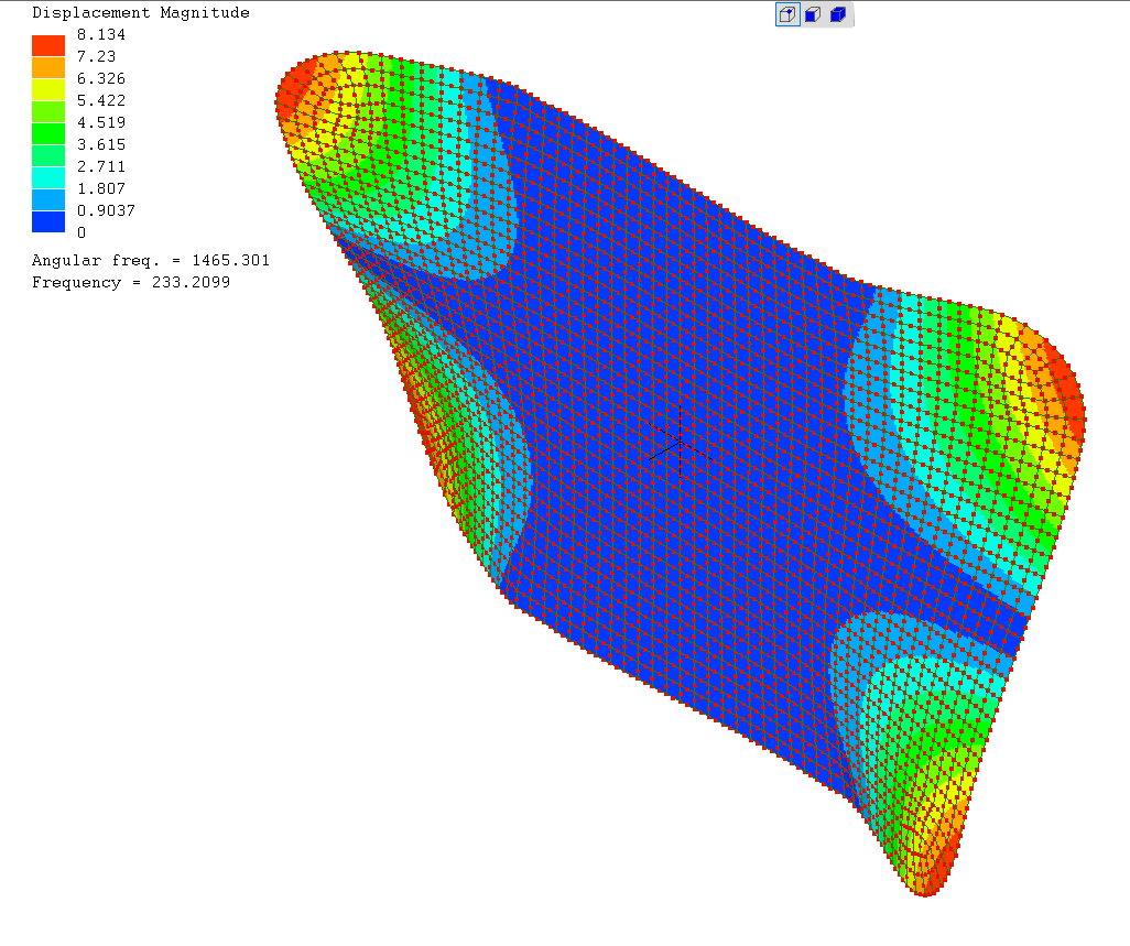

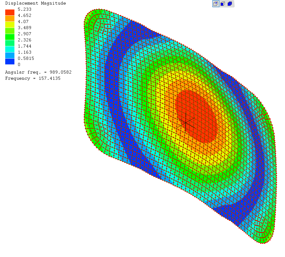

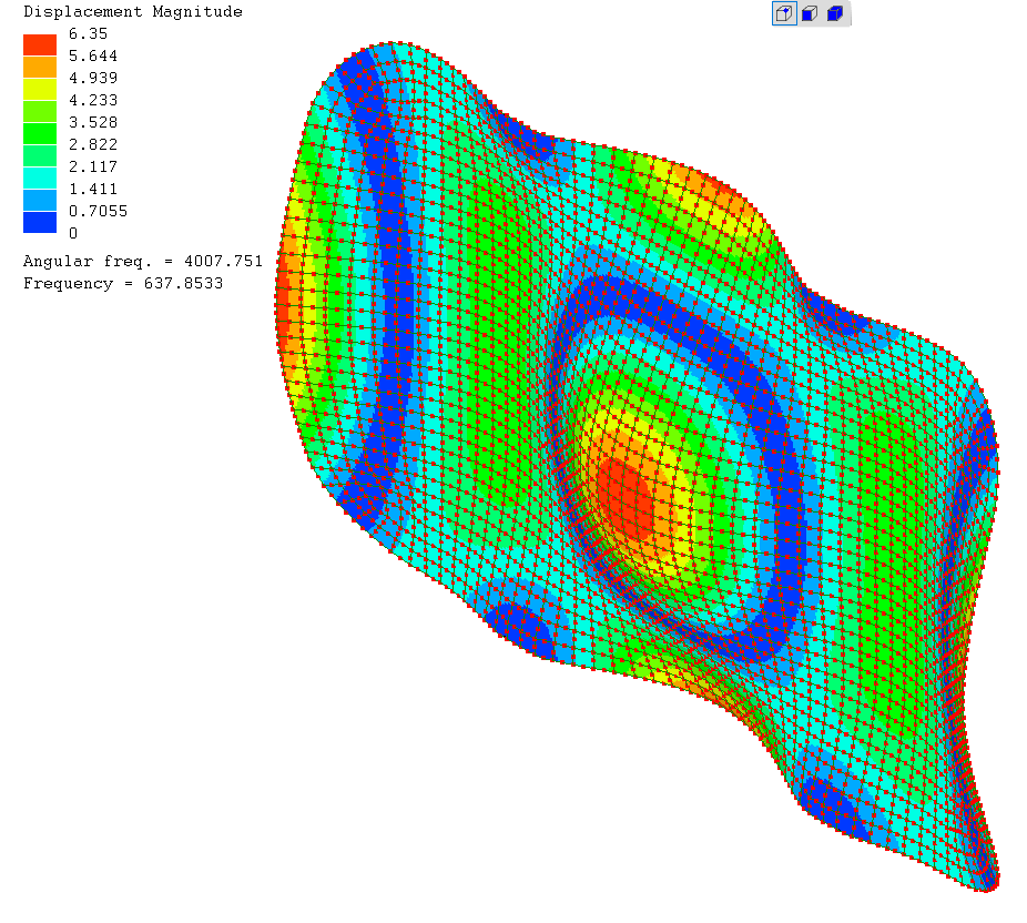

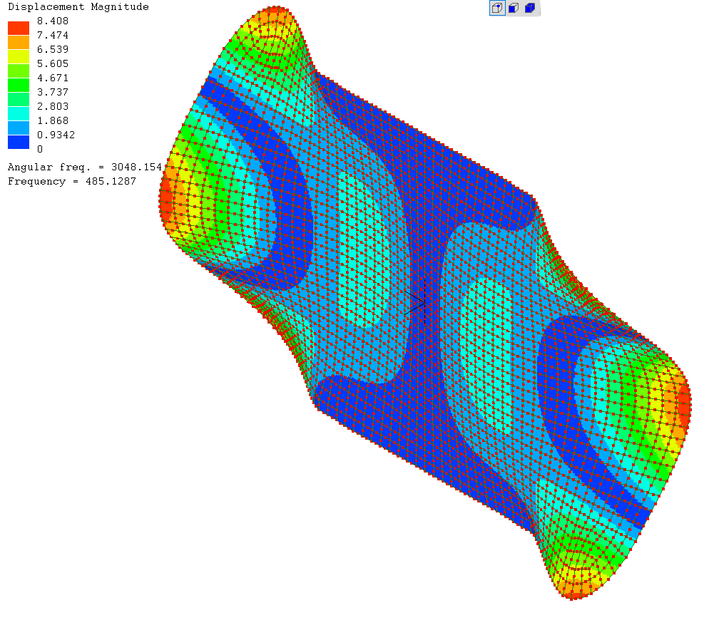

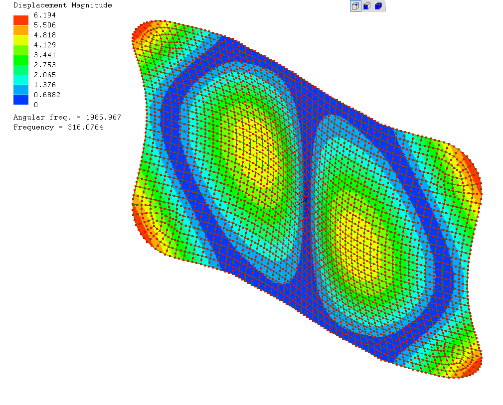

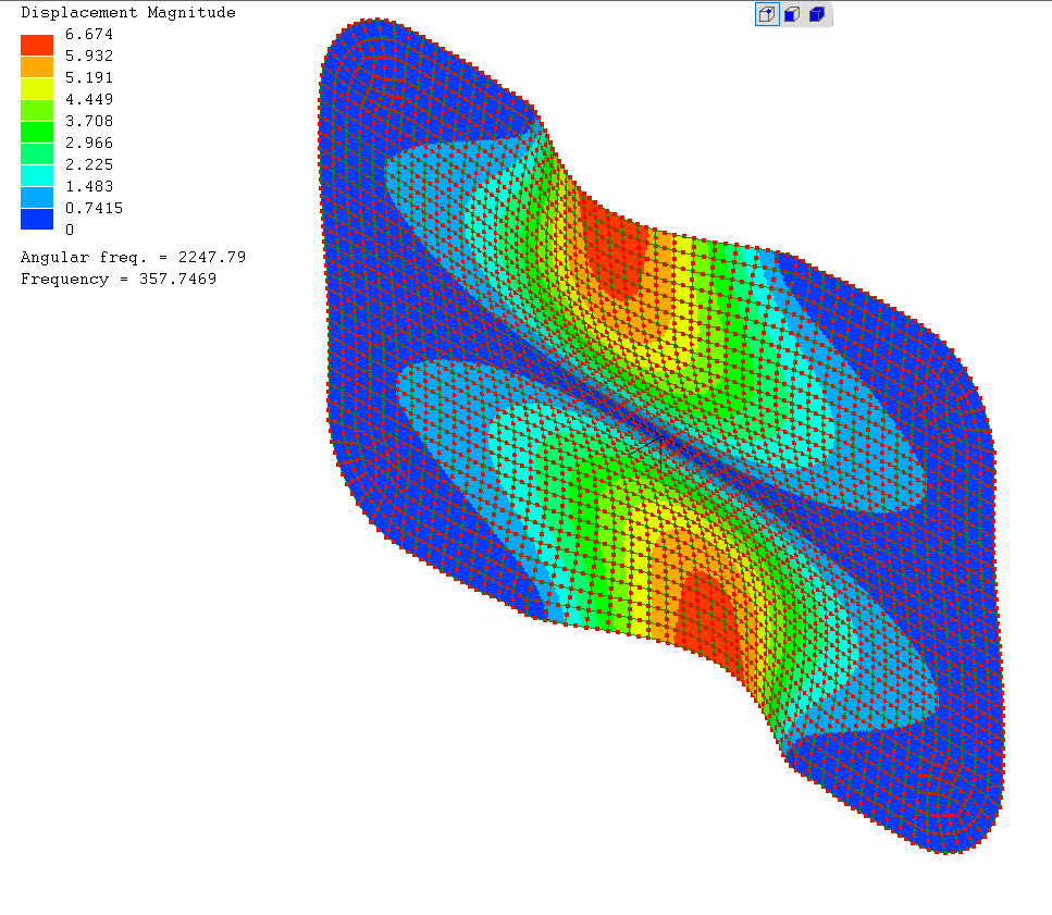

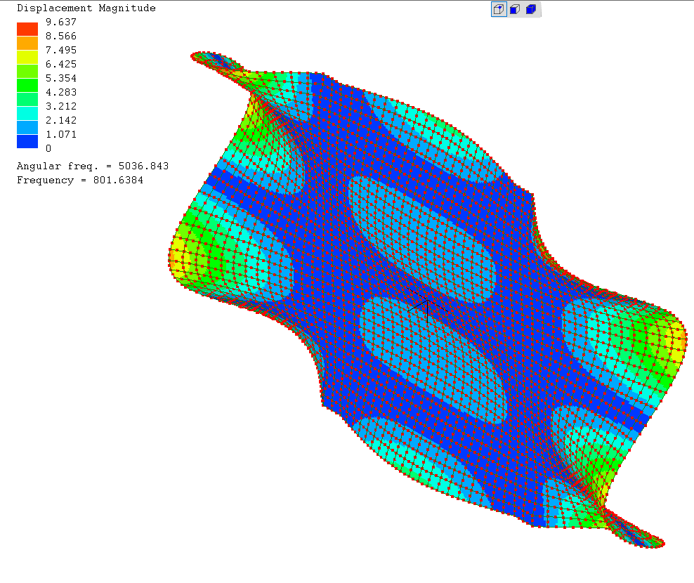

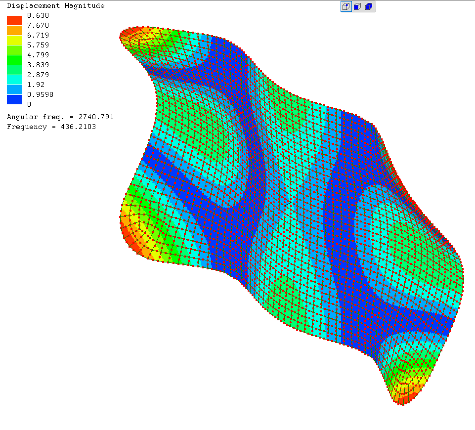

In there they analyze some example DML panels and they discuss Excitation point and Geometry of Panels.
They have an example figure in which Modal Analysis is illustrated.
They comment on this:
"The position of the exciter will decide which modes of the plate will be excited, affecting the radiation performance of DML. Thus it is essential that one makes sure that the excitation point couples as many modes as possible, and ensures de-correlation between panel velocity and drive point. One might use, again, FEA to determinate the position of the exciter. Usually observing the first 20 modes or so is sufficient to conclude the optimal point of exciter, which is often near the middle point of the panel but never exactly on it. This is because that while the exciter is on the middle, it only can excite even modes. Figure 3.5 illustrates the nodal maps of the first 20 modes of a panel quoted from [9], which can be done by using FEM. The region where fewer nodal lines pass is a better position for exciter; in this case, possible choices are near the middle and the corners"
As we can clearly see, the region at the middle section (blank space, not dead center on the cross point ) provides the best possible positions for exciter placement, the edges are not considered as good choices.

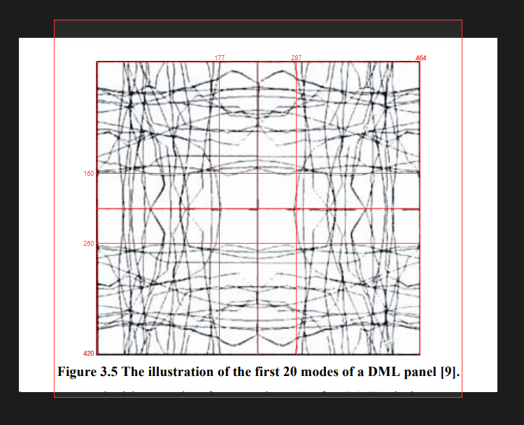

Now look at this picture below.
I overplayed in red lines a Phi Matrix (Golden ratio) over the original image, just out of curiosity.
Look at this! It's a perfect match!
Hmmm! I think there's some juice here.
The picture above has the two ratios of 0.618 and 0.382 lined out.
Look at the picture below where the 5 lines of phi matrix are overlaid.
Nature works in patterns 😉 and I think there's an obvious one here.
This could possibly give us hints for better placement.
I am definitely going to try this on.
I would appreciate your thoughts or experiments on such a possibility as well.
Manos.
Eric, you are not wrong, it becomes established that they have the sheets wrong placed and priced. Meanwhile the atactic PS. with same dimensions are now playing with some more eq (i.e, less dB`s) in the 2 to 8 kHz band compared to the previous. The price diferences don`t favor the s-PS.RMAM,
Interesting. PS makes more sense than PE. I would have expected it to be garden variety PS (i.e atactic) rather than syndiotactic, however. I would have thought that sPS would be too expensive to use for anything but fairly specialized applications, but I could be wrong about that...
Eric
The honeycomb isn't attached to the panel and is not used for creating a panel, it's used as a kind of waveguide for the sound emitted by the panel.
Obviously, although you can dampen the panel attaching it to the honeycomb wich is needed depending on material type, dimensions and panel load.
Nevertheless, i think is more cost effective to add exciters on the same panel, or chose different materials/exciters for separate mid/low freq panels to achieve the same goal.
Leob,

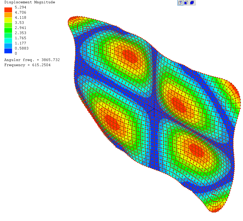

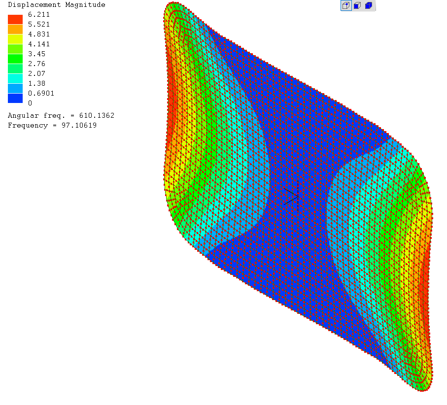

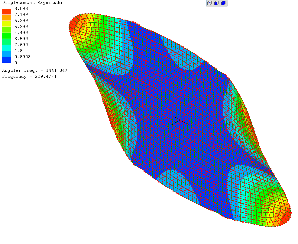

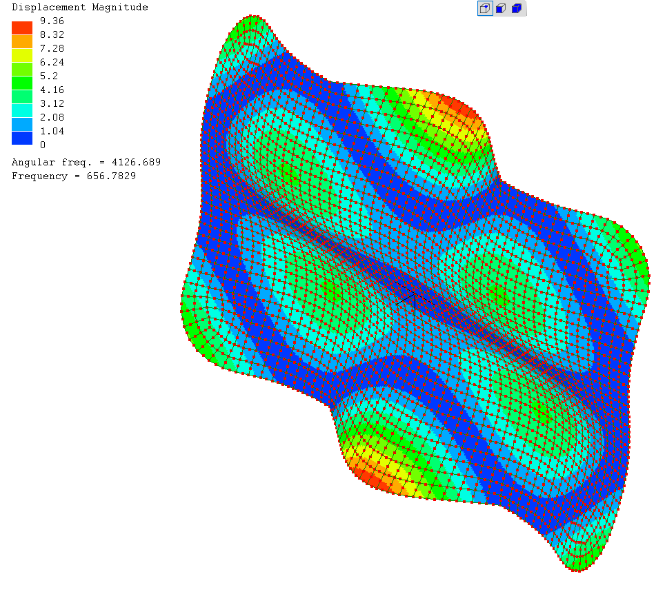

Here is what I have so far using the LISA FEA to model your plates. There are lots of assumptions, so take it all with a grain of salt, but hopefully it's is still interesting to you.
I used plate dimensions of 550 mm x 330 mm x 25 mm, with a corner radius of 60 mm. The supports are 20 mm x 10 mm centered 140 mm from the plate edges. I assumed an elastic modulus of 30 MPa, density of 40 kg/m^3, and poisson ratio of 0.3. Those came from some EPS I tested before.
Images below show the estimated frequencies and mode shapes for the first 15 modes.
Based on the mode shapes, the ones I would expect to radiate sound best would be: 1,3,8,9 and 12.
Eric
