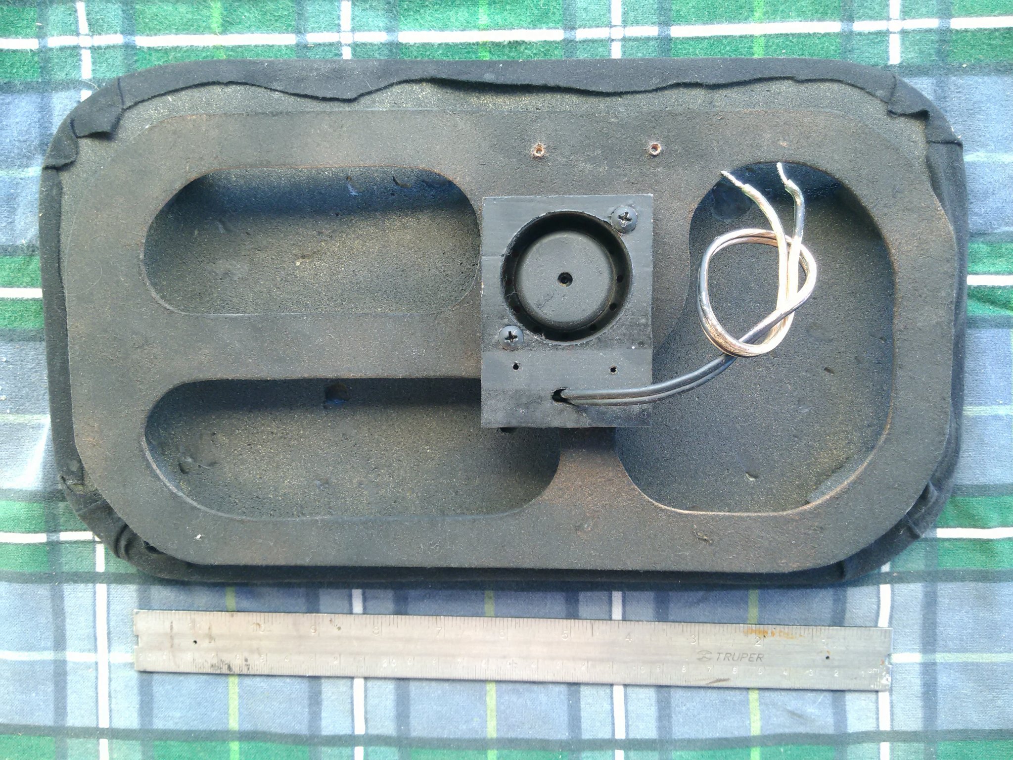

These are easy to mount. The four holes can be tapped and appropriate length bolts simply applied from the rear through whatever you want to mount them on. Just one example below. Soft rubber washers could be used along with foam around the rear perimeter of exciter if desired for a somewhat giving mount. I generally just hard mount.
