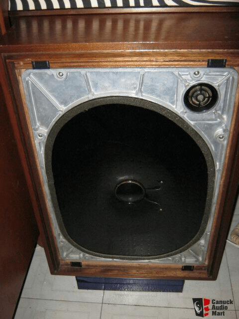

In both Bertagni and Yamahas design the ear shaped is used as a mid/woofer. That shape is not intended to be used for higher frequencies.

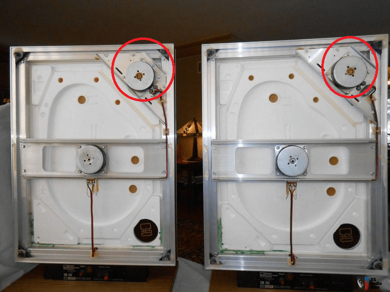

I saw the tweeter of "Bertagni" was also placed in the corner (2-way)
I just found out that it has some holes in it
So are they using these holes for some kind of correction?
Does anyone know the purpose of the big hole in the lower right corner?

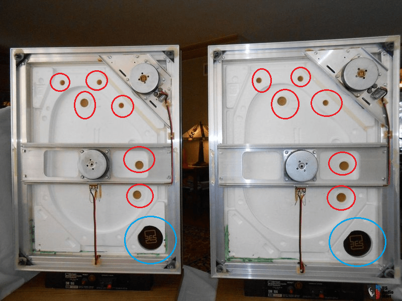

The holes you circled in red are weights. The weights can help lessen the degree of intermodulation between the two exciters. The big hole you circled in blue acts like a bass port releasing stored up energy and or redirecting the stored energy away from the high frequency exciter.

Correct. Instead of using a second exciter for the high frequencies like Bertagni, Yamaha just utilized a conventional tweeter as its way more easier to implement in ones design.

Which Yamaha model is this loudspeaker? Seems the "DML" and the tweeter are firing in same direction (not the case of other models being 3 ways as other Yamaha models with such "natural sound" or ear speakers).
I don't think there are specific needs for a tweeter because used with a DML..
The tweeter introduces :
  • a crossover with the question linked to that (phase, distance between the source center...)
  • a big difference in the radiation pattern. No HF to the rear side, a reduction of the radiation angle when the frequency increases.
From the only FR I have seen from the Yamaha speaker, it stops emission too early;
Seems additional weights are in most of the commercial DML. One of their role is to modify the modes and smooth the FR.
