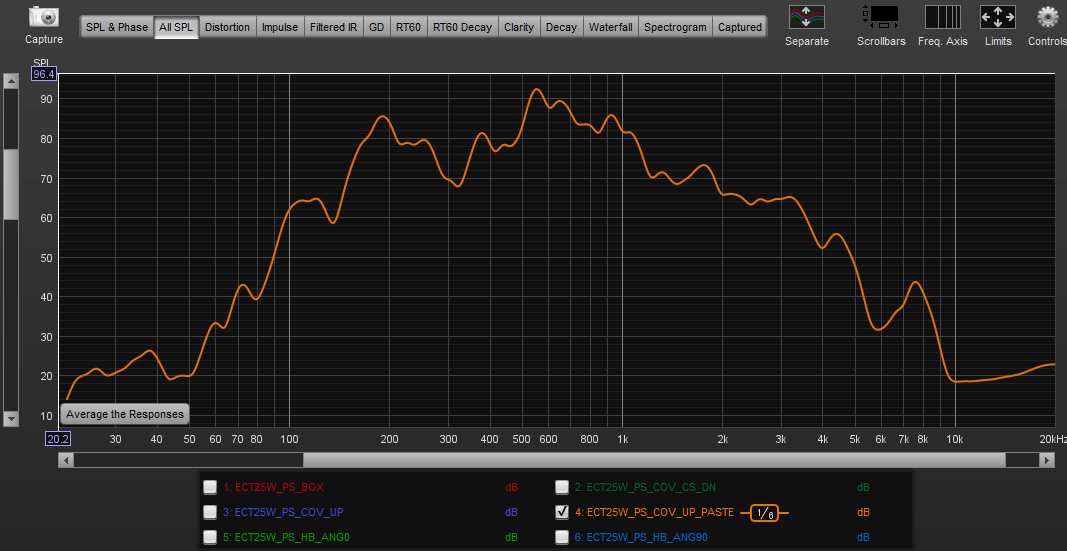

Subwoofer < 80HZOK. Seems I missed one of your previous post... DML + FR is not usual in the designs shared here. Have you already described how the frequency ranges are splitted between them? what is their relative efficiency?
(The subwoofer can also not be used, I personally think it's okay)
I want to test the PPD subwoofer later
But maybe after a long time
https://www.diyaudio.com/community/threads/ppd-subwoofer.393371/
80Hz < DML < 2kHz~6kHz
The frequency of DML depends on the overall situation
But I think good exciter + suitable board
Maybe it should be able to go to 3kHz~6kHz?
Of course, FR also needs a good curve matching
My current combination doesn't feel great
I'm not currently over 2kHZ
So this time I bought some full-range speakers with better medium and high frequencies.
But I'm afraid there will still be "coil sound"
So I bought some dome tweeters this time
Because the seller told me that the effect of "dome tweeter" is still far greater than that of "full-range speaker"

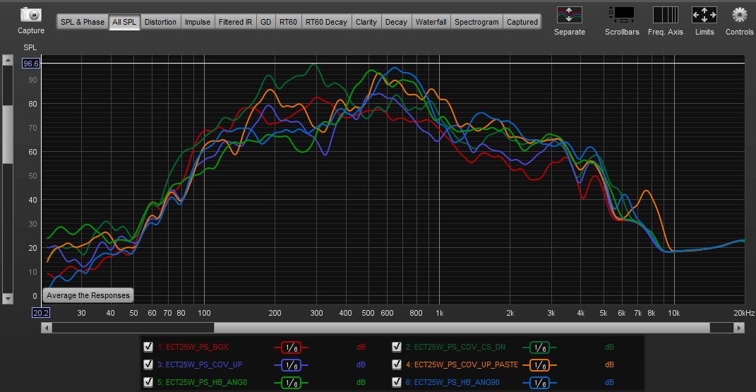

I agree in some ways. I find that the panels, whatever material I'm using, do have an aggressive upper midrange, 5k or so, and which spits the sibilants. But that 'air' is lacking, and the sound does benefit from a 9k or so boost.I have not found HF reproduction to be a challenge, apart from when using the large 50w exciters or bad materials. But with most materials I tested...like polycarbonate, plywood and EPS...HF reproduction has not been lacking. In fact I have to reduce HF to not make it not sound too sharp. So not sure why one would use a tweeter or have to chase materials or exciters with maximum possible HF reproduction? Are you actually aiming for a flat curve with no slope?
I do find that basically the higher up in frequency you go, the more DML shows its advantage. Less issue with several sources and reflections due to diffuse nature, very litte distortion at high levels and great directionally and transients. But I guess some people prefer the sound of conventional tweeters for some reason?

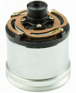

The (30w) Tectonic drivers I used had no problem >10khz, but I have not found Daytons with the same capability. I have to go right down to Dayton 10w drivers to get decent response at 10khz.
As pointed by other answers, there is something strange here. In the materials I tested, without checking carefully, I would say 10k is the mean value reached, 15k or more for the best, 6 or 7k at least (corrugated PP).I'm not currently over 2kHZ
Which kind exciter coil to membrane interface do you use? Could it be the HF is attenuated here? Important weight?
In the description of your system I understand woofer/DML/tweeter. In previous post, you mentioned FR. FR = Full Range? Which band is targeted?
Maybe I'm too old to care about "air" 🙂 I get good response up to 10k, but have seen a 5dB dip centered around 15k. I haven't really bothered tweaking it with EQ since I cannot really hear any difference, with 16k being the limit of my hearing.I agree in some ways. I find that the panels, whatever material I'm using, do have an aggressive upper midrange, 5k or so, and which spits the sibilants. But that 'air' is lacking, and the sound does benefit from a 9k or so boost.
By reducing a couple of bumps in the mids I get a reasonably flat slope from 20-20k with around 6db/oct attenuation overall, which seems right to me to keep it warm and fat sounding also at high levels.

Hi everyoneMaybe I'm too old to care about "air" 🙂 I get good response up to 10k, but have seen a 5dB dip centered around 15k. I haven't really bothered tweaking it with EQ since I cannot really hear any difference, with 16k being the limit of my hearing.
Because my current Exciter is not good at high frequency
I will continue to test when my next batch arrives.
Maybe have a good performance?
I don't necessarily have to use tweeters
But until I finish testing the next batch
If I still have "coil sound" after I use DSP adjustment
Then I'll probably use the tweeter first
I've been asked several times
I have never posted Exciter bought from China
Sorry to post it because it's cheap
But I think DIY is all about finding good stuff from cheap
This is when I just started to buy
At that time, I did not understand the specifications and chose the wrong one.

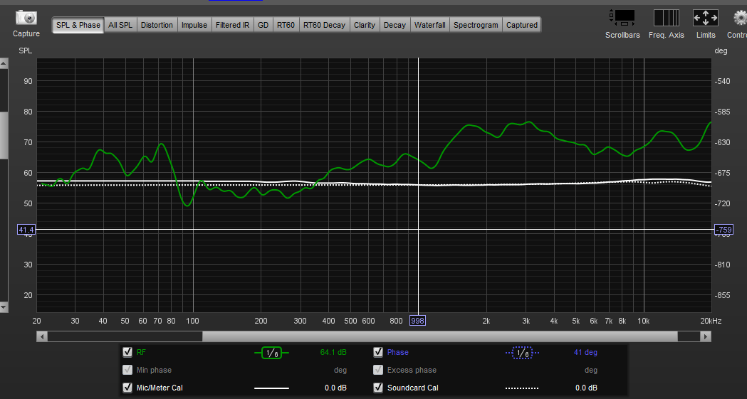

This is 3" FRIn the description of your system I understand woofer/DML/tweeter. In previous post, you mentioned FR. FR = Full Range? Which band is targeted?In the description of your system I understand woofer/DML/tweeter. In previous post, you mentioned FR. FR = Full Range? Which band is targeted?In the description of your system I understand woofer/DML/tweeter. In previous post, you mentioned FR. FR = Full Range? Which band is targeted?In the description of your system I understand woofer/DML/tweeter. In previous post, you mentioned FR. FR = Full Range? Which band is targeted?
Its free curve without baffles
The impression is measured around 2.5M
Because I am just getting started, the frequency range for me is 20K as the standard
Its high-frequency curve extends all the way up
It sounds much better than my current Exciter in the high-frequency
This is a temporary combination
Because I don't have any more suitable exciters and speakers now

With EQ or with weights? or rear baffles with strategically placed holes?By reducing a couple of bumps in the mids...
