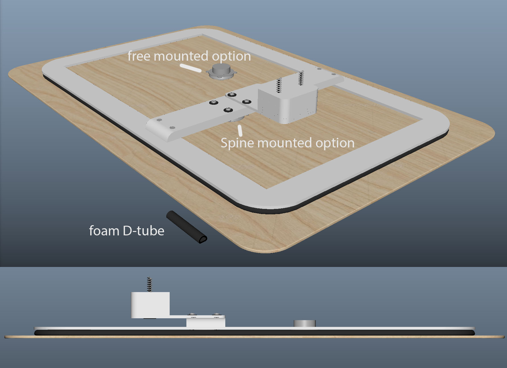

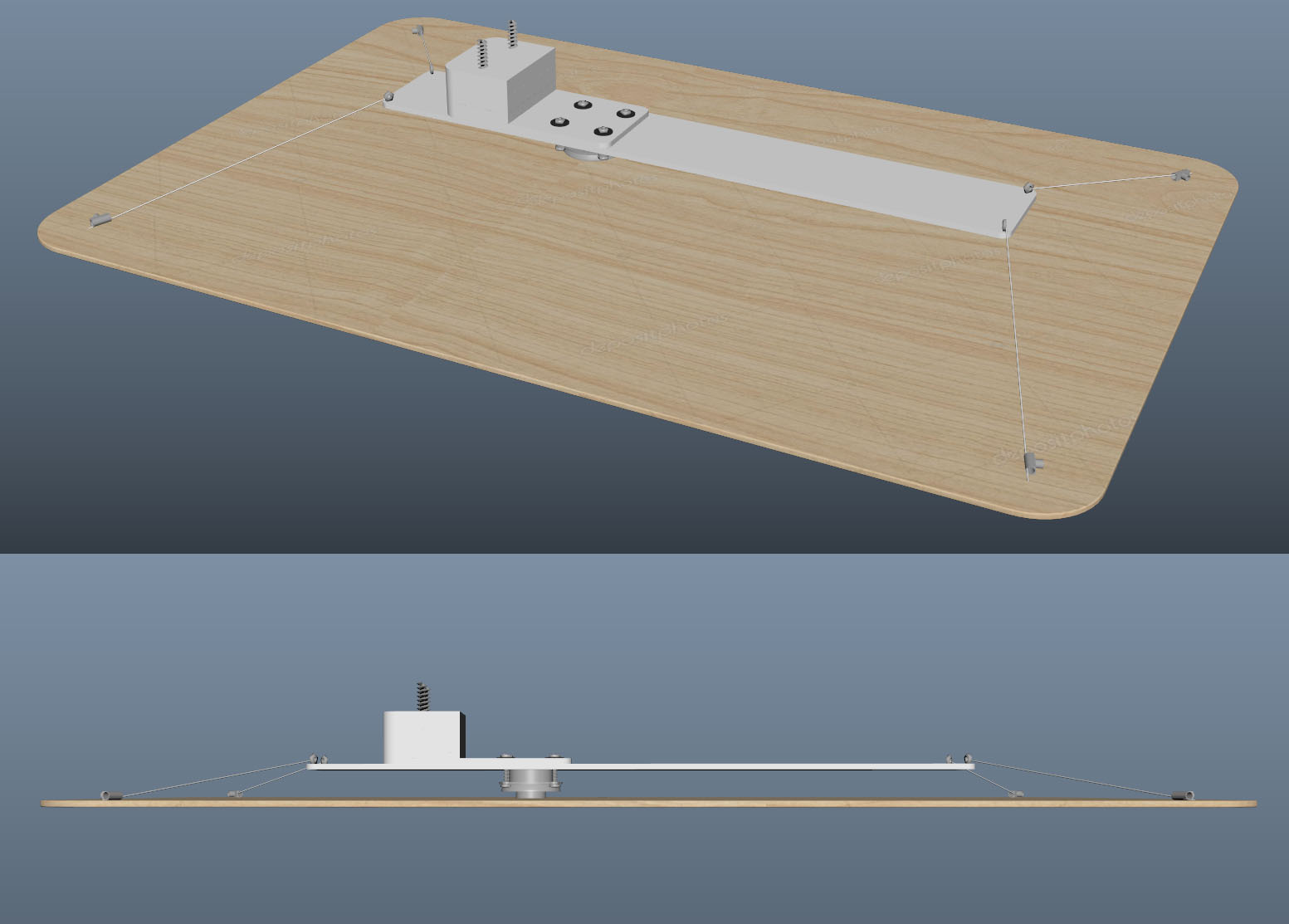

Hey everyone, I've been back and forth between several designs for my .4 atmos DML panels, and i've settled on 2x3', 1/8" birch/w spruce core plywood panels. I've already cut and rounded the wood and begun on the mounts.
My question is, since these will be ceiling mounted (horizontally) will the single exciter alone (Dayton Audio DAEX30HESF-4) be strong enough to support the panel? I have epoxy to supplement the 3M glue, but im concerned it will also not be leveled.
I've come up with a design that could support the panel, but i've read its a big no-no to put any support on that side of the panel, only the edges.
Is there another way of supporting the panel other then what my example shows?
I'm currently considering fishing line, but I also have some elastic wire, strung out only to support and level it. I'd really prefer not to do a frame.
I hope someone has a good idea!

I like your choice of panel, but I think your design for the supports is going to be difficult to make work.
You definitely don't want the weight of the panel hanging only by the exciter, as the weight will pull the voice coil away from the neutral position, and if the exciter is not dead center and hence balanced, the panel wouldn't even sit flat. So for sure you need some other way to support the panel.
What's the reason you don't want a frame? Is it just the appearance of the seemingly "floating" panel what you want to preserve?
I have a strong preference for frames, for several reasons. Mainly, when I've tested panels that are largely unsupported around the edges, the base frequency response has generally been been compromised, both in sound power and especially in smoothness of frequency response. And for a wood panel, a frame will help a bit to reduce warping of the panel with changes in humidity.
If the idea is to preserve the floating appearance, my suggestion would be to try this: Build a "frame" but make it several inches smaller in both length and width than the panels, say 18" x 30" compared to your 24" x 36" panel.
Attach foam strips to the face of the frame, and then attach the back surface of the panel to the foam strips. For foam, you could use this:
McMaster-Carr
I like the 3/4" wide x 3/8" thick foam.
It has adhesive already on one side so you can stick it firmly to the frame. Then use double sided tape or spray adhesive to attach the panel to the foam.
Now, to be clear, I have never tried a version where the panel extends more than a little beyond the edges of the frame, so I can't say for certain how well it will work. But my suspicion is that it will perform better than a substantially free panel.
For attaching the exciter, probably you could simply use the supplied tape alone, or mount it on a spline spanning the frame. But since the panel is laying horizontal I suspect the need for a spline is much reduced.
One thing I like about NOT using a spline is that if the panel warps (and wood surely will), it won't push or pull on the voice coil, as the exciter will just float on the panel where ever it goes.
Then attach the frame to the ceiling however you want, maybe short vertical fishing line would be good for that, for example.
But whatever you plan, I highly suggest making and testing a prototype (or several!) before committing fully to a design.

Thank you for your input Eric, I really appreciate it.
You are right about the idea that these should appear like floating panels as much as possible, but I recognize that they do need support, and the frame suggestion you describe sound like an excellent idea.
I've gone ahead and bought 16 meters foam tube which i've modeled in with a frame design as you described.
I decided on a D-tube as you can see on the picture, as I imagine this will give a better suspension.
I 3D modeled in the woodframe for the tube using the same 1/5" wood as I used or the panels. This helps me keep a low profile and I have leftover from the panels I can use, hopefully it's strong enough.
It is placed 2" in from the edge.
Then in using a piece of MDF i also have enough of from scraps to mount the frame to the ceiling mount (which I already made). I cant center the ceiling mount due to acoustic panels in the ceiling, let me know if this is confusing and i'll take a picture.
Only questions remaining is if I understood your design idea right, and if I should spline mount or free mount the exciter. I'm probably going to build it to be able to do both, and I can listen and decide for myself!
Thanks again for your suggestion, and please let me know if this all sounds right to you or not!

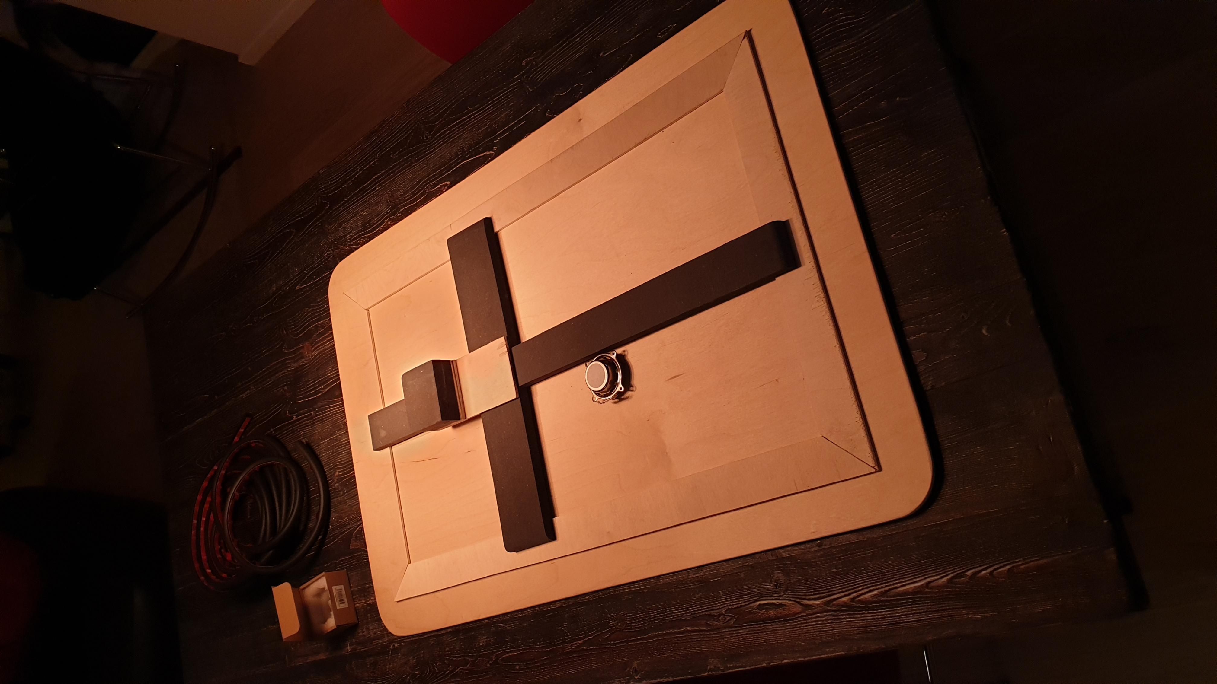

update, not quite ready for testing yet, but I think i'll get there in a couple of days if I find the time.
I went for a full on holy with a cross to hold the frame as I felt the thin ply needed more support.
I still need to glue and round the ply corners, and i'm planning to add a extra piece of thin ply to strengthen the corners, forming triangles.
Rubber will be glued on once I assemble the frame.
For the spline option I need to cut a round hole in the wide piece for the exciter to sit in, then I can adjust the mounting depth with some spacers.
Let me know if you see anything alarming.

kaptajn,
Yes, it looks like you understood exactly my suggestion. Your progress looks good, I sure hope it works out well!
