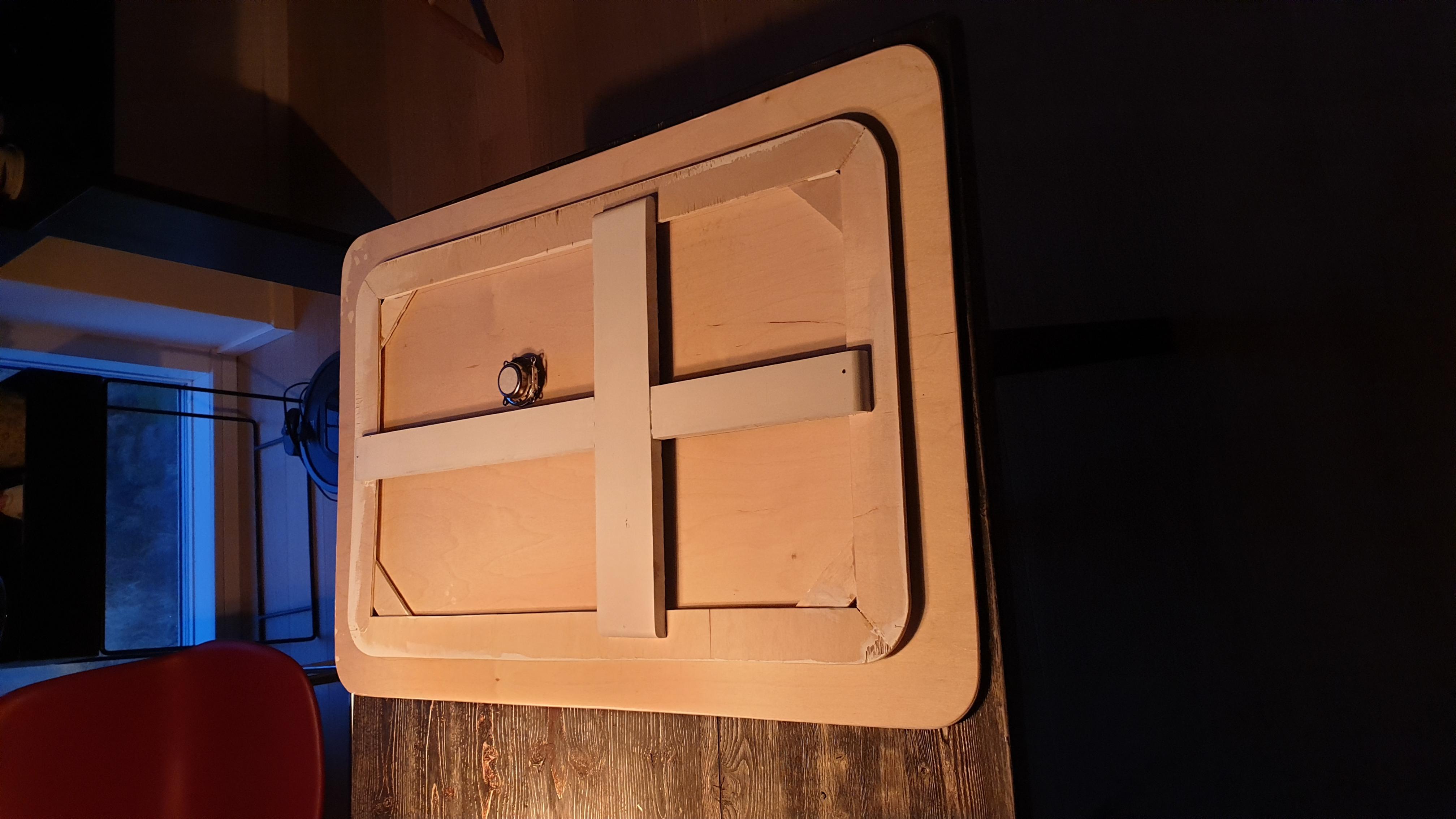

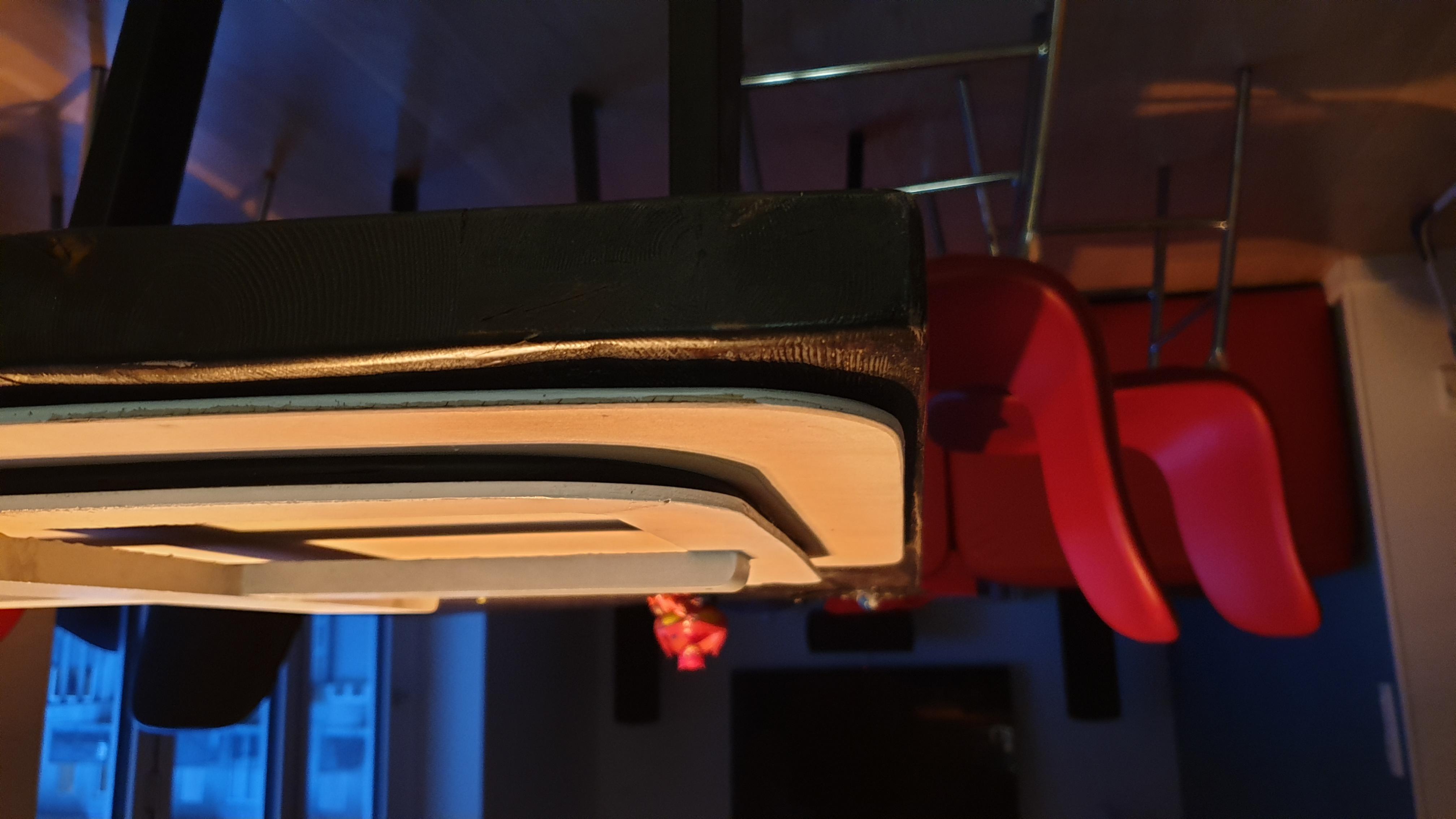

Having doubts stopped me as my 15-16inch minimum rule has never failed me when it came to bass/lower frequencies. Plus 300mm is around 12inches which is only 3inches less. So I doubt adding 3-4inches would hurt and I believe more so could make it better in the lower frequencies.
I put together the prototype and gave it a quick listen, I have to be honest it was not very reassuring.
exciter and rubber tube is epoxied on and the whole thing seem quite solid.
I had suspended it on the frame vertically using quick grips, so the front wasn't touching anything.
I connected it to my small PC stereo amp (marantz m-CR511) to test it out.
I would describe the sound without EQ as extremely damped and very low output compared to my warfendale diamond 220 bookshelf speaker.
I then crancked up the volume and played around with EQ on the PC (voicemeter) and that helped quite a bit, but I had to do a very agressive EQ to make it sound anywhere near to a budget bookshelf speaker.
I am receiving my Umik-1 tomorrow and will do some measurements to get a better idea of what is going on.
I feel like the wooden board may over damped?
How aggressively do you guys need to EQ ply panels?
in case you missed it, its a 60mm x 90mm birch/spruce/birch 5mm plywood board (BB grade) and the exciter is a DAEX30HESF-4.
Edit: I swear those photos were neither rotated 90 deg. or flipped upside down, wth?!

Hi kaptajnThomsen,
How disappointing, you should have had a better result than that!
I will comment where I have experience. I run ply panels BB grade at two thicknesses, 3mm and 4mm, with similar exciters- Dayton Audio DAEX32EP-4 Thruster 32mm Exciter 40W 4 Ohm. The amount of energy going into the panels should be similar, I doubt the exciters are the problem.
Comparisons are very subjective but I would never describe the results from the panels I have as over-damped. Transients- e.g. drums etc, are startling in their rendition with real dynamics. I don't use any damping on these panels and they are suspended by wire.
I also have no problems with volume in a room 5M by 4M with carpeted floor and soft furnishings. So I suspect your diagnostic is right, you may have too much damping. DML's work by resonant modes, the mode nodes the better, and if you over damp you may be inhibiting this,
EQ is a matter of taste. I used to eq a little, in my experience ply does not need much, but I don't bother now.
If it's not too much work can you remove the panel from the frame and test out the panel without damping as a quick check?
Burnt

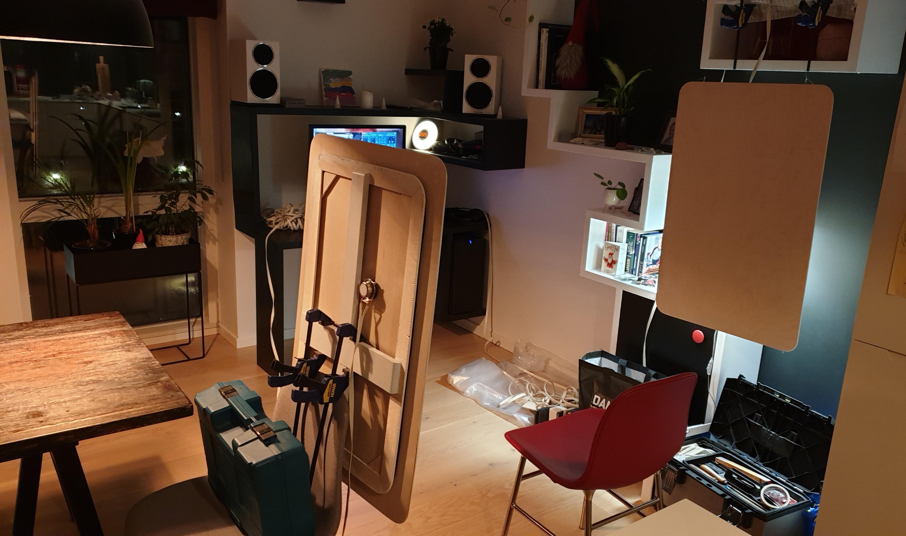

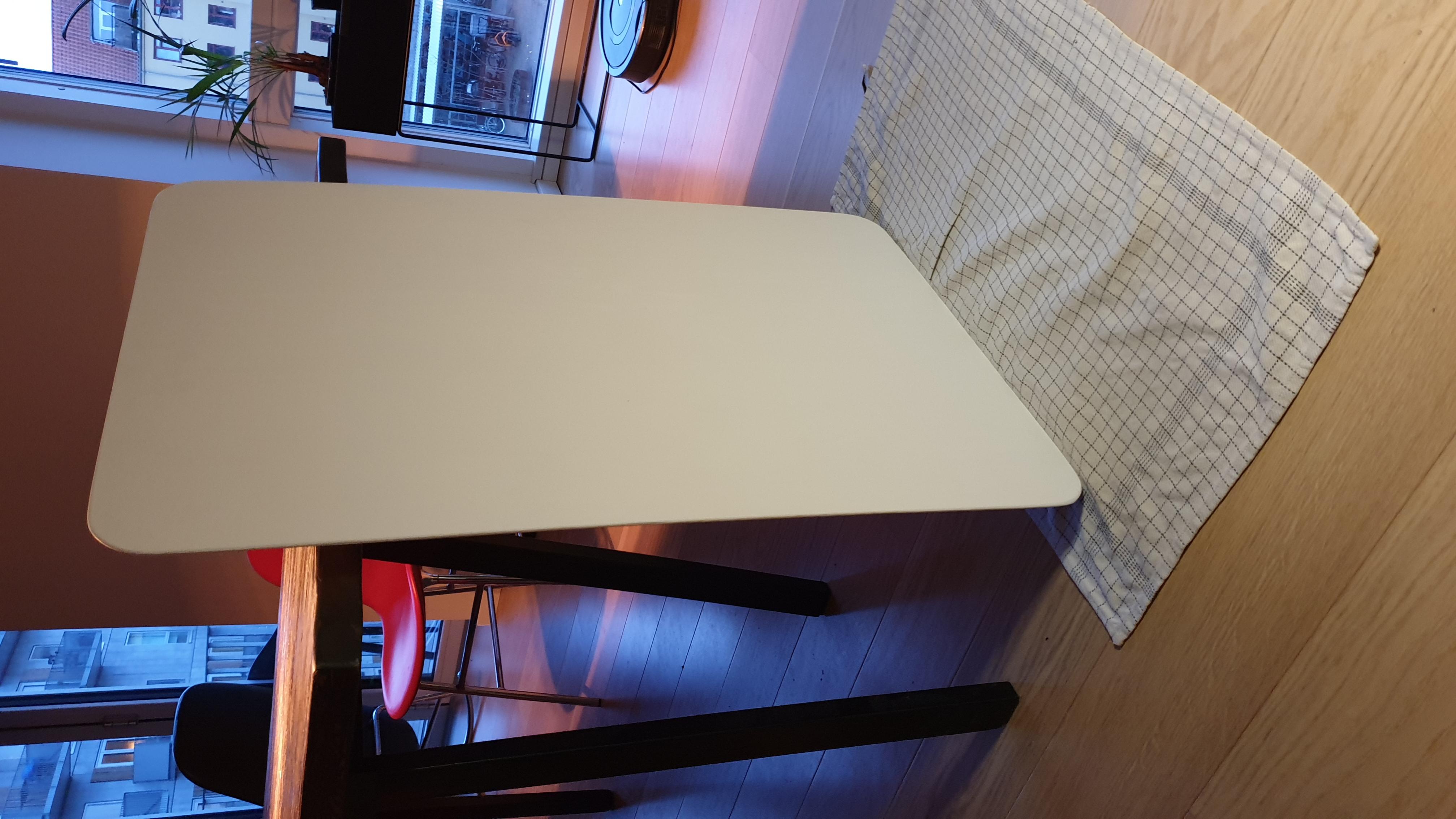

I have 4 of these panels and exciters, so next up is a wire suspended test. I did the frame design for better support as they eventually need to sit horizontally in the ceiling as atmos channels!
If you have a spare panel which is undamped - just the ply- try that as a reference.
I rigged something up pretty quick with some fishing line and quickdry superglued an exciter on a clean board with some very small screw hooks in the edge of the board, I think you may be able to see it in the picture.
I set it up in stereo so I could switch from left to right on the PC while sitting between the speakers and switch eq on or off.
Thanks for suggesting this comparison and i'm happy to say that the un-framed panel was a definite improvement over-all. I tried re-EQ'ing but I only had to raise it a bit below 500hz and above 10k hz. The bass was much more present as was evident when I switched from left to right.
What surprised me most was the significant boost I got from having them playing in stereo, even with one panel overly damped, the boost in output felt more significant then if I did the same with my bookshelf speakers.
So next ill try to remove the rubber and attach strings between my frame and front for a horizontal setup and test that out, but before that I will wait for my Umik-1 and test both current panels to have the measurement with the rubberfoam frame.
Excellent! I am glad you made a step forward so quickly. I agree waiting until you can measure the panels as well as listening to them is very useful in diagnosing problems. In my limited experience the simpler you keep DMLs the better they sound. Good luck with the next steps and please share your results, it helps all of us learn.
You did your frame and spline wrong. These are basically Bipolar speakers so sound needs to radiate equally from the front to back. Your type of frame with spine covers too much of the back making the radiation pattern unequal so less output from the back side. Instead you should of mounted the frame on the outside of the "EDGES" of the panel. Also for the spine all you need is a "single" thin piece of wood. The spine's main purpose is to hold the exciters magnet in place to prevent voice coil sag and give the exciter something to push off of.
