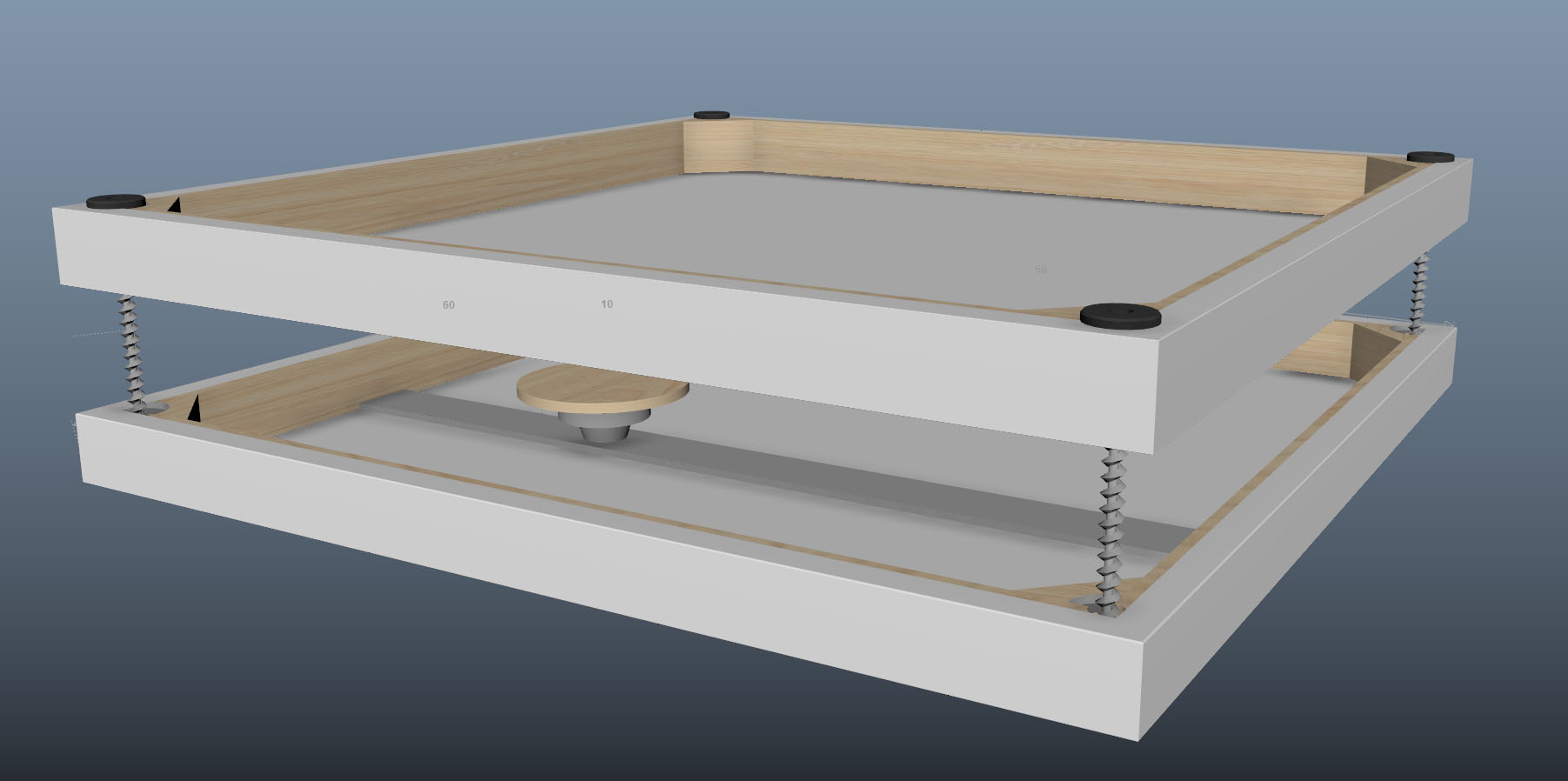

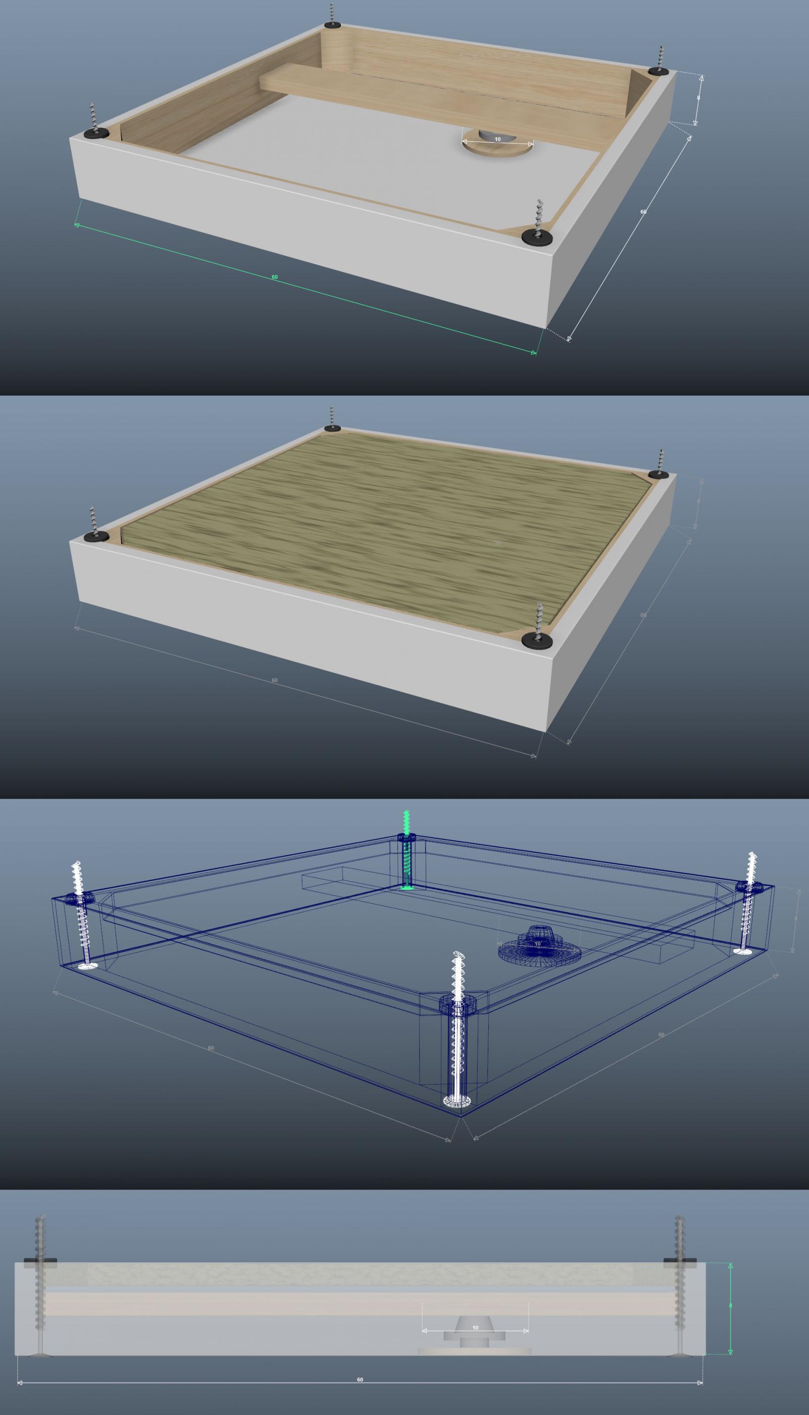

I have a few questions regarding your very interesting picture frame design.
I've been inspired by this forum and others and ordered 4 daex30hesf 4 ohm to go in my ceiling for atmos, and am deciding between two design.
A large consideration is aesthetics/WAF as I have spend all my WAF points on towers, center and wall mounted back channels in our living room (5.0)
As I have covered parts of my ceiling in acoustic panels at 2'x2' (commercial mineral wool ecophon 40mm or 1.57" glued directly to the ceiling) the speaker panels should sit next to or on top of these and blend in as best they can. I have decided they should not extend down much further then 80mm / 3.15".
first option is the 2'x2' xps panels screwed into a piece of 1.57' spacing wood which is then screwed into the concrete ceiling. I've seen something similar done in an early post.
I would cut a hole in the existing acoustic panel and place the speaker directly below it to absorb the back of the panel.
The second option is your picture frame design, but i'm uncertain if this would work, so I've sketched it out in 3D so you can see what I mean.
My design is a 2'x2' (60x60 cm) and 3.15" (8 cm) deep frame that will be flush mounted to the ceiling. This frame could also contain a thinner (0.79") acoustic mineral wool panel as seen in the picture.
So my questions would be if you this design could work to a reasonable degree, or the compromise of distance to wall is not worth it, and I should go with the XPS without frame for this purpose?
Eventually I am planning to build a subwoofer sofa table to cover the lows better, but that will like happen after the panels.
My system is Quad Z4 fronts, ZC center and Z1's for backs powered by a marantz 7013.
I sincerely hope you feel inclined to share your thoughts on this, and will be happy to alter my 3D design if any good suggestions come up. I also promise to share my experience and pictures once I decide on a build.
Cheers!

I've made another quick sketch of your suggestion, but in order to both mount the exciter and cover it for WAF, there is a sandwich design going on.
On the downside the membrane is extremely close to the wall/ceiling and there now seems to be no room for an absorber in the design, or it will have to be quite thin.
The inner membrane could be any material, not just cotton canvas.
The outer cover would obviously also have to be speaker cloth, which in my case is fine, but if you want an image on there, you will need it to be printed.
Height could be reduced if the exciter could be mounted on something thin and strong, like a steel bar.
I made a quick example of a thinner bar to hold the exciter in place, its 4mm, attaching it to the wood frame shouldn't be too difficult.
This allows for two same-sized 1.6inch canvases to be stacked which makes pre-bought frames an option, still the outer canvas will need to be speaker cloth.
Have you tried holding one of your exciters on the front of a canvas and put it up against a wall? How do you think that will sound?
