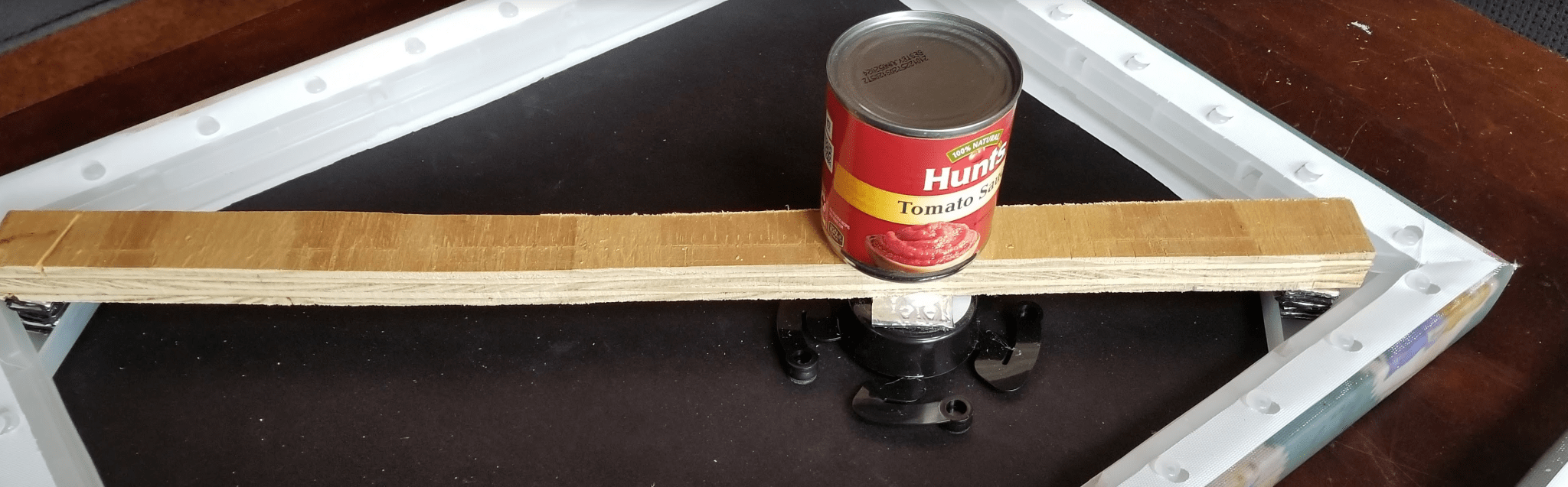

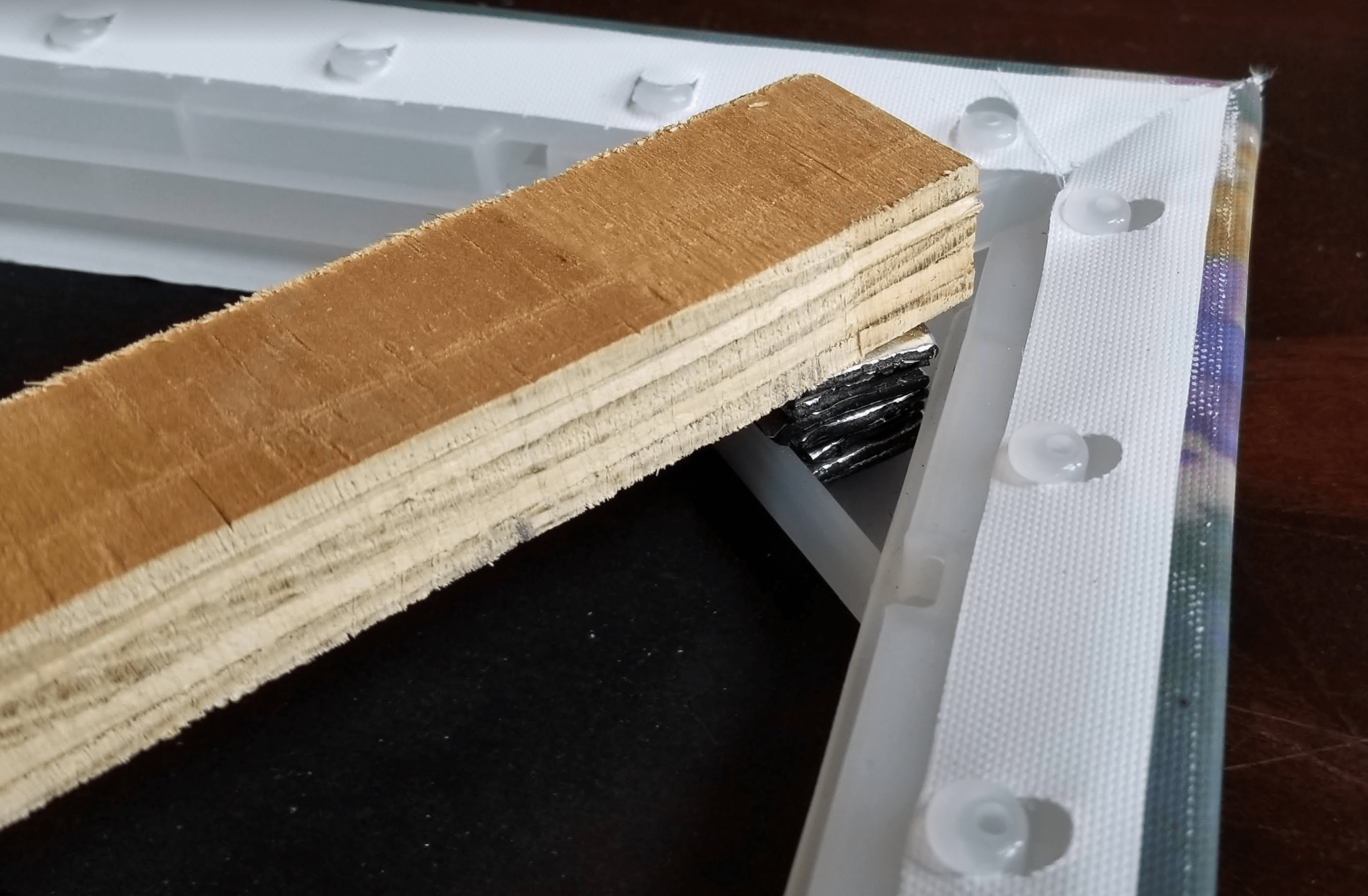

And here is how I implemented the spine. This is a simple 3/4" piece of plywood cut to width, and then attached to two corners of the frame and the back of the exciter with a combination of PVA adhesive and stacked strips of MLV. Once the adhesive dries I am going to test the result with a quick pink noise RTA measurement and then install them.
If anyone else does this, the frames look to me like they could be HDPE so they should be flame-treated first or the adhesive may not bond well.
Nice. I think a spine is a good idea, but for prototyping a spine doesn't usually matter much, it's only over time that the surround will start to creep and sag. But If I were you I'd want to test that no matter what anyone said.And here is how I implemented the spine.
Normally, I put the spine across the shortest span, to maximize its stiffness. Minor point I think.

Hello Deude_MannAnd here is how I implemented the spine. This is a simple 3/4" piece of plywood cut to width, and then attached to two corners of the frame and the back of the exciter with a combination of PVA adhesive and stacked strips of MLV. Once the adhesive dries I am going to test the result with a quick pink noise RTA measurement and then install them.
My knowledge of acronym and materials is too short...
MLV = Mass Loaded Vinyl?
HDPE = High density Poly Ethylene?
From the pictures, your canvas seems not made from the classical coton or linen fabric. Is it?
Christian

Yes sorry MLV is mass loaded vinyl though technically the stuff I showed is butylHello Deude_Mann
Christian
HDPE is correct
I looked at that and honestly I do not know. It may not be. I did have that nasty ring at 1500 Hz, and the sound is OK not great, so perhaps that could explain why.
