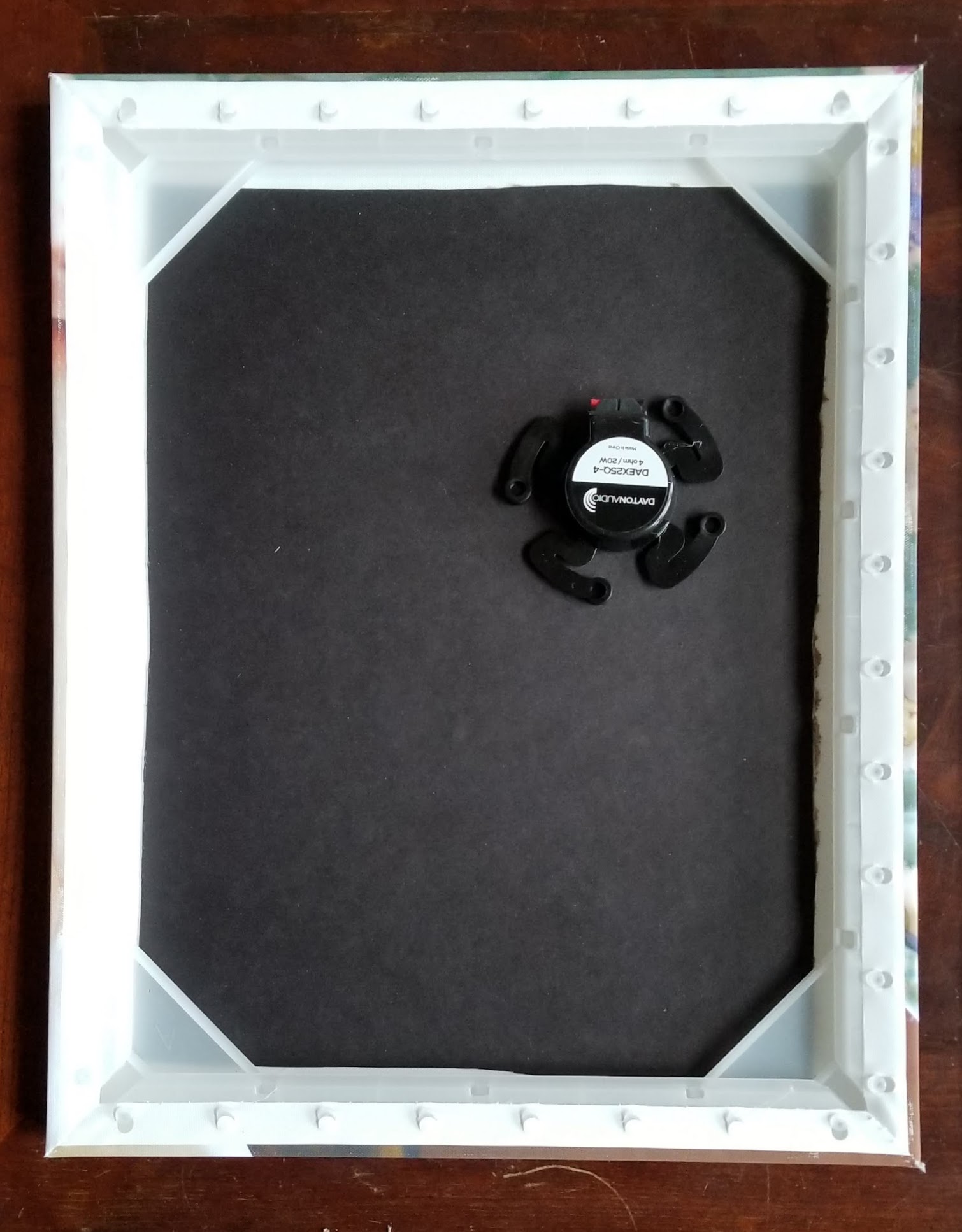

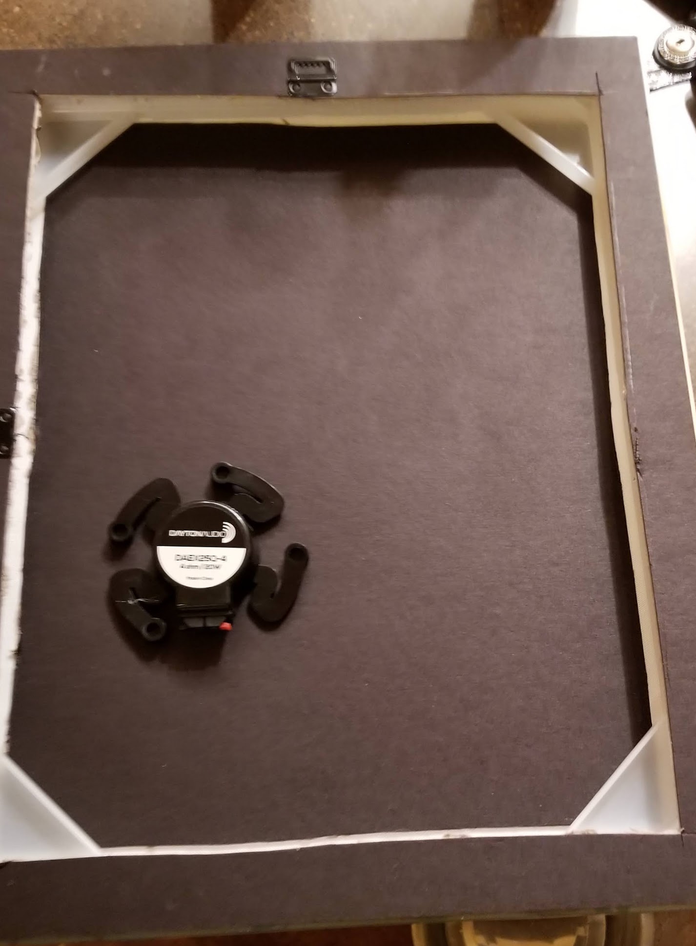

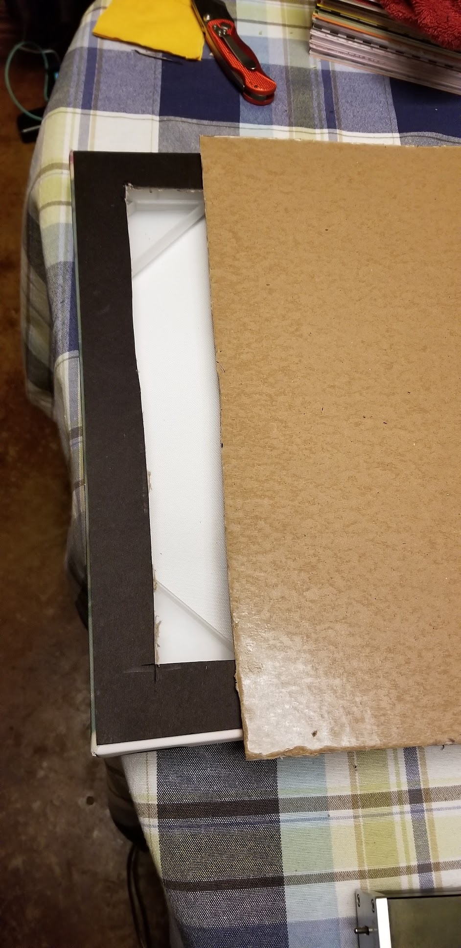

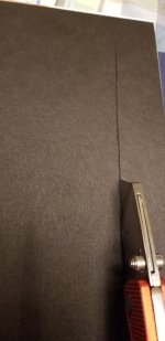

OK here is what I came up with as a quick and dirty implementation. This is using the above mentioned CVS canvas prints. Basically I tried one with just the canvas and it did not sound very good, and had a nasty ring at 1500 Hz, like a not happening unacceptable level of ring.
So I cut the back off of one of them and found that the backing was not only cardboard, but had an adhesive layer. So I slipped it under the frame corners and stuck it to the back of the canvas. After playing around with pink noise and an RTA with a waterfall plot I found a spot that reasonably spread the energy across the spectrum so I stuck the exciter in place. The photos of the operation are attached.
This is the exciter I used - Dayton DAEX25Q
The result is good. Not jaw dropping hi-fi sound but good enough for two pictures I'll be hanging up in the kitchen. It definitely sounds better than I would expect for something I threw together with $15 exciters in a couple of hours tops including testing. I will be adding spines tomorrow (exciter to frame) to see what that does. Also the adhesive used on the frames/backing/canvas is not exactly 3M VHB so I may augment that as well.
The wife is happy with them. She did have a problem when I played some Swedish Death Metal using the photo of our daughter LOL. Maybe it is because our daughter is into JAPANESE Death Metal, not Swedish.

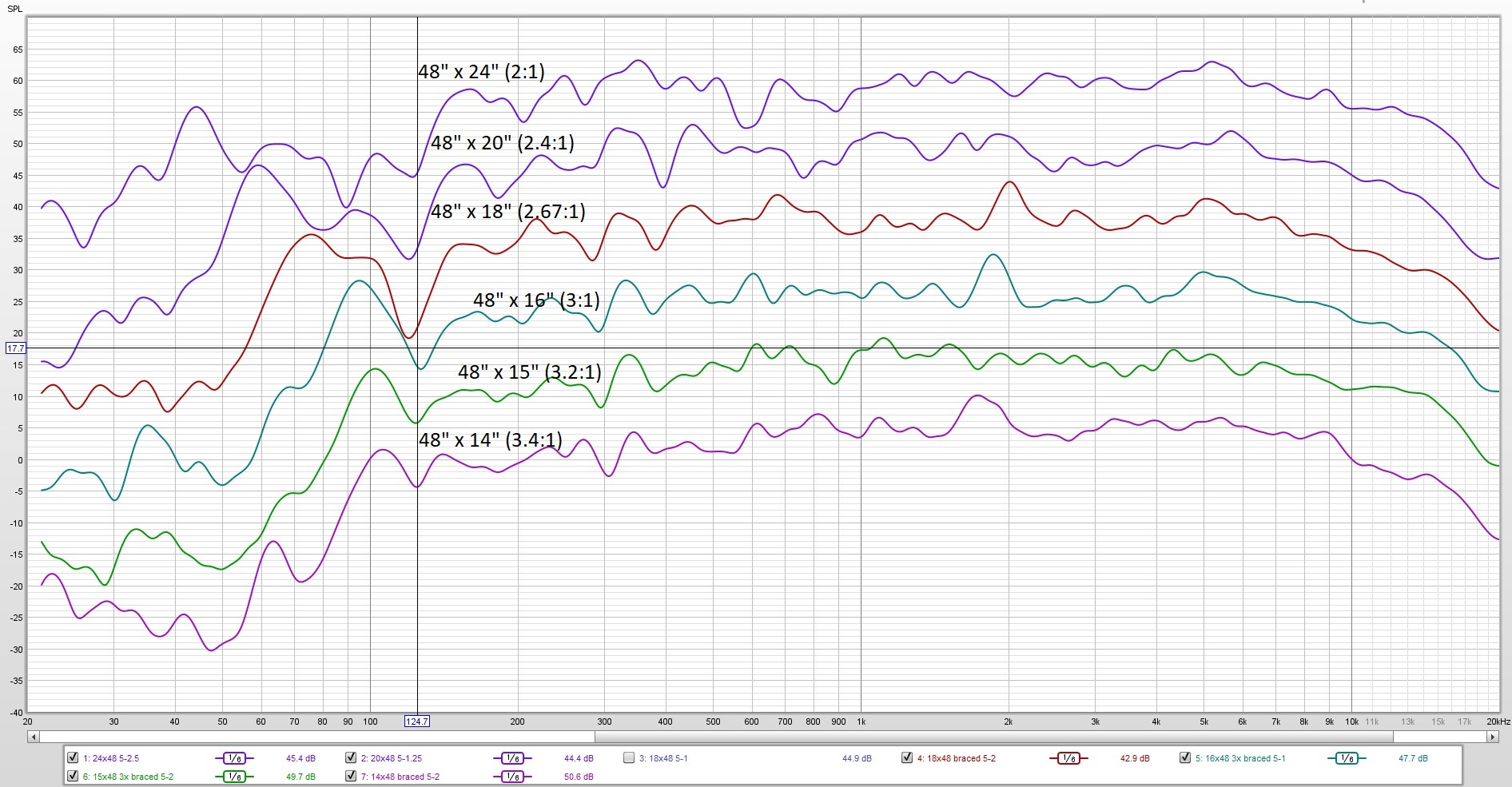

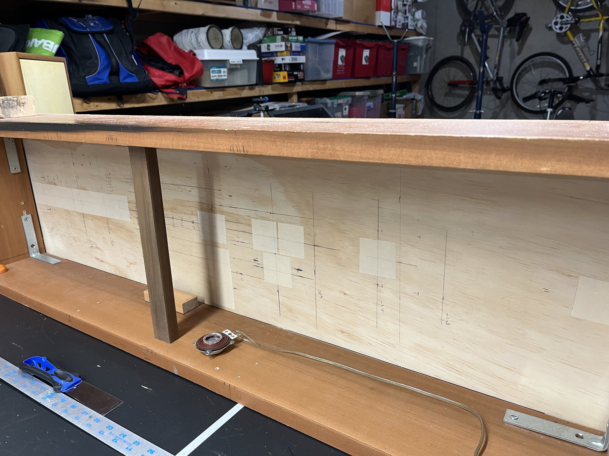

I posted several times about my current preference for using panels that are relatively high aspect ratio (more than 3:1) and mounted to a rigid frame with foam tape around most or all of the perimeter. Below is the result of an experiment where I started with a 48" x 24" (2:1 aspect ratio) panel and then cut it down in steps (widthwise) to 48" x 14", and measuring the frequency response with REW at each width.
The panel is a 4.6 mm thick, 5 ply "birch" plywood from Leow's. I put "birch" in quotes because this plywood has only thin birch skins, with the cores plies unspecified but most likely poplar. The panel is attached to a sturdy frame similar to that shown my most recent post above. The panel was attached to the frame with 1/2" wide 3M 411 mounting tape around the perimeter (except about an inch or two in the corners). The exciter position varied slightly. For each aspect ratio I tried several different locations and selected the best/flattest one for the plot below.
Anyway, here are the results:
My focus is on the low frequency range, say 40 Hz to about 160 Hz, where most of the differences are.
Not surprisingly, the largest (widest) panel (2:1) has the lowest fundamental frequency, and hence has significant output at lower frequency than any other aspect ratio, down to nearly 40 Hz. However, between 40 Hz and 160 Hz, the output is weak. But as the panel gets narrower and narrower, the region of weak SPL output between the first peak and consistently strong SPL gets smaller and smaller. And finally, at the 3.4:1 aspect ratio, there is only a small dip at about 125 Hz, but otherwise reasonalby consistent SPL from 100 Hz up.
When I have used panels of even smaller aspect ratio than 2:1, I typically see similar "lumpy" low frequency response, like the 2:1 aspect ratio above. So far, the best way I have found to reduce this "lumpiness" is with high aspect ratio panels mounted as I described here.

Eric that test and the resulting graph is great thanks. I will say I was considering the same test and would have most likely done it very much in the same manner that you did. A few observations:
Based on all of your modeling and testing to date, would you think this trend would extrapolate (within reason) to different ply thicknesses and boundary conditions?
- Intuitively your conclusion of aspect ratio vs 'lumpiness' makes sense to me from a physical standpoint. The farther apart the length vs width is, the less likely they will have complimentary modes. I am speaking very loosely.
- Regardless of aspect ratio, response in general really gets messy below 100 Hz or so which seems to be a general trend from everything I have read here so far.
- The higher aspect ratios have a response below 120 Hz that would be more manageable from a EQ/DSP standpoint.
- There is a significant 7 dB peak that comes and goes at 2kHz as the aspect ratio increases. That is tangentially interesting.

Very interesting test.
What about the Young modulus of this plywood in the 2 directions?
Christian
Pardon me if it has already been brought up, but as far as determining the effective modulus, one can use a simple three-point bending test to determine modulus within a reasonable amount of error. This could also be done with samples cut in different directions to determine isotropy or anisotropy. I'll try to do this when I start building the next larger DML. That will also be ply based (what Eric has above).

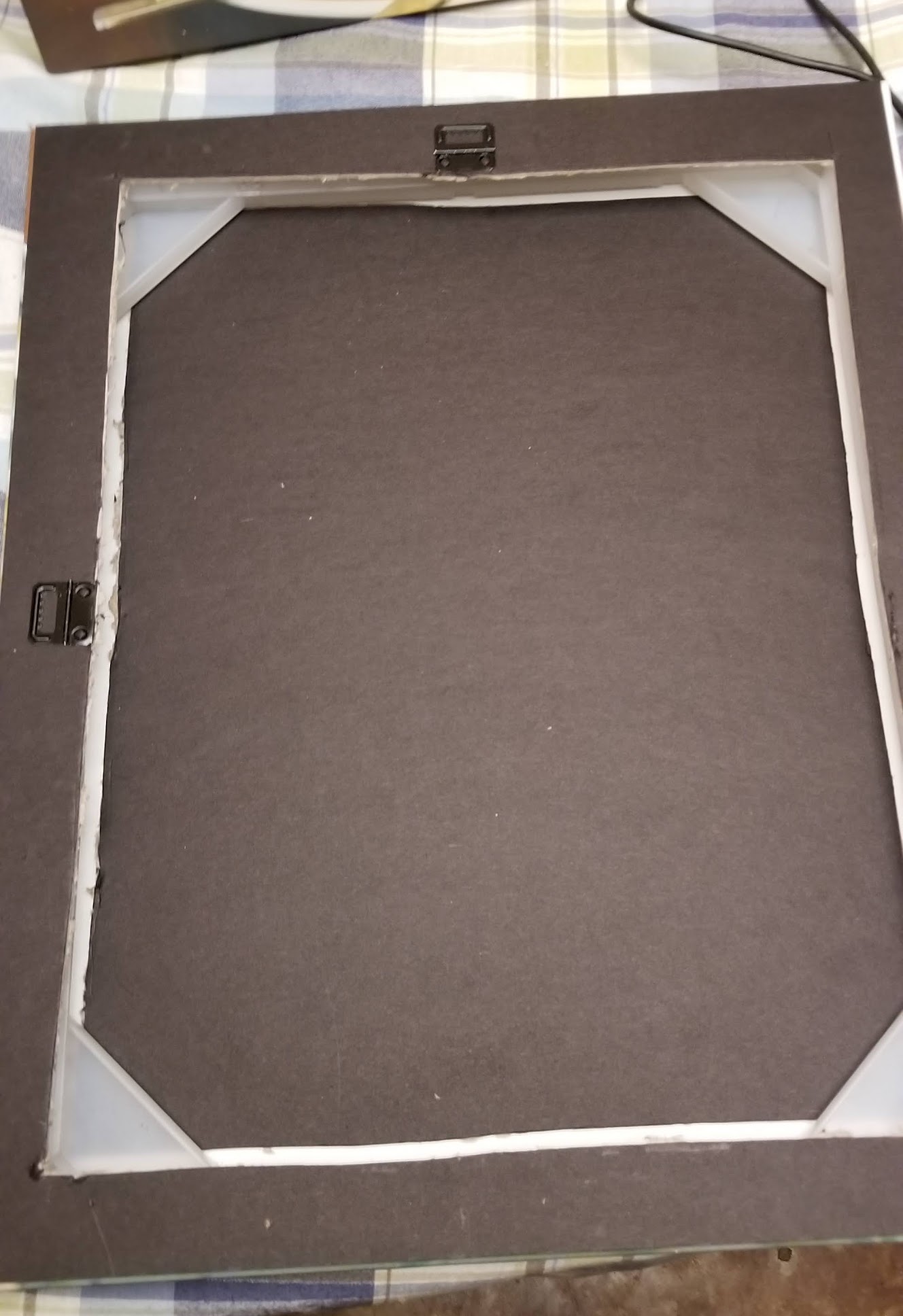

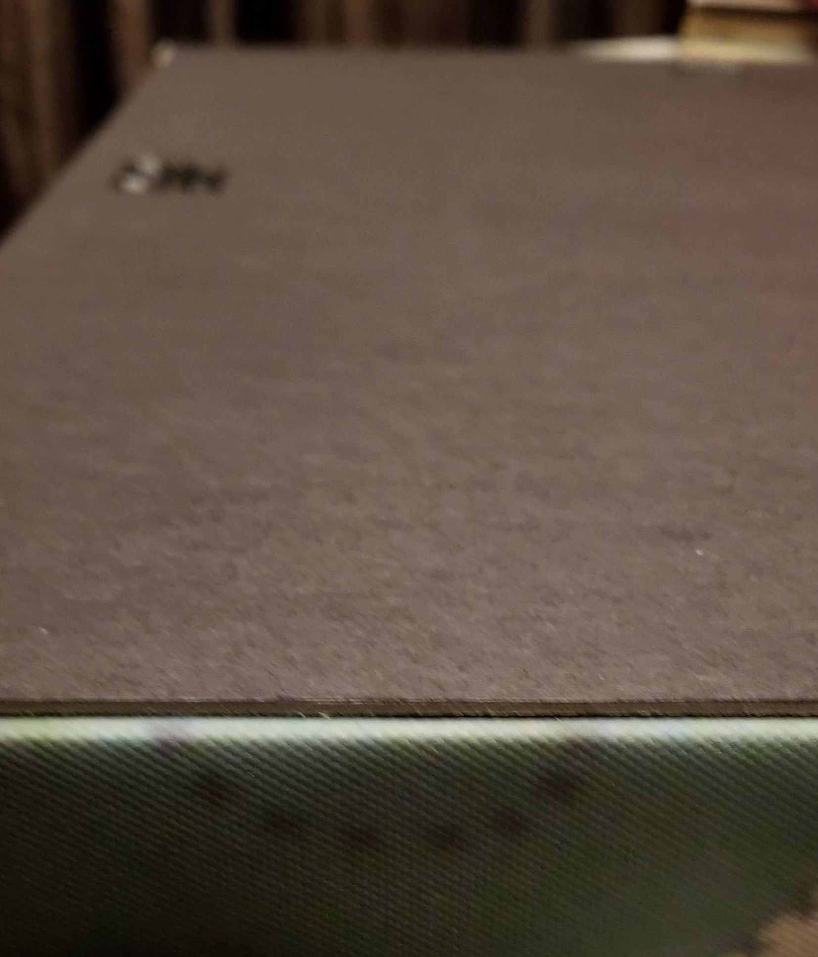

Circling back briefly to post #9929 I removed the rest of the backing from the frame and found this. In retrospect it would be easier to remove the backing and THEN trim it down to size for attaching to the canvas. Also, the frame on the front side supports the canvas in a very simply supported manner; there is a thin protrusion around the outer edge of the frame that holds the canvas away from the main body of the frame.
