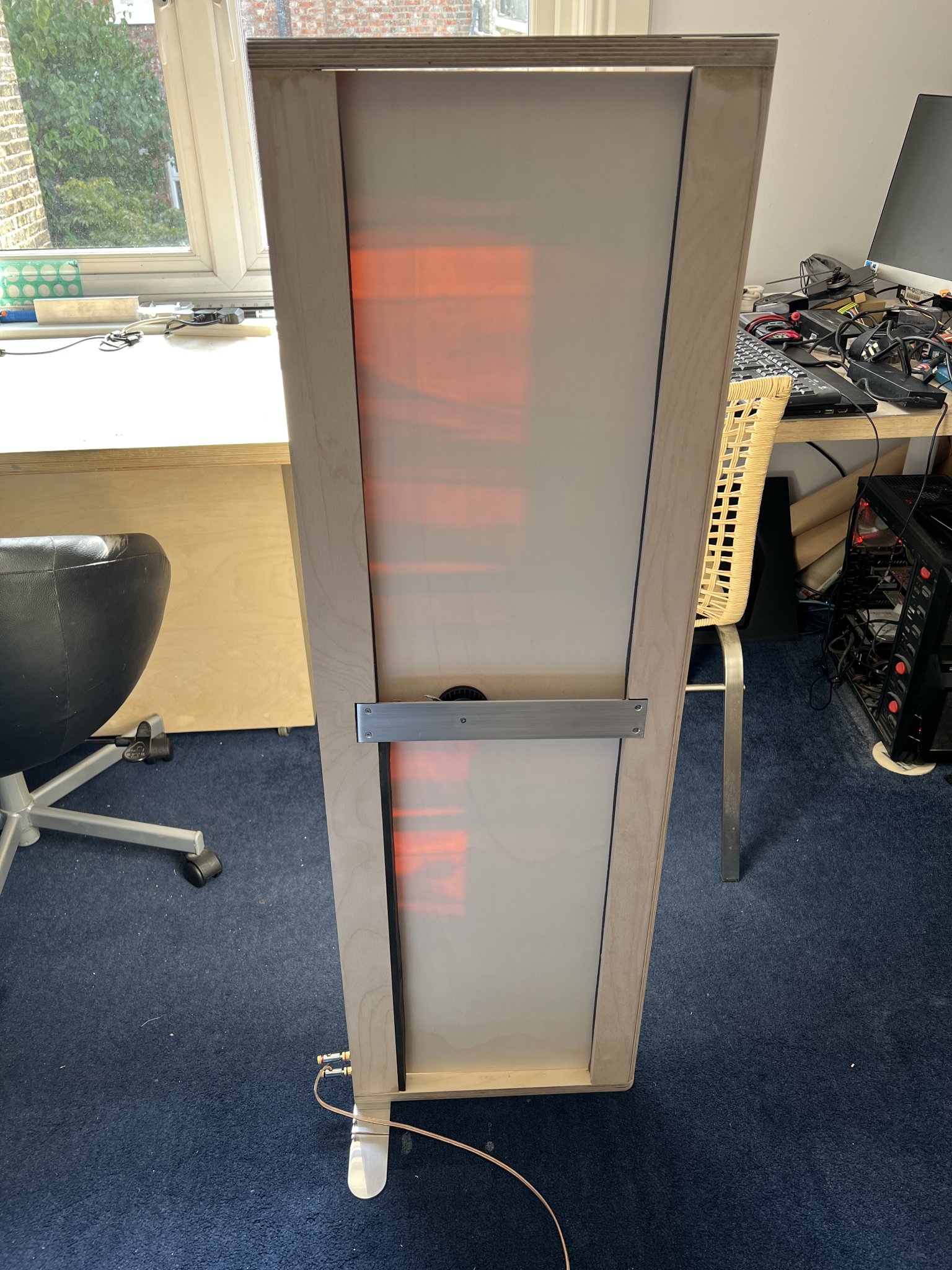

I have used the same exciters on free hung Birch ply panels and the Scandi Blonde experiment and had to correct the top end drop on both of them. I am not sure why these are so extended but they have measured consistently in two versions of the same type of build now. The difference in build suggests the material is giving a better response but I am not sure of the mechanism yet. Picture of the design for reference.
Burnt
My experience with Thrusters is that they're not the best option for hf extension. I put it down to the larger voice coil diameter (32mm vs 25)
My answer to the good hf extension is Poplar vs Birch. Poplar SG is around 0.4, and Birch can be between 0.55 to over 0.7, assuming the ply core is also Birch (may easily/commonly not be).
Lighter is better for hf.
Perhaps interestingly, some while ago I tested 3mm Tasmanian Blackwood panels which are harder and denser than Poplar by some margin, and as expected, the efficiency was down compared to Poplar, but it produced perhaps the most even frequency response I've seen so far, maybe because of the damping factor of the material.
When I get time I intend to revisit those panels.
Eucy
Reactions: Earborne 963Hz

"I am a bit surprised at the plunge below approx 160Hz for a panel that size... Any thoughts on that??"
In my experience when DML's move out of their operating window with bass their response plunges. 160hz seems a bit high but I am not to concerned as the sub fills in nicely. I spent a lot of time a year and half back trying to coax more bass out of DML's but in the end I find IB subs do a good job.
Burnt.

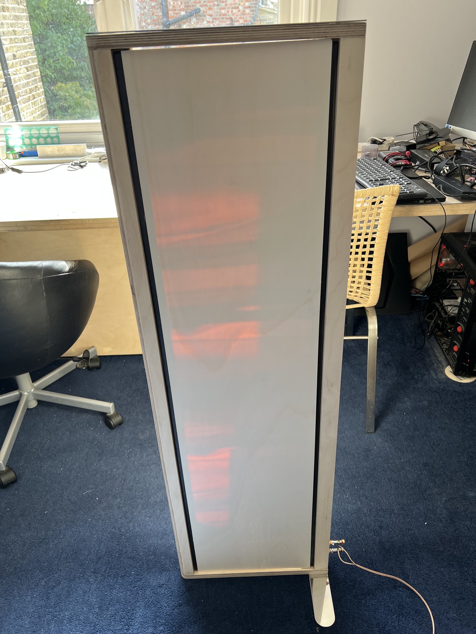

Hey BC , You mentioned your current panels are 3mm Poplar , why do they look glossy in the photos ? , Did you use a coating on them ?
thankyou.
@Earborne 963Hz
Hi. They are not glossy. The day I took the picture it was very sunny. What you are seeing is the effect of the sun shining through. In my experience I find Poplar ply doesn't need any treatment. Others may have tried treating the surface and there is an argument for stiffening the skin by applying a thin layer of epoxy on both sides but that would add weight which is to be avoided.
