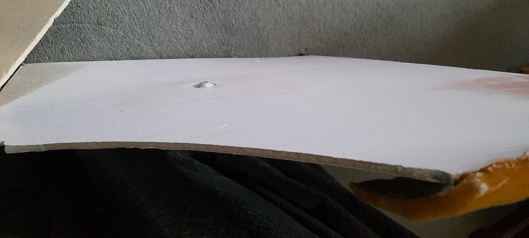

Does anyone have learnt experiences on the type of paint to use over XPS foam ?
The only XPS panel i can get in Australian "Big box" stores is a bit porous , The options would be water based so it doesn't break down the foam like a solvent based paint , latex style paints may be too soft and could damp out waves.
I looked at some paints which are claimed to be "non - stick - dirt shedding coatings which i wont use in case the VHB tape unsticks itself.
So i am thinking of exterior house paint because it dries a little harder than an interior paint would and may possibly give sharper cleaner waveform reflection
I also have a choice of satin sheen which is like a matt coating but that may also act a little dull compared to a gloss reflective surface.
There is also Gloss which might sound too tinny so i will probably start with semi-gloss as a starting point .
Edited ** I will use a circle of epoxy (araldite) to mount the exciter on to before i paint the panel , i will sand the front only and recoat if neccessary.
Do people think the 50/50 PVA is still a better sealer for its hardness over water based exterior paint ?
You can water down vinyl silk or matt paint, similar to pva.
This will help keep the weight down and not damp the panel as much.
You could also give the panel a coat of pva to protect the panel from solvent paints.
Coating the panel in paint will reduce colouration in the panel similar to doping a paper cone speaker, for a smoother sounding response.
Epoxy has the opposite effect and brightens the sound giving a higher HF and a more lively sound.
The shiny XPS surface should not be sanded when Coating with Epoxy.
The thinned vinyl will run off of the shiny surface if not sanded.
If painting the whole panel, do not coat the area of the exciter coil , paint is not glue and can easily peal off the exciter.
The 50x50 mix of pva when the water has evaporated, will only leave a trace of pva on the panel.
The paint even when watered down will start to increase the weight, so it will damp the sound more.
To be honest, I would now only use thin Epoxy coatings on XPS, as thin as possible to keep the weight down.
With the right exciter this changes the XPS into a full range panel material with good sound.

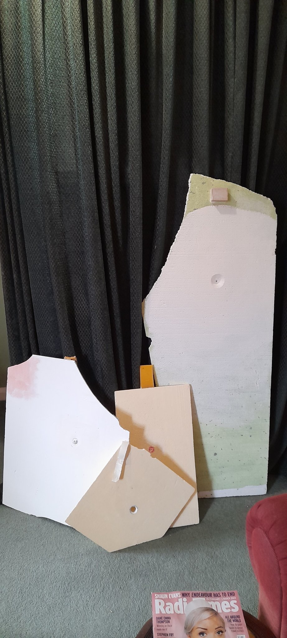

Some pictures of my various vinyl painted panels.
The green panel is the epoxy coated panel, I used a small roller to apply this coat which is too thick I think.
If I did this in the future I would probably use the scraper method to help keep the weight down ?
Hope this is of some help.

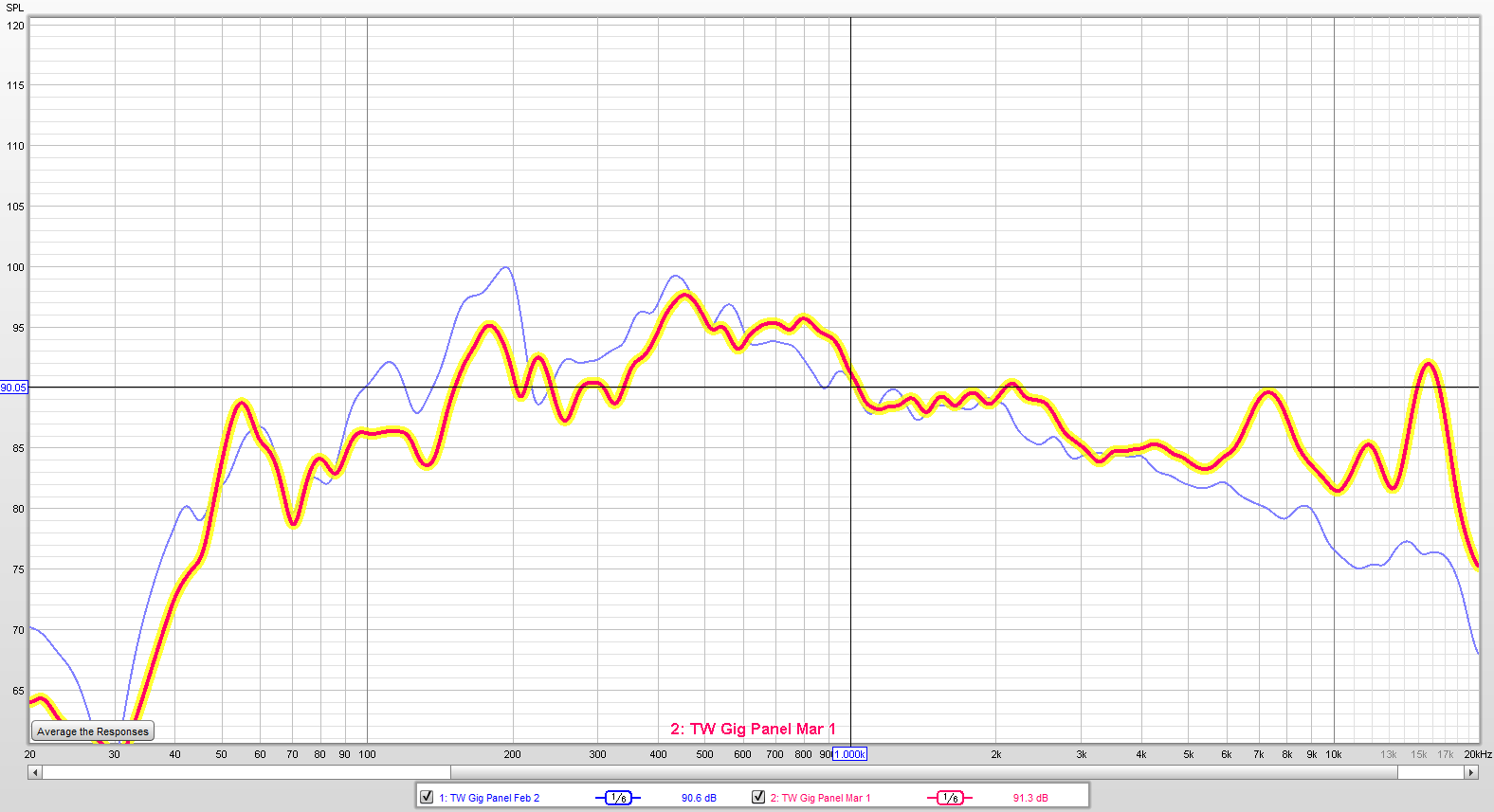

I suspect that my own panels might have developed a bit of a peak around 500hz, and this might explain why Steve's EPS panels sound so aggressive in them.
Please comment.
I have never reeeelly bought into the idea of 'running in' speakers of any kind.
In my experience, speakers perform the same they do when you buy them as when they're older, barring depleted wallets, hopeful psychological issues and perishing surrounds of course. Same as when you overhaul your old Cosworth racing engine just before a race, as opposed to racing it 3 months down the line when the valves and rings are stuffed to hell-n-gone.
I measured my 'Gig Panels' (4 x DAEX25Q-4's each in 2 x 1,400mm x 450mmx 5mm Twinwall panels) beginning Feb just after assembling them, and I was a bit 'meh'—they were a lot better, bandwidth-wise, than the high power 30HESFs and "32QMB-4 Mega-bass" drivers in the same panels. But I still had to EQ them quite a bit to make them palatable for general stage use.
This has changed.
I find I have to EQ them less and less to get the sound that I want.
I've just compared them to the measurements I did a month ago (after A LOT of very loud abuse) and there are differences. I stand corrected: Drivers DO need to be run-in.
And as you can see, there is definitely a 450hz peak that might disagree with any other signal source with a similar peak.
Oh. And check out the bass end... Unless I'm driving very loudly indeed on stage, I don't need a sub.
50hz on the bottom is wayy enough for almost everything I consume at home.

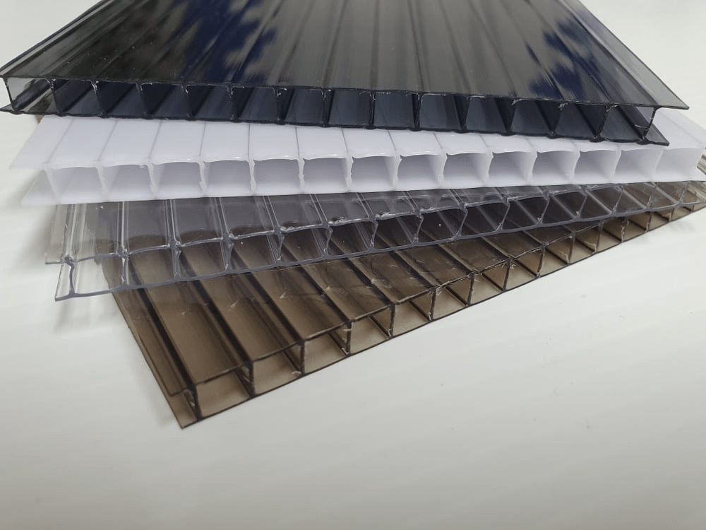

Are your panels polycarb or polyprop?
Eucy

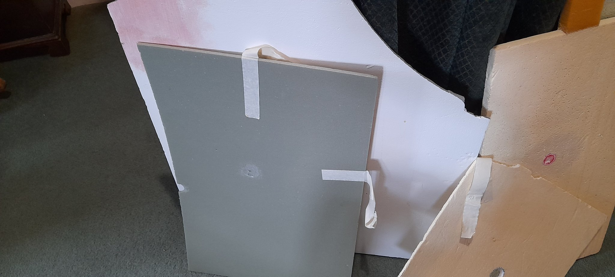

That is the CD I was using.
I presume you are referring to the epoxy XPS not the small EPS panel on the left ?
I made this recording from my seating position 3m back from the panels.
The room is stacked up with boxes on both sides of the walls.
This was to show the in room bass response under normal- ish room conditions.
Plenty of room problems.
I always recommend using headphones as this gives more of a being there sound.
I would expect the recording to sound odd being played over another stereo system.
I usually try to get close to the panels, under 1m to minimise room problems
The proplex was a 2ft x2ft panel.
The XPS epoxy panel was 85cm x60cm.
I could hear an echo in the panel ,that was why I subsequently used smaller XPS panels to reduce this.
Some small weights might solve this problem?
I will have a look tomorrow when I get time.
Steve.

They are polycarb.Are your panels polycarb or polyprop?
Eucy
They are lighter and harder than polyprop which I have tried and which I found to be unsatisfactory
I have no idea Steve.I presume you are referring to the epoxy XPS not the small EPS panel on the left ?
I was referring to the file names:
Yep...I have yet to try Polycarb,. Steve wasn't impressed from memory...bright but plasticky???. Can't remember... Both he and I have quite good results from polypropylene... A bit soft without added measures but generally better than expectedThey are polycarb.
Eucy
Yes, bright and plasticky indeed. But it's given me the best combination of HF response and efficiency so far.Yep...I have yet to try Polycarb,. Steve wasn't impressed from memory...bright but plasticky???. Can't remember... Both he and I have quite good results from polypropylene... A bit soft without added measures but generally better than expected
Eucy
I've damped the plasticky sound by applying a few layers of spray paint.
Eucy, Andre.
All materials have their trademark sound, it is what we do to minimise this and what we can put up with.
I have only tested the 1cm thick square fluted Polycarb sheet.
Which had a very hard bright sound ,I don't remember it being that efficient except in the hf ?
But I was only using my 10watt exciter.
The 4mm square fluted polypropylene panel does seem to have a sort of cardboard sounding coloration to it ,compared to the round flueted 6mm proplex panel.
The proplex sound is hard to pin down, or I have not been paying enough attention, but nothing has hit me in the face yet, apart from the usual problem of a heavy panel.
And this is a very heavy panel, that is why I am trying out the thin film on these two panels.
The round flueted proplex panel did surprise me, I was not expecting this sort of performance from such an over damped panel.
I expected it to sound over damped and dull with curtailed frequencies.
There is one slight problem I have found, which is where to buy the product!
I have had a look on the Internet, and cannot find any trace of it ?
Only square flutes , which probably means that if round flutes can be found it will be very expensive .
Steve.
