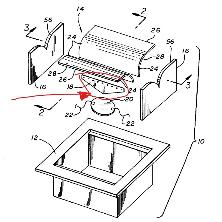

@ Andre Bellwood
Further to my post #8,616
It might be interesting to transfer the 'pistonic' motion to the panel front through a slit in the panel by some sort of a stiff material from the transducer, maybe as shown in this Paddock patent. Red arrow.
The panel doesn't have to be curved as in that patent. By keeping the transducer away from the panel, the panel would not get any distortions from the transducer, or at least be minimalised. The transducer is a piezo in this patent, but it can be any motor. In this patent and in Arcophon, the all sides/edges are held tight, maybe with a soft foam underneath, except the edge(s) that gets the vibrations from the transducer. When we have a flat panel, and with all edges held tight, we can make a slit in the panel to transfer the 'pistonic' motion vibrations to the front. We may not divide the divide the panel in half as in Joppe's video. But we can prepare that area around the joint vertically to get more HF. Just a thought. 🙂

Is this the Rubanoide tweeter?@ Andre Bellwood
Yes, I've been tempted to build something like this with an exciter behind it. But if I did go that far then I think I wouldn't even bother with a panel around it, and just make it long enough to hit at least 150hz on the bottom end, and have space for 4 or 8 exciters on the back... I'd also try to make it open-back and dipolar...
I'm undecided.
Just taking an idea off that patent. 🙂Is this the Rubanoide tweeter?

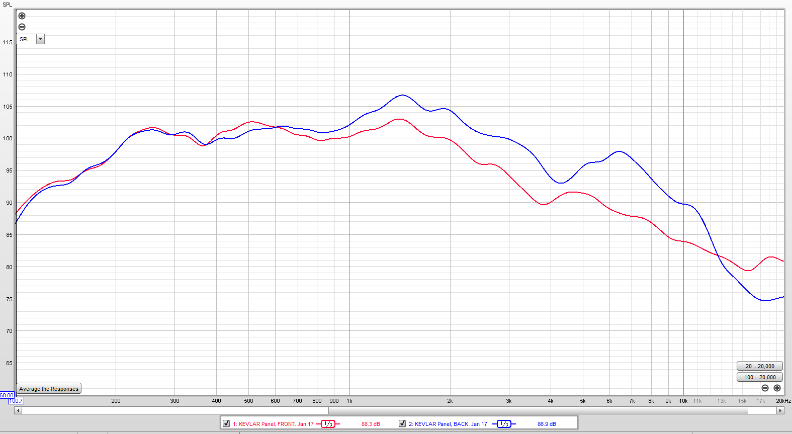

Great!Hi Thomas,
Ok, so I've tested this...
There's a difference! Red trace is the front side of the panel. Blue is the driver side on the back...
It’s confirms my thought.
It supports that the panel needs a core that is light and does not compress easily.
Thomas

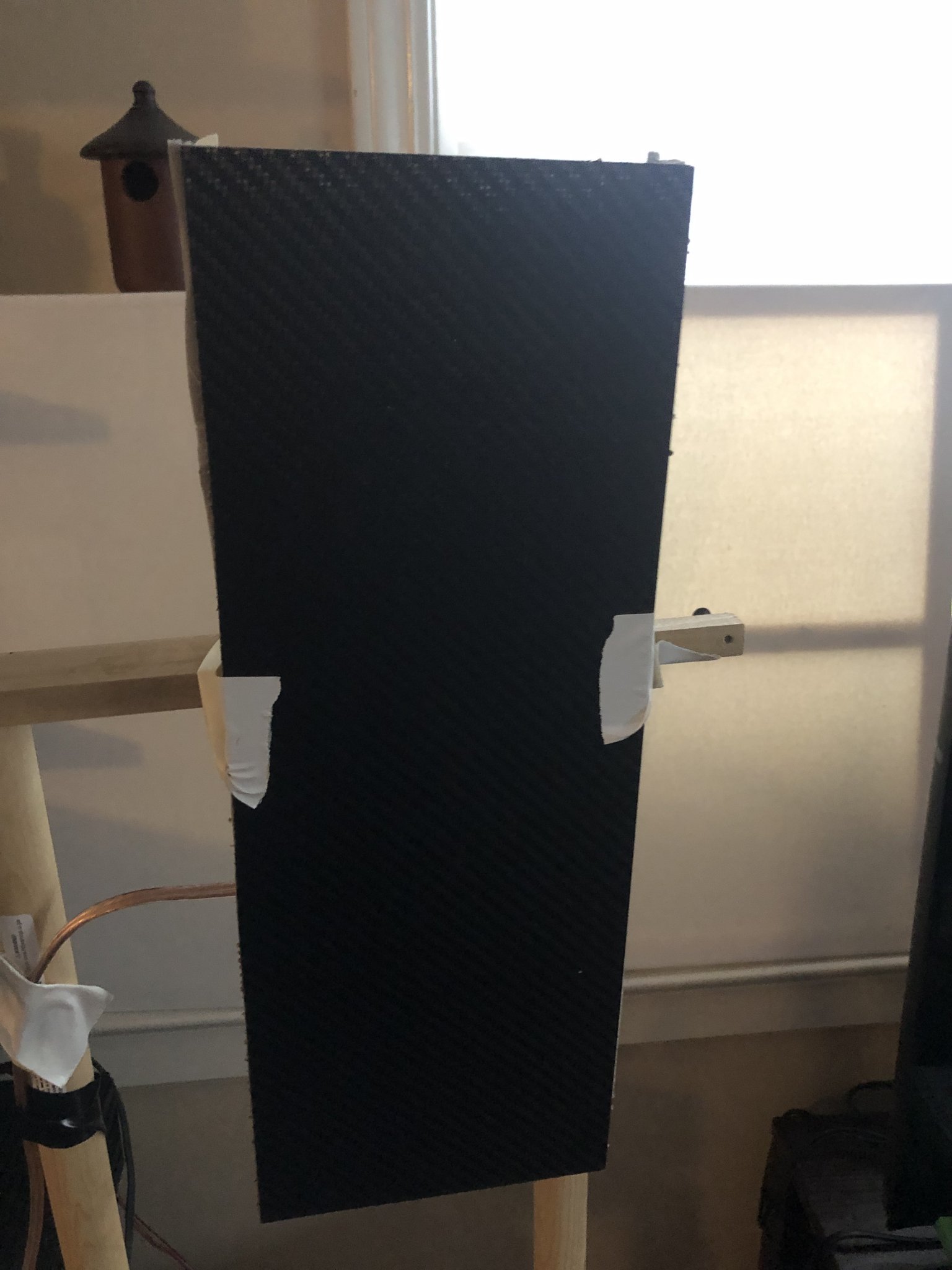

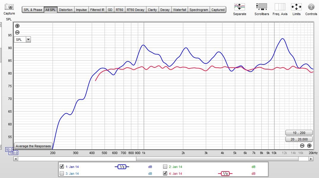

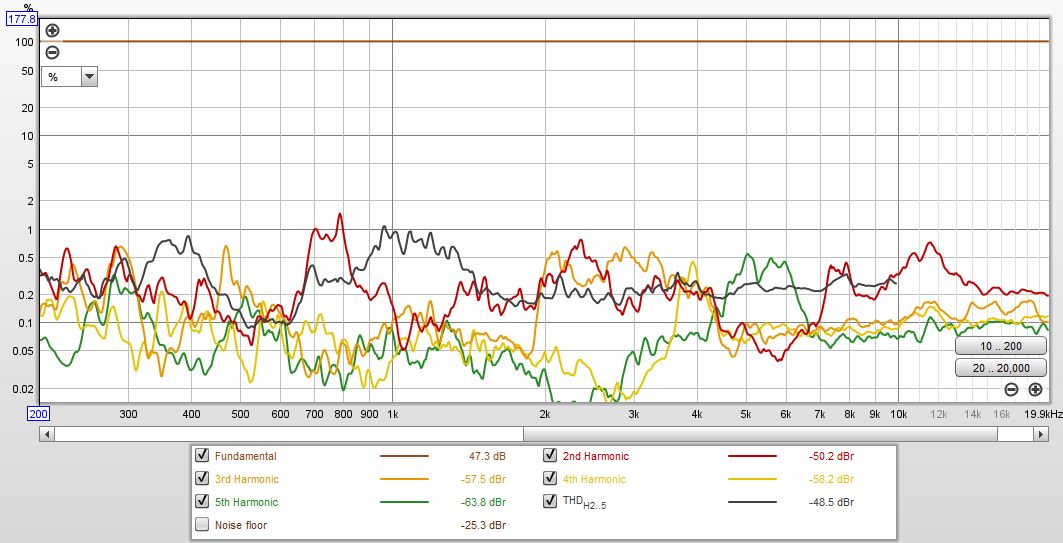

I've been experimenting with smaller panels to use in a 2-way setup. I've settled on a 350mm H by 150mm W panel made of a 3.5mm Nomex honeycomb core sandwiched with CF (purchased panel). I will probably crossover around 400Hz because the woofer I'm using has lower distortion below 500Hz. I'm using a MiniDSP 2x4HD for EQ along with REW for measurement. After measurement REW provides a file export of the EQ filter coefficients that load directly into the MiniDSP. The attached response was accomplished in less than 15 minutes (blue is prior to EQ and red is after). I was kind of amazed at how well the panel responded to EQ. I'm still working on the woofer integration. The current panel mounting is a bit crude. I have 3/8" foam strips along the edges and the white duct tape provides a quasi "medial clamp". This is a work in progress but pleased with the results so far. The exciter is a PUI Audio ASX0504-HD-R.
Thanks, Dave
Thanks, Dave
What is the exciter placement?I've been experimenting with smaller panels to use in a 2-way setup. I've settled on a 350mm H by 150mm W panel made of a 3.5mm Nomex honeycomb core sandwiched with CF (purchased panel). I will probably crossover around 400Hz because the woofer I'm using has lower distortion below 500Hz. I'm using a MiniDSP 2x4HD for EQ along with REW for measurement. After measurement REW provides a file export of the EQ filter coefficients that load directly into the MiniDSP. The attached response was accomplished in less than 15 minutes (blue is prior to EQ and red is after). I was kind of amazed at how well the panel responded to EQ. I'm still working on the woofer integration. The current panel mounting is a bit crude. I have 3/8" foam strips along the edges and the white duct tape provides a quasi "medial clamp". This is a work in progress but pleased with the results so far. The exciter is a PUI Audio ASX0504-HD-R.
Thanks, Dave
ExcellentI've been experimenting with smaller panels to use in a 2-way setup. I've settled on a 350mm H by 150mm W panel made of a 3.5mm Nomex honeycomb core sandwiched with CF (purchased panel). I will probably crossover around 400Hz because the woofer I'm using has lower distortion below 500Hz. I'm using a MiniDSP 2x4HD for EQ along with REW for measurement. After measurement REW provides a file export of the EQ filter coefficients that load directly into the MiniDSP. The attached response was accomplished in less than 15 minutes (blue is prior to EQ and red is after). I was kind of amazed at how well the panel responded to EQ. I'm still working on the woofer integration. The current panel mounting is a bit crude. I have 3/8" foam strips along the edges and the white duct tape provides a quasi "medial clamp". This is a work in progress but pleased with the results so far. The exciter is a PUI Audio ASX0504-HD-R.
Thanks, Dave

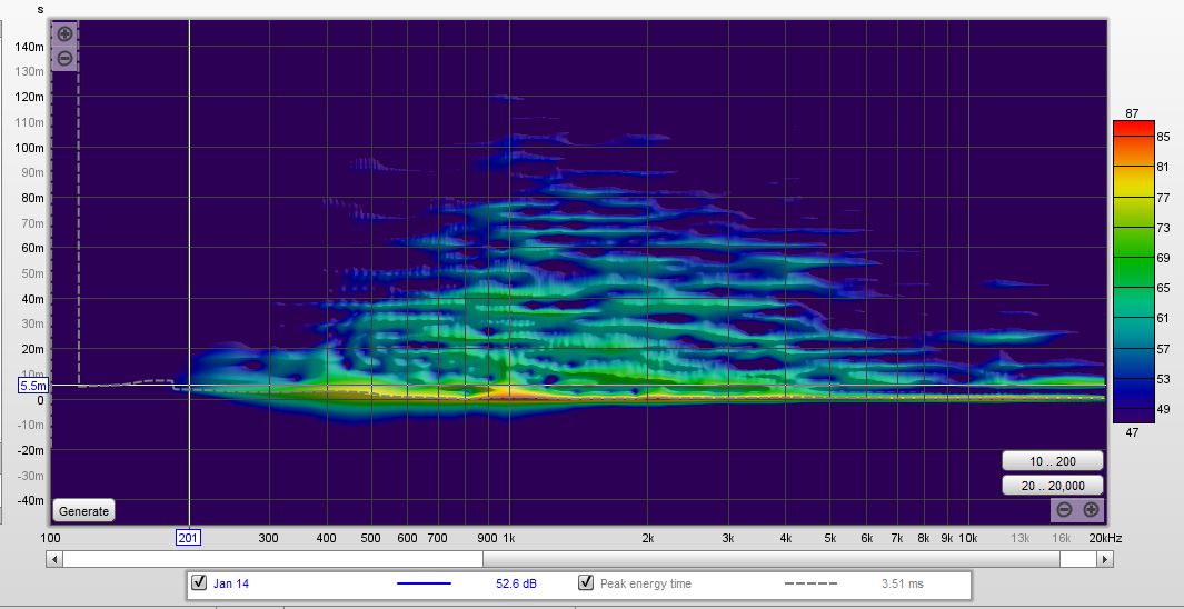

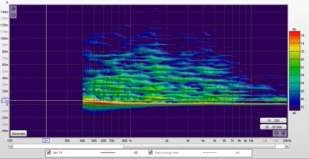

It was already pointed here that the DML by their resonant nature would be suitable for an EQ correction.
Is it possible to see the spectrogram in the wavelet mode 1/6 oct of REW before and after EQ?

Dave,I've been experimenting with smaller panels to use in a 2-way setup. I've settled on a 350mm H by 150mm W panel made of a 3.5mm Nomex honeycomb core sandwiched with CF (purchased panel). I will probably crossover around 400Hz because the woofer I'm using has lower distortion below 500Hz. I'm using a MiniDSP 2x4HD for EQ along with REW for measurement. After measurement REW provides a file export of the EQ filter coefficients that load directly into the MiniDSP. The attached response was accomplished in less than 15 minutes (blue is prior to EQ and red is after). I was kind of amazed at how well the panel responded to EQ. I'm still working on the woofer integration. The current panel mounting is a bit crude. I have 3/8" foam strips along the edges and the white duct tape provides a quasi "medial clamp". This is a work in progress but pleased with the results so far. The exciter is a PUI Audio ASX0504-HD-R.
Thanks, Dave
Did the distortion impove after EQ? I assume the posted distortion results (very good!) are after EQ, is that correct?
Thanks,
Eric

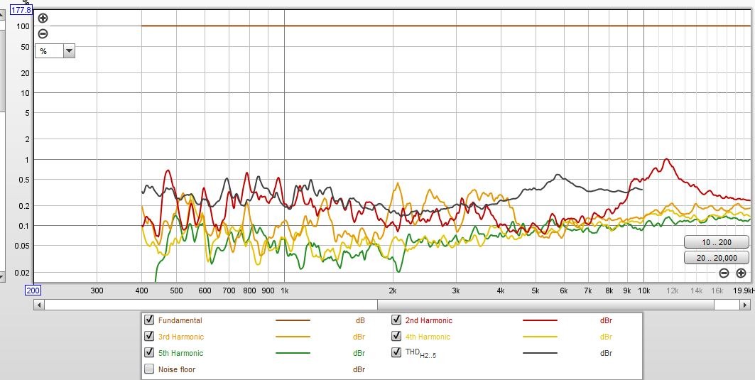

The distortion did improve some after EQ in the 1kHz area (see attached). The exciter is mounted essentially in the center of the panel. Attached are the before and after EQ REW spectrograms.
Thanks, Dave
This is amazing indeed!I've been experimenting with smaller panels to use in a 2-way setup. I've settled on a 350mm H by 150mm W panel made of a 3.5mm Nomex honeycomb core sandwiched with CF (purchased panel). I will probably crossover around 400Hz because the woofer I'm using has lower distortion below 500Hz. I'm using a MiniDSP 2x4HD for EQ along with REW for measurement. After measurement REW provides a file export of the EQ filter coefficients that load directly into the MiniDSP. The attached response was accomplished in less than 15 minutes (blue is prior to EQ and red is after). I was kind of amazed at how well the panel responded to EQ. I'm still working on the woofer integration. The current panel mounting is a bit crude. I have 3/8" foam strips along the edges and the white duct tape provides a quasi "medial clamp". This is a work in progress but pleased with the results so far. The exciter is a PUI Audio ASX0504-HD-R.
Thanks, Dave
I find it very interesting indeed that the DSP Eq reduces distortion to such a degree. Is this because of undamped panel resonances that are addressed or controlled by Eq?
I've been very very tempted to use a DSP-based EQ, with a pre-programmed curve embedded in an integrated chip in a pre-amp. And your results make me do a double-take and force me to consider this option very seriously.
I too found that the centre placing of the exciter works well, when the height is near or more than double the width. This places the NXT patents (and others following/copying them) somewhat on its head. Sure, EQ works quite well with thin panels, just like with 'normal' speakers.The distortion did improve some after EQ in the 1kHz area (see attached). The exciter is mounted essentially in the center of the panel. Attached are the before and after EQ REW spectrograms.
