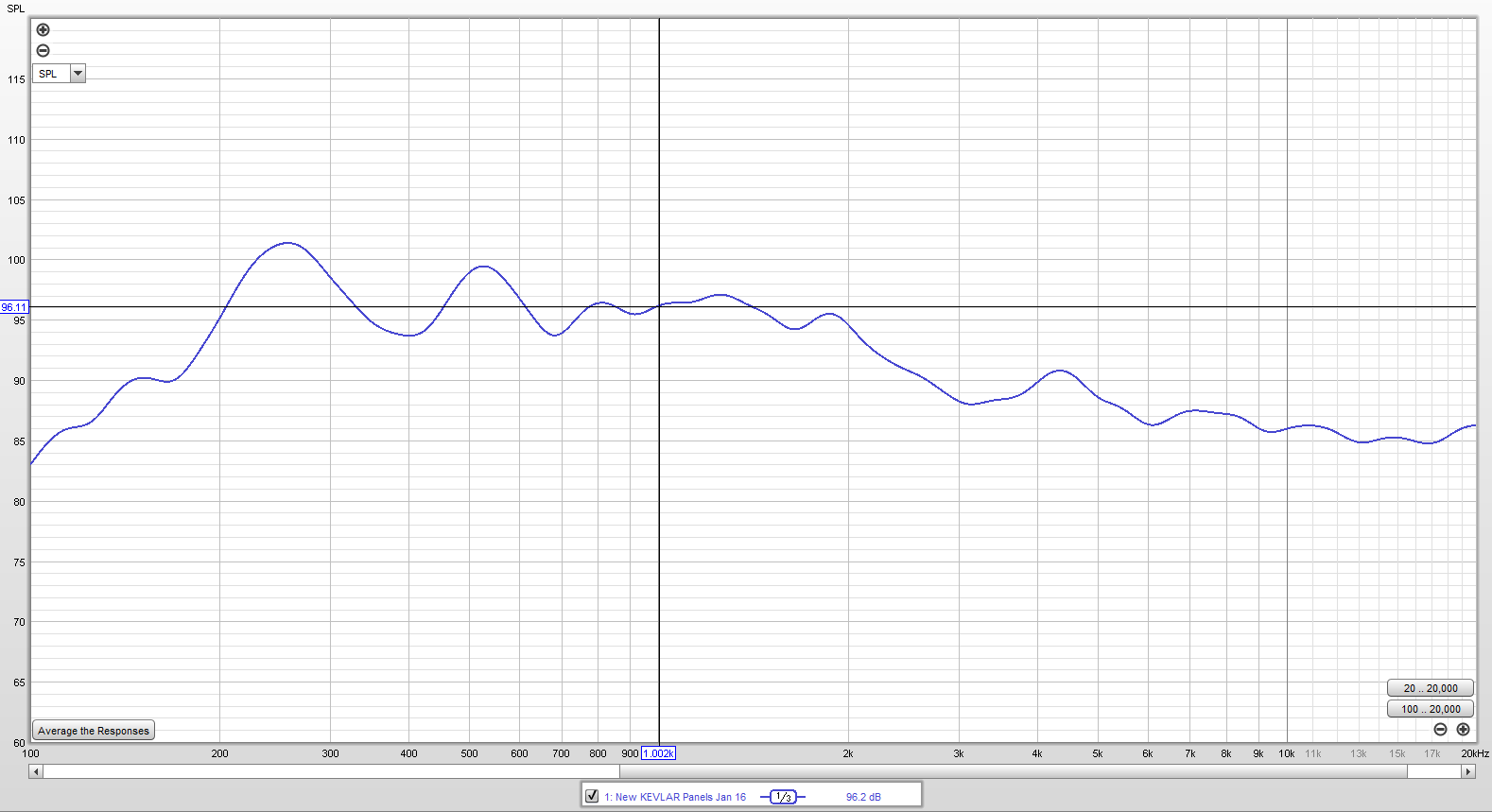

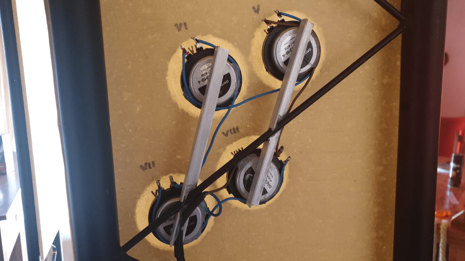

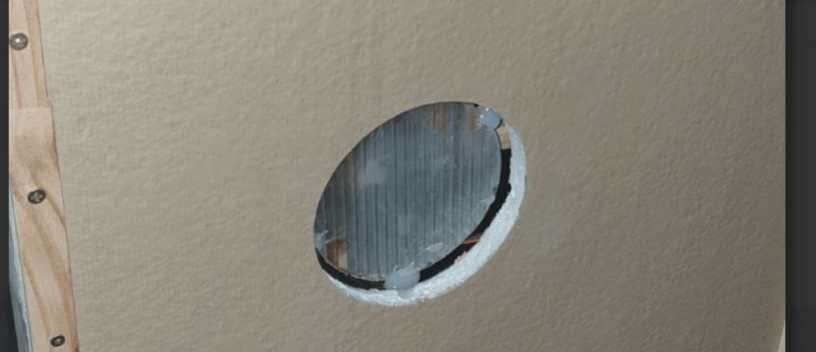

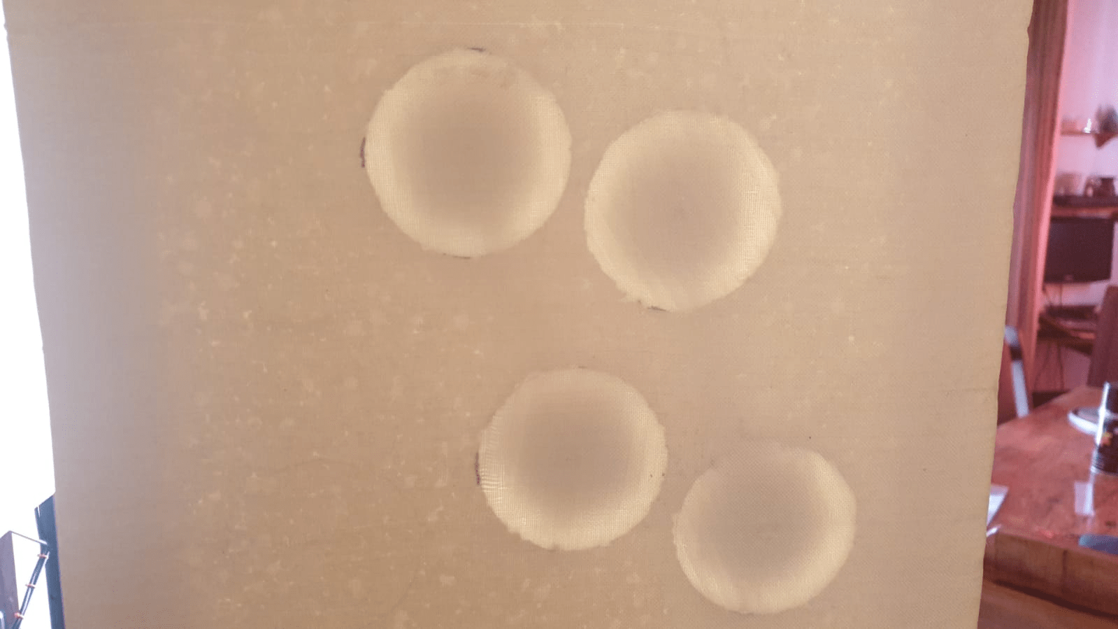

This is exactly what I've done. I used small polycarb Twinwall pucks through tightly-fitting holes in the EPS, and covered with Kevlar skins both sides to keep material impedances as low as possible. You can clearly see the sagging HF...

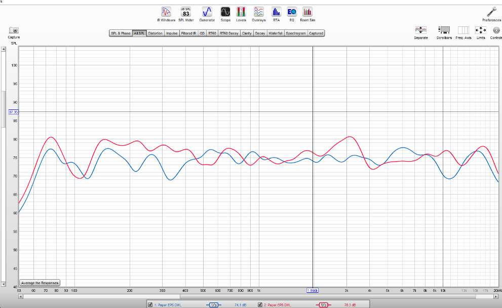

In my previous experiments, I'd used a much larger puck and connected it to the panel via "legs" without connecting through the skins. Paper in this case.
This gave a beoootifully flat response, but kak sensitivity. Nice for Hi-Fi, but useless for PA.

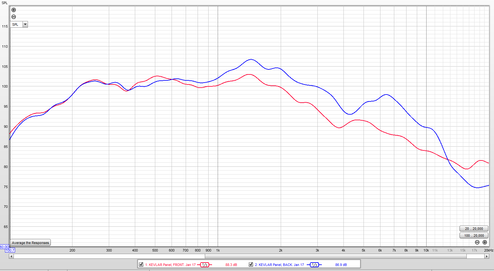

Ok, so I've tested this...
There's a difference! Red trace is the front side of the panel. Blue is the driver side on the back...

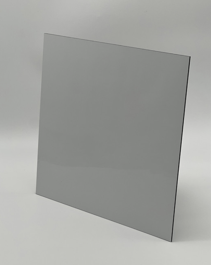

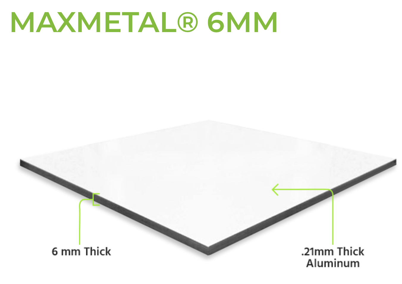

Great find. Looks like a promising option – but at a price, as you mentioned. They will be only half the size of your current panels. At least the shipping will be free for you. Keep us posted - I am very interested in your findings.A possiblability?
AlumaComp Aluminum, 30"x36" Archival Painting & Mounting Panel
Not cheap.
Polyethylene core 1/8"
Size : 30" x 36" x 3/16"
Seems heavy, but perhaps not much heavier than 6mm Proplex.
I've got some from having mounted a painting.
You can cut it with a good razor knife.
On my list to try.
Do you know what core your current Valcucine panels have? I suspect aluminum. Here we can get two kinds of honeycomb core – aluminum or Nomex, but both are unaffordable.
Art conservators use panels like these. In the past I could get various kinds of aluminum skinned panels over various cores (e,g., foam core, aluminum honeycomb, paper honey comb). One could get them in various thinknesses of cores and skins. Many such panels had wood edges (covered front and back with the aluminum skins) suitable to staple canvas or paper. A couple of suppliers will still produce custom lay-ups at very expensive prices.Great find. Looks like a promising option – but at a price, as you mentioned. They will be only half the size of your current panels. At least the shipping will be free for you. Keep us posted - I am very interested in your findings.
I'll try this AlumComp panels as rear surround speakers.
Sign blanks (in the US) seem like similar the the AlumaComp panels. A couple of suppliers: Sign blanks & Maxmetal
My Valcucine panels have aluminum honeycomb cores, a 4-5 mm aluminum edging around the perimeter (covered by the skins), and the aluminum skins.
