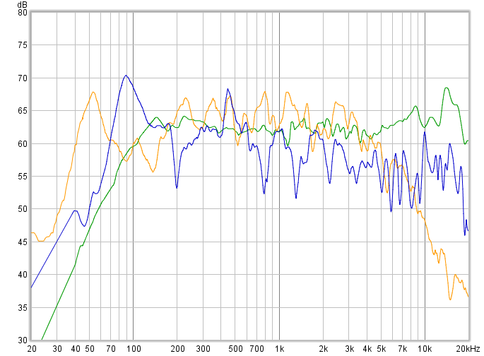

Here's an REW measurement I got last night. Distortion is about 0.5% over most of the range. There is a blip of distortion at around 450 Hz that grows when I turn the volume up. I will have to see if I can figure out how to clean that up.

Interesting plot, should get a great performance.
Thanks sharing build Veleric,
Interesting it looks you get a relative good HF reach there, below 50dB vertical scale comparison should give some feel of response to other systems, blue graph is yours from post 848, orange graph is xrk971 dual exciter from post 1, and green graph is factory datasheet a generic 3 inch wide band transducer Tymphany TC9.
BRYTT,
Very cool overlay! Funny, mine has dips where ever xrk971's has spike, and vice versa. Combine them for dead flat response!

And thats exactly what the Tech Ingredient guys did in their second video, They combined the outputs of acoustic ceiling tile with XPS to get a better, smoother output in the far field. There claim was that was far superior to using weights for damping of resonances. But talk about lack of WAF and the amount of space needed...it works, but is it practical for anyone?

Had not noticed that good spottet 🙂
Find it interesting that many down the thread report of higher resolution from their builds compared to normal speakers, as was the case pages back replaying the Lou Reed track Walk on the wild side over DML panel, aware non controlled subjective review reports can be misleading but in that many talk resolution imagine there must be something about it.
Thinking over why the reported higher resolution made me do the overlay, you know find differences to normal speakers because responses so far looks not be very smooth and maybe that non smooth distortion can subjective be interpreted as a higher resolution is a thought, other differences to normal speakers could be if these panels are true omni including their HF reach which if they are would bring them closer to how most natural instruments works, and also xrk971 impedance plot from post 1 show interesting stuff, know it looks scary ragged but overall impedance swing in ohms is actual only a small fraction compared to normal transducers and should lead to less phase distortion when we use voltage amps to feed a current device.
About response think it would be interesting if some dips are someway more or less destructive or they can simply use a 100% reverse mirror EQ and panel system then goes flat as a rock or to whatever the target curve wish is set at.
