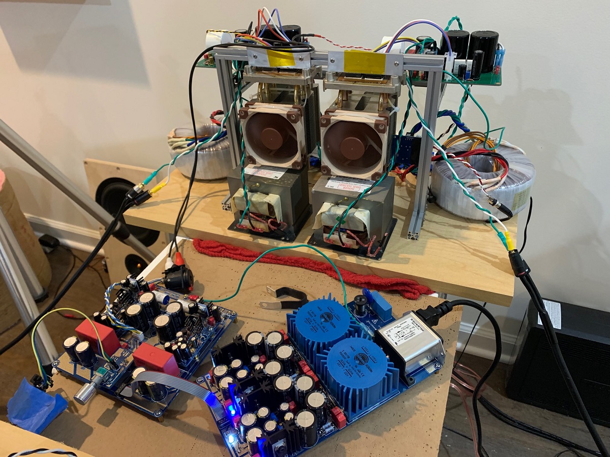

Talk about some mad scientist looking table!
I'd get lost in the wiring! ha ha!
I wouldn't know where the power button is on that contraption!
Thanks for the links, Perceval!
Haha, my amps are often unboxed. Power switch? Yank the cord! 🙂

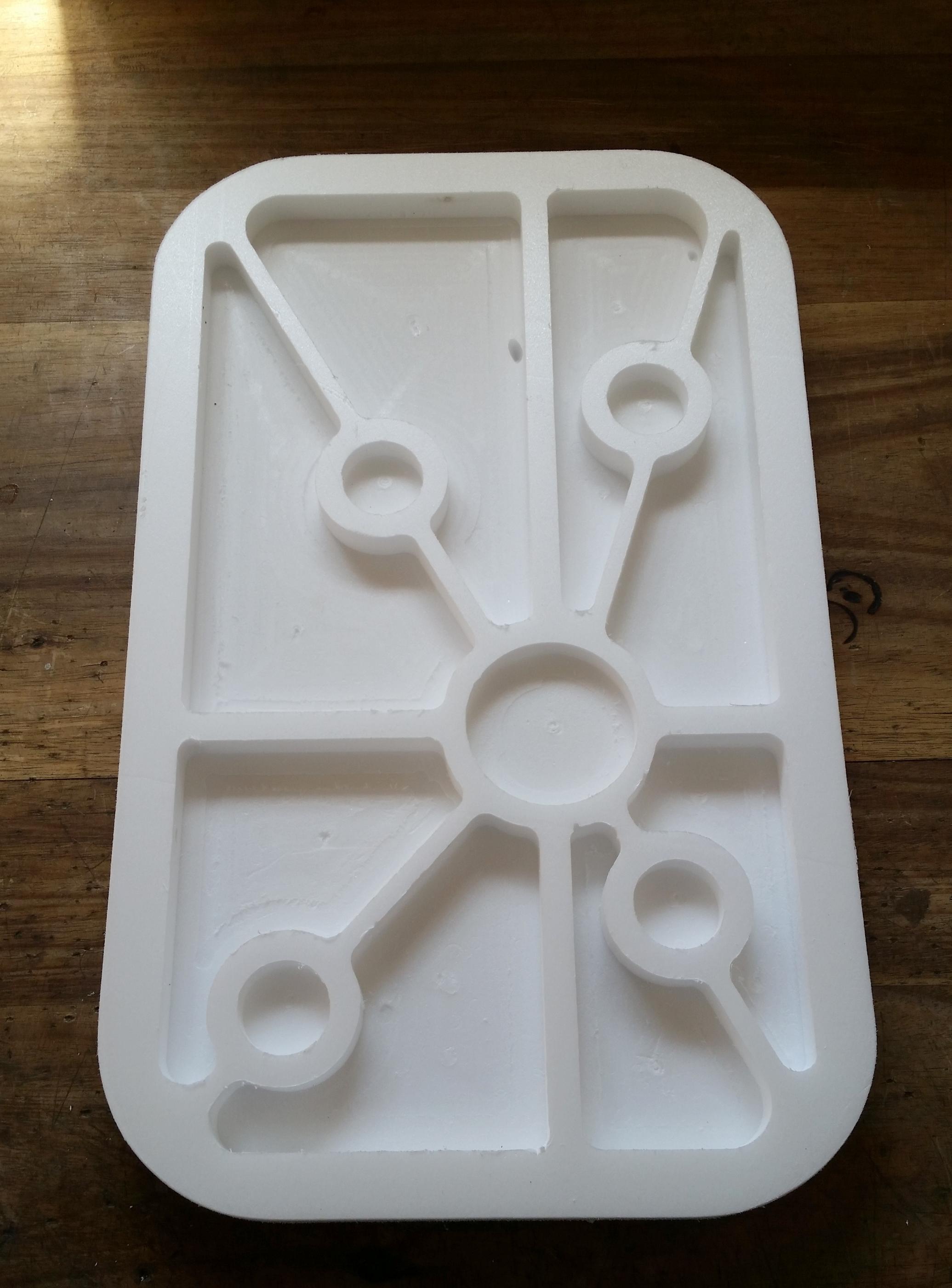

Looking at those, and thinking about modes of vibration, made me wonder if anyone has tried something like a nautilus shell. The shape of which is interesting because it's (discretely) self-similar. A golden spiral, or any logarithmic spiral, is continuously self-similar. That is, the modes of vibration would be the same regardless of the frequency. Well, at least for an infinitely large spiral, but I guess you could make one large enough for a reasonably low frequency.Hi all, first post but I've been stalking this thread for a while. I finally got my first test panel cut a few minutes ago. It's a small 250mmX404.5mm 25mm XPS panel, gonna start sanding now and apply the pva/water mixture and then start cutting another design.
