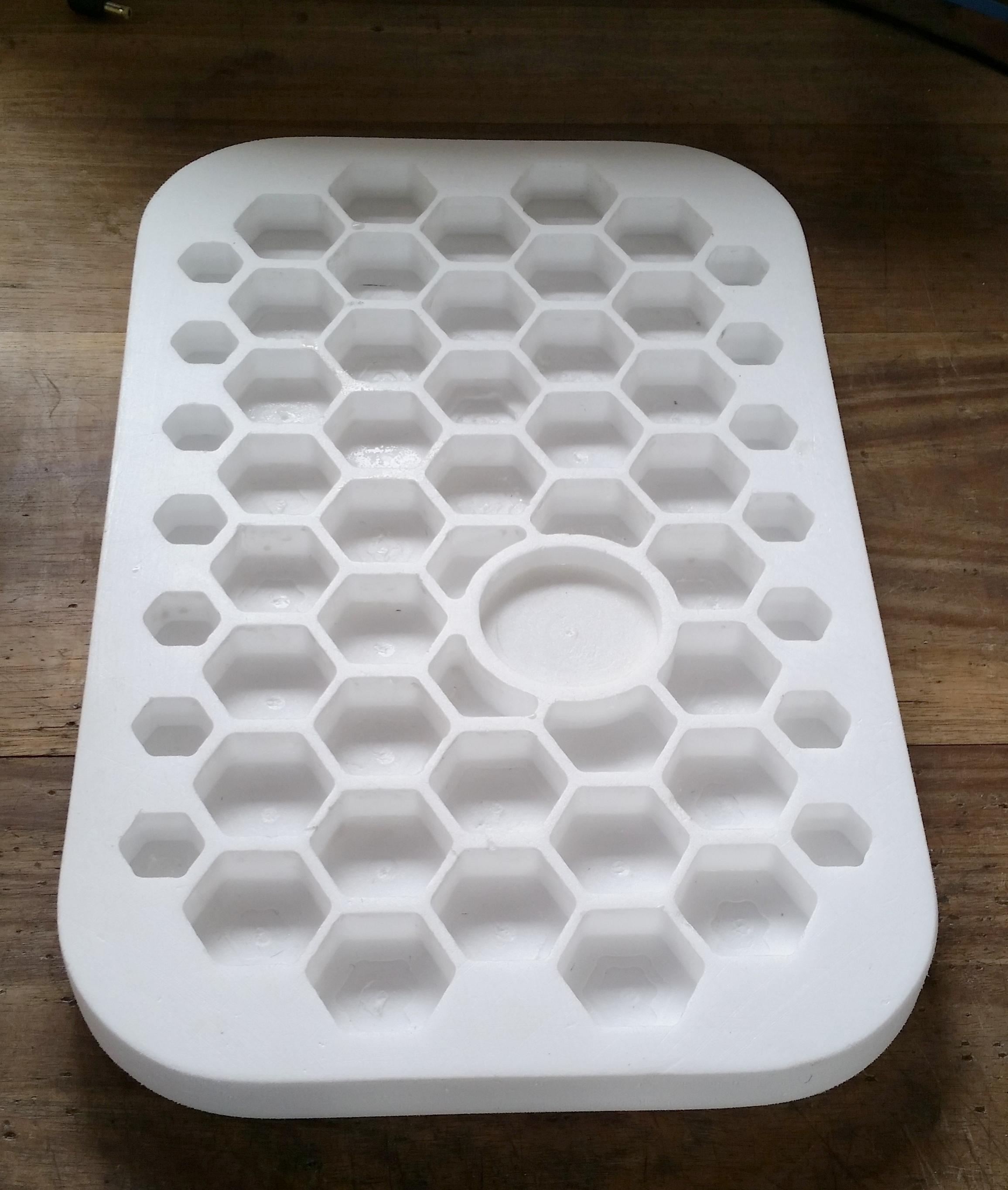

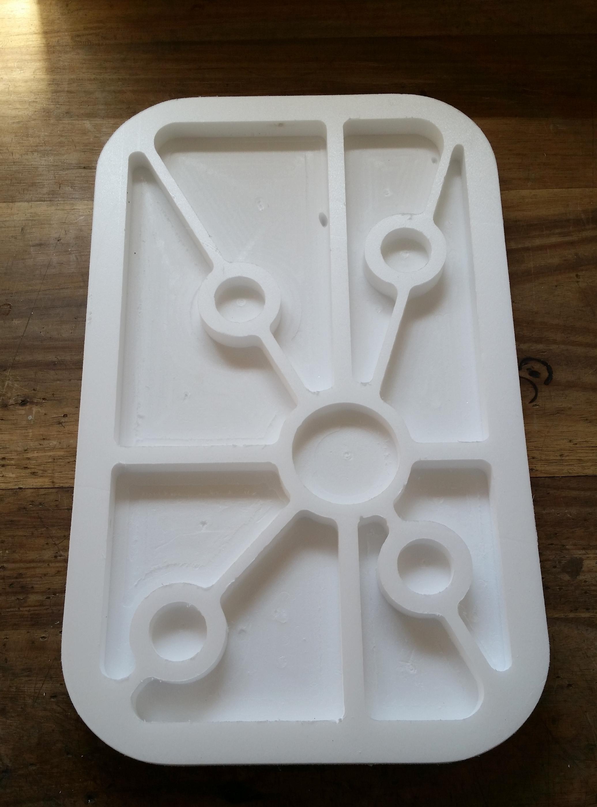

As for the Bertagni design it is a very interesting one. When EPS foam became available in the 1960's a lot of designers experimented with it. I have a pair of KEFB139 drivers which are also flat and made from EPS. They were originally designed to be good for up to 1khz and crossed over to a ribbon driver for the rest of the range but this didn't work as well as intended and so they were relegated to bass only. The reason for this seems to be KEF was working on the pistonic model and had hoped that the structural foam would be stiff enough to prevent breakup. They didn't know about DML operation at the time and so did not optimised the motor system of the B139 to take advantage of DML principles. Instead of a stiff, low excursion system, the B139 has a soft suspension with high excursion capability.
Bertagni seems to have been much closer to understanding the DML operation as a review of his 22 patents will confirm. He started with thin wood and plastic panels and moved to EPS when that became available. But there are some significant differences between Bertagni's approach and the NXT approach. Bertagni uses crossovers to split the frequency range between drivers and panels like a conventional loudspeaker, NXT panels do not. Bertagni also varies the thickness of the EPS panel, the NXT approach does not. Bertagni varies panel size, NXT typically uses a single panel for the entire frequency range.
In practice everyone seems to be in the same space, but choosing different methods to optimise results. This is to be expected, there is a world of difference between the measurement tools available to Dr Bertagni in the 1970's and those available to NXT ( and the originators of the NXT technology) twenty years latter. Dr Bertagni was a physics professor and a very intelligent and talented designer who was well ahead of his time so all credit to him. But he does appear to have been doing things differently to the NXT approach. Both appear to be successful. I don't think its controversial to suggest there is more than one way to successfully exploit this technology.
Edited to add- the BMR technology does indeed appear to be closer to the Bertagni approach in the way it exploits varying the panel area according to frequency. All in the same family, controlled vibration in a panel rather than pistonic operation, but yet another embodiment of the basic principle.
