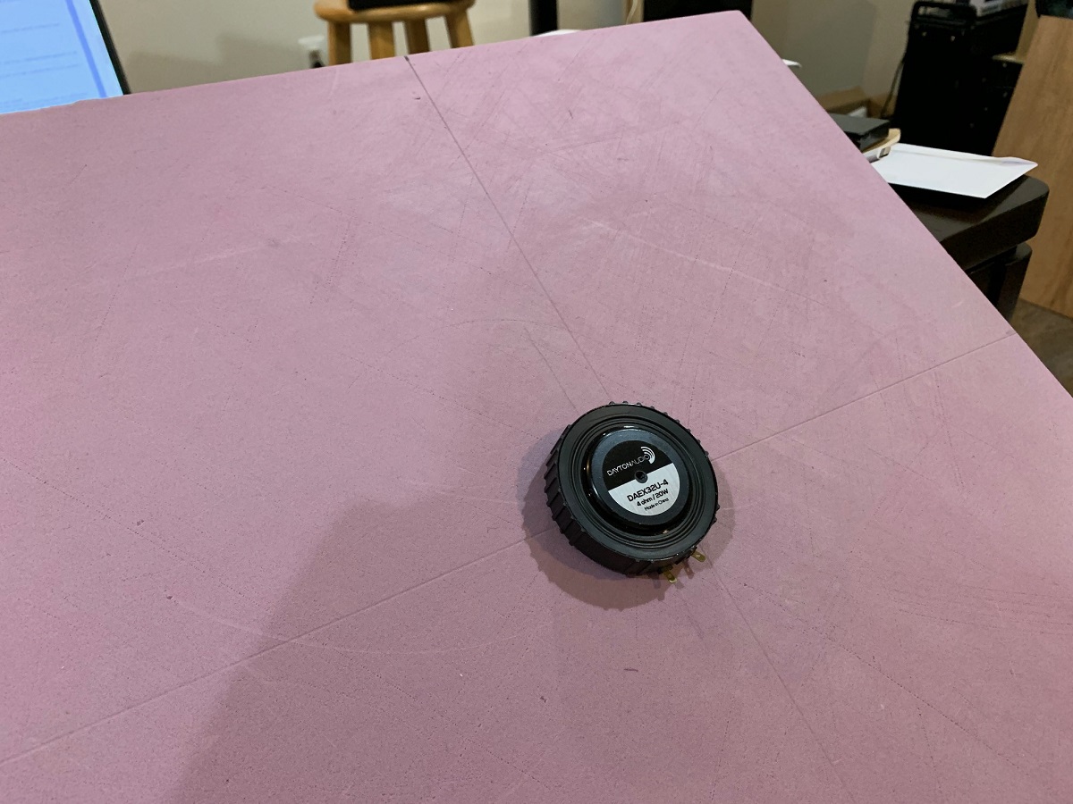

Interestingly, my overall impression is that exciter position actually makes less difference than I initially expected. Typically I have done this experiment while playing pink noise and monitoring the output with an RTA app on my phone. I know/admit that this is a pretty crude measurement and I suspect that if I performed proper REW sine sweep measurements instead I would probably see a lot more difference between exciter locations than I do with my simple pink noise RTA test. Someday I'll do that.
I have observed that having the exciter in the vicinity of the center gives more output. But otherwise, I don't see any clear trends. Supposedly, the exact center (or anywhere along either center line) is a generally cited as a poor location, because so many modes have nodes there, and hence you minimize the number of modes you can potentially drive. My "measurements" however haven't shown any significant difference between the exact center and other locations nearby.
Likewise, the 3/5 location doesn't appear to me to be particularly magical. Is seems to give about the same result as about anywhere in the general vicinity of the center.

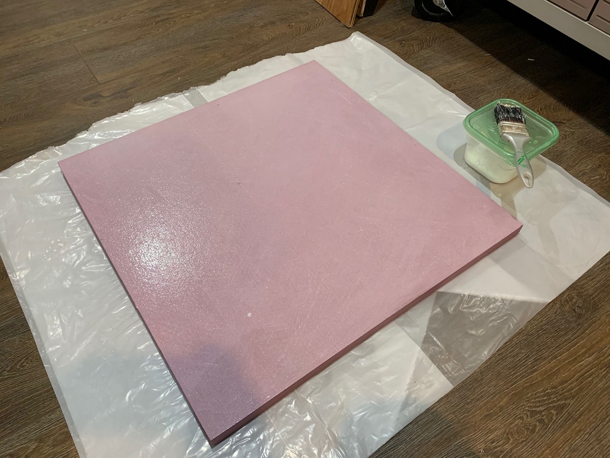

I built a simple DML using square 1in thick 24x24in XPS panels. I sanded the surfaces with 100 grit sandpaper. I treated one of them with 30:70 PVA:water and was going to see if I could measure any differences between treated and untreated. Tapping them with my hand and listening to the sound and resonance, I cold not hear the difference it made. I ended up suspending them from string onto an aluminum crossbar that allowed them to be suspended from a 30in tall speaker stand. After installing the stereo pair I was disappointed to find out that the left channel exciter went dead upon using it for 1 minute. A check with an ohm meter showed open circuit (pretty dissappointing quality control on the Dayton DAEX32U-4 driver). Really wanting to hear stereo - I removed the bad Dayton and installed a Tectonic TEAX32C30-4/B driver. Different exciters on left and right channel I know but this will have to do until I get a replacement Dayton. The sensitivity sounds about the same with both so not too far off. Listening to it, definitely sounded way too bright - and unbalanced - like it needed a BSC shelf. So I went in Jriver DSP and added a -6dB Q=0.5 high shelf at 1kHz for the BSC. I also added +3dB Q=0.6 200Hz low shelf to boost some bass back. Sound is much more balanced now. Driving with VHEX+ 100w Class AB driven by AK4490 DAC from my Cayin N3 via USB 3.0 from PC laptop running Jriver flac or wav files. The sound is surprisingly good considering how simple and inexpensive the speakers are. The sound is wide and lacks pinpoint imaging. But for most music, it works. I am not wowed by it though. Maybe using identical exciters on left and right might make a difference - we will see.
Listening to jazz with Chick Correa, Dave Brubeck, Melody Gardot; also some pop and classic rock thrown in. With the EQ, much better and could be really good with a sub woofer.
Applying PVA water mixture. I used a hair dryer to speed up drying.

Dayton DAEX32U-4 (good one) mounted at 2/5 (10in) and 3/5 (14.4in) from edge for 24in x 24in panel. I used soft 28ga wire taped to the panel to bring the leads from the exciter to my amin banana plug speaker cables using female bullet connectors.

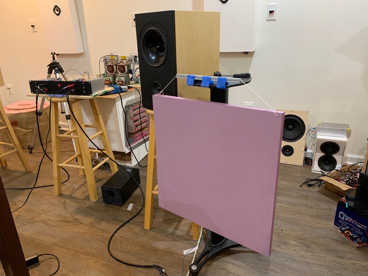

Here is the right panel from the front - hanging with string from an aluminum crossbar mounted to a speaker stand.

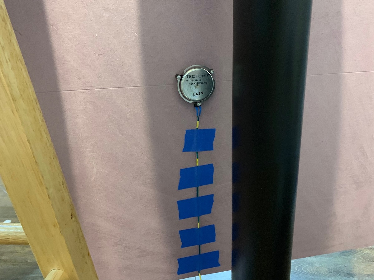

Here is the Tectonic TEAX32C30-4/B exciter mounted on the left channel and detail showing how wires are taped to back to prevent rattle and distortion.

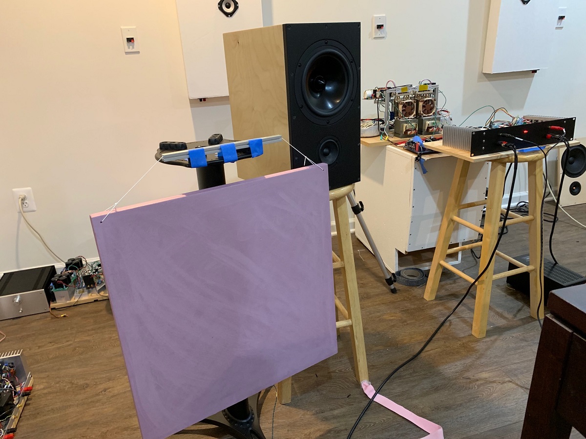

Here is the left channel from the front.

I see you have some interesting reference designs scattered about!
You might gain some benefit from rounding the corners as this is believed to increase the mode density which is a good thing. I used a dinner plate as a cutting guide- very scientific!
The brightness has been reported by other XPS users who also eq the response flat. I use ply which gives a flattish response but isn’t so loud. It’s still plenty loud enough with a sub woofer. Personally I think subs are essential with DMLs.
You may find with further listening you get used to the soundstage. I get good localisation and a very wide and deep soundstage but it’s all subjective to a large degree and my references are ESL’s and OB speakers so it might be my conditioning showing.
Good luck with the experiment!

Tape and wire should not be adhered to panel. Instead adhere it to the stand.
