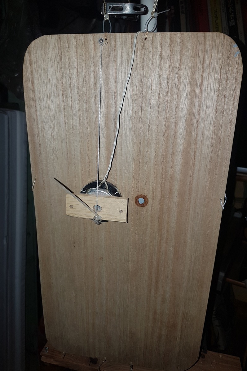

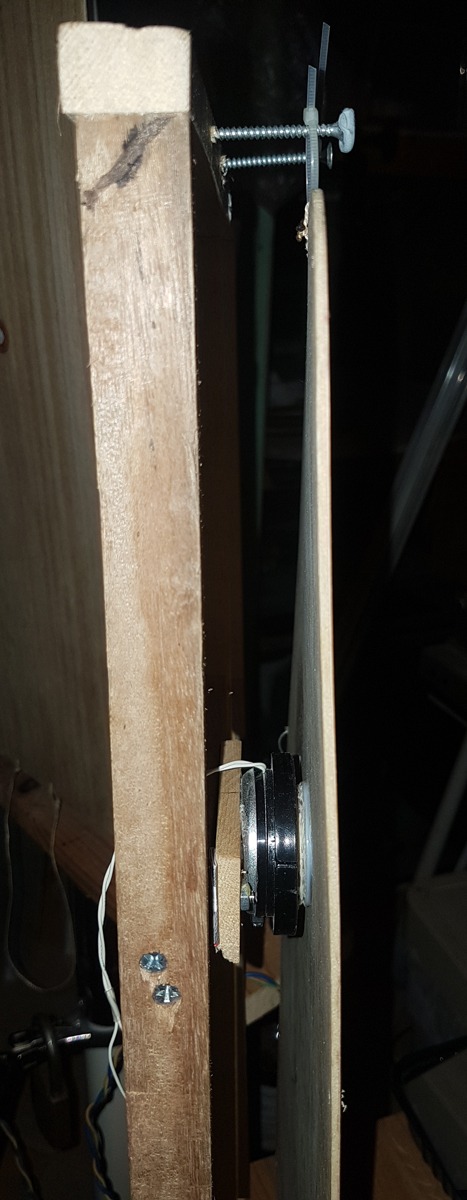

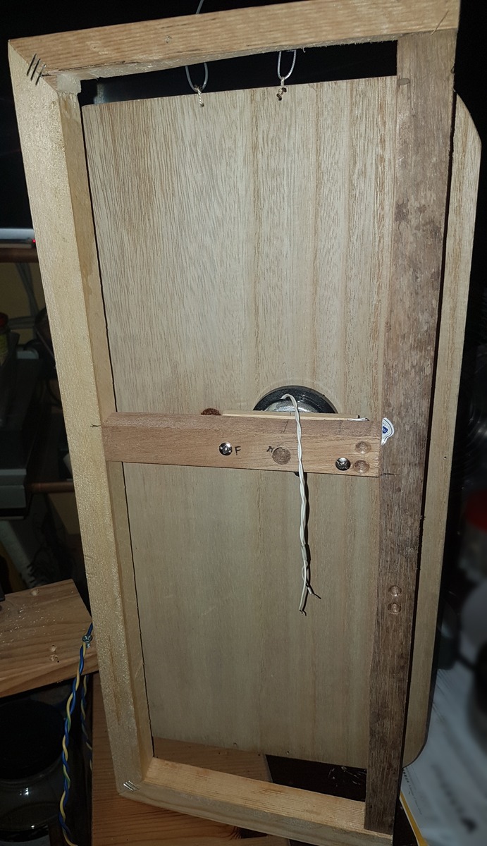

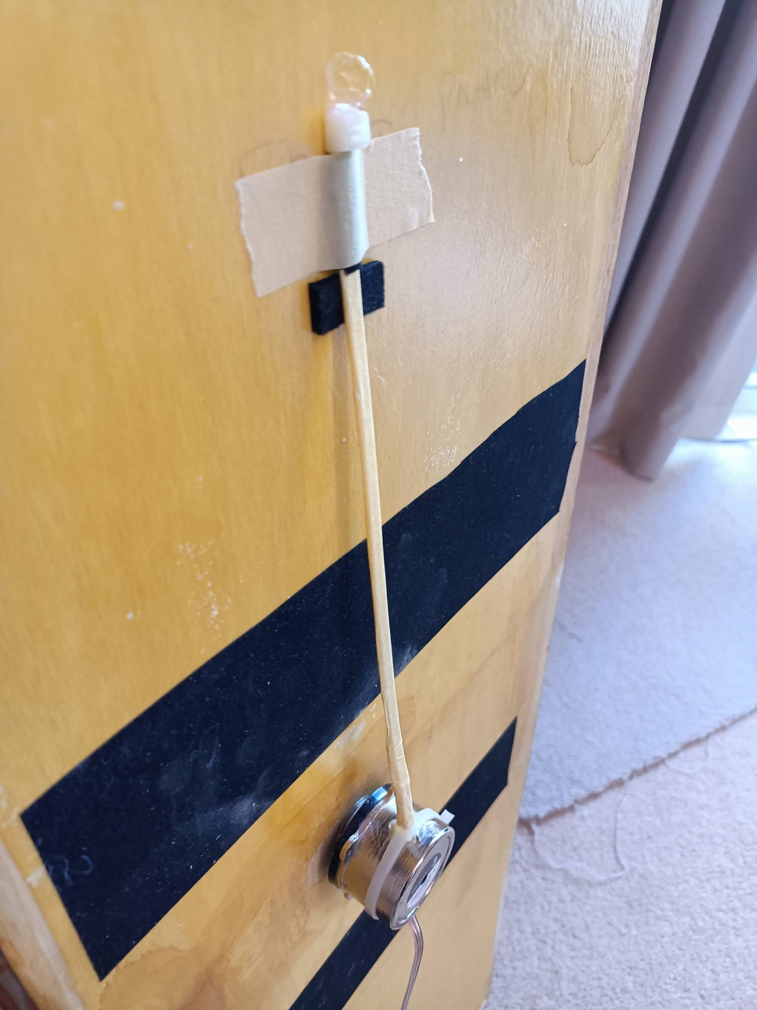

Last weekend I finally tried the spine + hanging frame (pic1).
It quite easy to made, actually we don't need the lower part of the frame. Just the upper square is enough. But of course you have to find a way to mount, hang or sit the frame.
A piece of wood was glue to the exciter back (pic3). I used a bolt system to attached the exciter to the frame (pic2). It give me chance to remove the exciter easy.
Because the panel is just hanging on the frame. The panel is a free float, and will not cause pressure on the exciter. However the height and position of the exciter must match the spine accurately. I used zip-tie on the hanging cords for fine tune.
I'm satisfy the result. The exciter no more head-down by gravity so that's no voice coil noise on some particular HZ. And the free flow panel don't get damped, sound still lively.

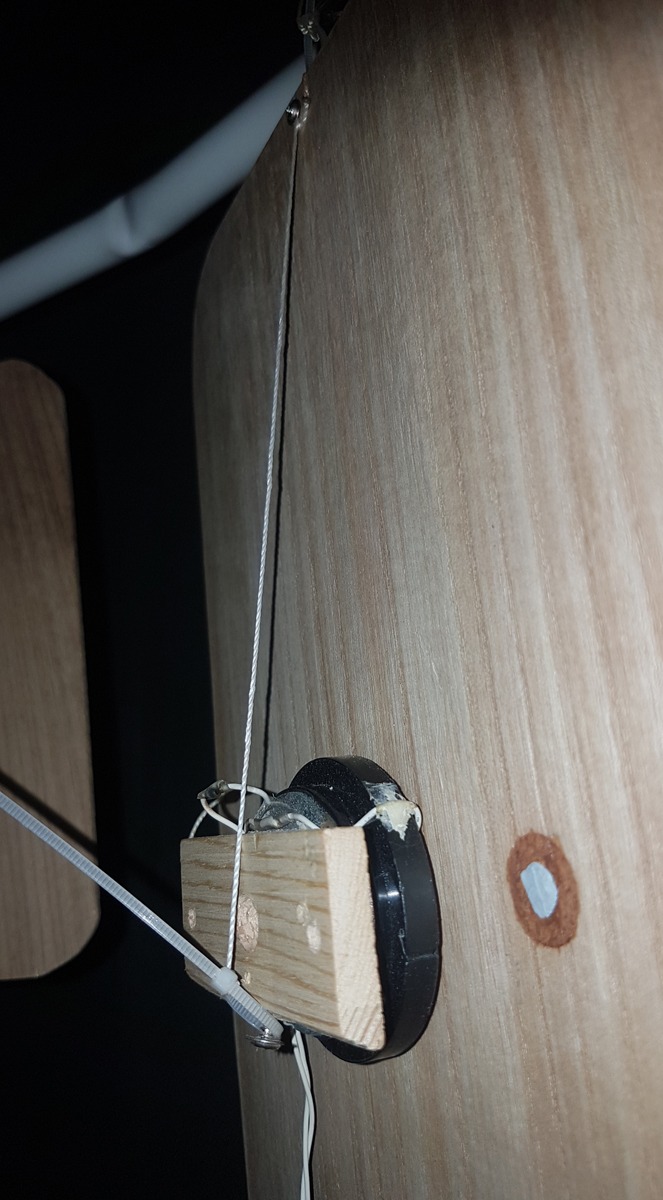

After finished the frame method. I just think maybe a more easy way can hold the exciter without a fix spine. So I tried the tug cord method (pic3+4).
Also I zip-tie to fine tune the cord length. The anchor is a screw next to the panel hanging point. So I think it may not increase the damping on the panel much. Or should I move the anchor outside the panel? On the hanging cord maybe?

Somewhere not too far back I posted pics of my most recent support method using zip ties - works wellLast weekend I finally tried the spine + hanging frame (pic1).

I found a copy - attached - the top end of the zip tie is glued to and separated from the panel by felt pads. The strip of masking tape is at the top was just to hold it until the glue dried - I just left it there. I also wrapped the tie with masking tape for damping (I love masking tape). A loop was formed at the the bottom through which was passed the second tie which is fixed tot he exciter - silicone was dobbed at the junction of the two ties
Of course the method used has to suit the exciter shape

Hkguy6.
My original 2mm corrected cardboard and aluminium panels over on my NXT RUBBISH days, used similar short term mountings to support the magnet weight.
This prevented the exciter weight from warping and bending the thin panel material around the coil foot.
I simply used 1inch masking tape from the top of the panel to the exciter magnet and used foam on the tape to stop the tape buzzing.
But this method does not prevent exciter wobble at low frequencies.
It is still out of balance, even the tape makes it more out of balance.
I noticed in pic 2 that there is a considerable warp in your panel, this could be a serious problem if rigid mounting was used on a ply panel, I mentioned this problem on, dml/open baffle for pro sound use, and a possible solution?

The tug cord method mainly for get rid of the noise at particular HZ.
This ply with the PUI exciter has noise at 228-233HZ and 440-445HZ these 2 range. Outside these range it's all fine.
The LF wobble just happen on my DAEX25FHE which I think it definitely need a fix spine. Or maybe a rigid mount panel also necessary.
The wires under in pic4 actually is the extension +/- wires from the voice coil (pic3 I lay those wires on top). This exciter originally is a DAEX58FP with square back.

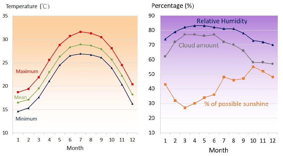

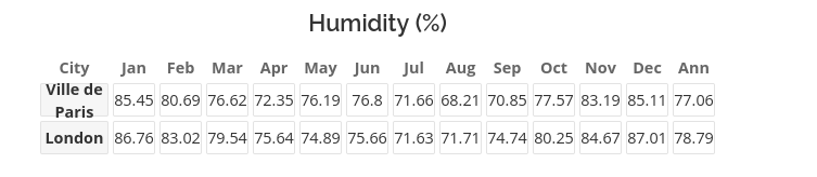

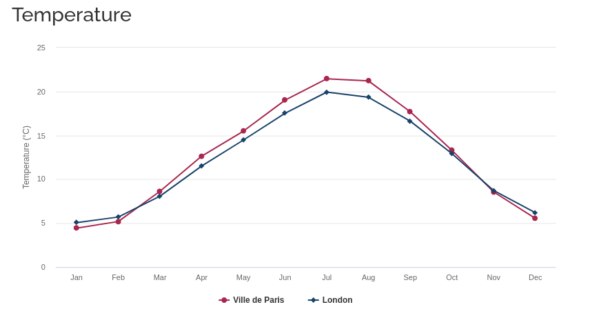

I don't know the humidity is in the different areas of the world, I guess north part of France is not very different from England, Honk Kong knows probably more humidity ? Seems from the graph below the difference is more in temperature ?
Any way, my plywood panels have now one year. They are finished with a light varnish on both side with a foam surrounding. The panel had a warp before to be glued on the foam but the glue and the foam did the job and they are still flat. To be cautious, a periodic control of the distance panel/spine near the exciter might be a good idea.
London vs Paris
Hong Kong
Hong Kong here can be VERY wet. We call it "回南天"。Hello
London vs Paris
View attachment 1101469 View attachment 1101471
Hong Kong
I didn't read the % but on the wet days. My house the walls goes sweat, some bad days the ceiling has dropping!
Check this scene to see how funny serious it is: 回南天
Drops on the ceiling... yes very wet! I understand wood is perhaps not the best choice for you...Hong Kong here can be VERY wet. We call it "回南天"。

Yep.... There's definitely a difference between European humidity and Asian/Tropical/SubTropical humidityDrops on the ceiling... yes very wet! I understand wood is perhaps not the best choice for you...
The effect is due to the higher temperatures .
In London/Paris it's rain, in Asia and down to northern Australia it's like steam
